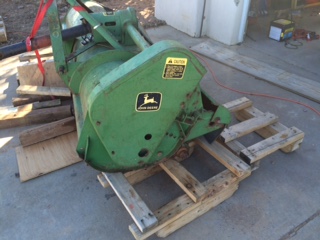

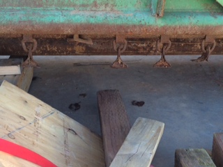

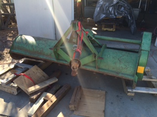

View attachment 456746View attachment 456745View attachment 456747
The is my second flail mower. My first is a Vemvo 6 ft wide that I have had to do extensive repair to. Thats why i purchased this one. After cleaning off some of the dirt I did find a large 25 on the back side as two stickers.
Hello CTWright,
If I have not done it already; I want to welcome you as the newest member of the Flail Mower Nations"
Yyou can order replacement manuals for your flail mower from John Deere or your local dealer.
YOU are the proud owner of a JD 25A flail mower with 36 scoop knives which will give you a good over all cut in all conditions.
Your flail mower rotor can be equipped with the 36 pairs of side slicer knives if my memory is correct-my fathers 25A had 72 side slicers.
check for broken D rings and damaged scoop knives, Change the drive belt, change the oil in the gear box scrape and wash of all the rubber dust and grease out from under the V belt guard and be sure to grease the other fittings under the V belt guard.
Pump no more than six squirts of grease in the flail mower rotor bearing and 4 squirts in the rear roller bearings before you mow for 8 hours each time and have fun with your new to you toy.
