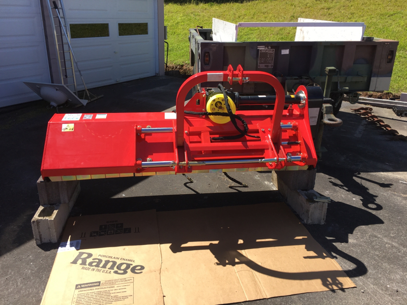

Although I got delivery of my new flail a couple weeks ago, I just got it assembled:
Hydraulic Offset 78" FlailMower EFGCH+195 HD
Tomorrow I'll get some gear oil, grease it and probably a new top link.
In the AM I have a buyer coming for my old flail. Thinking a good use of the funds will be a 2nd function switch.

On your picture you show the machine resting on cinder blocks. How did you lift it? And is it necessary to do that? Can I just uncrate it on a flat surface and attach the mower to the tractor痴 3-point hitch?

My 195 did come with couplers. I lifted it with a chain and my FEL, minus the bucket. I placed it on the blocks for ease of assembly, several bolts went in from underneath in the front. I haven't cut with it yet, rained all day today, but did mount it and run a bit.

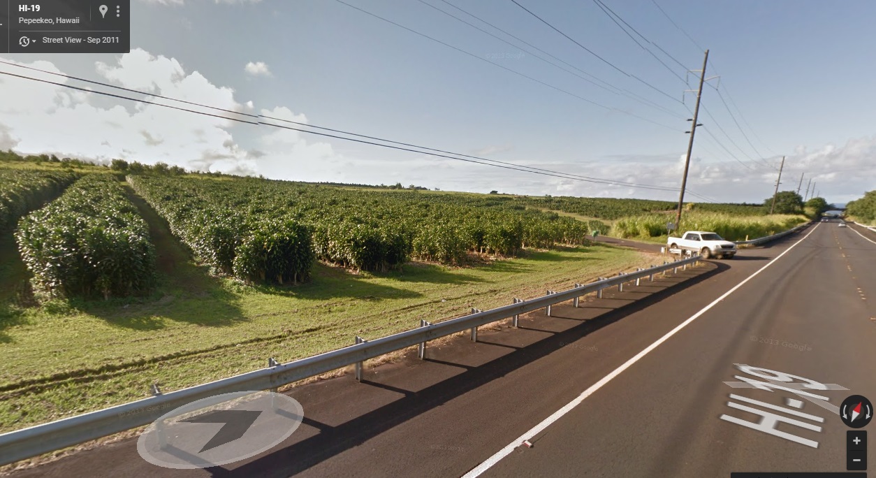

On another subject, while driving North on Hwy 19 a few miles after Pepeeko we saw a plantation but we are not sure what it is. Any idea?

Not sure what you mean by plantation. There are buildings left from the sugar plantation days, but no active plantations.
Lots of farms growing a variety of products and cattle.

That is 24 ac of Ti plants. The leaves are used in floral decorations and Hawaiian garments. The stalks are packaged and sold for folks to grow their own ti plants. Any part of the stalk will grow a plant ... just add water and soil.

Thank you Whirly. I googled Ti plants to see the flowers, they are beautiful. We saw some in bloom at the Hawaii Tropical Botanical Garden on Old Mamalohoa Hwy. Andre

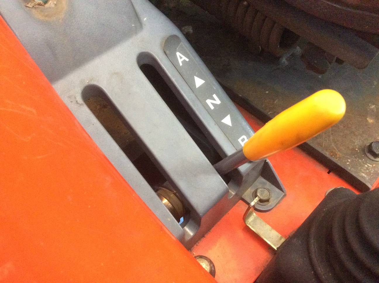

I know very little about hydraulics :(, but I believe my FEL and backhoe levers do return to a neutral position when released. The lever to operate the flail hydraulics does not, I have to purposely do so. If I don't my 3pt will not lift. Not sure about the overheating, but would prefer not to find out, especially your way. David Sent from my iPad Air using TractorByNet

This is correct David, the FEL and the Backhoe joysticks are spring loaded to return to neutral position when not actuated, thus allowing the oil to circulate. The problem is when using the Auxiliary Control Valve like the one on my Kioti to actuate a hydraulic cylinder. The ACV is not controlled by a self centering lever but a lever with fixed positions (in my case A. N. B). I will contact the dealer and ask him if a joystick can be added to control implements with cylinders, like the flail offset extender or a hydraulic top link. It would be a safer way to operate the cylinder implement, just in case one suffers a senior moment. Andre
