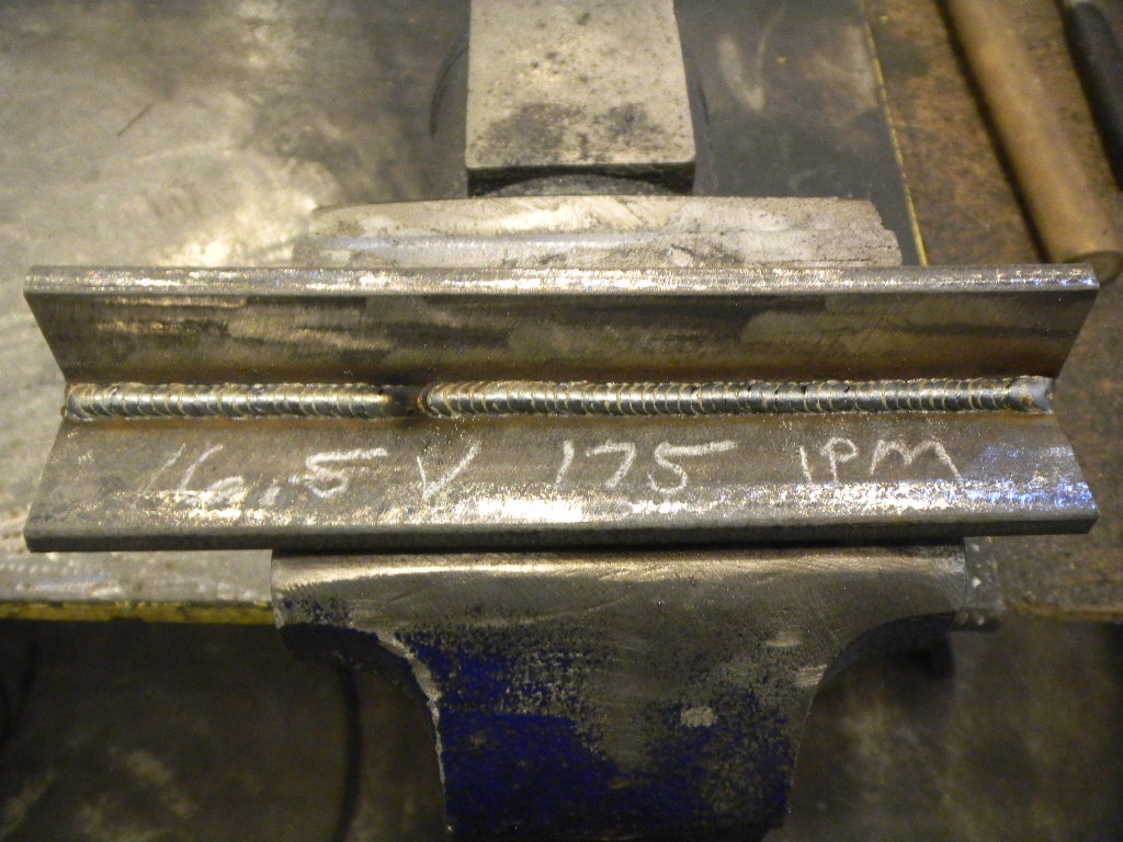

/ Let's see your welds... #69

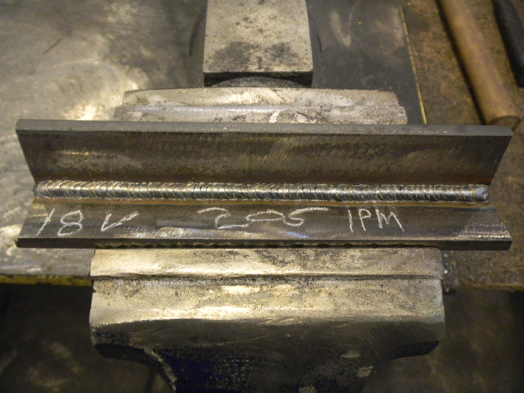

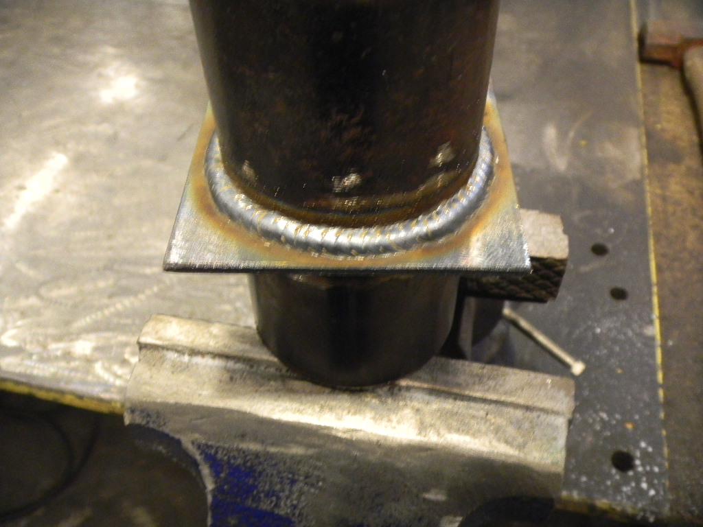

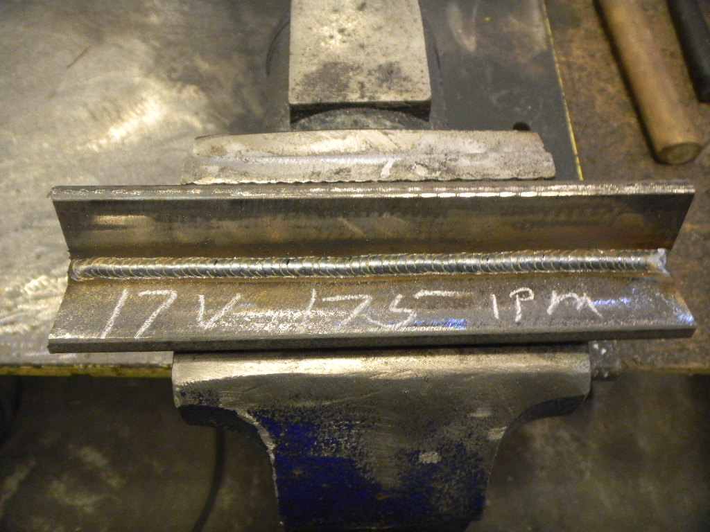

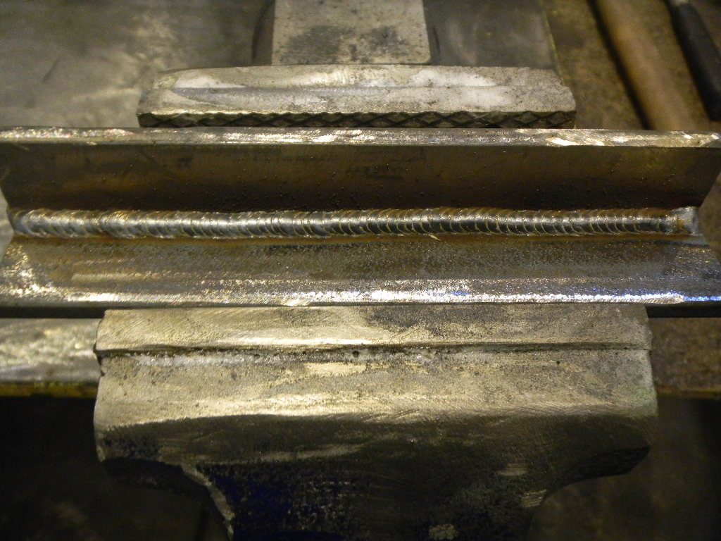

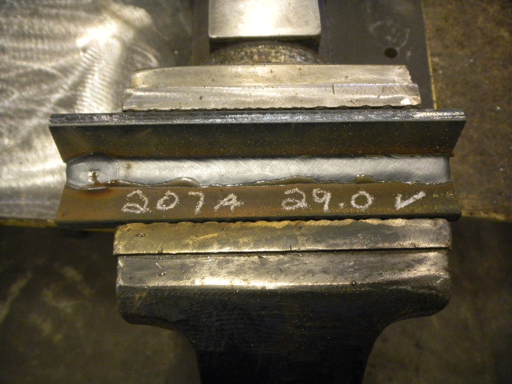

Getting closer! I started out at 16-volts, which gave a little more definition, but I thought it was way too cold. I ran these at 18-volts, 77-amps, wire speed was at 187-1/2 inches per minute, (measured). Even these seem cold to me! I checked Lincoln's site to see if this was anywhere close to factory recommendations. For .030 L-56 Lincoln has a minimum of 17-volts, and 35-amps! I was shocked at this!:shocked:
The travel speed on this is so slow, I fell asleep three times while making this 7-inch long weld! :laughing:

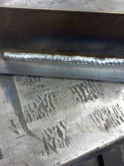

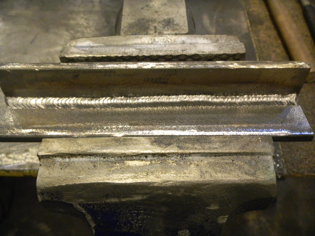

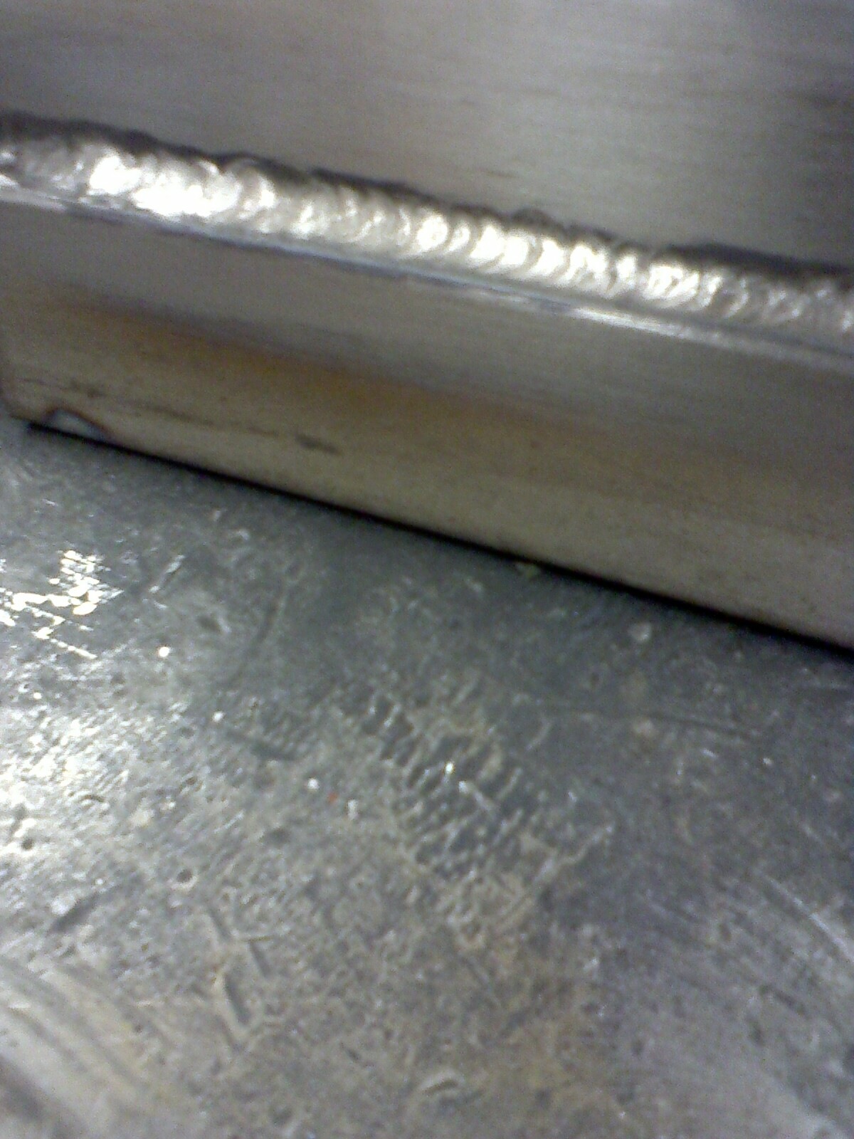

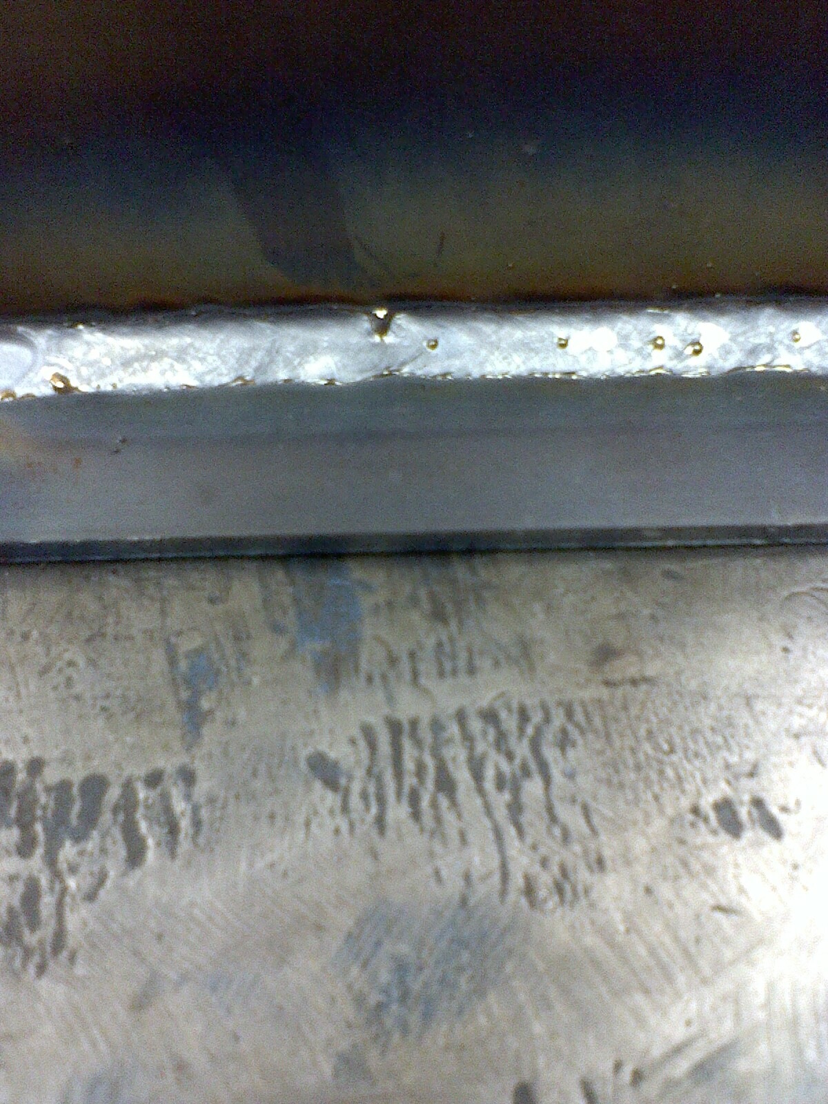

Here is a pics of some I just did. Miller 350P welder and .035 wire. Volts @ 15.8 and wire @ 160 FPM. This was 1/8" cold roll. And I too feel it isnt hot enough. I tried it colder and slower as per suggestions here. I normally would have welded this somewhere around 18.5V and 200-230 FPM.
The second pic is the same size metal, only set up to pulse. Wire speed @ 280. (there is no voltage/amperage adjustment on pulsed). This is about 2x's to 3x's faster travel speed than short curcuit welds.:thumbsup: And **** strong too.
The last two pics was a little TIG'ing on some stainless. Welding 1/4" bar to 14ga sheet for a guard.

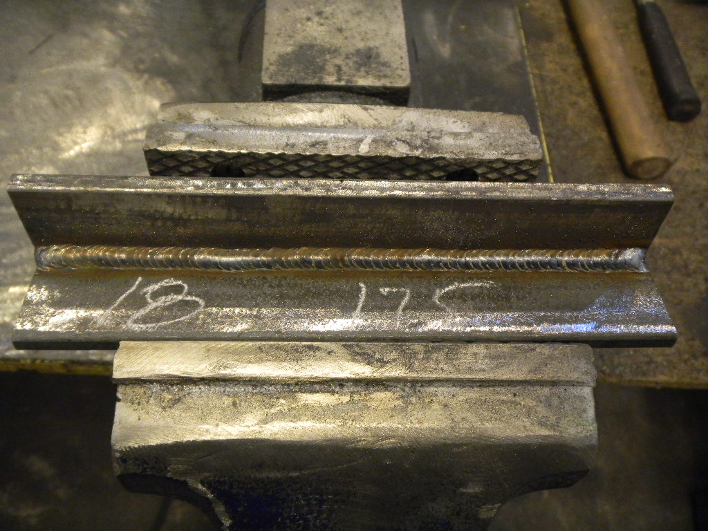

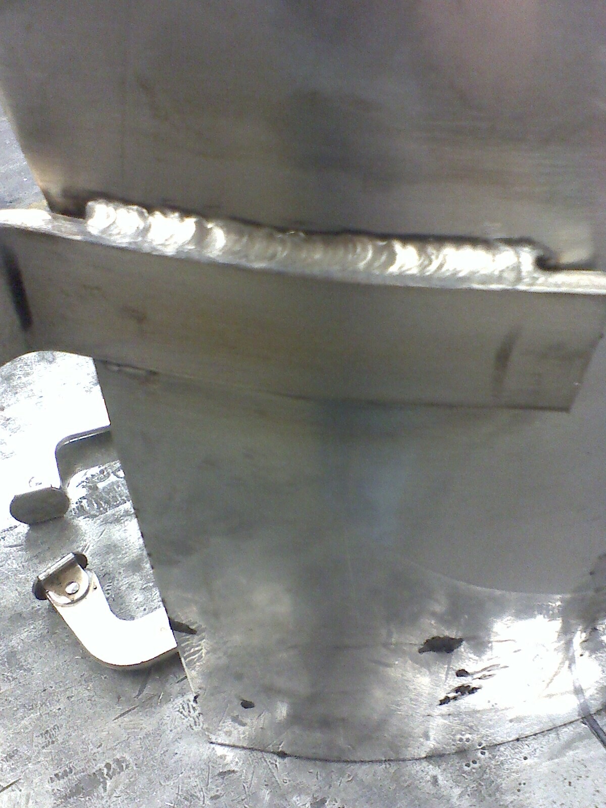

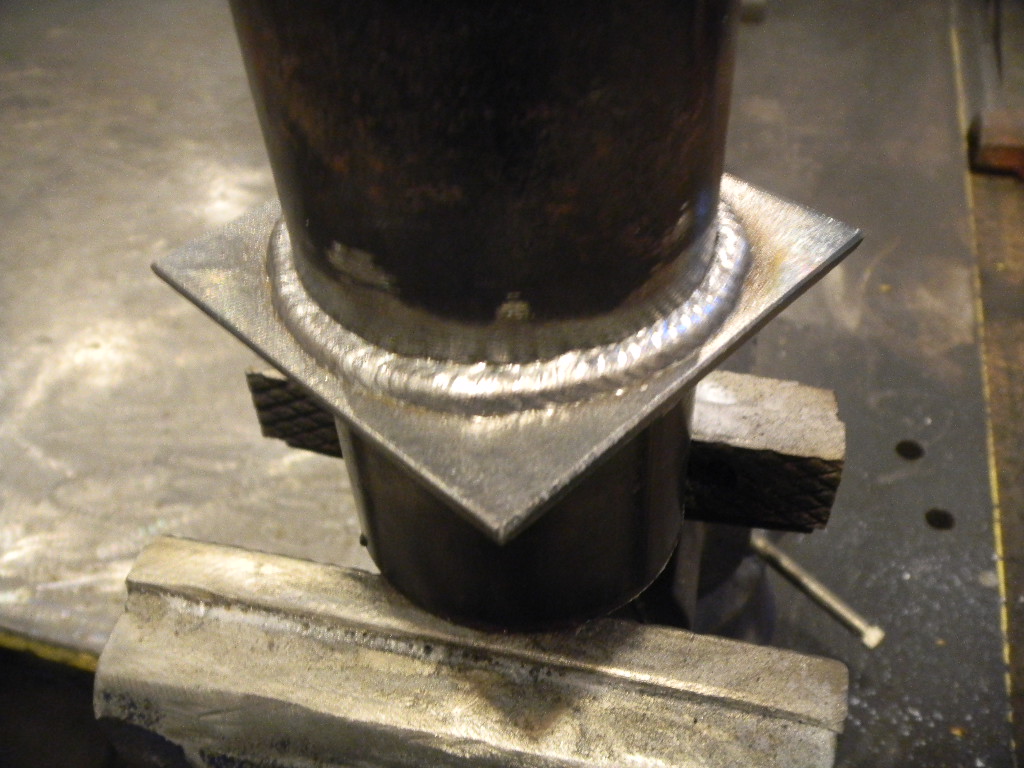

Here is the others I did. I didn't catch the amps on some of these, the Invertec only holds the amp reading for a few seconds and I always forget to look!

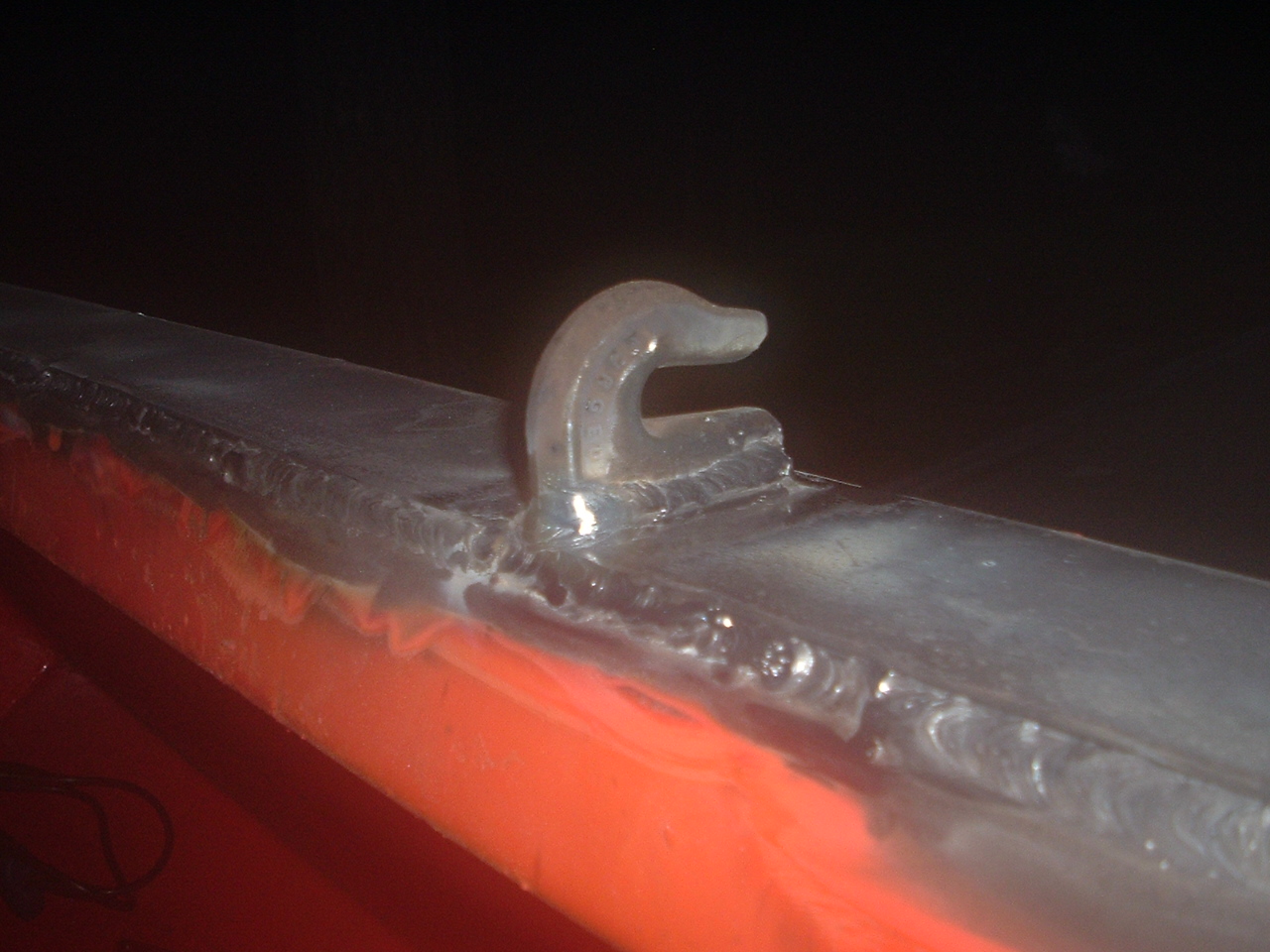

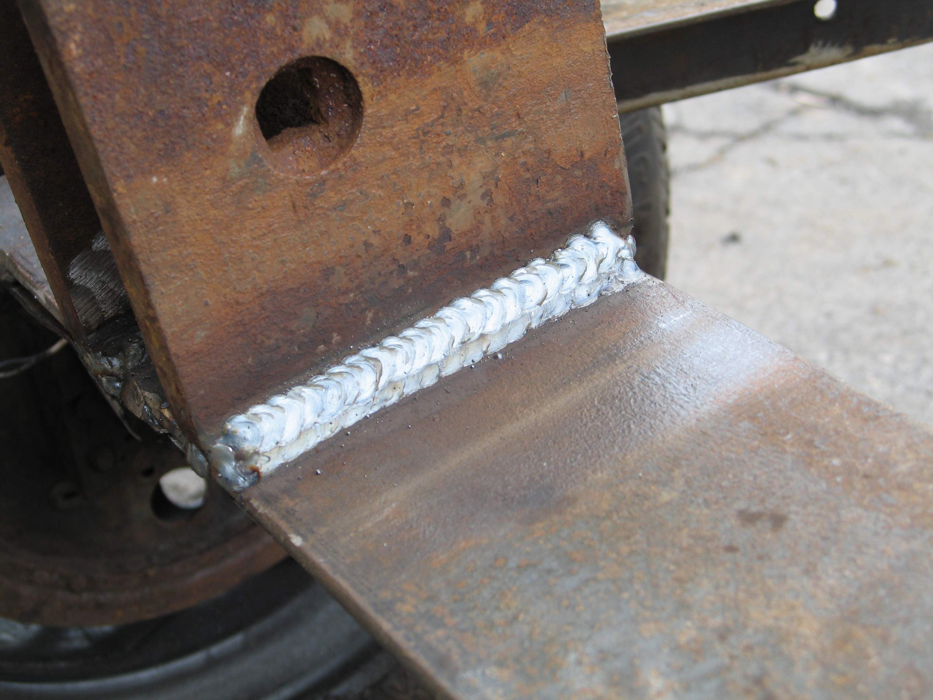

A few of the welds I did when building my snatch block for the logging winch.
1/8 7014 @ 115 amps DC
Sean

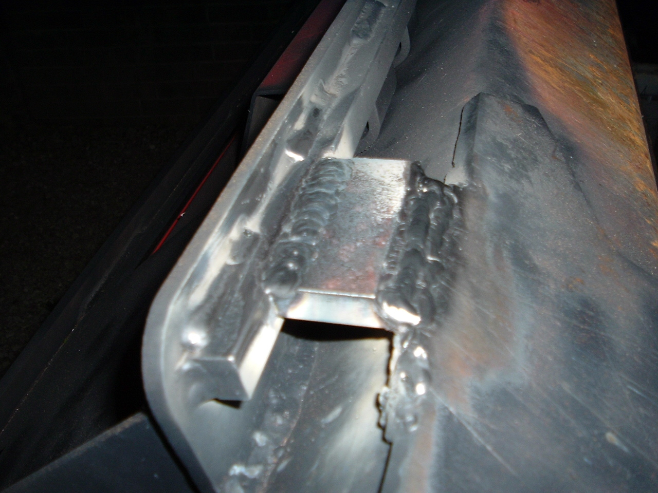

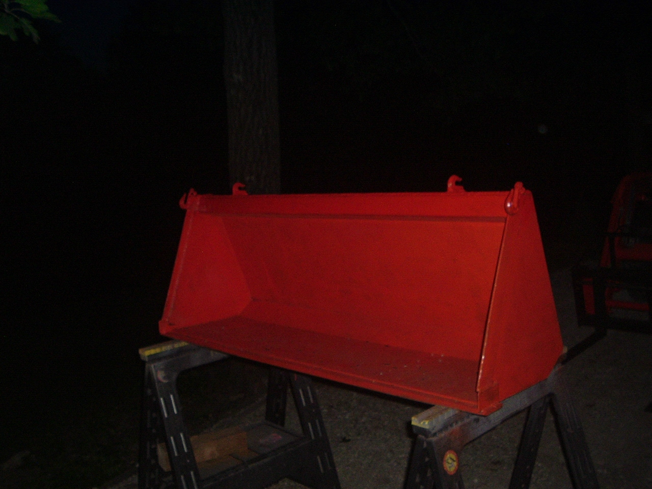

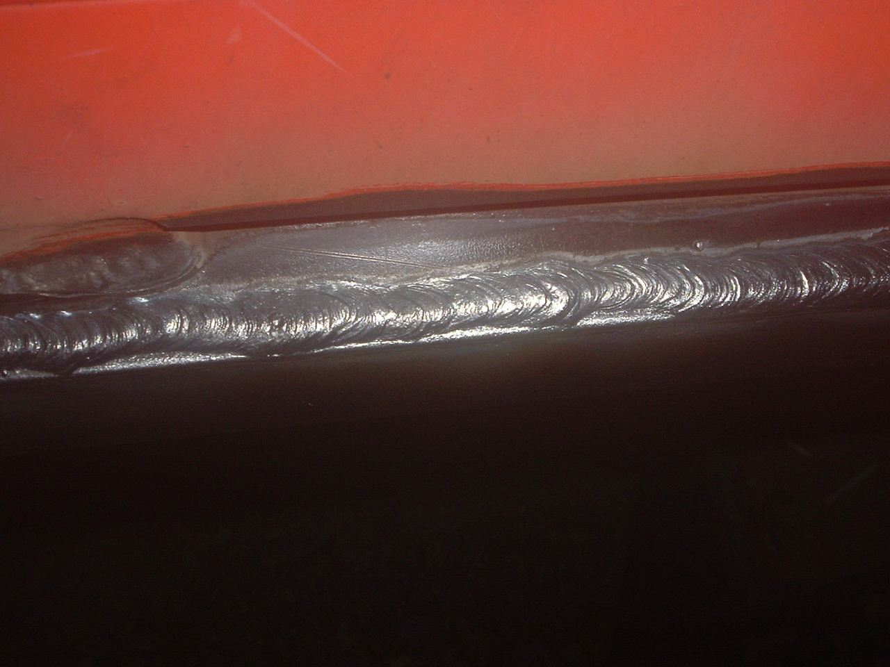

Here are some from last June on the bucket project. The reinforcing piece I put in just under the latch holes of the SSQA plate I welded on my old bucket after I got it cleaned off. It was cut at about a 45 degree angle, and I made multiple passes. I just wanted some more strength near those holes as I backdrag to smooth out dirt and gravel a lot Notice the smooth MIG welds on the SSQA plate, I did not make them, they are factory. The close up of the long bead is the top reinforcing plate I welded onto the top of the bucket, and the third one of course is one of the hooks welded onto that plate. Pic 4 is the finished product. My rod was 7018 125 amps Welder Everlast PA160
James K0UA

On these beautiful TIG welds, what type and power of welder are you using? Is it water cooled?

I never had much trouble getting that " fishscale" look. It is all in the type of weave you use. The >>> look is probabally just from a typical u shaped or z-weave. You can run the amps hotter and still get the "tig" look if you do the lower case e pattern. The problem is doing it SOOO consistantly.
Sadly only the second photo appears to have good fusion to the base metals. Running too cold with MIG and trying to get that fish scale look may look cool, but you run a very high probability of getting cold lap between those scales and non fusion on the sides which the other 3 photos show distinctly on the top edge more prominently than anywhere else.
If you guys want good strong welds, try to make the ripples closer together and the weld as smooth as possible, keep the puddle molten as you weave back and forth, if it cools and you are adding molten metal to the cold puddle, you will have more issues with cold lap than if you keep it molten like the spray arc welding. This isnt always possible when in vertical and overhead, but run it as hot as you can without sags or undercut on the sides.
Welds in general and TIG welds especially should be rather slightly concave , to flat with sides tied in well to the base metal when joining plate rather than convex. The extra metal humped up in the middle contributes nothing to the strength of the weld and in actuality creates internal stresses in the weld that will contribute to cracking. Cap passes on pipe are generally limited to about 1/16" high max with additional 1/16 allow for really thick materials but regardless of thickness, never more than 1/8" above the base metal and they must be fused to the base metal completely.
I agree that the first pic doesnt have as good of fusion as the second. But that ISNT how I normally weld. For sake of trying....I was trying to get that "row of dimes" look that shieldarc was also trying to duplicate. The second pic is pulsed and everyone has their preference as to what the "like" as far as looks....And I personally like the look of a pulsed or spray weld:thumbsup:
If you look closely, the las two pics of the TIG welds they ARE concave slightly:thumbsup: Those welds arent going anywere. The base plate that the bar was welded to is only 14ga SS. I have played around with the TIG and done break tests on different joints enough to know that TIG welds are TOUGH to break. A butt weld on two 1/8" plates with a single pass on one side only, and bending in the weak direction (back overtop of the weld) and I can bend it into a tight U shape and then flatten it back out and no cracking at all.
