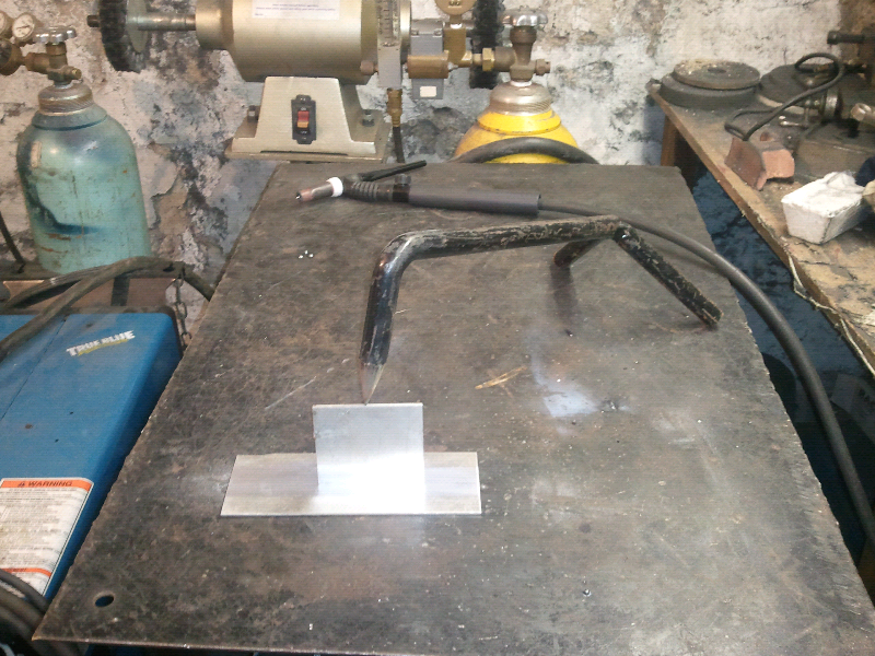

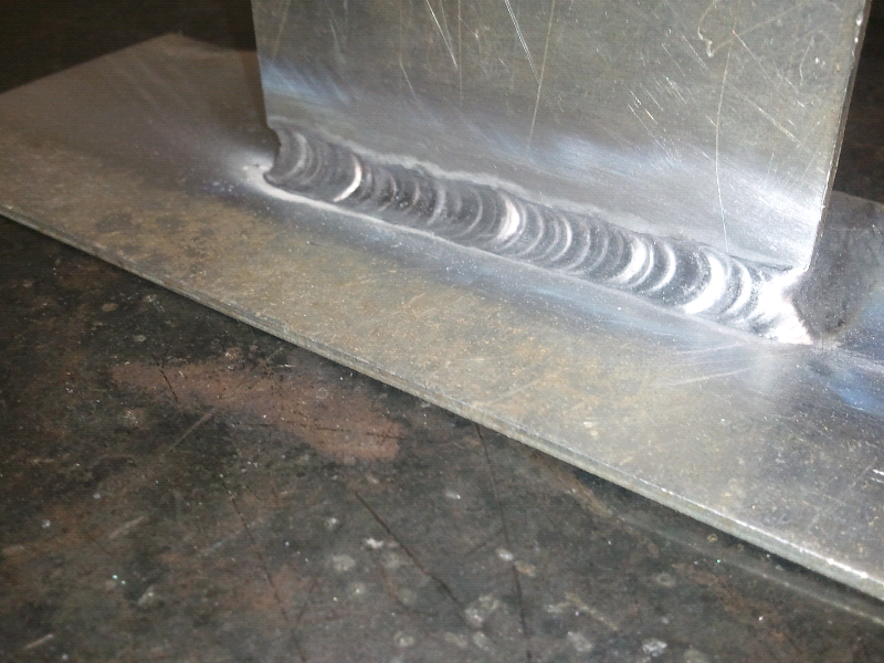

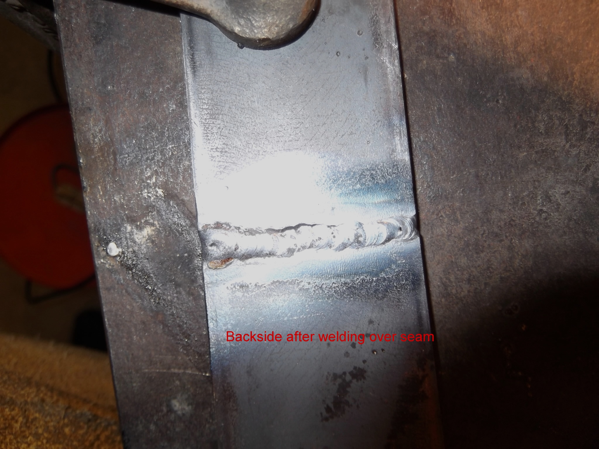

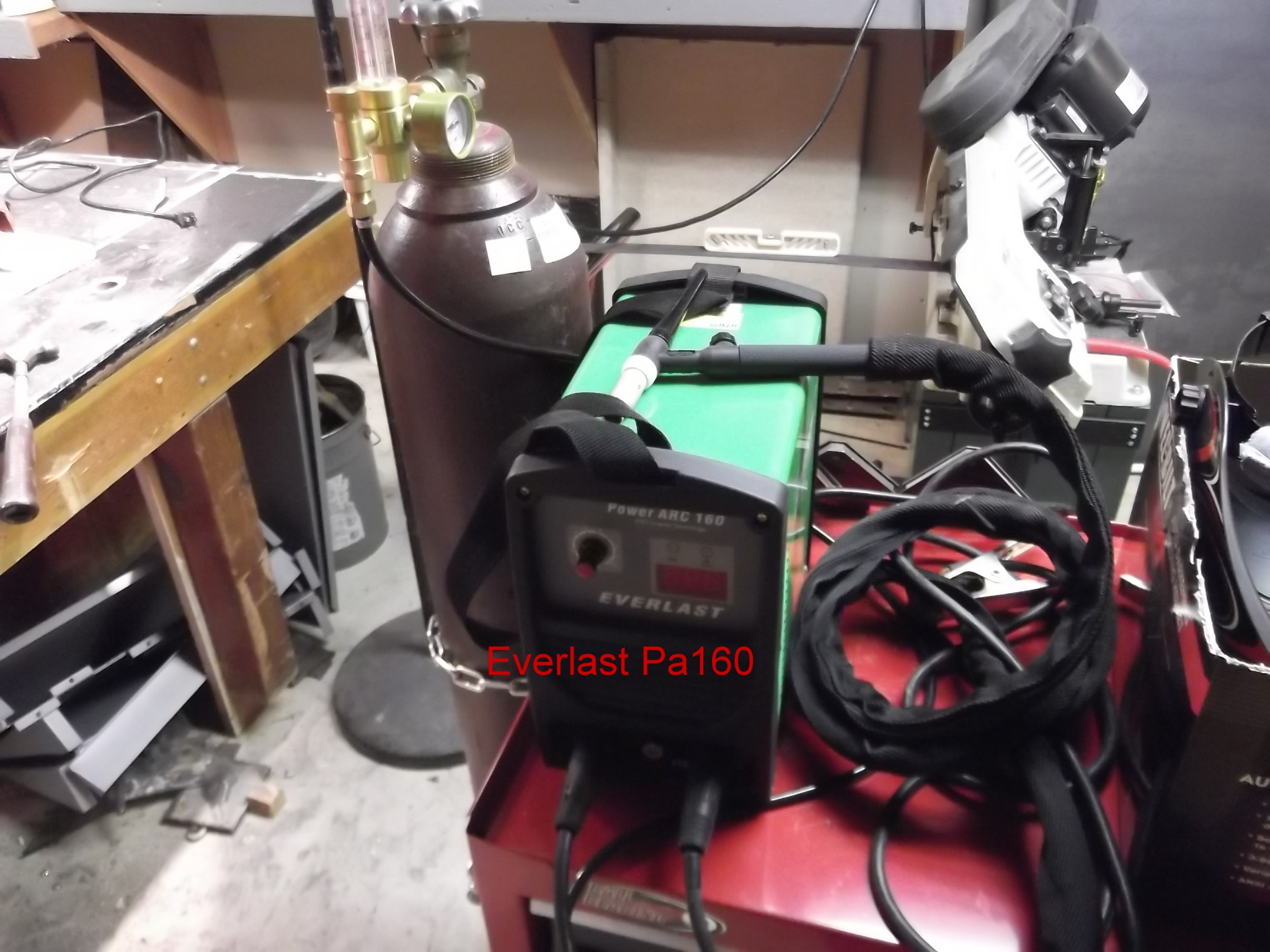

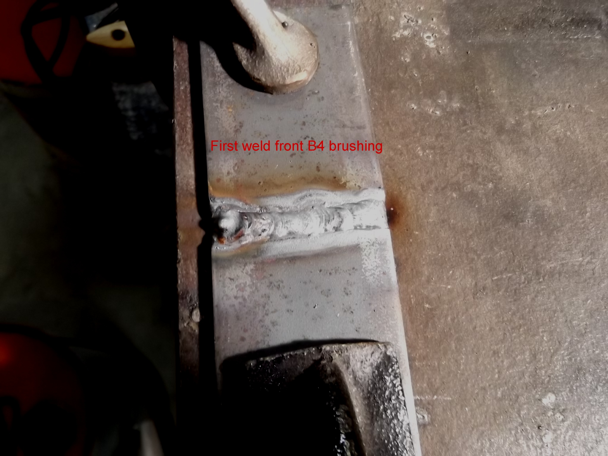

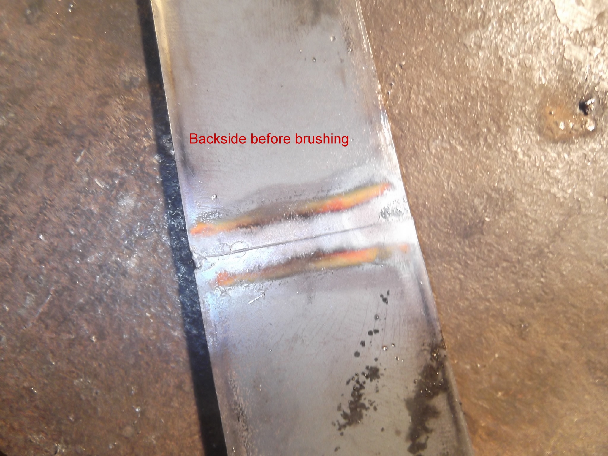

Ok Shield Arc, here is some Lift start TIG on the Everlast PA160 stick welder.
The first bead on the front is not too good, so I welded the seam on the backside after taking the photo's . Had a little undercut etc. Then I Ran 2 more beads on top of the backside over and under the seam bead. They looked a little better. I should have run some practice beads before I started. The thing I am the most proud of is the 17V torch tungsten is not all gloobed up as it usually is.. I stayed out of the puddle for 4 beads:) No grinding for me WHOO HOO. Now if you will just let me do some grinding and a little fill in I could make that metal look smooth:laughing::laughing: You do know that is why they invented the grinder, for guys like me right?

Nice shop bud! Acoustic ceiling, stove, fridge, and a waiting room lounge for pushy customers! LOL!!! Keep practicing, coming along fine. My phone only showed last couple pics. Been doing that alot lately, dont know why. Some wont even open.

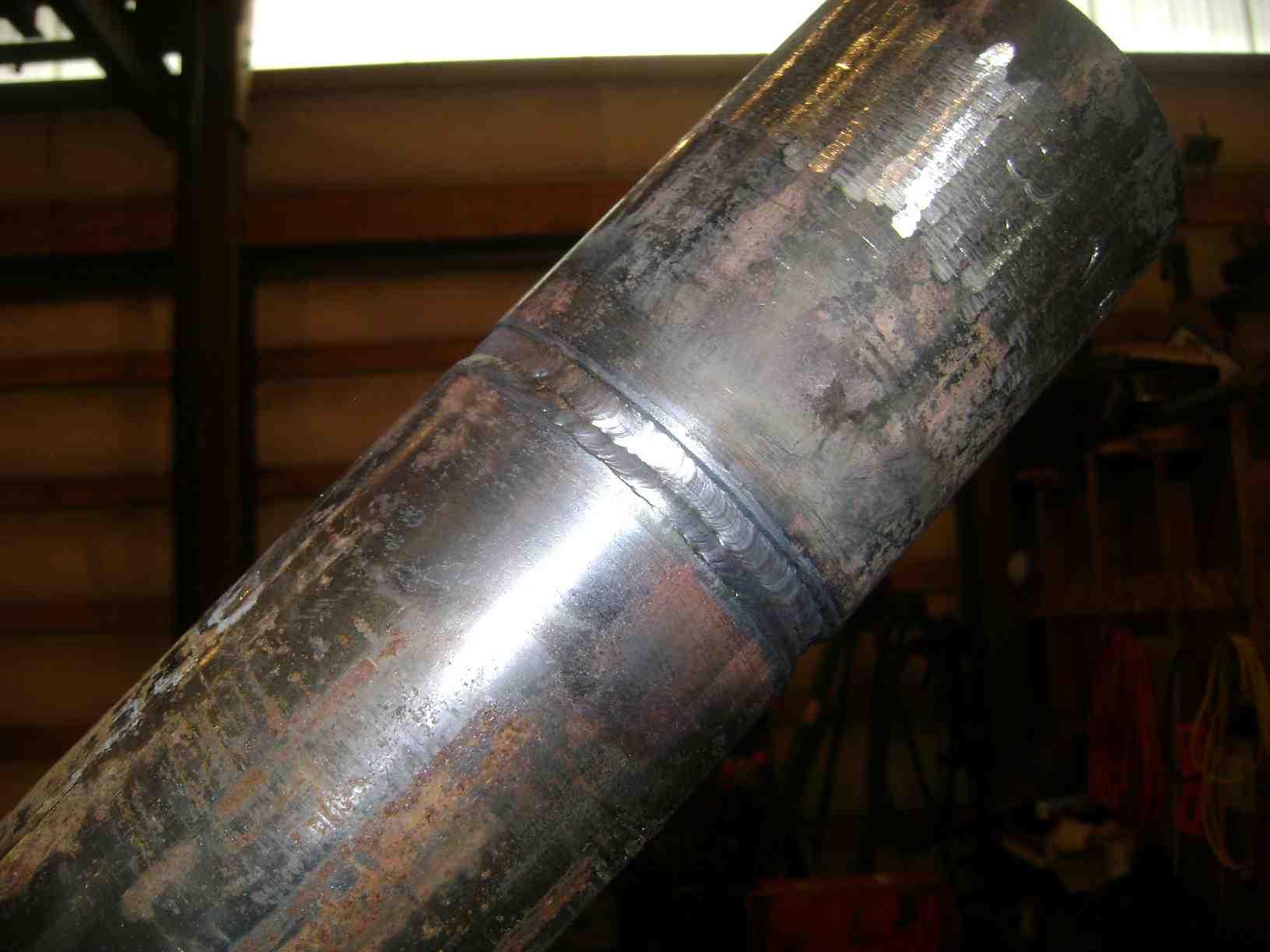

James those are great! For full pin welds I'll tell you how I do it, not that I'm much of Tig hand!
I like a knife edge / 0 land. I use a 3/32-inch drill bit to set the gap. Use 1/8-inch filler rod. Lay the rod in the gap, and run over it with the torch while holding down pressure on the filler rod. I run about 85 to 90-amps with a really long 3/32-inch sharpened tungsten. For the next pass I won't turn the heat up anymore than 5-amps, and switch to 3/32-inch filler. This really helps with preventing suck back. Nothing more heart breaking than to run a perfect root pass then destroy it by running the hot pass too hot, or not use enough filler, and suck the root bead right back out!

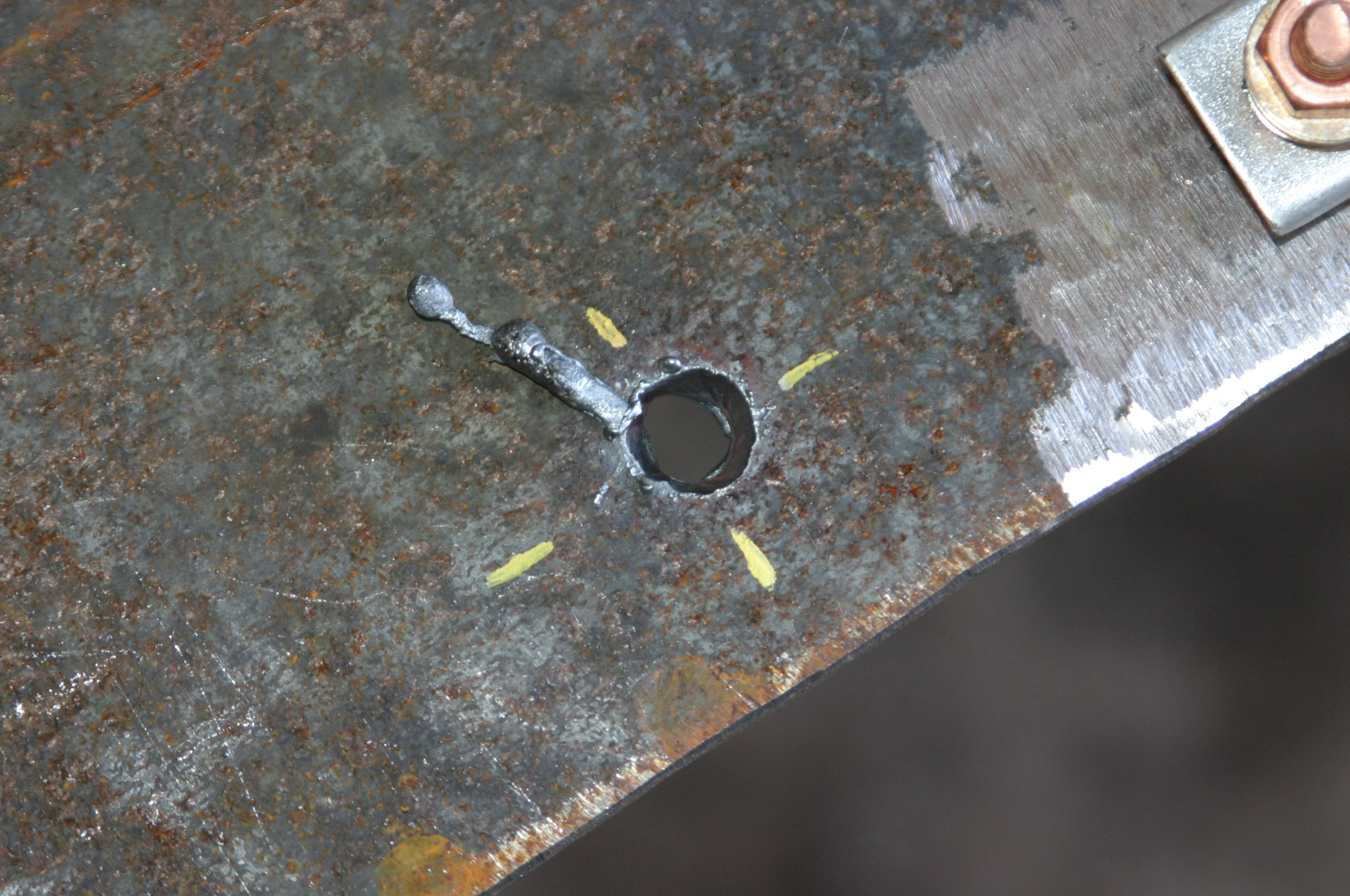

I dont think to take a lot of photos of stuff I am working on, but I searched my camera chip and found these of a favor I did for my building contractor. He wanted some anti-skid and floation plates welded to his backhoe stabilizer pads. All cast material on the pads and welded with 1/8" 7018. Material welded on was some scrap rusty as he!!! angle and a piece of old disc axle to act as anti skid bar.
