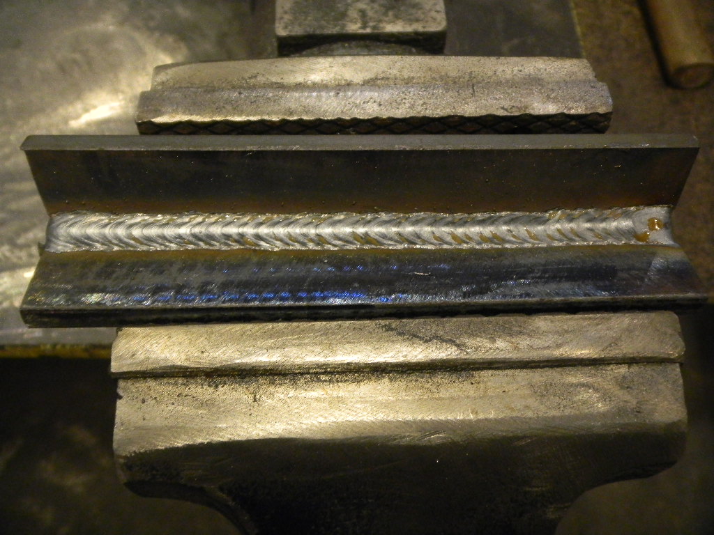

Figured id try to keep the post going was expecting more pics guys. After checking out ZTs mig like tig welds, I was playing around a little tonight.

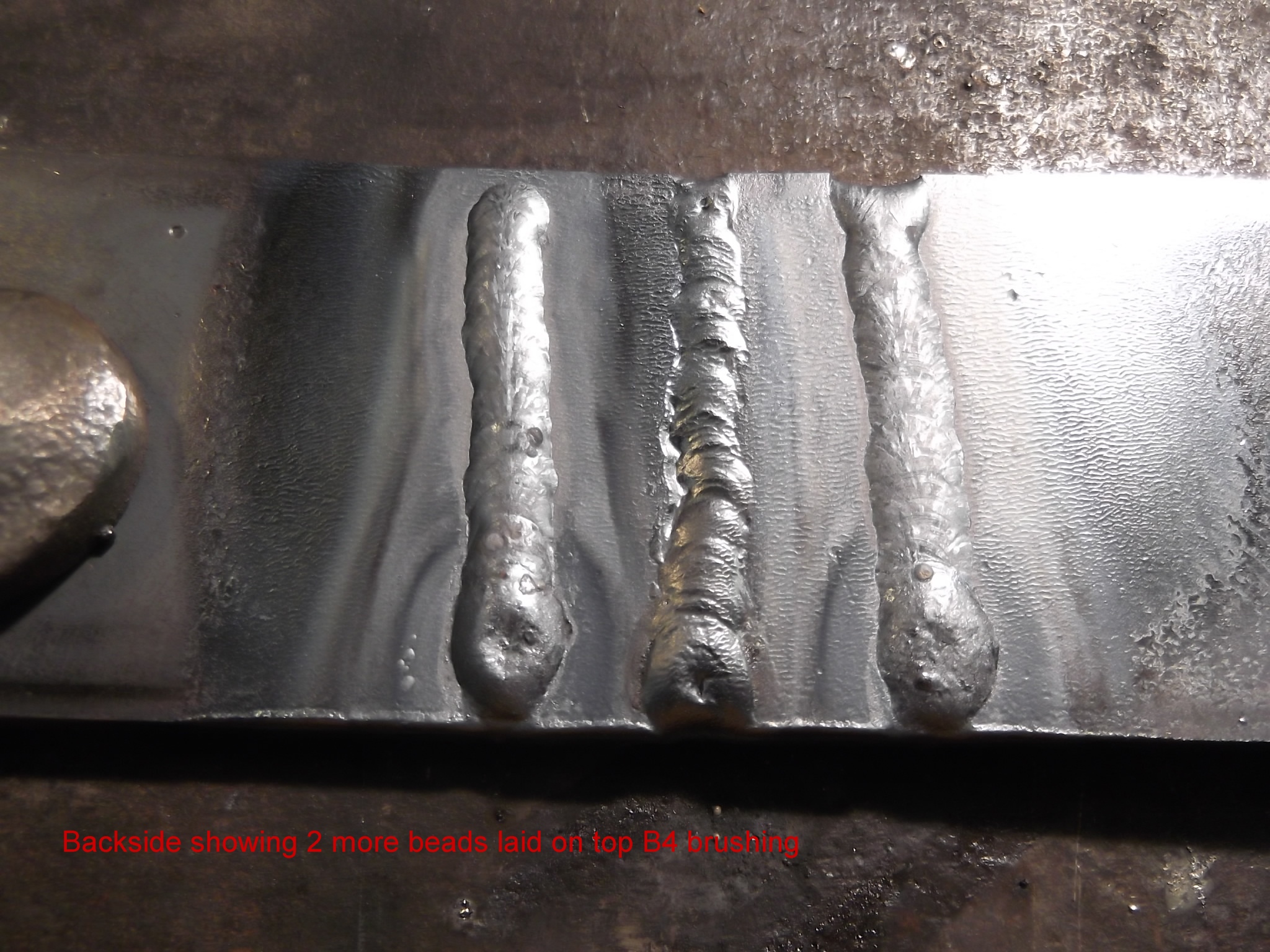

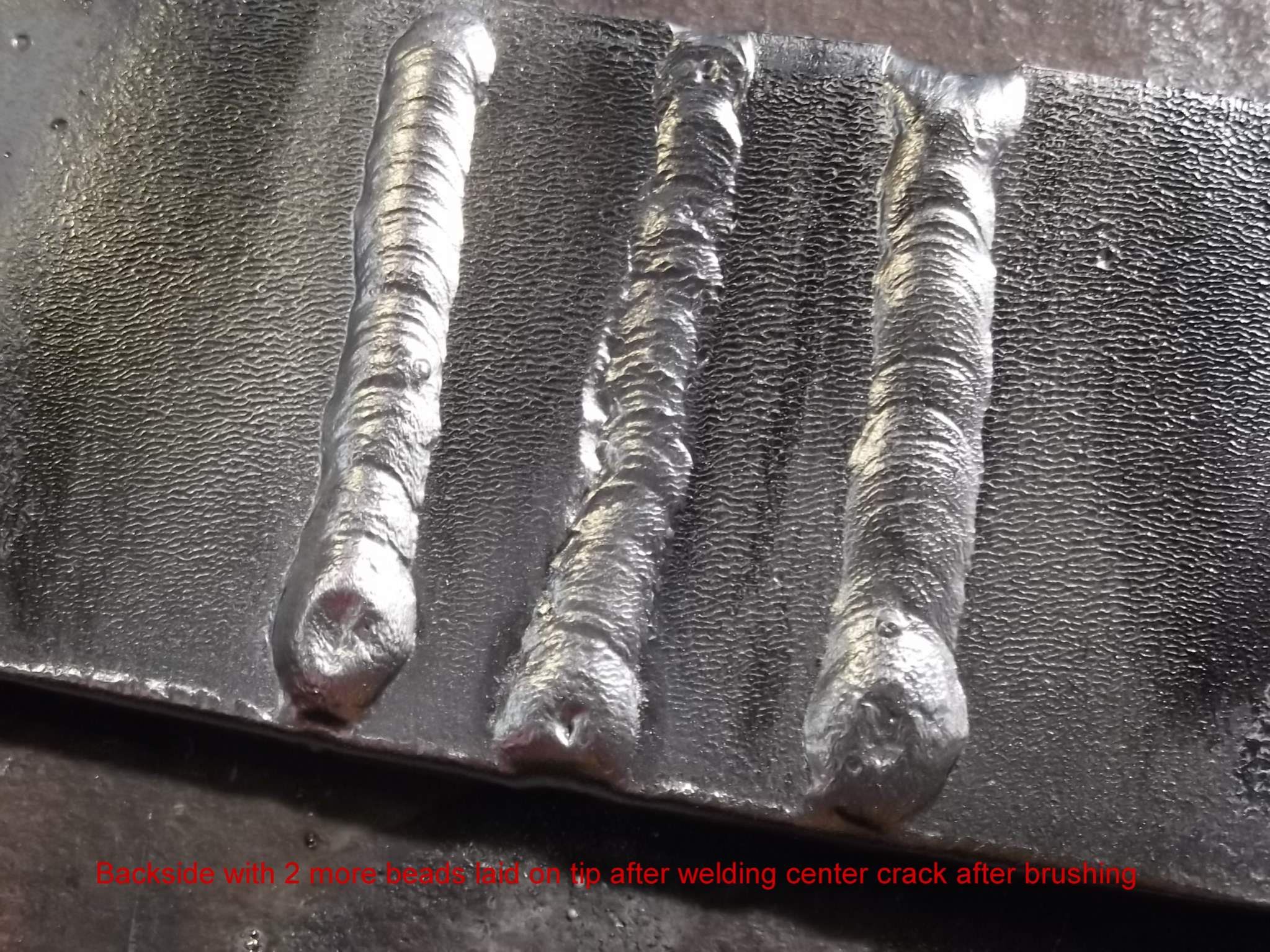

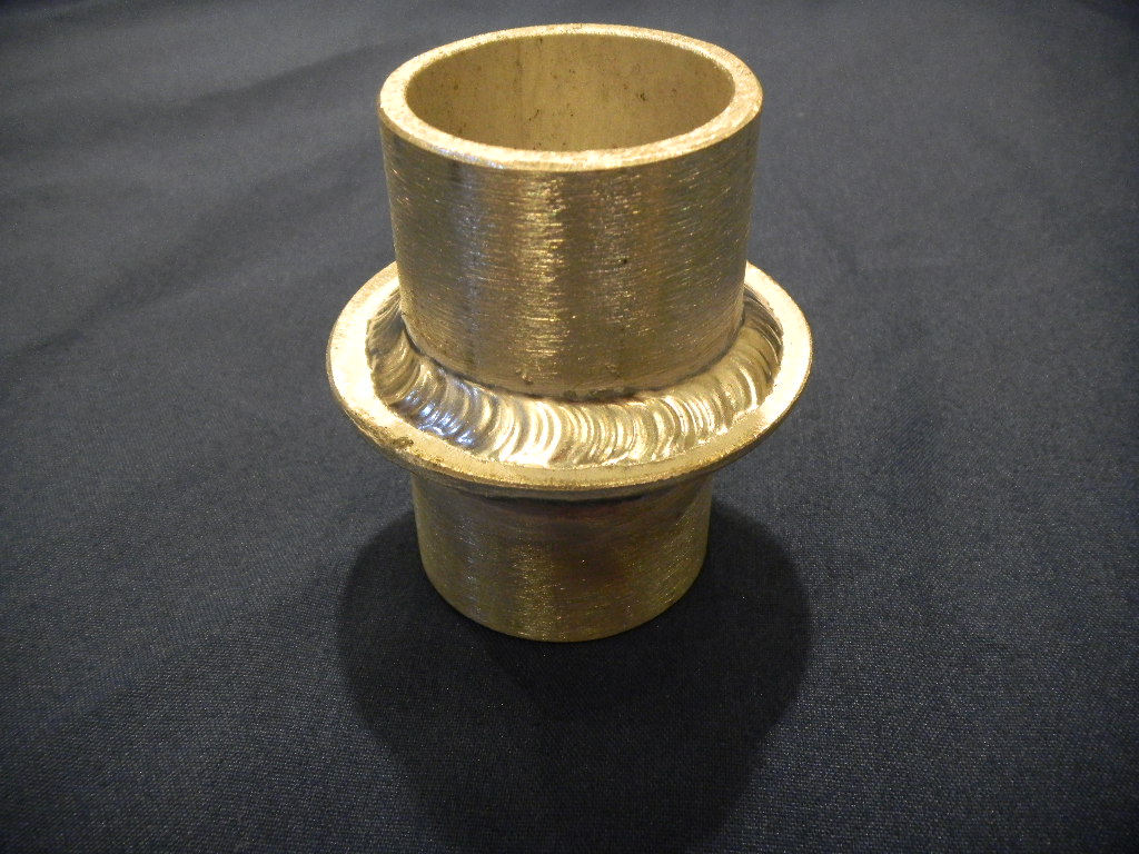

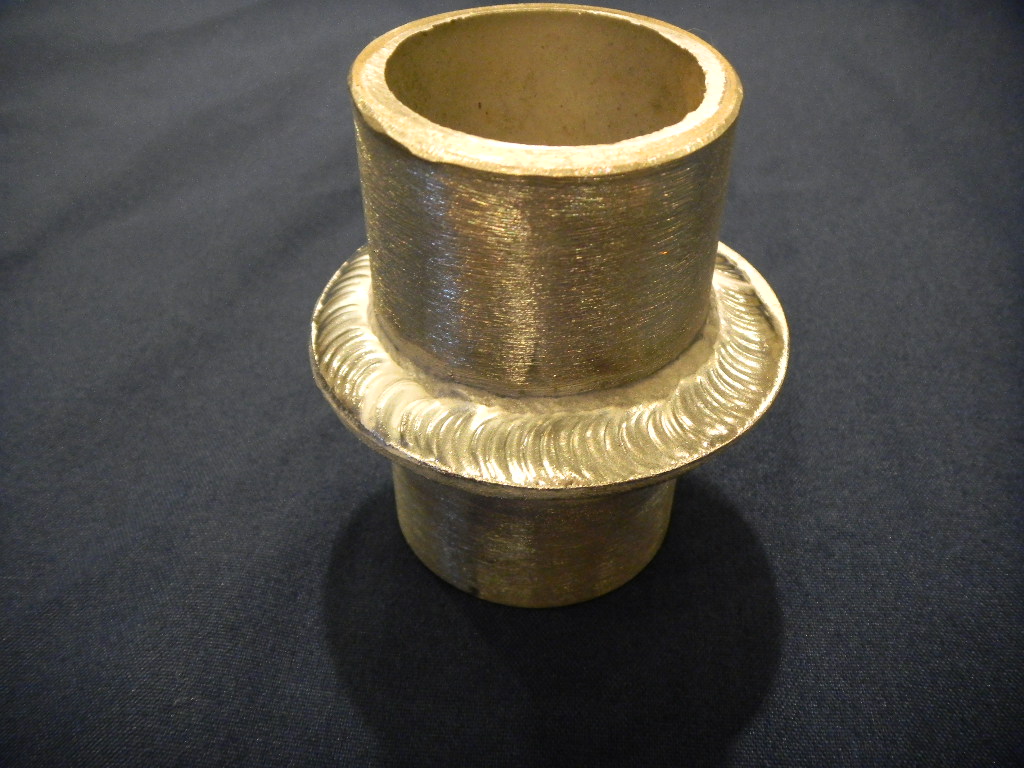

Playing with the Tig welder this morning. 1/8 inch 4043 filler, have no idea what the base metal is, found it in the scrap yard.:confused:

Beautys shield, looks great. Silicon bronze filler?
/ Let's see your welds... #55
No just plain old 4043.
When you did your Mig weld a few post back, what pattern did you run? Or did you whip back n forth like with 6010?
/ Let's see your welds... #56
Like an e<, volts up and wire speed down, gun straight in to joint at a 45* angle. Its definateley in your field of view, so if your a righty you almost have to be on the left side of the gun and two hand it for repeated accuracy.

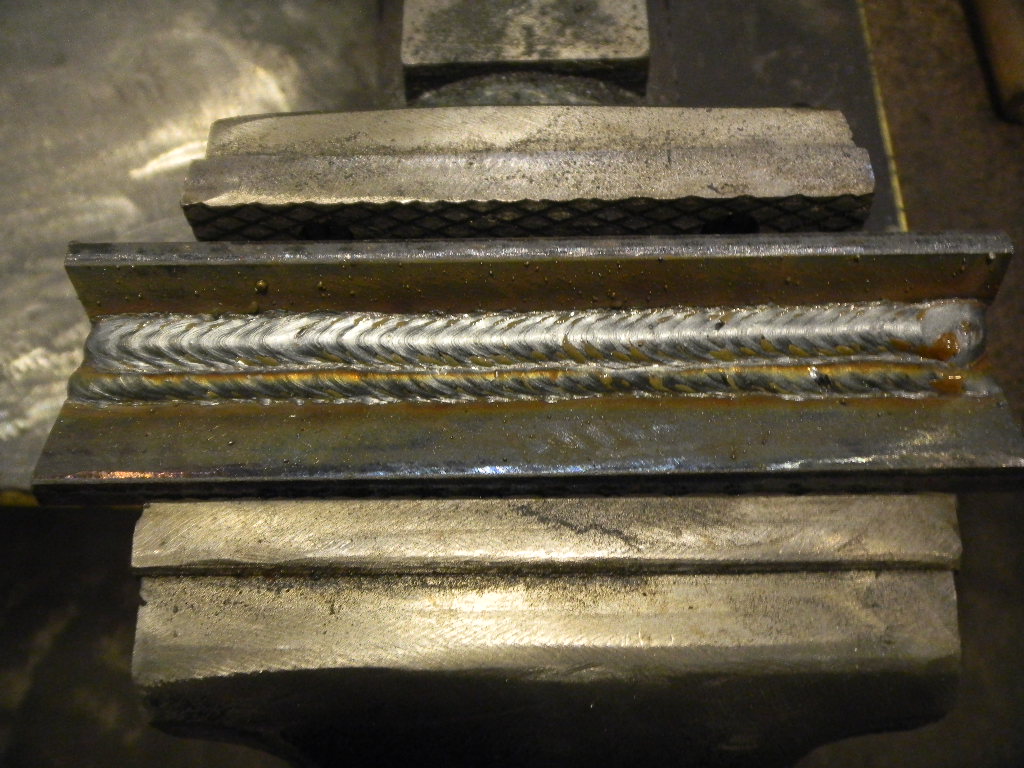

I can't seem to get the < out, need more of an (. Adjusting the pinch / arc force helped, but maybe I'm running to hot?
.030 Lincoln L-56 wire.
22-volts.
145-AMPS.
+7.0 pinch
20-CFH C/25 gas.

Great looking welds, but for that other approach try not angling your gun(straight in) and slow your wire speed down to the point it would be unorthodox to use, but yet steady. This is a very slow process of mig welding. Prob about 5in per minute, just as a referance
