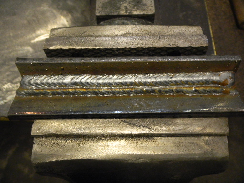

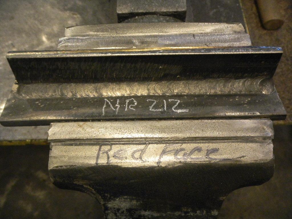

This is far from a perfect weld, but good enough for the average home owner. .045 Lincoln NR-212 on 1/4 inch flatbar. Notice how the crater is fuller than the ones in your pictures? Soon as I want to start thinking about stopping, I turn the gun to more of a straight in angle, tighten up the stickout, (this will cool things down), and go backwards 3/8 to 1/2 inch, and pause for a second or two.

Shield Arc,
Wow that is a lot better weld. Just one question, what do you mean by tighten up on the stick out? I understood the rest of it but am having a
little bit of problem with the terminology.

/ Let's see your welds... #107
The length of wire from the contact tip to the metal is called stickout. With Mig and most fluxcore self shielded wires I'll run 3/8 to 1/2 inch stickout. NR-232, and NR-233, and Coreshield 8, along with fluxcore gas shielded wires I'll run 3/4 inch stickout. If you lengthen the stickout you increase the voltage, (to a point) if you shorten the stickout you drop the voltage, (which cools the puddle).

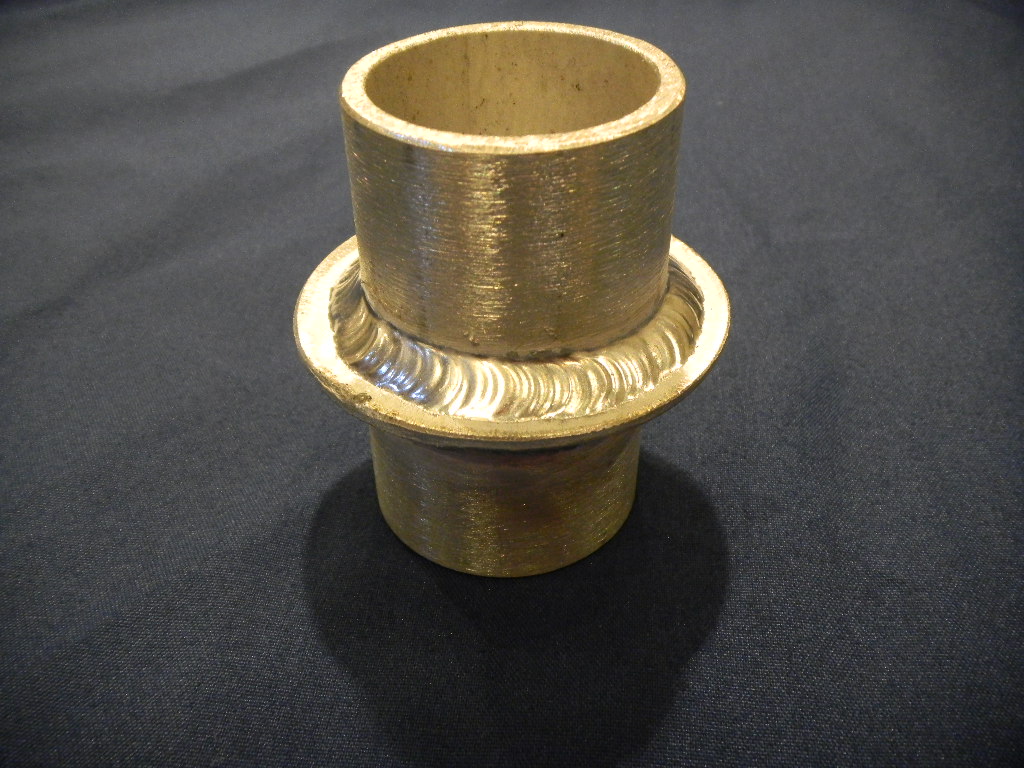

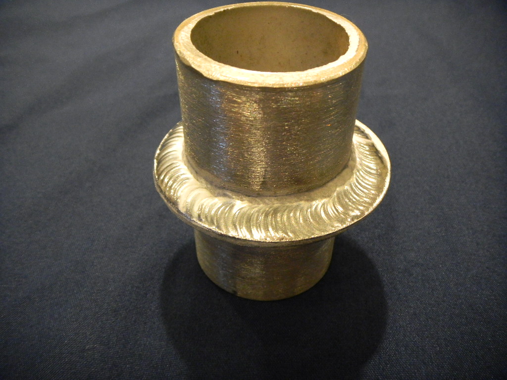

Bored to death this morning, so decided to build a roll cage for the new millermatic 211. Kept me busy for a while, now bored waitin for paint to dry! BEER BREAK!!!!!
/ Let's see your welds... #119
Paint dry finally! Just figd I would send some pictures. Quiet day here guys. Figd while the new machine was still new I would do something to help her future before I start abusing her.
