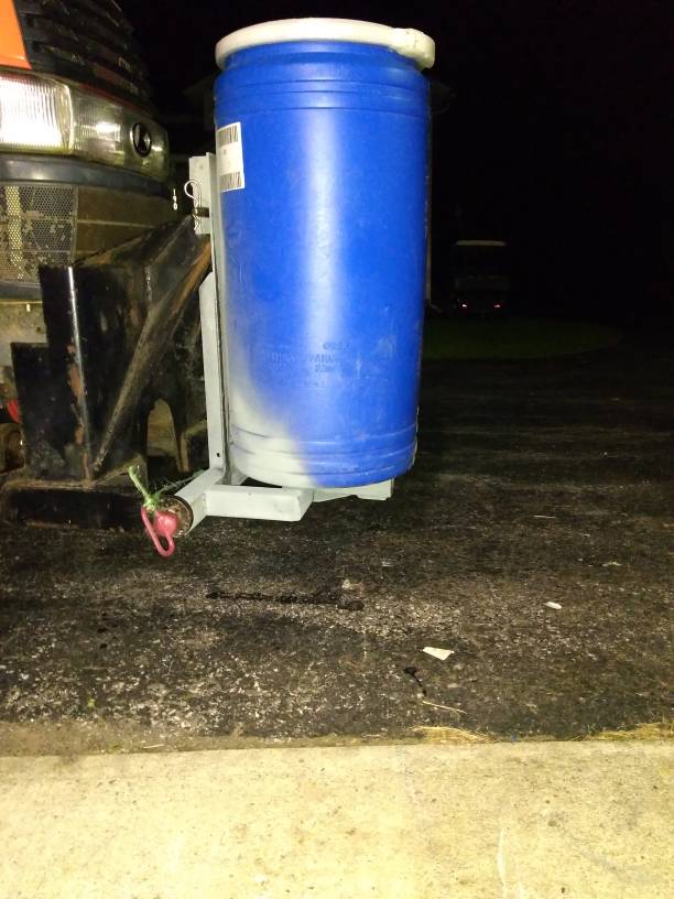

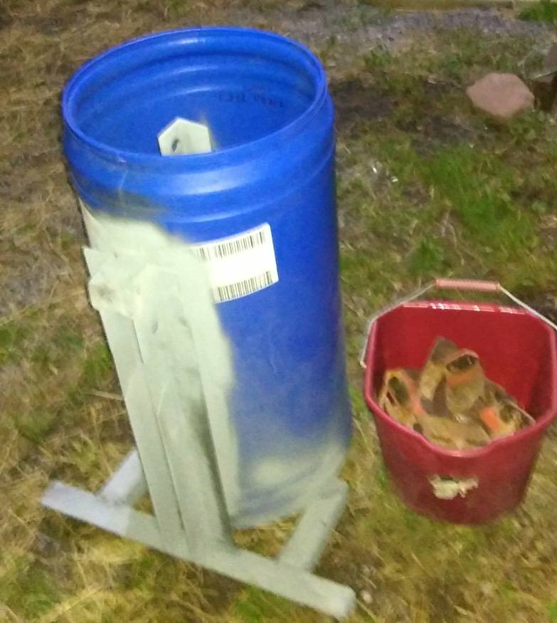

Here are a couple of the one that I made the other week.
We had someone here pouring a floor in the barn, so I had to bring a little extra to put in the barrel.
Not sure what it weighs, it's a 35 gallon plastic barrel with a removable lit. It has a handful of disc brake rotors (4?) and some steel framework in it.
It also has a full set of worn out tines from a 60 inch Kubota rototiller :D.
I left a little bit of space at the top for chain storage, there is a 2in receiver at the bottom and I may put some grommet mount lights in the top.
Its purpose is to either be on the back of the B7500, or on the front of the L3830 if we need extra weight up there (such as when moving round bales).

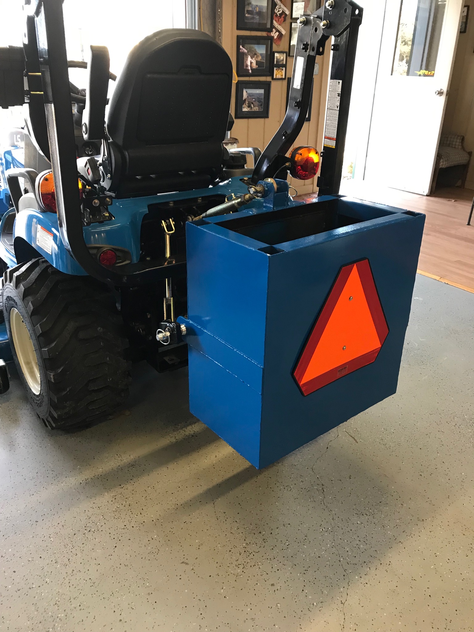

How does your tractor feel with it? Especially since itç—´ not so close to the rear. I prefer it that way just curious what you have noticed so far with FEL use.
Just installed it last night and haven't used it with the FEL yet. The ride seems more solid with the ballast on. The ballast is to replace the weight of the back hoe that I took off. I'll let you know how it works out with the FEL.

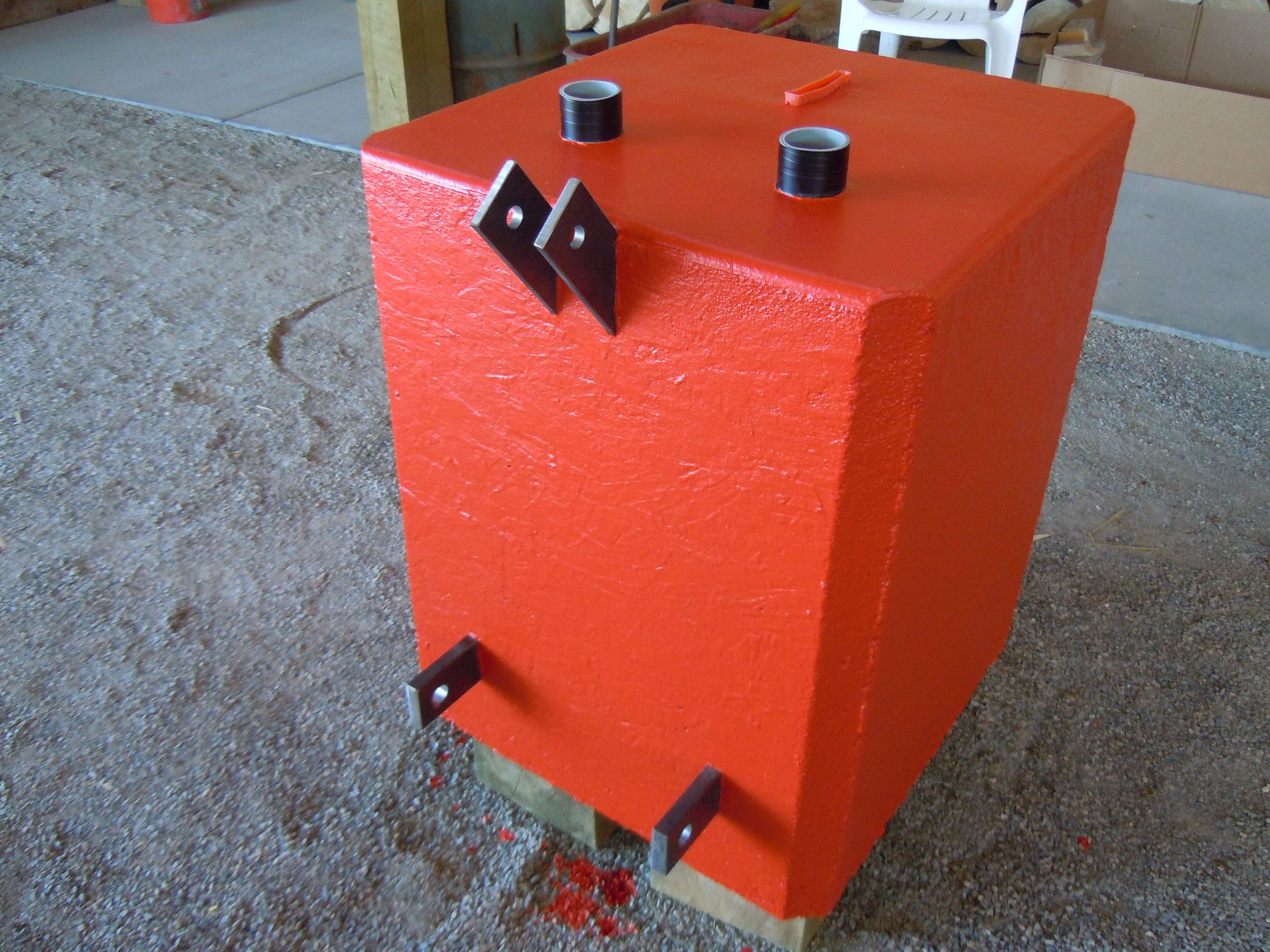

What are the dimensions on that block if I may ask?
Gotta be lots of steel in that to be 1600lb... I have a 55gal drum and solidworks tells me that it's like 1200 or so..
