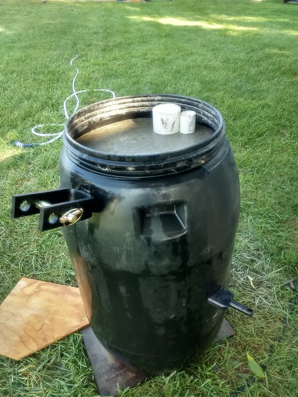

Nice. How did you keep the chainsaw sheath from compressing with the concrete?
If you were referring to mine, I used a piece of plywood. Lube it up, I had a hard time getting it out.:2cents:
I generally park the tractor in the same spot and have a wood block to rest the ballast on.

Yes, I was referring to your post and Pics. Unfortunately the Tablet I was on would not let me 'Reply With Quote' Really nice job in it's simplicity and functionality.
Having the block designed so the Hydraulics are at rest sounds great to me. It would have been a bit difficult to do but maybe some box Tubing at each corner and smaller box to slide up and down as Feet would have been nice. As you say, you have a home for it and there is a block of wood waiting for you so you are in good shape.

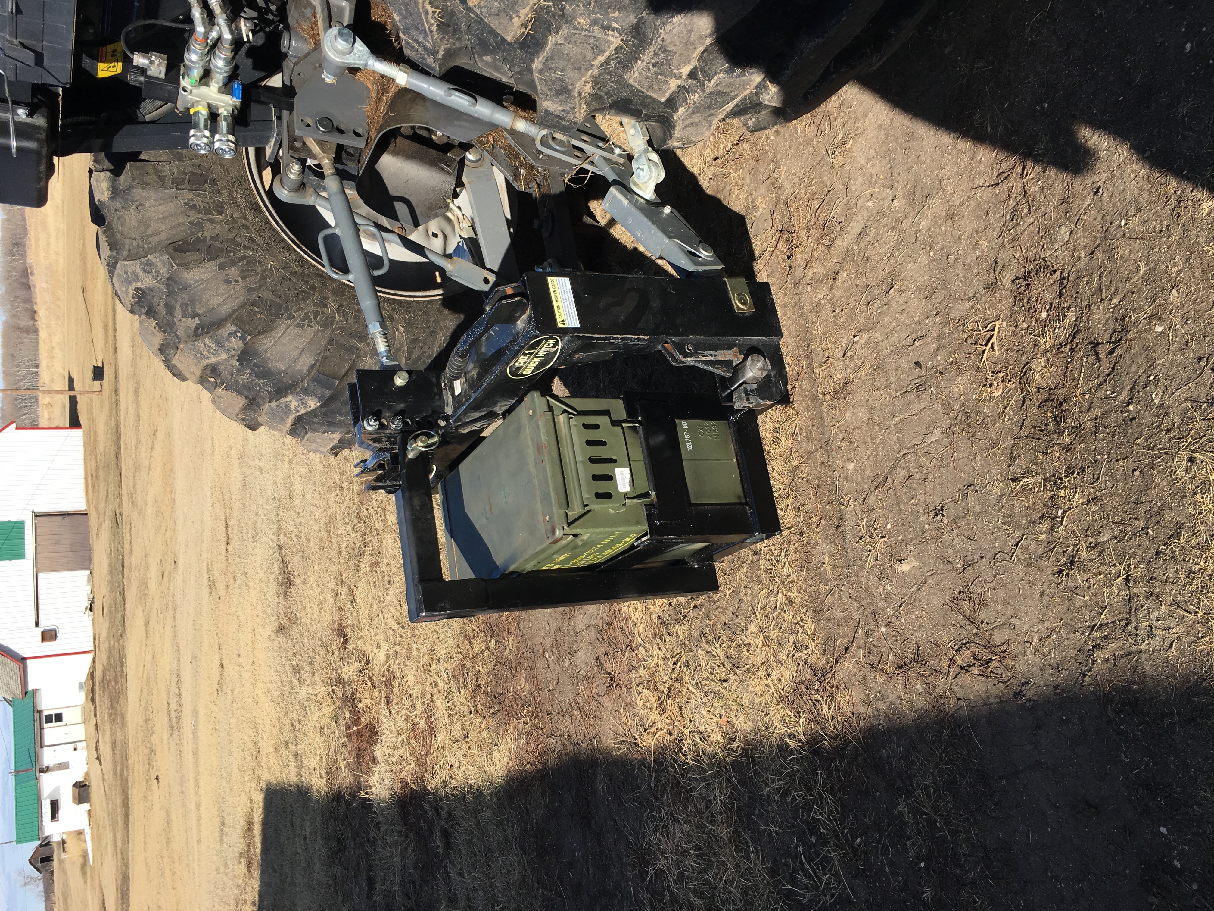

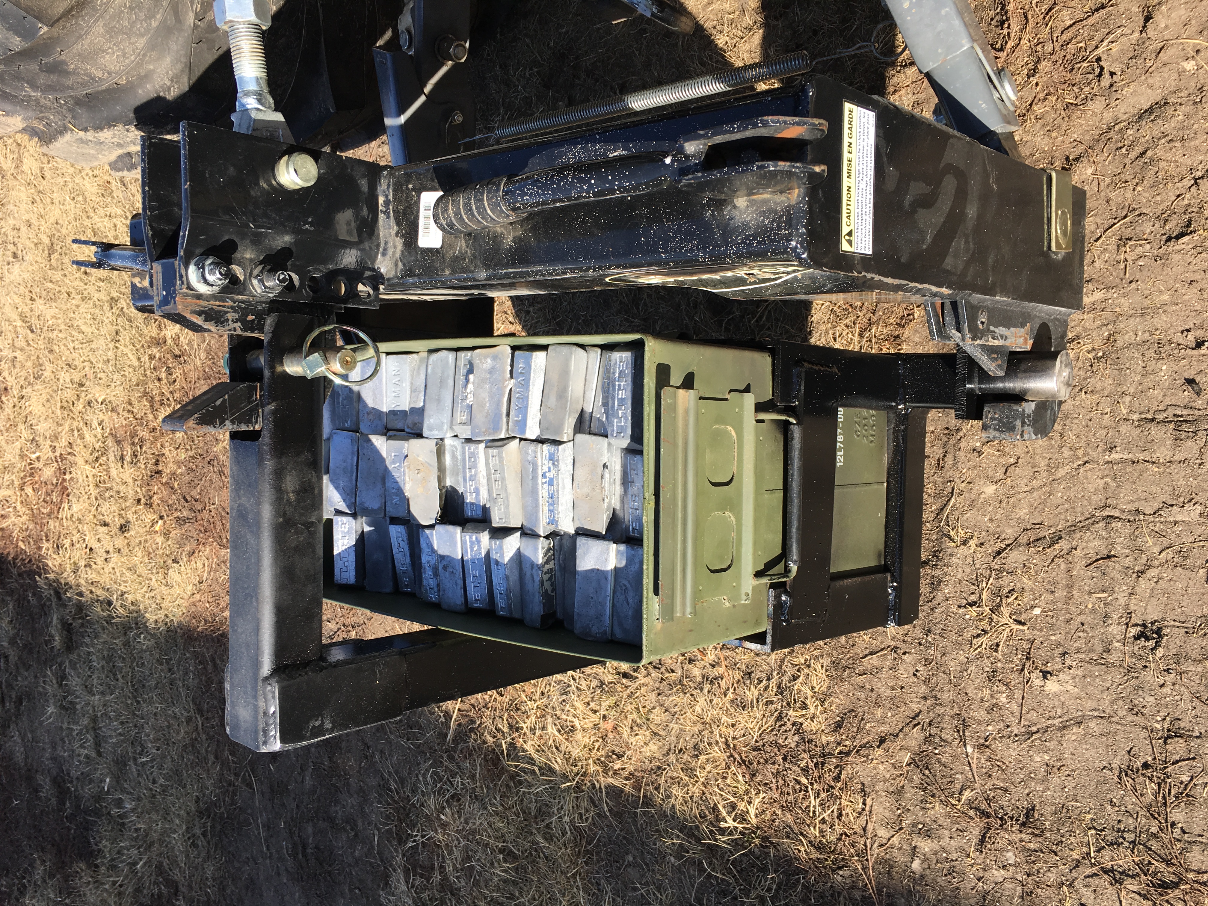

Posted this when I built it, pics never get old though. Compact size, about 600 lbs. Carries low for good cg. 60F024AC-6F71-4BD4-AE2E-5373B7D9EAA2.jpeg29101174-743C-4A05-ADF0-7C94D7C71FD9.jpeg

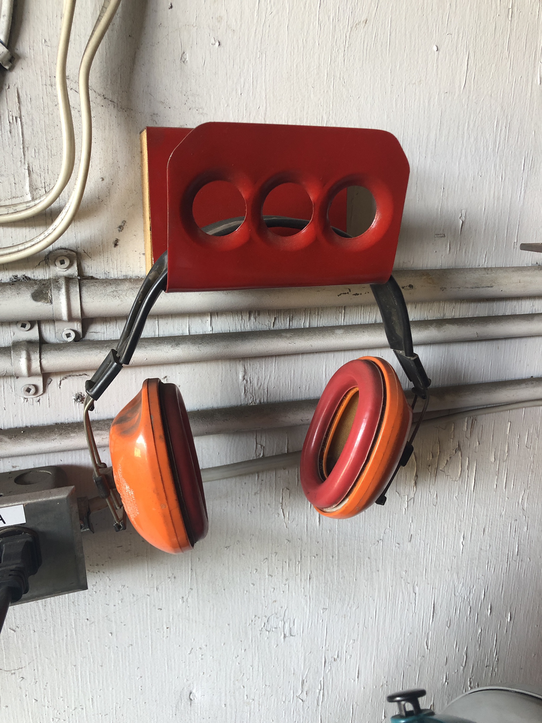

that's nice ballast it may not squeak or knock around but I wonder if it's still too noisy to have behind you
I agree. PPE a must.
