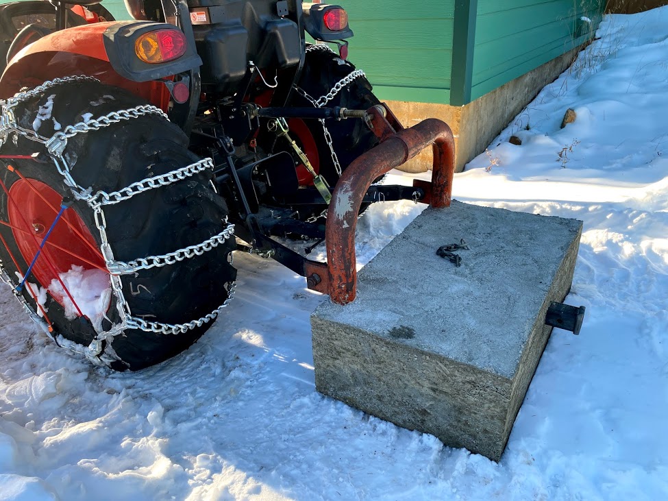

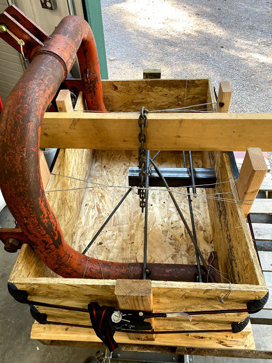

I made a 3-point ballast block for my Kioti CK3510H using the frame from an ancient 3-point scoop. I boxed that up, added some rebar, a loop of chain on top, and a hitch receiver, and then mixed up (14) 60# bags of concrete. The finished weight is somewhere between 900# and 1,000#. The block is approximately 40" wide, 23" deep, and 14" tall. The FEL is MUCH happier with the counterweight in place and it helps alot with traction in the recent 24" of wet snow we just got. :D
It's been mentioned several times in this thread but bears repeating - A CUT with a loader but no backhoe ought to be sold with some kind of ballast or at least a pointed discussion with the buyer. This tractor is strong enough to get you in serious trouble if you're doing any non-trivial loader work without some kind of counterweight in place.

Simple and very clean.. Nice

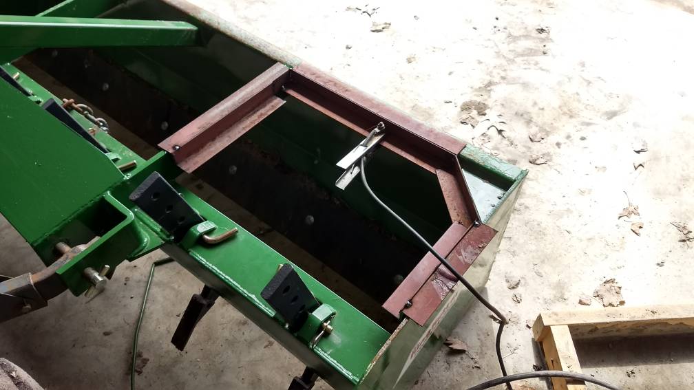

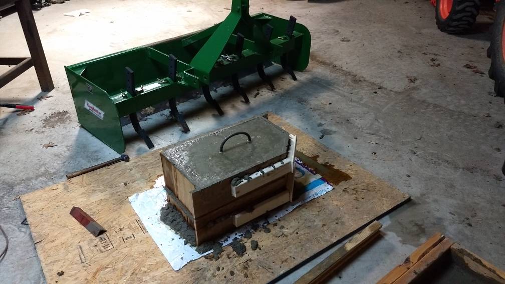

Not really a dedicated ballast, but works well. Kils two birds with one stone though - I'm always wishing for more down pressure on the box blade, and it serves that purpose well. World of difference when grading the driveway or cutting harder ground. Also works as a ballast. Each block is about 300lbs, plus 500lb bb makes for 1100lb ballast. Another 1100lbs in fluid in tires. Makes a huge difference with FEL handling.
I just welded up a frame with scrap I had laying around so it rests in the bb cavity. Piece of bent rebar in the top for easy lifting in and out with an engine hoist. IMG_20200417_120849025_HDR.jpegIMG_20200413_184807178.jpegIMG_20200420_174217993.jpeg

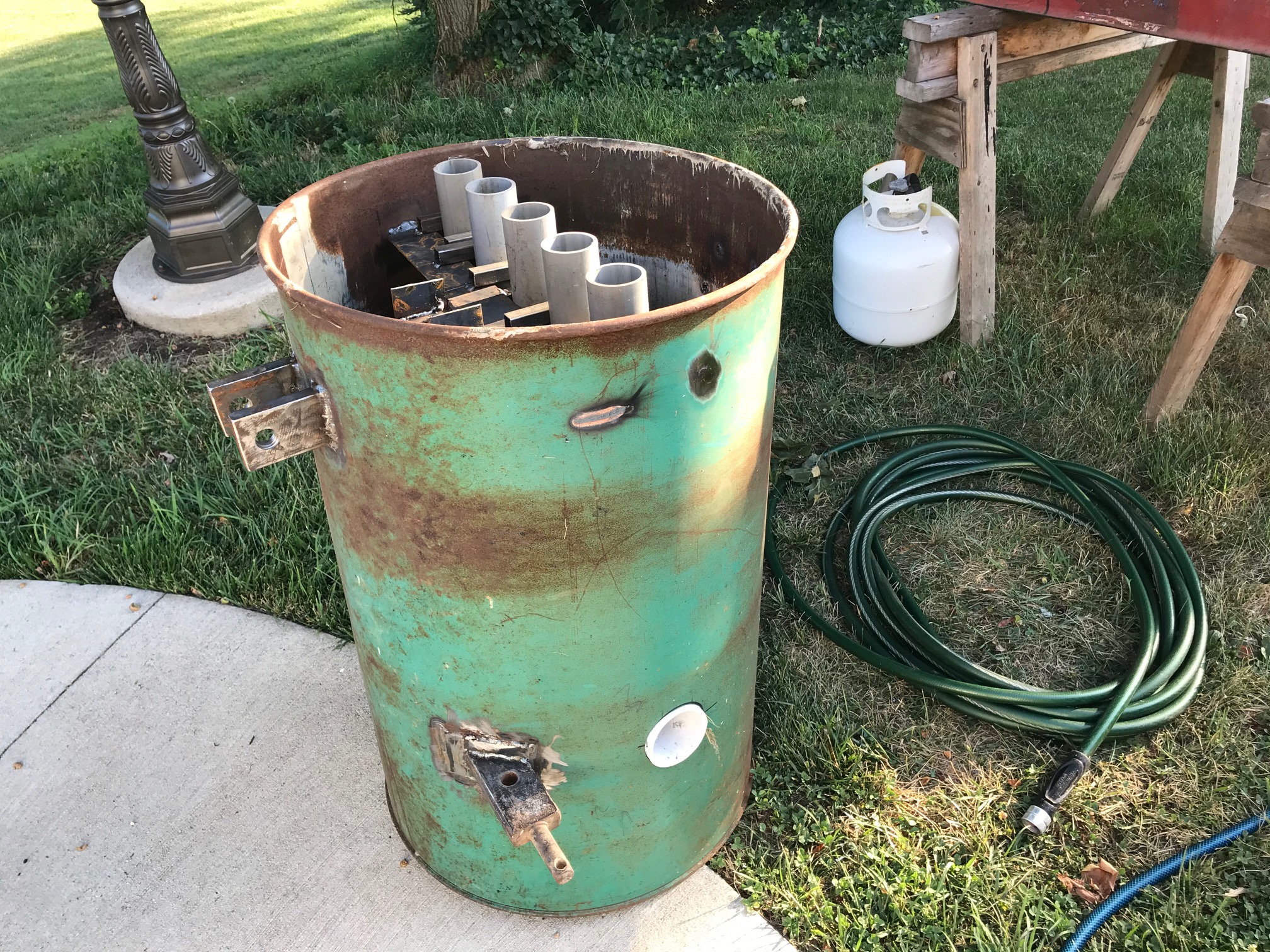

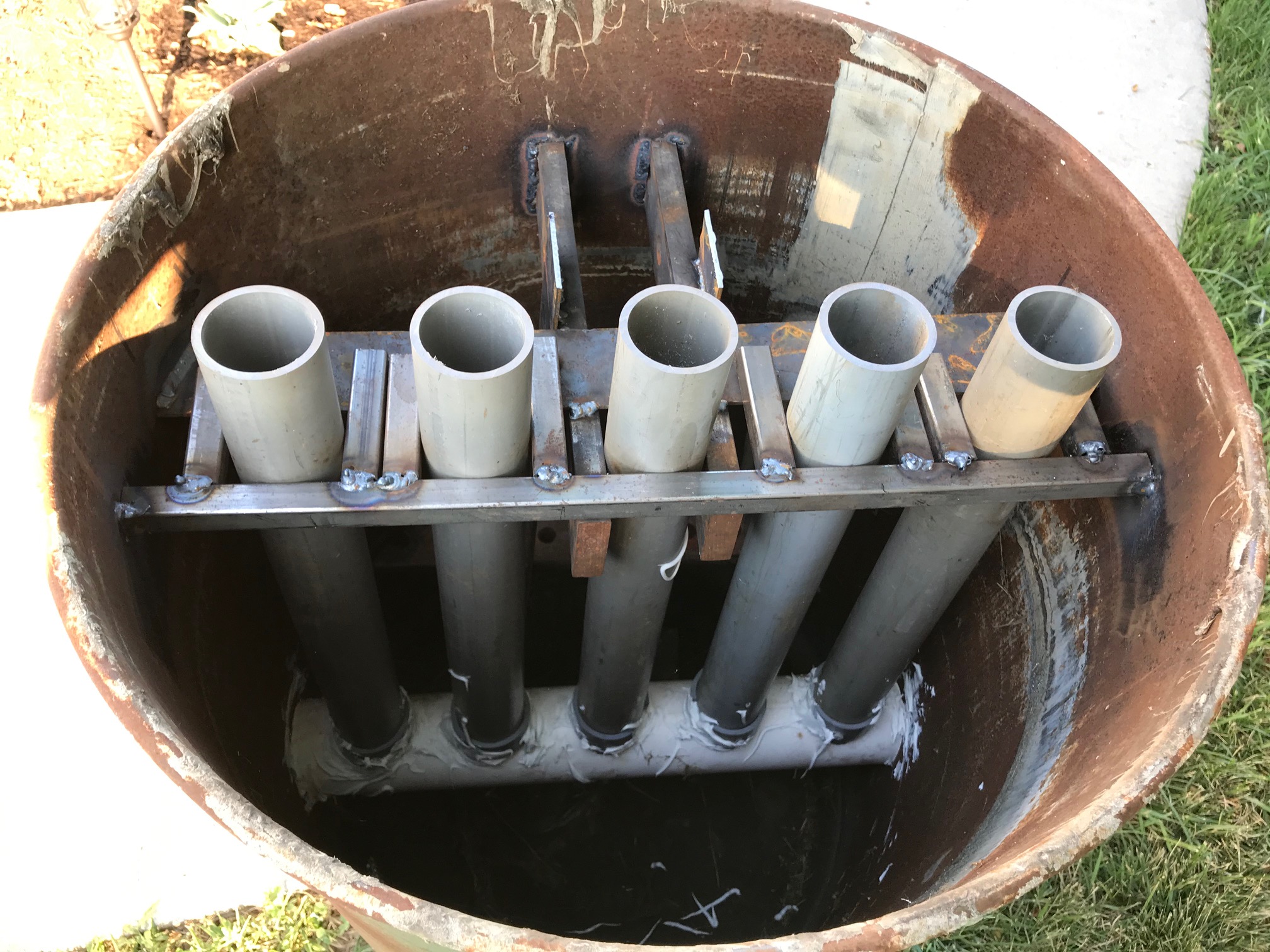

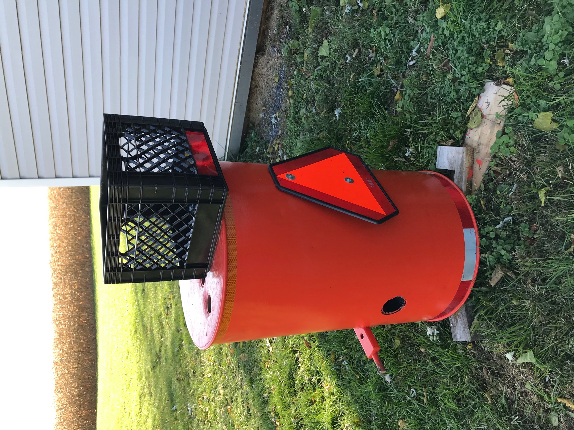

Built this for the 4240. I was looking for a 55 gallon drum and found a smooth-sided one at work. Brought it home and did the steel inserts and PVC tubes for tools. The bottom tube acts as a header to facilitate cleaning the vertical tubes. After concrete and painting I added a milk crate for hauling chains, slings, etc.
hmmm, it's happening on some posts. All I see is a "attached thumbnail" at the bottom of page. No pic and if I start to click on it... Nothing
Yet jshwhites pictures come right up. Not sure what's happening

Nice! I'm always amazed how much better the tractor rides with the weight.

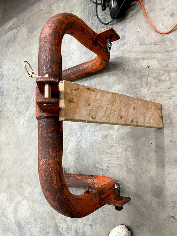

Super nice and simple but you might want to consider afixing that drawbar to the square tubing somehow. once that gets bouncing it's going to put a ton of stress on your 3-point linkage. Just something to think about...
:thumbsup:
Howdy.....you said something that made me ponder.....how would you afix the tractors drawbar to the ballast or the 3-point ? I mean the ballast/3-point is going to travel up & down as the 3-point is raised or lowered. Kinda trying to picture what you said. can you elaborate?
