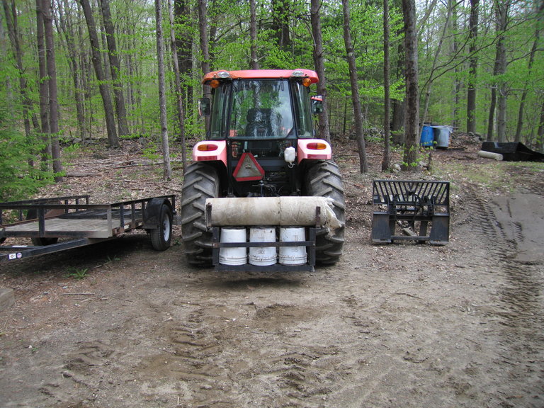

After standing the M on its nose trying to move a ginormous boulder, I decided my initial ballast was really way to light so I added a rack on top of the original and laid in this former concrete pier that used to hold up a corner of my old woodshed [now reconstructed with new foundation].
I know ideally, ballast should be at or below the rear axle line but this was the how it mounted.
I figure it is now about 800 lbs.
You can see its partner laying behind on the bank

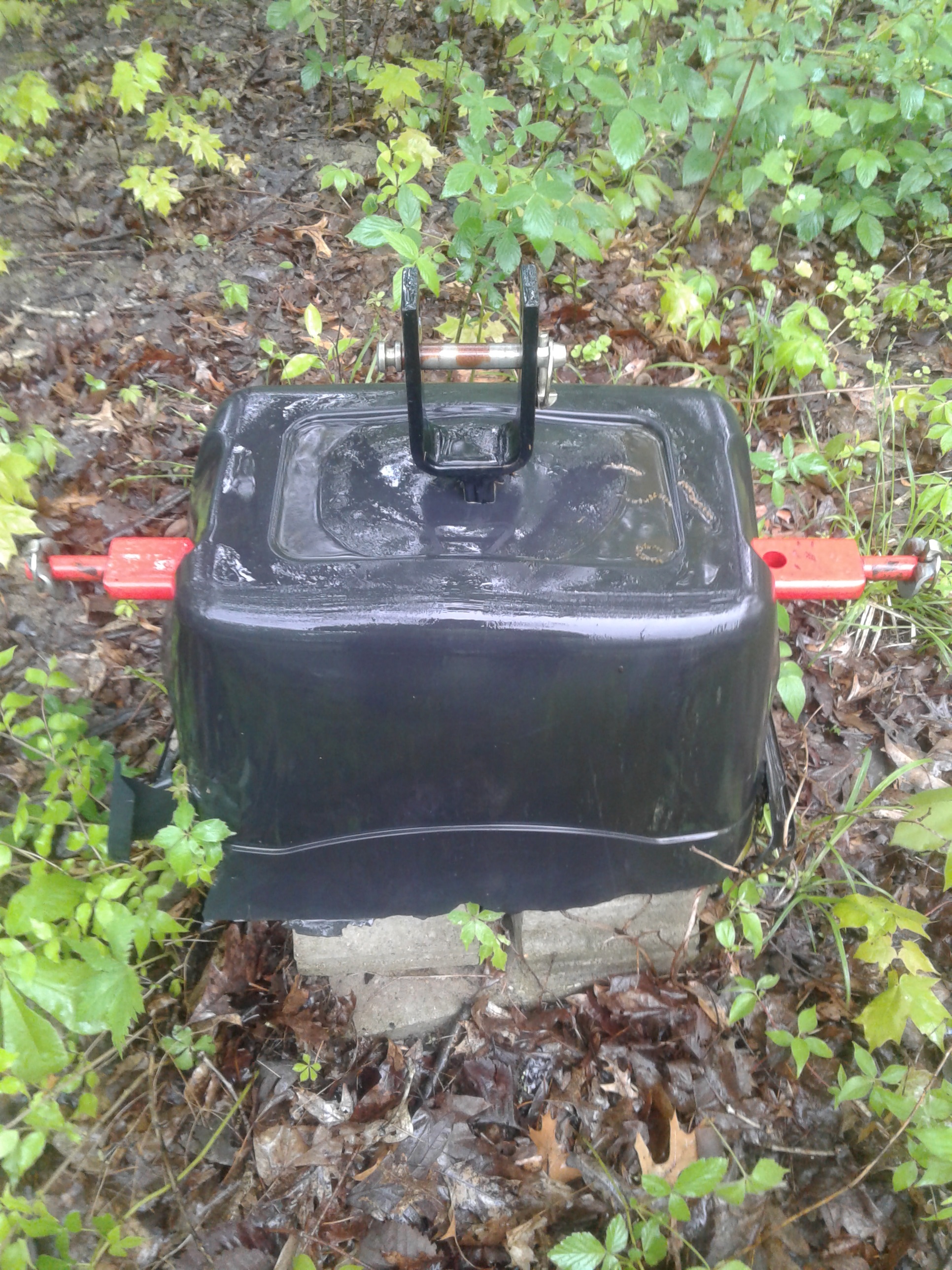

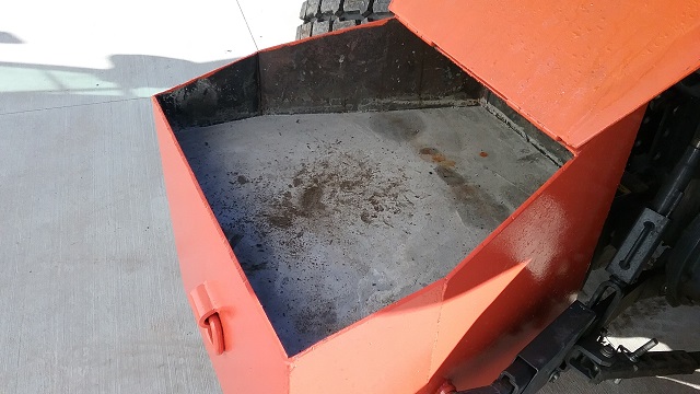

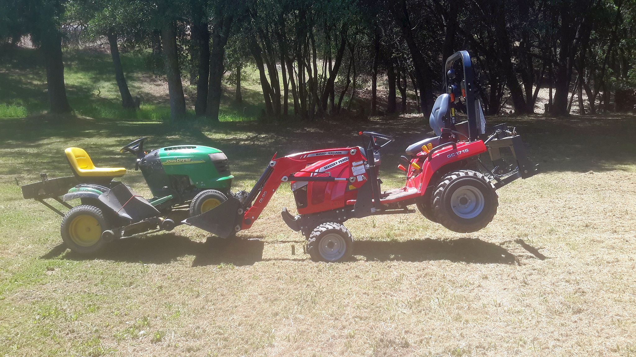

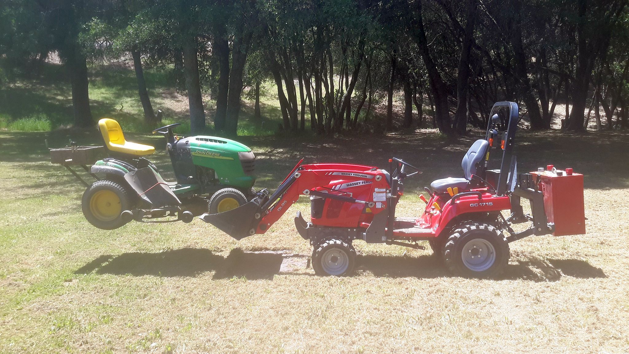

This is what came with my FEL for my SCUT.... Seems it would apply to larger tractors too..... Only issue is one needs a scales to do calculations, unless you want to trust factory weights...
A 400 pound (+/-) ballast box seemed to cure this problem when lifting a 520 pound JD dead Deere...
Dale
Umm correction, ballast box is about 550 to 600 lbs... Box is 4 cu-ft and one cu-ft of concrete is approximately 150 lbs...
Dale

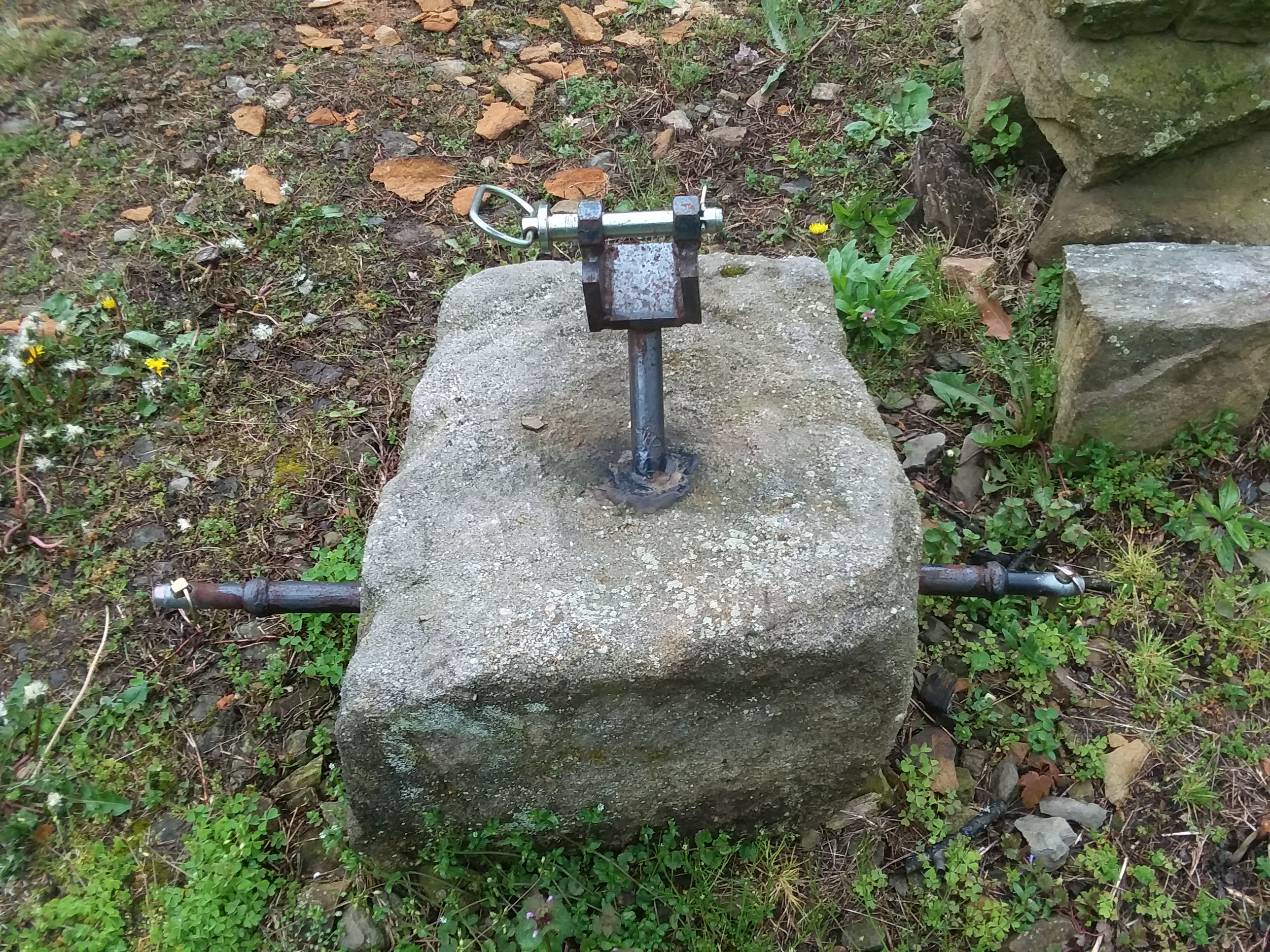

this is my flintstone model 150
