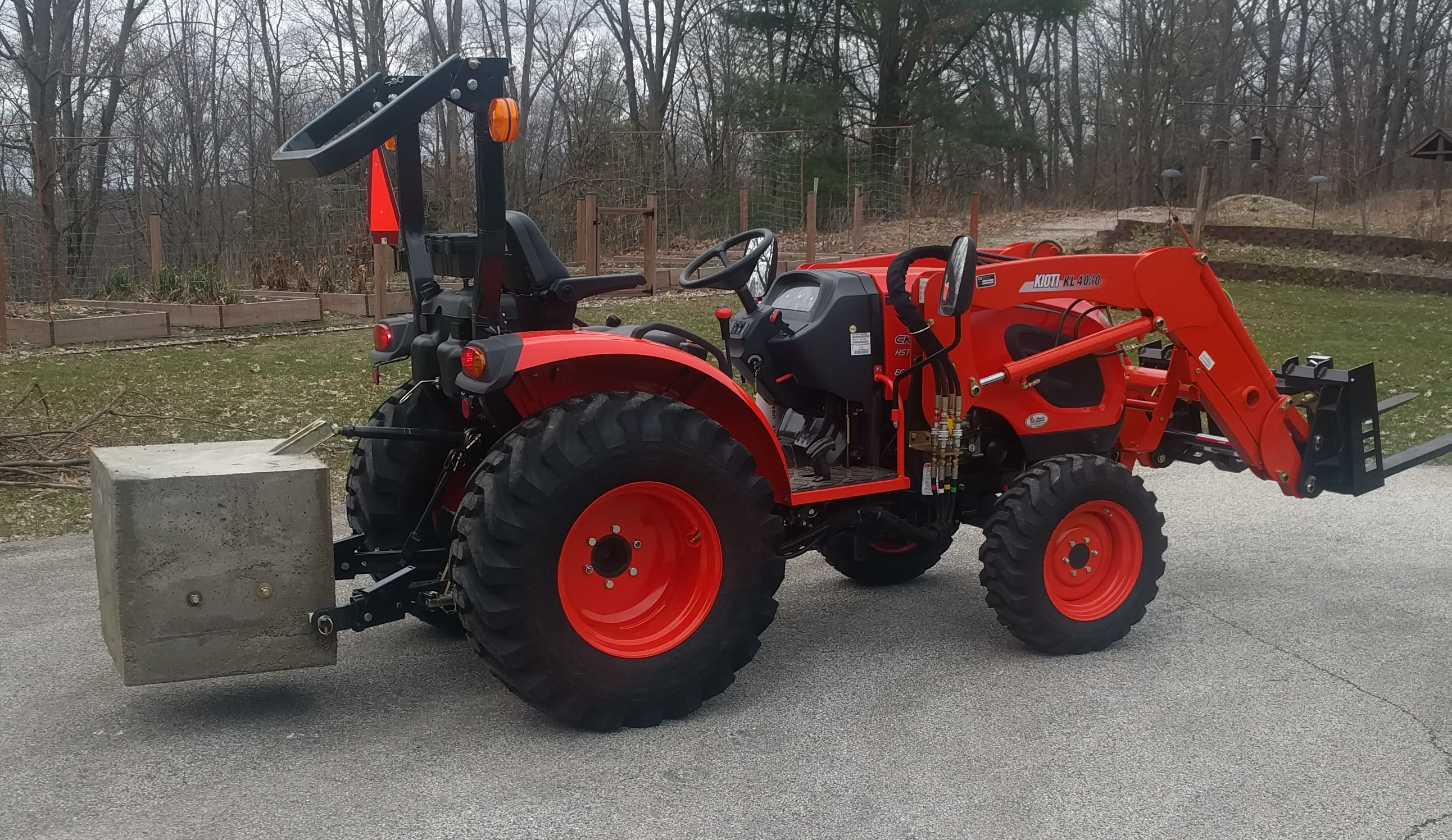

Here's my recently completed ballast. It's a 2ft cube with sixteen 60 lb bags of concrete, rebar, several disc brake rotors, angle iron and some other stuff. I'm guessing total weight is around 1300 to 1400 lbs. When I bought the tractor I had them not fill the tires knowing that I'd need ballast of some kind. It was kind of neat seeing the contrast between trying to scoop up dirt with and without the ballast.
Great job. Kitchen sink in there too? I like how my tractor squats a bit and feels much more stable. Enjoy.

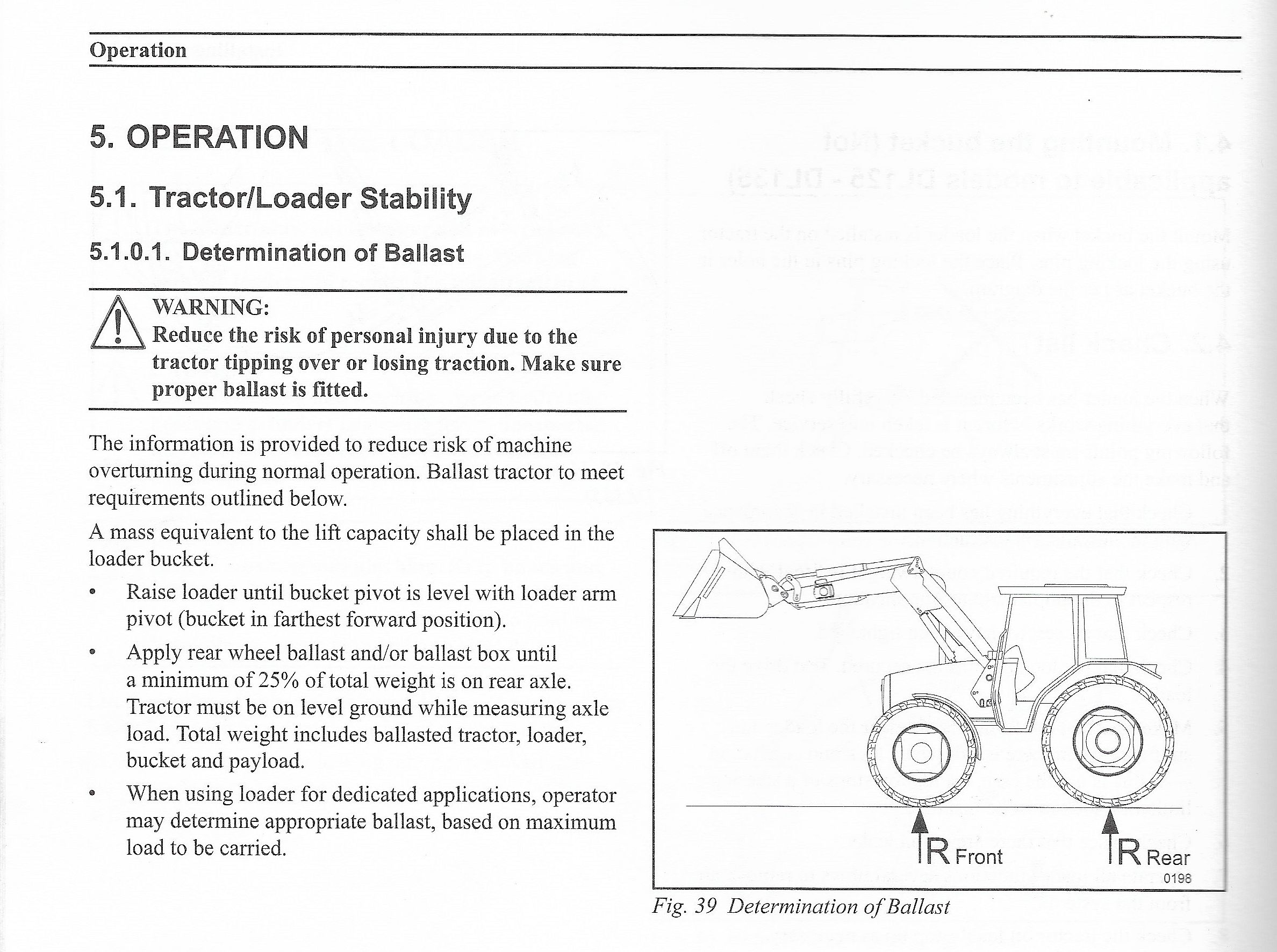

what is a good calculation on what you need for ballast? should you go 75% of your FEL capacity? Or does it really matter what you're lifting? Should it be somewhat the same as what your lifting or just a helper of maybe 50% etc.
   / Let's see some homemade 3 point ballast! #183
This is what came with my FEL for my SCUT.... Seems it would apply to larger tractors too..... Only issue is one needs a scales to do calculations, unless you want to trust factory weights...
A 400 pound (+/-) ballast box seemed to cure this problem when lifting a 520 pound JD dead Deere...

streamin:. So many options. Let me share my own observations.. My tractor data says it can lift 2600lb at my FEL pins and at my 3Pt. I made my counterweight/ballast about 1300lbs. I had it poured at the local ready-mix and they set the pallet and forms on my trailer. When I went to remove it from my trailer with my tractor pallet forks, it was a bit of a reach...about 3'+ out on the forks from the pins. My rear (loaded) tires lifted instead (pucker)!! I dragged the pallet to the back of the trailer (dangerous) and then I could lift my counterweight with the forks.
So... I learned that with ballasted tires, but without a counterweight, my FEL limit is about half the quoted amount. With the 1300# counterweight on the 3pt, 2' out, I feel much more stable with a load in the FEL or on the forks. I could/should have made it between 1500 and 2000 lbs.
I hope that helps.

The believe the rating in the specs(2600) is based on the strength of the loader arms and the hydraulics/cylinders. It does not factor in the front to back stability. Some have commented that a good dealer would never let you off the lot without a heavy rear implement or a counterweight.
As for the tire ballast, I had mine filled from day 1 based on advice on TBN to newbie tractor owners. I do not know what it would have felt like and how it would have operated empty. I suspect it would have been scary and does more than I know. Ballast is not the same as counterweight - 1300lbs stuck out two feet behind the 3pt has way more leverage.

Ballast in the rear tires does help, but the pivot point for that weight is the front axle. 3pt counterweight on the other hand pivots at the rear axle, helping to unload the front axle while holding the rear down.
