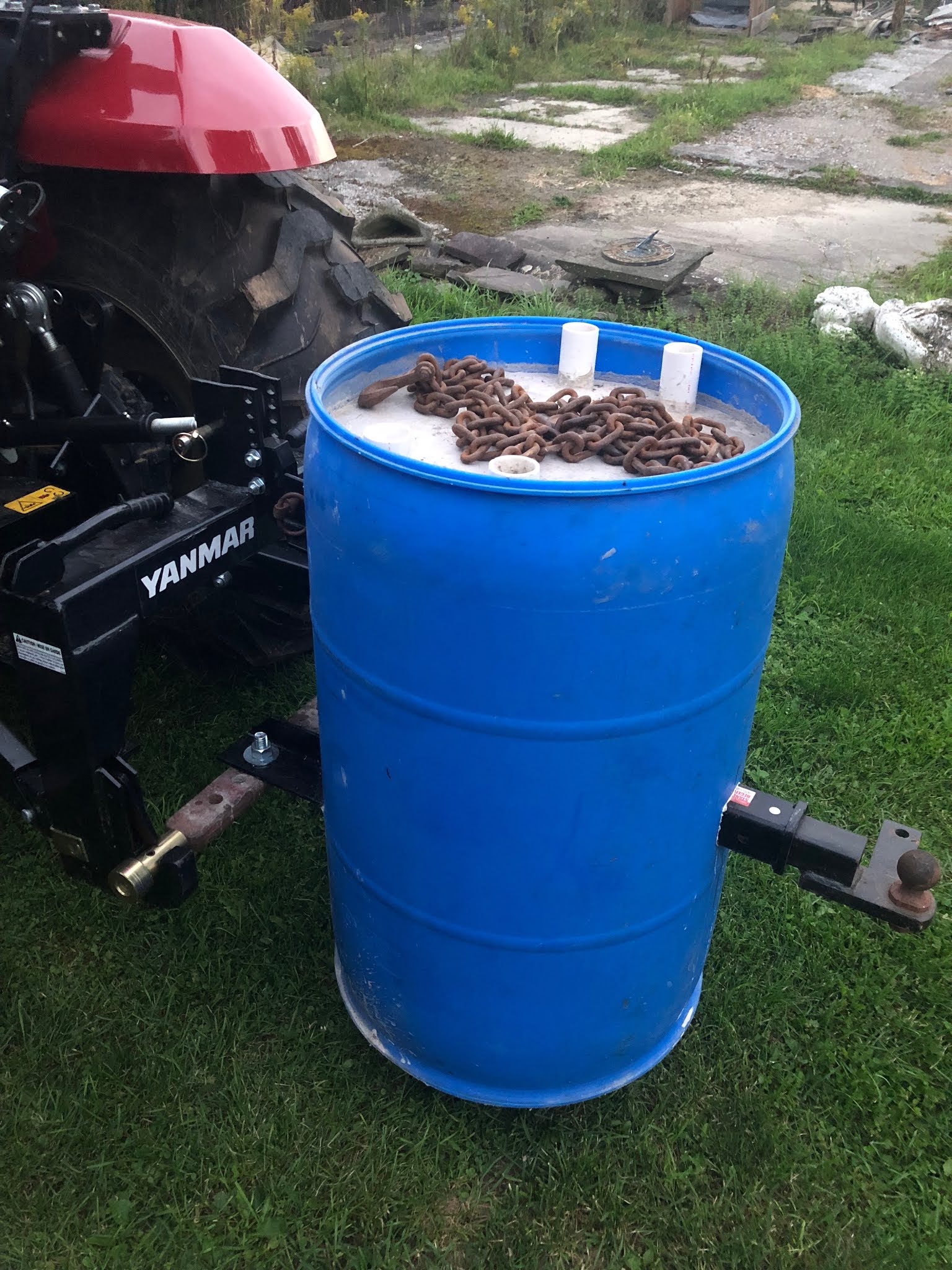

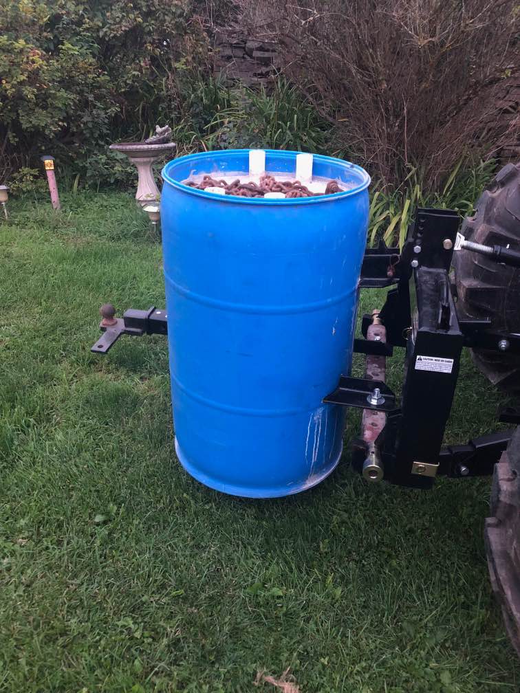

Finished the ballast. 11 80lb bags of cement. I should have mounted the receiver a little lower, but it will do.
   / Let's see some homemade 3 point ballast! #69
How does your tractor feel with it? Especially since it’s not so close to the rear. I prefer it that way just curious what you have noticed so far with FEL use.
   / Let's see some homemade 3 point ballast! #70
Using cad, mine calcs out to 1164lbs.
Yours would be 880, plus some steel and the barrel, so maybe 900...
I wonder why mine is so much more. I guess the dimensions of a steel barrel are that much more? Surprising...
Anyway, good job. Looks just like mine, and I sure like it. I've borrowed the drawbar off of it a couple different times.
