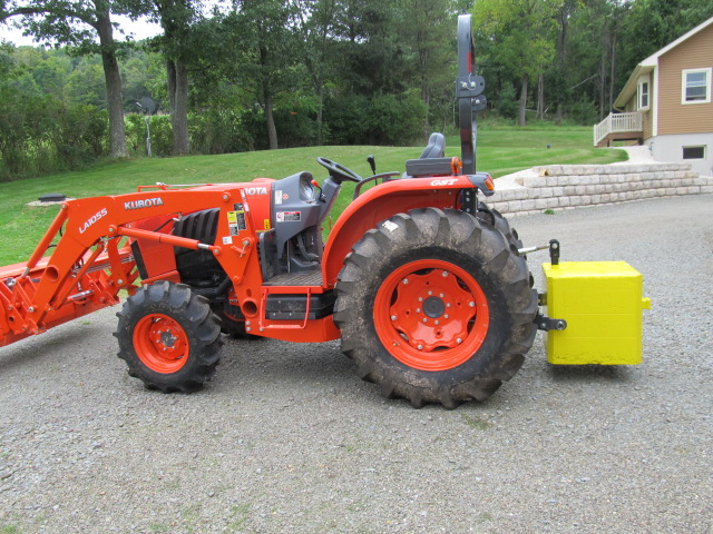

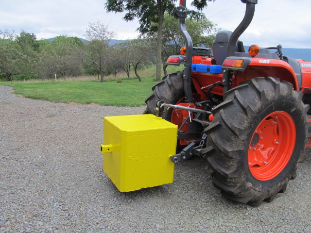

My 2' x 2' x 2', (4 cubic Ft) concrete block, w/2" trailer receiver hitch cast in. (12-13) 80# bags of Sakrete, approximately 1150# with hitch iron in the block.

I like the yellow! I may have to color mine up one day..............................
I painted mine yellow because every year some of my loader works involves being on a secondary public road and I want high viability for my tail other than just a SMV emblem.
I'll say. Some tractor branded ballast boxes are priced higher than that and not near as sturdy. Nice find. But it would have been just a little to large to suit my needs.
Totally understand that. Since you have a receiver hitch there you might could add a light bar for even more visibility. People are way to occupied these days instead of watching the road!!

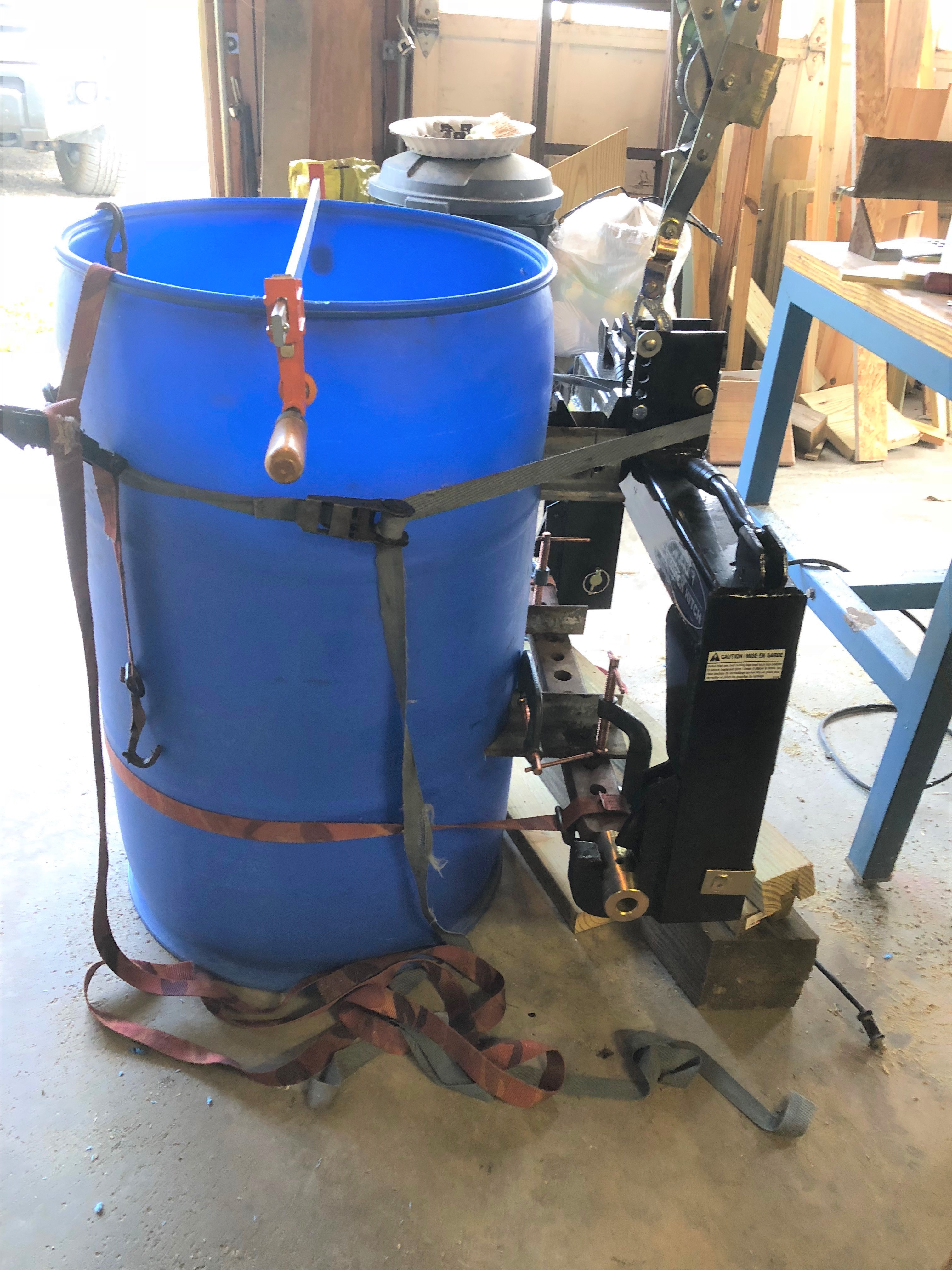

Started my ballast project yesterday. So far I've used scrap that was laying around the house. Plan on putting in 4 PVC tubes, a receiver hitch and maybe some concrete anchor bolts sticking out the sides for hooks. Will probably leave 6" on top for chains or tools.
