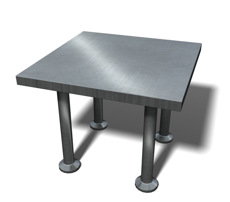

Today I was digging the piers for a lean to I am building on to my shop. It is going to be 24' wide and 50' long. It will have six columns supporting the roof made out of 8" I beam. I plan to use weld plates like the attached picture and weld the I beams to them. I am not sure what is best if you are using wood posts.
My question is how big do the piers have to be? Digging the holes with my backhoe they got pretty large in area in order to get what I thought was adequate depth. Thinking of maybe sticking in a sonotube and backfilling with dirt to reduce the size.
What you can do is figure out the maximum dead loads and snow loads the roof supports (will be in psf) then multiply by the roof area, then divide by two and again by six. That is an approximate estimate of the weight each column would need to support if everything was even (you can add a factor of safety based on unknowns, or just do like me and assume slightly higher dead/snow load than is usual). That number will be in pounds. You can again divide by the area of the footing to get psf or psi and see how that compares to the soil bearing capability where you are. Will require knowledge of the soil type and its specs. Another way is to just look at what other people have done in your area and determine if that's good enough.
If it's open to the elements, you will need to consider uplift resistance too, as well as possible side loads from wind. I had to get engineering done for my pole barn footings to satisfy the building inspector, and the biggest issue was not direct uplift, it was sideways loads allowing the poles to push over in their holes, which then led to uplift failure. For that reason, we were unable to backfill around the poles with the spoils from digging the poles, but rather had to use concrete (just dry mix, no water) to backfill the holes all the way up. All along I had though pure uplift was the main concern with pole barns, but the sideways loads were the weak link for my soil type.
For one lean to I saw built in my area, they used a backhoe to dig open the holes, then poured concrete about 12" deep (with rebar) to get a nice big flat footing. Placed the pole on top with an anchor, and then backfilled around the hole. No real need for a sonotube in that scenario.
