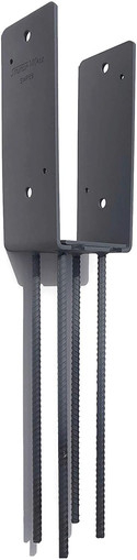

Prefab pole barn posts with a concrete base seem to be gaining in popularity (see image below for reference).
With building material so scarce and prices so high right now, I've delayed my pole barn build. It's not a must have, so it can wait. But I'm also thinking I could use the delay time productively, and cut my own posts on my saw mill. The issue for use in a build, obviously: Not treated lumber.
I was thinking of cutting 6" true posts, drilling the base of the pine vertically for a piece of 1/2" x 4' rebar, leaving 3' of the rebar exposed. Then, I would attach a concrete pouring form, 6"x6"x42", to the bottom of the post and pour in standard, 4000psi Quikcreate or Sakcrete. The rebar would be center-suspended in that mix and provide both lateral and vertical adhesion between the concrete and the post, and keep the pine off the ground when placed in the post hole.
Thoughts? Any reason that can't work?

How would that provide any vertical adhesion? It would keep the post form sliding horizontally, but what would keep it from lifting off the rebar?

What is your thought with the rebar?
What is it's purpose?
Threefold:
Resist lateral loads
Resist vertical loads (the rebar is hammered in snugly, with some construction adhesive in the hole)
Reinforce the concrete

Why not just use something like this sturdi wall plus?
Budget build.
For the price of one of those, I'm 85% of the way to a 16' 6x6 PT post, or halfway to the cost of a 20' 6x6 PT post, which I can use in a traditional, in-ground install, and the barn will likely last longer than I will.
I do love the looks of those, though.
If you've ever hammered 1/2" rebar into a 1/2" hole (with a sledgehammer)...it takes a lot of force to drive in. Would also add adhesive to the hole.

I'd be very surprised if rebar pounded into a wooden hole with adhesive were an accepted practice by code because the load pulls with the grain, not across it like bolts through brackets. Think about it. If you drive a nail into end grain, it is very easy to remove. If you drive it across the grain, it is less easy to remove. Maybe it's acceptable? I do not know. I think I'd use the brackets. They add more strength.

Budget build still requires sound practices.
I built a 24 x 24 garage addition last summer. After getting quotes for $6K on concrete I did it myself for half. Lumber, siding, roofing, fasteners etc., were $5K and I did all that myself as well. It was a budget build. I still had to follow code and sound building practices. Some things you can't skimp on.
It might be 'good enough'. I wouldn't do it.

The OP is in GA. That means there is a good chance of a hurricane or tornado. If you build this to code you must account for the up lift as well as the downward pressure. Even if you have no codes to follow you would want to follow good building practices. A piece of rebar stuck into the end of a 4 x 4 pt post will rate about a zero on the uplift scale. The connector that MossRoad posted is an outstanding way to tie the posts together. There are times to be frugal and there are times to bite the bullet and spend the money. Making the frame of your barn as strong as you can is a wise investment.

Don't forget that wood expands and contracts based on moisture (humidity). As it does this it will crush the fibers in the wood and loosen the grip on the rebar. Eventually it will be loose enough to slip right off. For an example, take a look at the j-bolt embedded in the concrete to hold a sill plate. Tighten those nuts down and a year later you can tighten them some more by hand.
/ Homemade, prefab, concrete and pine post #13
Just make your own version of the sturdy post steel base from 3/16~1/4 x 5 flat bar and #3 rebar in 2.5" sq pattern. Need to have a press brake to bend the flat bar and a welder to assemble rebar cage. 9" diameter post hole 3' deep (not much frost line in GA). 6x6 Square form the concrete above grade 1.5~2'. Through bolt your rough sawn 6×6 timber post. I would personally use 4' rebar rods to get any bending or tensile loads below grade.nerd to rent or purchase a 8~10' concrete vibrator.

No matter what solution you choose for the rebar application for the concrete, I whole heartedly concur that you need to get your posts setting above grade, and the finished floor. If you raise the footings to 18"-24" above grade, you'll drastically reduce the probably of termites visiting.
Also, instead of cutting 6"x6" posts with your sawmill, cut 2x6's and laminate 3 of them together, alternating grain patterns. This will likely prevent warping or twisting in the posts over time. And you can inset a beam in the top of it, to carry your trusses, or rafters.

Your post brings to mind another potential advantage of the 2x6's laminated: The middle board could extend past the bottom of the other two boards and could be cross-drilled for a piece of rebar, 6" wide, to provide vertical load resistance.
