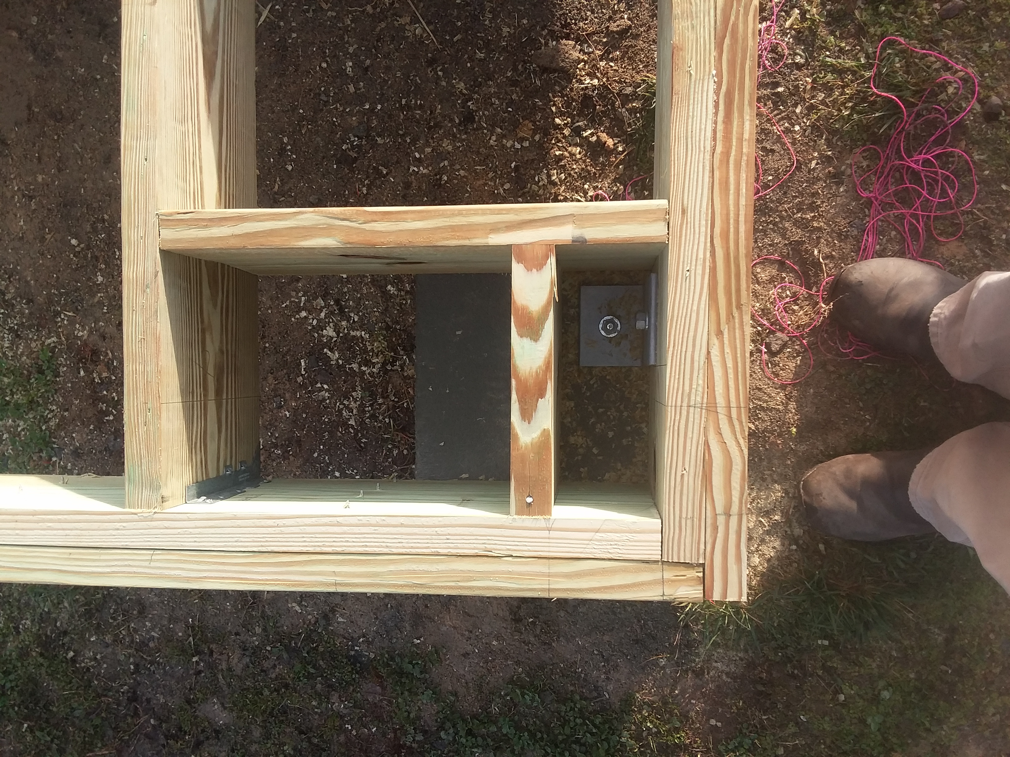

The guy that built my trailer had some 3-1/2"x5" angle. Had him cut 4" pieces and pop a 1/2" hole in each leg. I think that will be plenty strong.

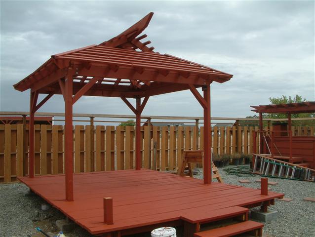

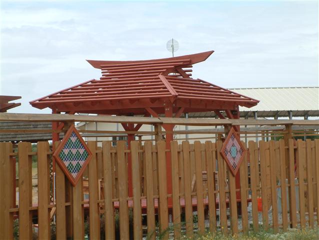

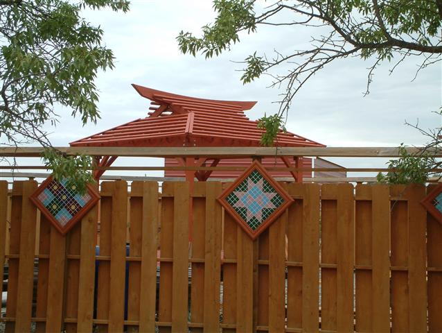

Here's a gazebo I built about 10 years ago.
I poured concrete footings with embedded Simpson post brackets for 4x6 lumber.
Good luck

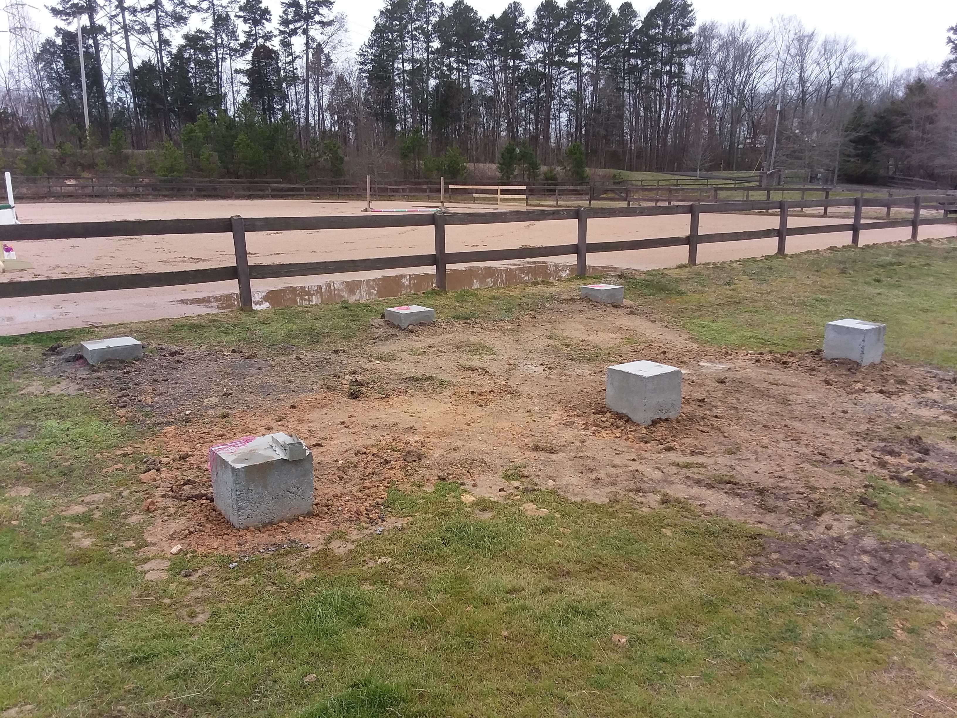

Now trying to decide on Sonotubes or building a square box and pour the entire thing with concrete. That way if she wants to cover with rock later its possible.
/ Gazebo/ Judge's Stand

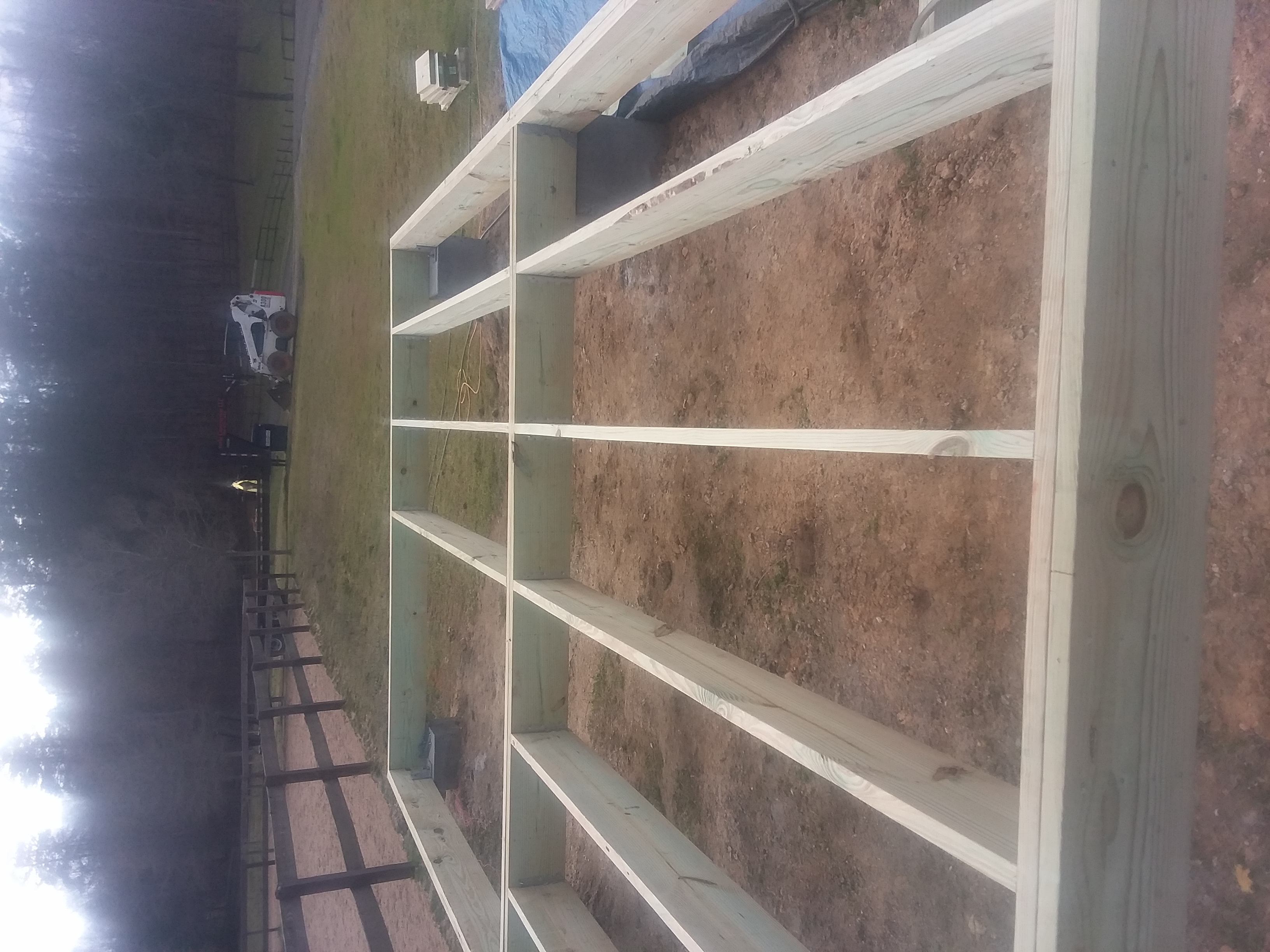

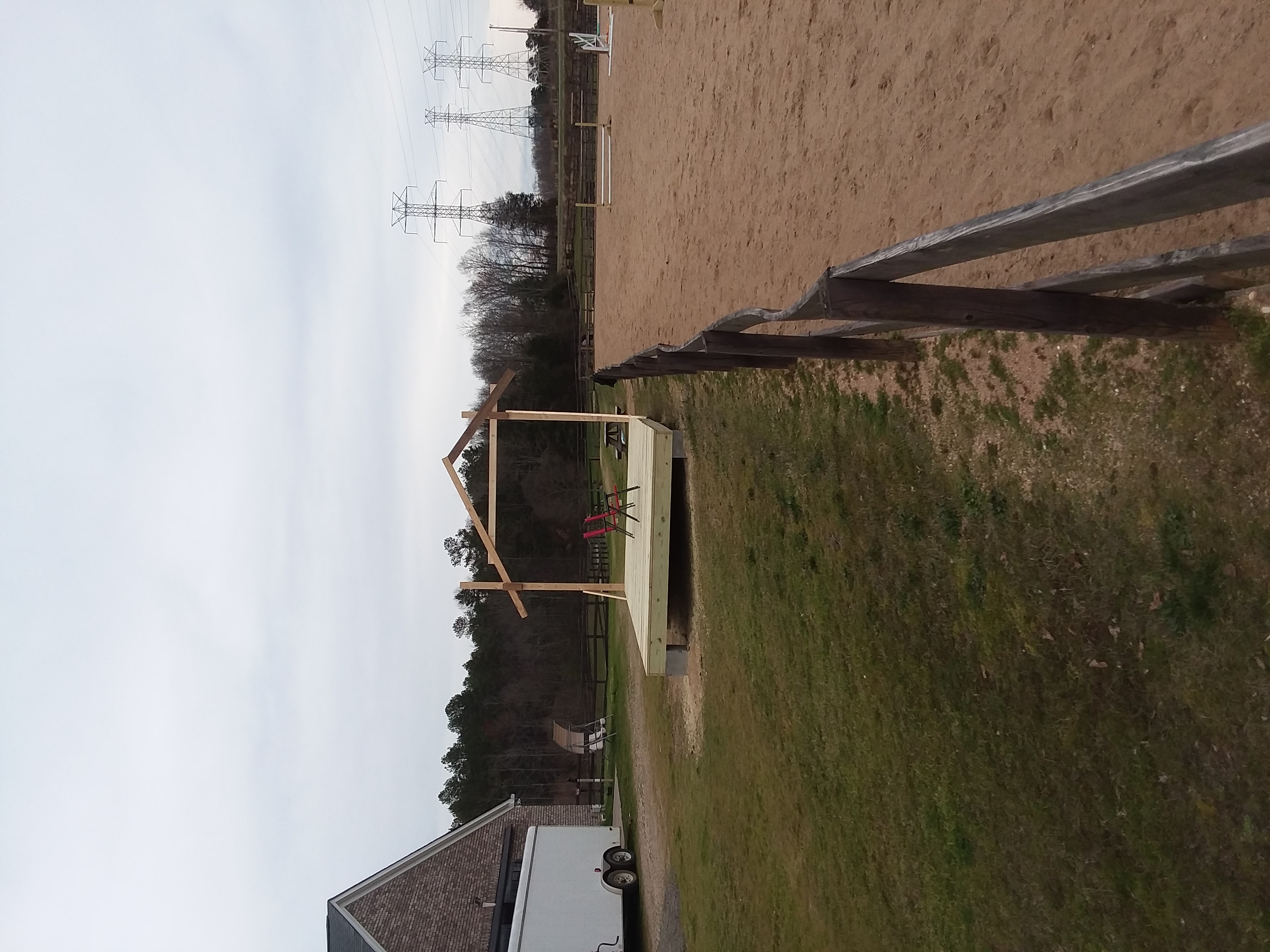

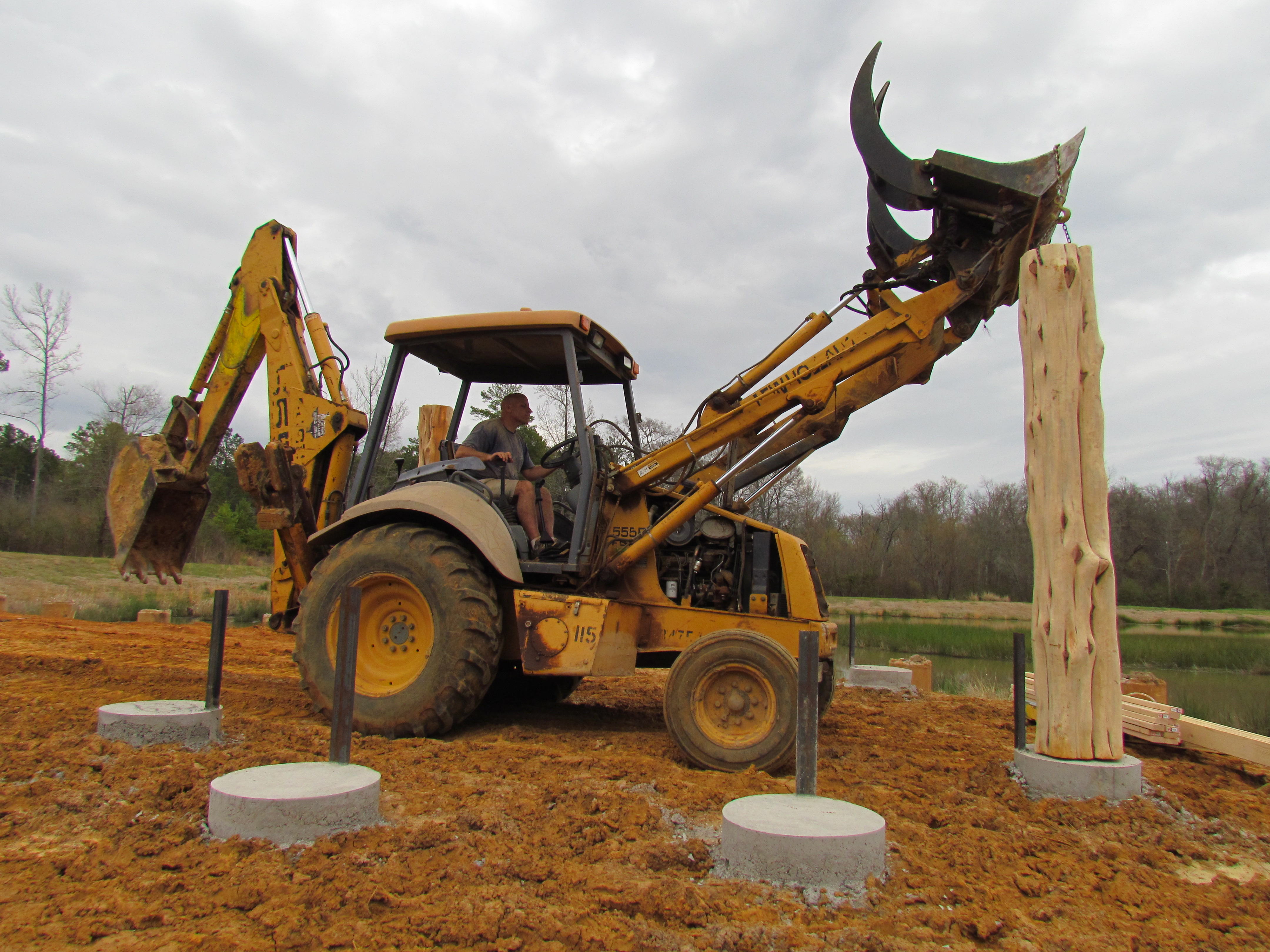

Finally got started on this. Seems its trained for 3 days every week. That and my fire dept schedule havent helped. So bored 15" holes 3' deep and built 15" square forms. Used pea gravel aggregate in concrete. My trailer guy cut some 3"x5" angle for me. Did a mock up of roof so customer could get an idea what it looked like.
#9
Waiting on metal.
