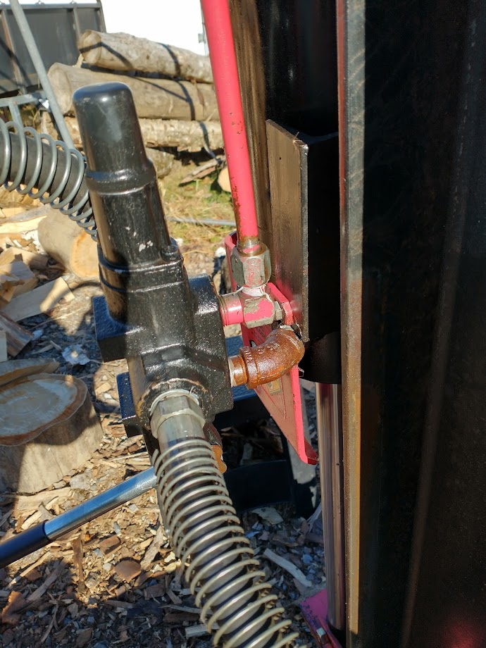

Called the auto parts/ best hydraulic parts shop, no high pressure black pipe.
They suggested Lowes or Home Depot.
How do I ask for such a thing?
/ Leaks are Driving me .... #22
You need hydraulic fittings not black pipe. They're made for the pressure. Log splitters often run at higher pressures than tractors. My splitter's relief is set for 3600 psi. The fittings come in a bewildering range of types but NPT just like black pipe are common.
You probably have a hydraulics shop in your local area who can find you a fitting (especially if you bring in the old one). If not, Surpuscenter and DiscountHydraulicHose both carry hydraulic fittings.
/ Leaks are Driving me .... #23
Most napa and oriley stores make hydraulic hoses so they would have some steel fittings and adapters.
Yea, iron fittings ARE avaliable that go up to 3000+psi, but they are huge, heavy, and expensive. Not what you want or need.
If local sources fail you, online stores like discounthydraulichose.com can hook you up.
Steel fittings will look more like that NPT to JIC 90° adapter you got connecting to that steel tube.
Assume those are 1/2" NPT fittings??? Then these two fittings would replace the black pipe I see
But go through the system. Replace any more you find on there with exeption of the suction and return. Those can be low pressure fittings.

black iron pipe fittings that are rated for probably 1/20th of the pressure you splitter produces
Hopefully that's just the tank line. If so, no issue with pressure really. Still, cheapo schedule 40 fittings don't shock me if they leak.
/ Leaks are Driving me .... #25
Would be nice, but its not. ITs a work port

Well, you were right on.
Called local hydraulic suppliers, no luck on the 45.
Discount Hydraulic Hose.com ordering was easy squeezy.
Again,
Thanks

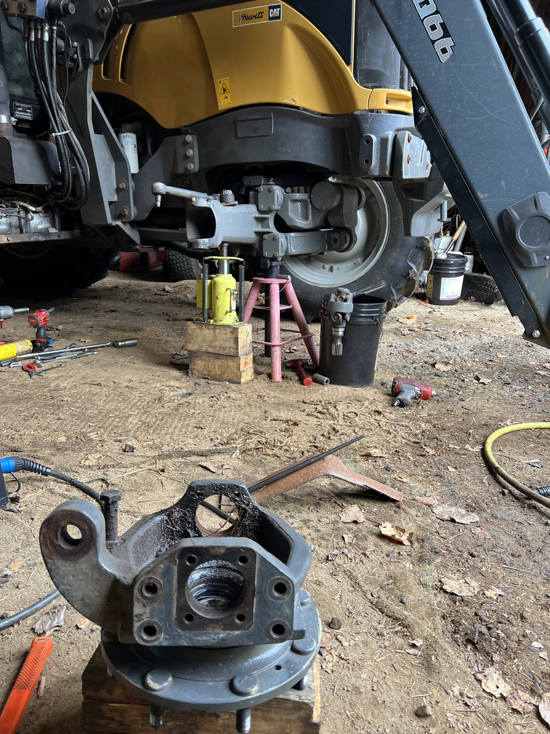

Leaks in general are the bane of my equipment owning existence. One axle seal drip can be VERY costly or time consuming (or both) to fix.
This one took a long time and the seals were not cheap, either. Getting king pin out was a real joy.

My main problem, black pipe used in place of high pressure fittings. No amount of dope or thread tape was going to fix that.
Thanks LD1
Unsupported valve is pretty common on a lot of log splitters and not a problem.
The bigger problem is your use of black iron pipe fittings that are rated for probably 1/20th of the pressure you splitter produces
