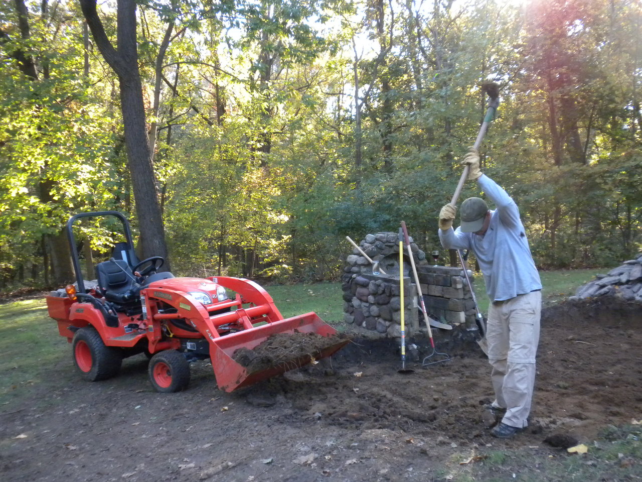

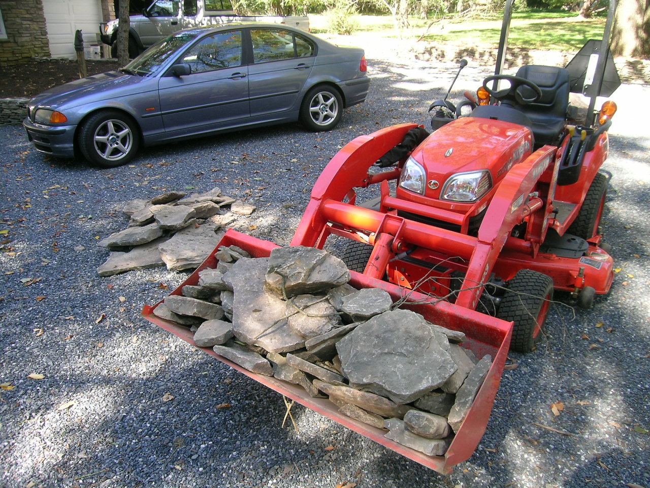

These are the exact factors that I considered, and in addition I had one more -- clearing snow.
In my analysis I considered a ZTR a "purpose built" tool -- that is, if I only wanted to mow grass it was clearly the fastest way to do it. But, any additional tasks would be limited by the limited towing/spraying/etc options available to a ZTR platform. This seemed to me to be a significant tradeoff, at least for my anticipated needs. Of course, for a professional landscape guy who cuts a square mile of grass per week, a speedy, highly-maneuverable ZTR makes perfect sense. But for my acre and change of grassed area, I did not think the time-vs-versatility tradeoff tilted the scales to the ZTR. Finally, the ZTR was going nowhere from late November to March --for that timespan it is a dead asset.
The lawn tractor approach similarly had limitations. It would have none of the time-saving advantages of the ZTR, and none of the better capabilities of a bigger utility tractor, and finally very few lawn tractors have 4WD which (combined with the light weight) pretty much negated any type of usefulness in the snow. Moreover, typical lawn tractors have limited lifespans; the last thing I wanted to do was purchase a tractor and throw it away in 5-7 years because the engine or transmission or deck has reached it's designed-in end.
This process of elimination is what led me to look at SCUTs. With one I would get the versatility, lifespan, and year-round utility I was looking for. Would it cut as fast as a ZTR? No. But I could do a lot more with it than a ZTR, and that would in the end save me time, money, and/or aggravation (e.g. dealing with rentals etc).
So at this point, I really don't know what I want. What to do, Internet? What to do?
Get a subcompact utility tractor. How's that for decisiveness?

Very nice Wrooster. I don't think you could have done all that with a ZTR. Why do I see a flagstone walk leading to the Barbecue or outdoor fireplace?

Good luck with your decision and new home. Looking back, almost everything I have done landscaping-wise has been with the assistance of my tractor. Nearly every piece of fieldstone and bluestone, and every yard of gravel and mulch that you see in my pictures above was moved by my SCUT. In the beginning, you will think that the FEL is the most expensive wheelbarrow ever and a tractor with a TPH/PTO as a luxury -- but eventually you will come to learn of the utility and the ease at which you can make projects happen. Of course my wife thinks that it is all a rouse to get more seat time... ;)
By the way, returning to the economics subject on three fronts...
1) Monthly, my "0% interest for 4 years" payments are currently costing me less than the landscaping services that quoted me on annual cut-n-blow. So that is a nice feeling, although as an "owner-operator" I have to do my own PM (oil/grease/etc) and servicing. But I am a propeller-headed engineer and I don't mind that kind of stuff.
2) Some operations with a SCUT and FEL will naturally take longer -- sometimes a lot longer -- than if you used, for example, a rented skid-steer. A competent operator in a skid-steer with a large bucket will outpace a competent operator on a SCUT w/ FEL ten times over, just like a mini-Ex will outdig a backhoe five times over. So, you have to find the right balance. Above, you noted that you would like to trench in sprinkler pipe. Don't use a SCUT for this. Rent a vibratory plow -- such as a smaller model from Ditch-Witch -- that makes a knife-edge slit in the ground while pulling black poly pipe. Afterward you irrigate the area you passed over and seven days later you'll never even know you were there. I installed sprinklers in my youth and know what I speak of here -- you are not going to win against a Ditch-witch pull plow. There is a reason the pros use one.
If you trench with a SCUT backhoe, the cleanup/reseeding operation is far more extensive. The money you spent on the SCUT-attached backhoe and "saved" on the rental will be hugely disproportionate. Summary: there will be times when spending $250 for a day's rental of the right tool will be far, far better than anything you can do with the wrong tool -- no matter how expensive the wrong tool is.
3) Some of your "savings" will be lost through acquisitions. Let me explain: a TPH without anything attached just sits there, mocking you: "feed me, feed me". Gradually you will begin scouring Craiglist for TPH attachments. It will become an obsession, you'll end up using SearchTempest or similar to find ALL the nearby deals. A PTO-driven generator, "like new, includes shaft", good price, 100 miles away? A TPH aerator, "used once, father passed away, will sell for cheap", 85 miles away?
