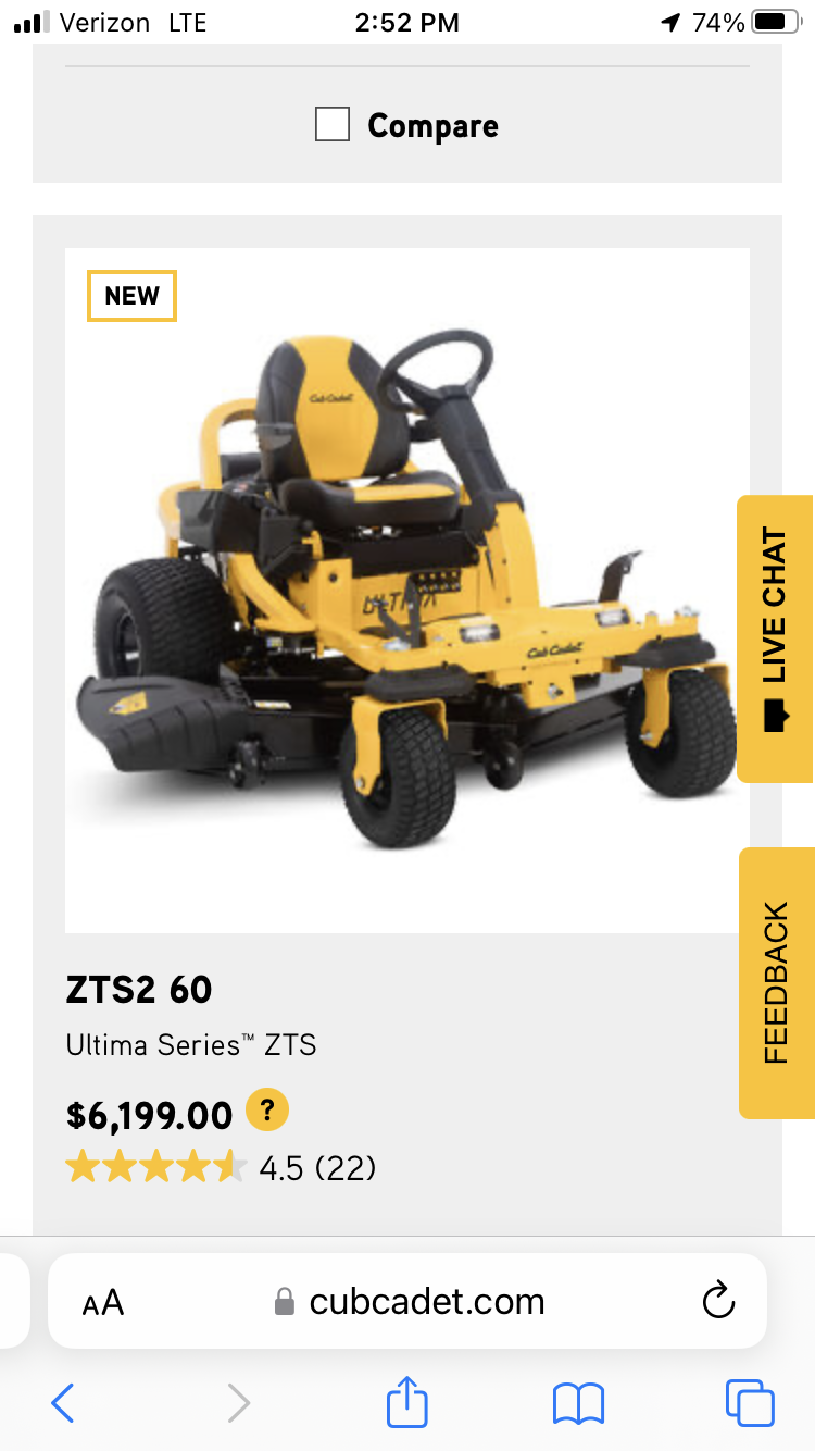

Does any company make a ZT with steering wheel in larger frame like some of the older John Deeres? This would provide familiarity of steering wheel with convenience of ZT.
/ Lawn Tractor vs Zero Turn #25
Not sure if this is what you mean, but this?
/ Lawn Tractor vs Zero Turn #28
As mentioned above, check out the "S" series of zero-turns from Cub Cadet. Instead of having casters on the front that just follow the terrain, you can actually steer the front wheels while applying inputs to the rear hydro-pumps that drive the back wheels. Makes it easy to handle slopes whereas lap-bar ZT's just want to trail off downhill. They used to make a Z-Force S but I think that's been replaced -- maybe with the Ultima series? It's worth a look.

Thanks for the insight. Sadly the Cub Cadet dealer was closed by the time I got there (would have gotten motivated sooner had I realized everyone closed at noon today). It does seem like the Ultima ZTS2 or ZTXS4 are good candidates. The ZTX has 3100 hydros and 10 gauge steel deck vs 2800 hydro and 11 gauge on the ZTS.
Will have to go check them out!
