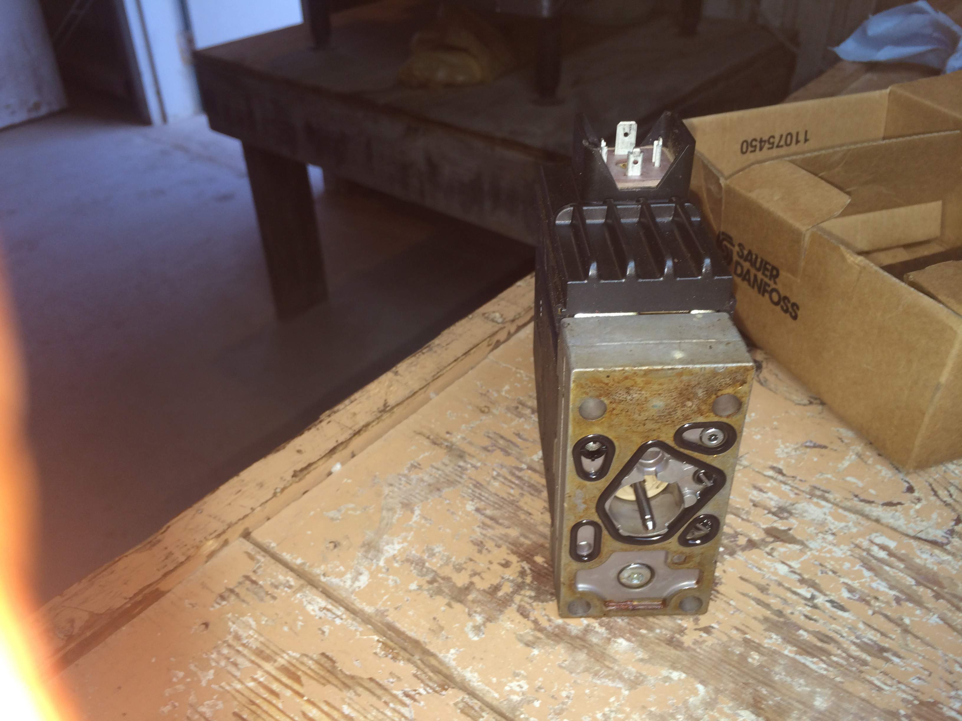

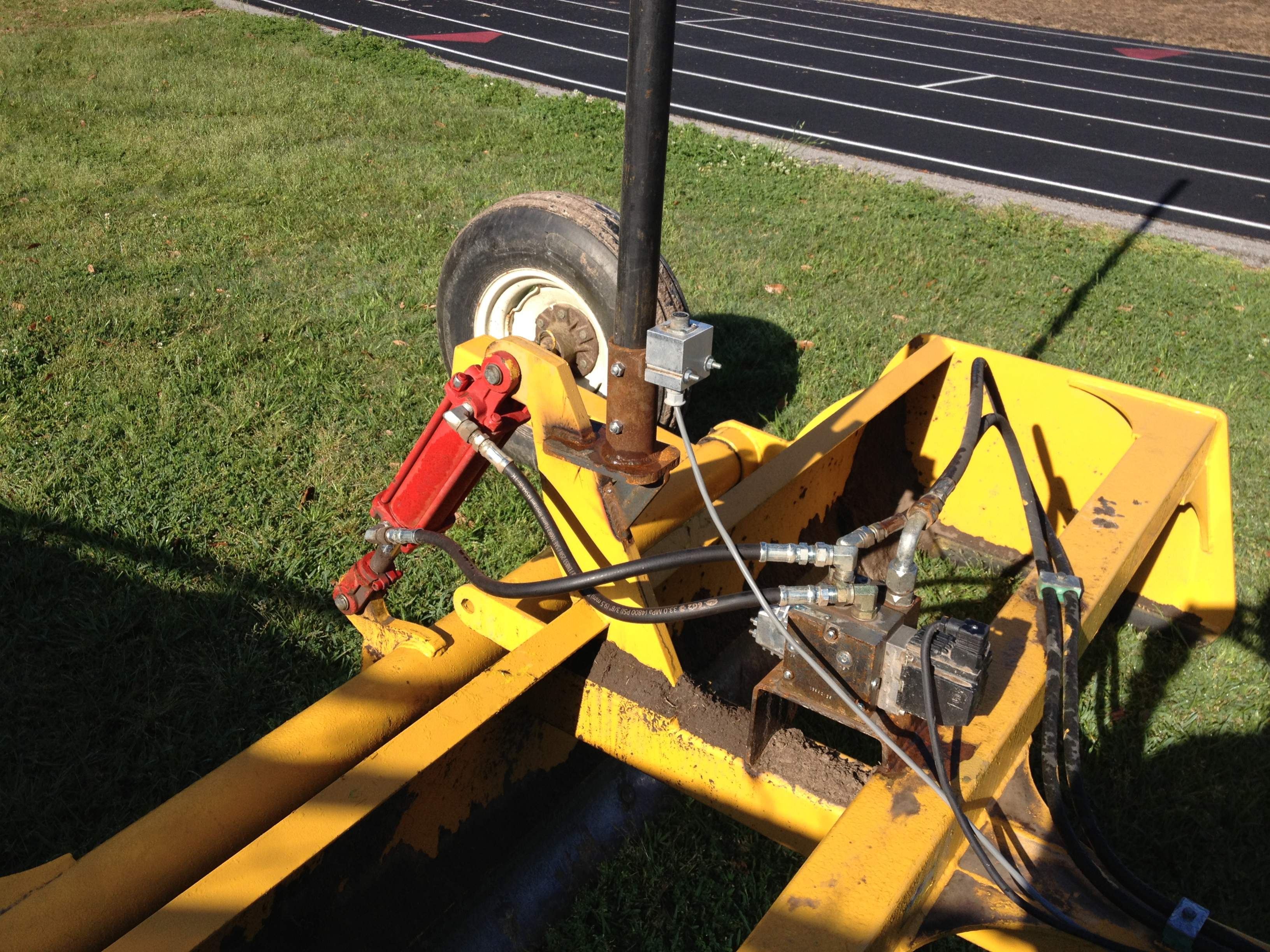

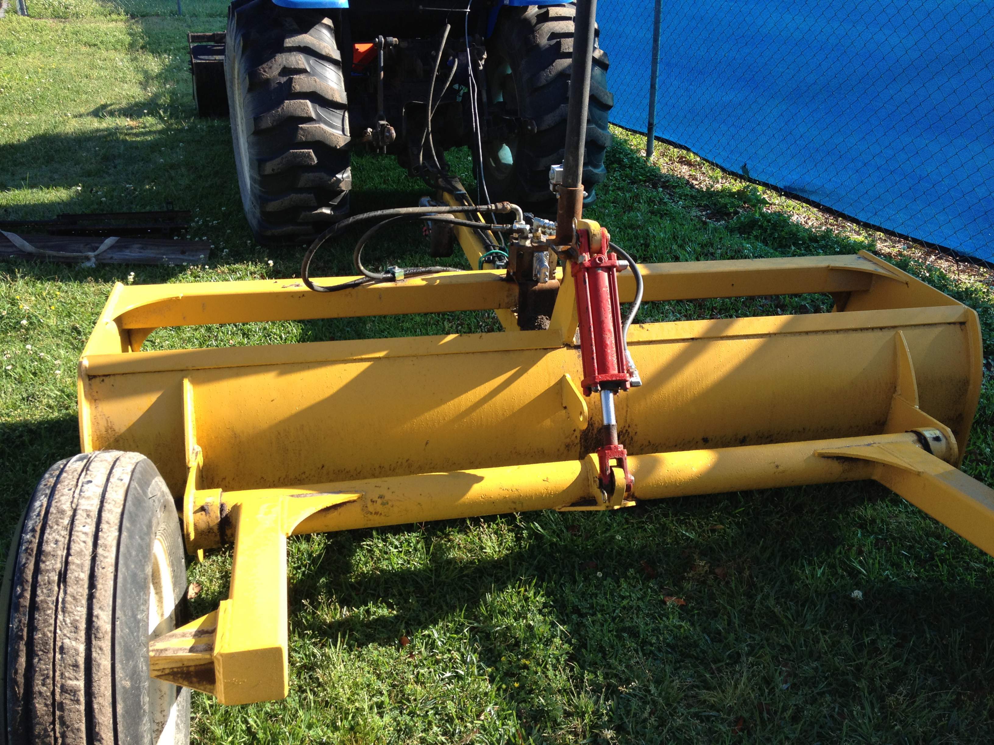

I have a laser grading system on an 8' blade that I use to grade athletic fields. As long as I had it on the New Holland TC45 in the pics, it worked fine. But, I bought a Kubota L5740 and on the first grading job with the Kubota, the valve shown in the pics failed. And, that valve cost about $800.
I was told that the reason it failed was because I had hooked up my hoses backwards and applied pressure in the wrong direction. I replaced the valve and went on to the next job. It seemed to work fine, but after about 8 hours of working, I'm starting to notice some oil coming from the $800 valve again. I'm not sure it will fail again, but I know that I can't afford to replace that valve every 10 hours or so.
Does anyone have any suggestions on what may have caused it to fail, and what could I do to prevent another failure? I do know that I did hook the hoses wrong on the first valve, but only applied pressure for a few seconds. I don't think I hooked them wrong for the second valve at all.
Could it have anything to do with the different tractor?
And, someone told me that I needed to add an inline 'backflow preventer' to prevent reverse pressure being applied to the valve.

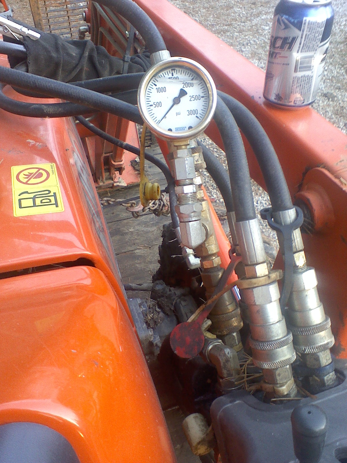

If you are supplying the laser grader with fluid and you happen to use the 3pt and it builds up pressure to make the relief go off, that pressure will be reflected on any valve up stream including the laser valve. You may/will cause back pressure and interfere with the laser finite controls.
Back pressure will work against the incoming pressure, and damage seals, etc.
You might consider a 3000 psi hyd gage in the system to monitor and trouble shoot the hyd system. Cost about $30

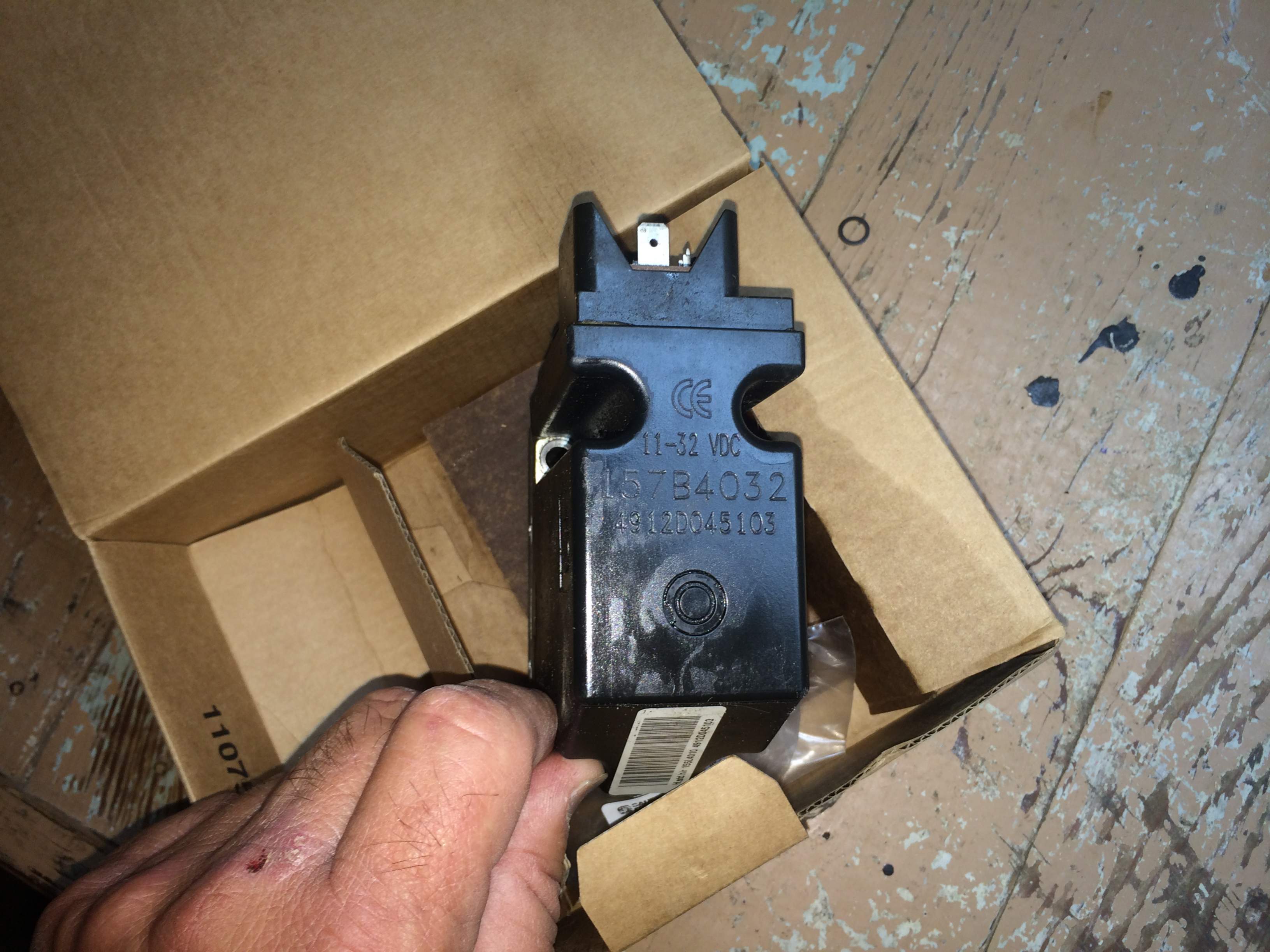

Actually, the part that I had to replace is known as a 'proportional coil'. I found the invoice for the one I had to get to replace the original, and the Sauer Danfoss part number is 157B4032. I don't get much info when I google that number.
I'm thinking that I need to add a 'check valve' or 'backflow preventer' or whatever you want to call it to protect the coil.
/ Laser grading hydraulic valve issue.

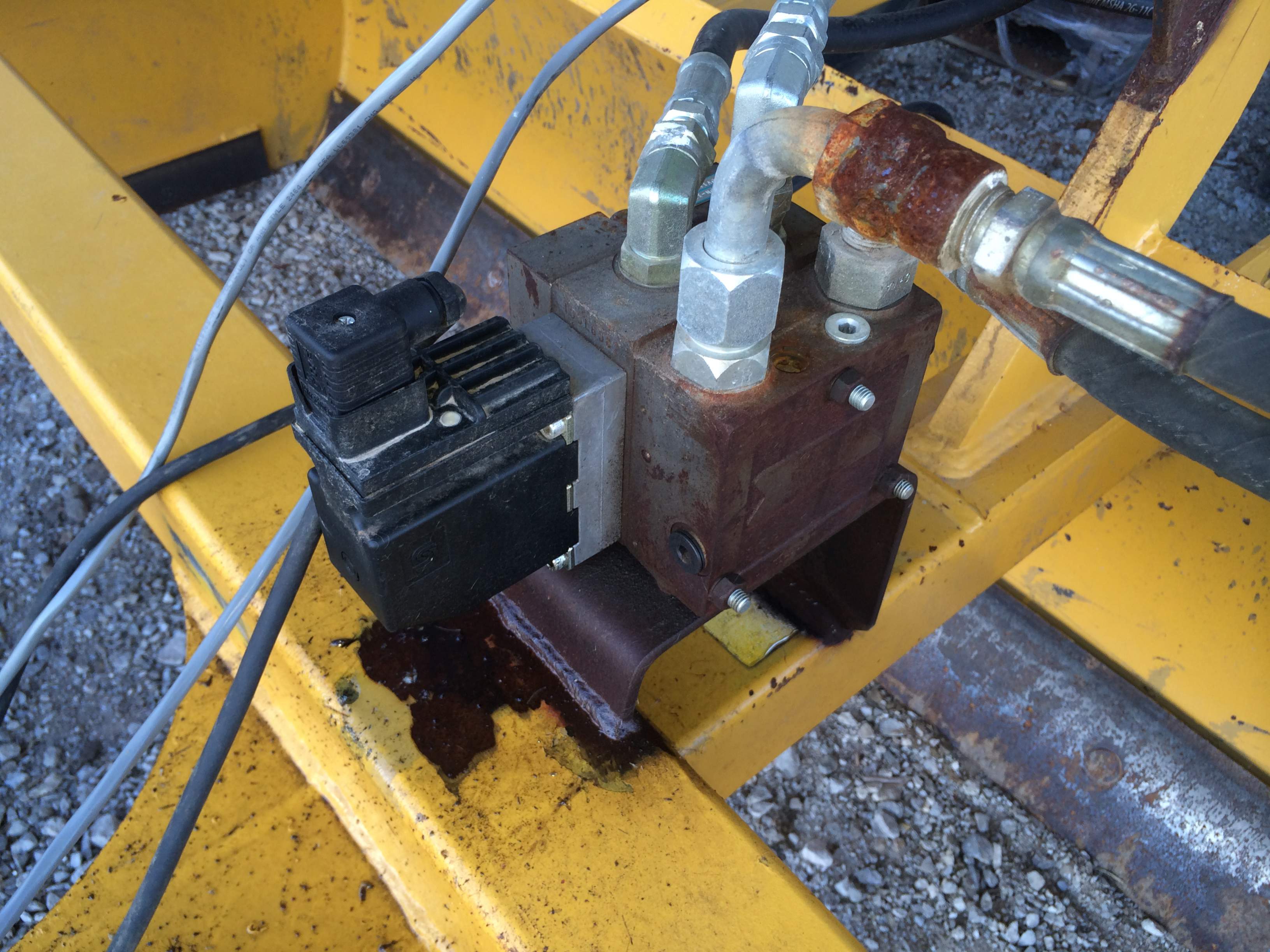

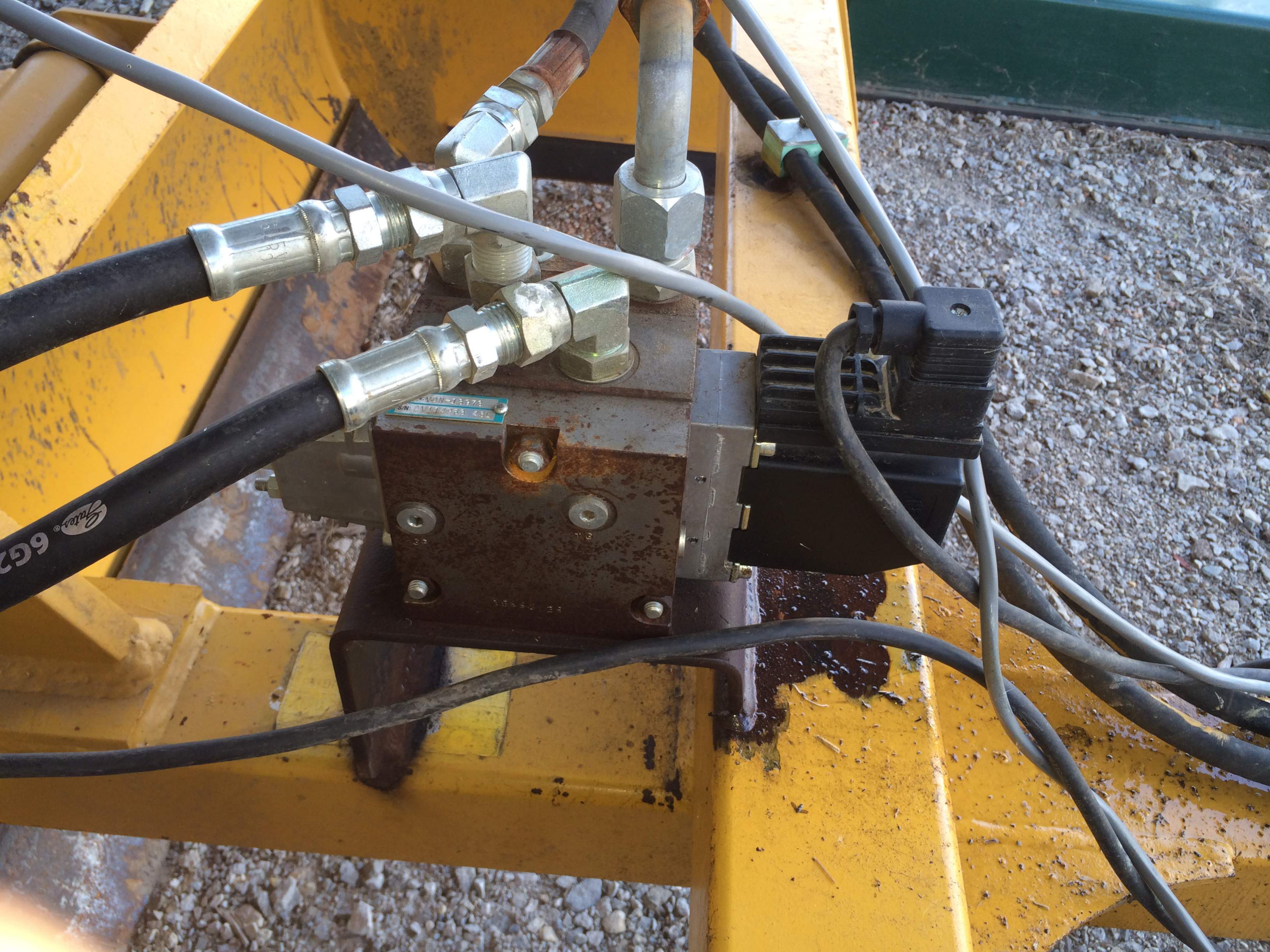

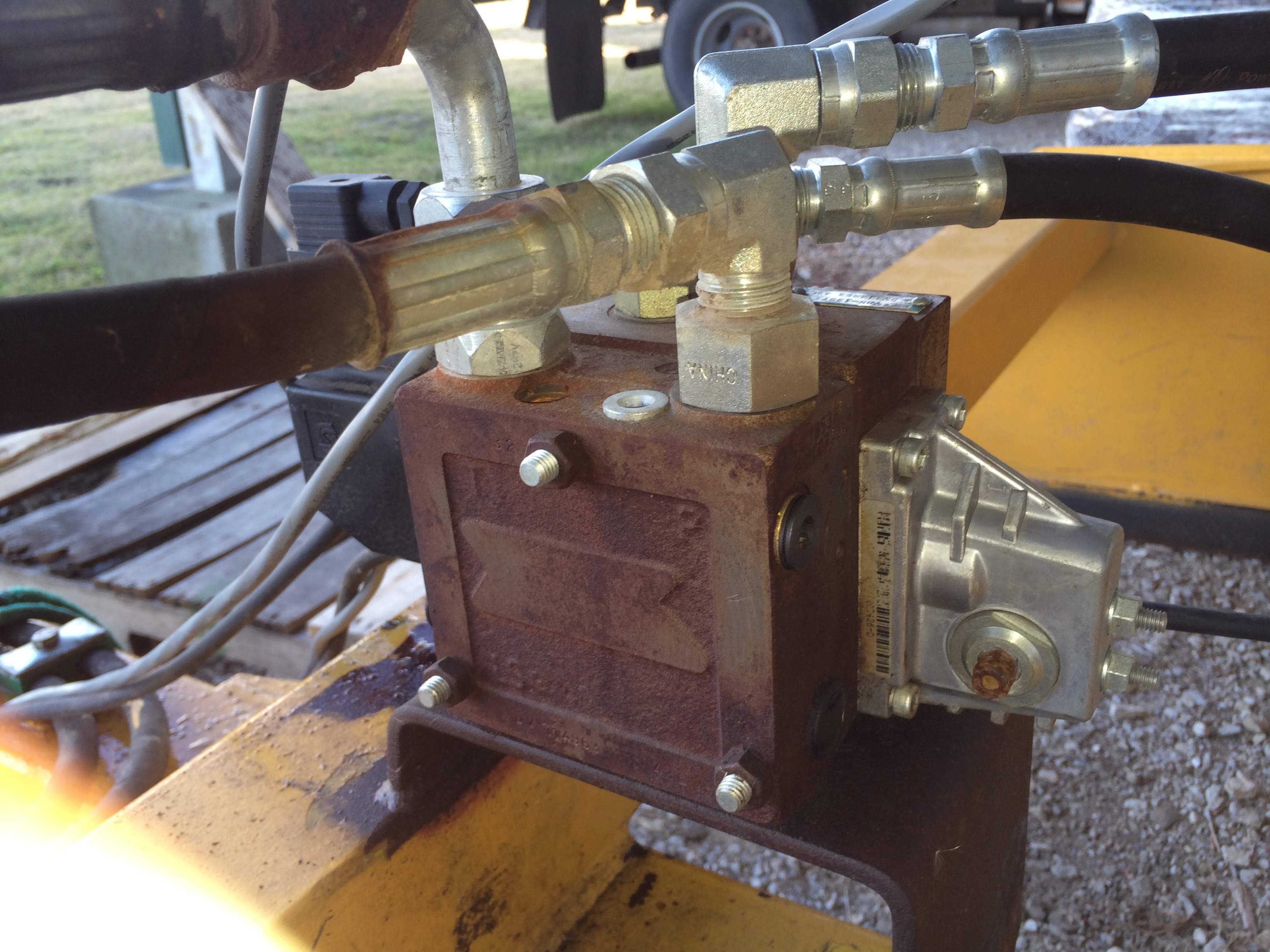

Here is a better look at how it's set up on the blade. I found a model number on the valve body of VDN-13973, but I don't get anything on a google search of that number.
You can see the oily area below the 'coil' where this new one is starting to leak. I just want to prevent ruining this one too.

This appears to be your setup Danfoss PVG 32 Proportional Valve Components : Neilson Hydraulics, Official Distributors of Bosch Rexroth and Sauer Danfoss , a stackable valve. You decide what you want and more or less mix and match.
Heres your solenoid Search Results : Neilson Hydraulics, Official Distributors of Bosch Rexroth and Sauer Danfoss ..Mike

I just noticed the solenoid is listed as 24V, is that right, your system 24V?
Yes, that does seem to be what I have. But that company is in the UK. My tractor is 12 V as far as I know. It has one 12V battery
/ Laser grading hydraulic valve issue. #12
That's the first one I came across.
Here's a link to some good but very deep info re the valve/solenoid http://tinyurl.com/ownk33b , definetly not nightime reading but very informative .
I'm wondering if the solenoid is indeed 24V instead of 12V if it's overheating baking the O rings causing the leak.
(never mind that thought, I see it's 11-32V)

Can you check the tank line pressure on the Kubota. Most pilot valves on this type of unit require minimal back pressure on the tank line to function correctly. I would suspect it would be around 25 bar (350 PSI) or less. Excessive tank line pressure will damage the pilot controls. Some valves have the option of an auxiliary drain port just for the pilot section. Not sure if this is an option on your valve though.
/ Laser grading hydraulic valve issue. #18
Is the return line on the valve hooked to the "case drain" on the tractor? If it's coming off the loader valve, it probably isn't since there is only one case drain from the loader valve that goes back to the tractor.
Hooked to two sides of the same spool, you could be bleeding a bit of pressure off in neutral via the return OR accidentally activating the loader valve when off in the opposite direction.
The drain side should have NO pressure on it. Disconnect that line off the valve entirely and run it into the oil reservoir on the tractor until you have this figured out, so you don't kill another $$$ valve :)

Probably the right way to do this is to change the valve over to an open center, which will have a an "out" and a tank drain. It would then be connected in series with the loader valve.
This is how I operate my post pounder with the open center Kubota.
