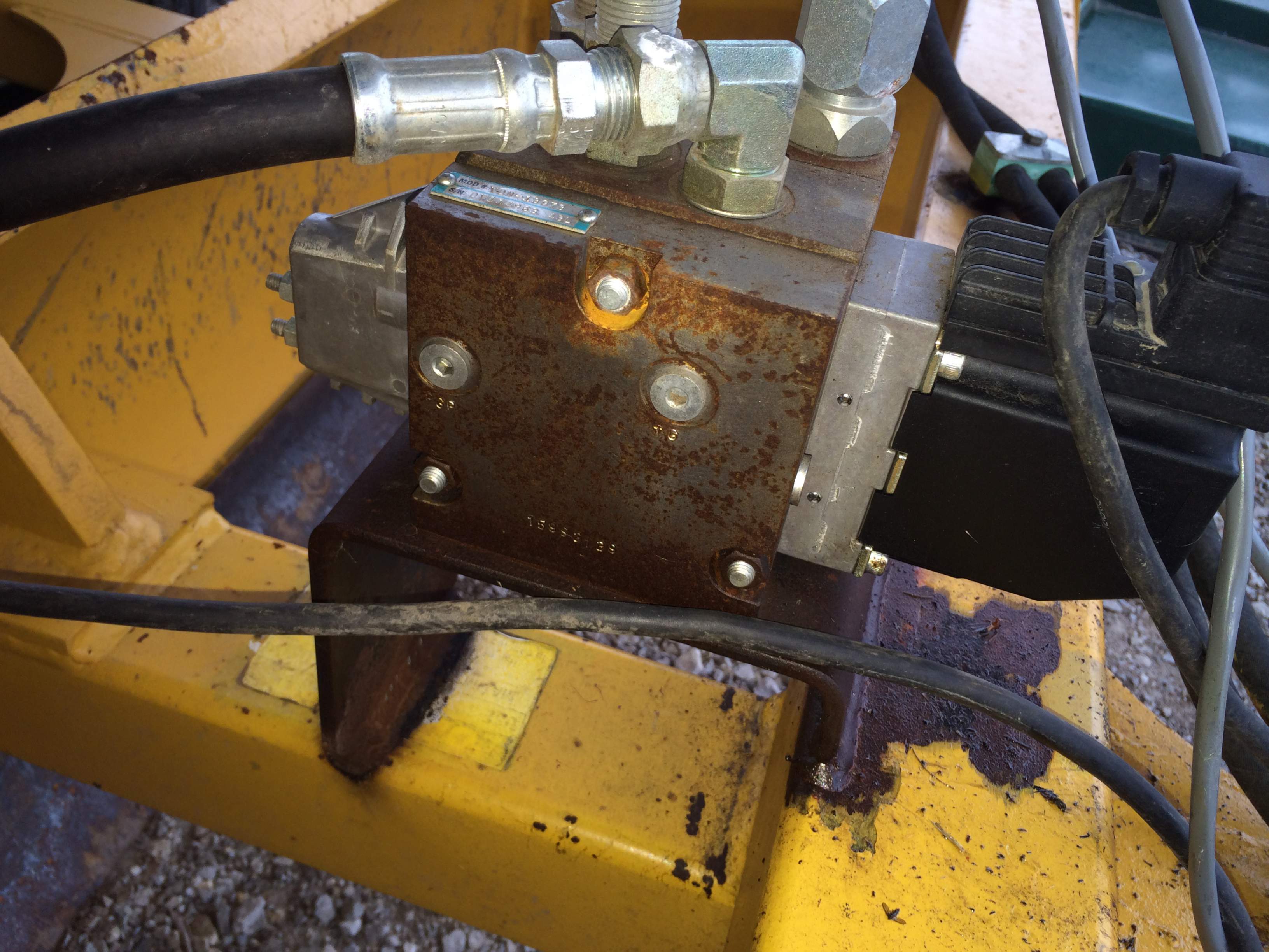

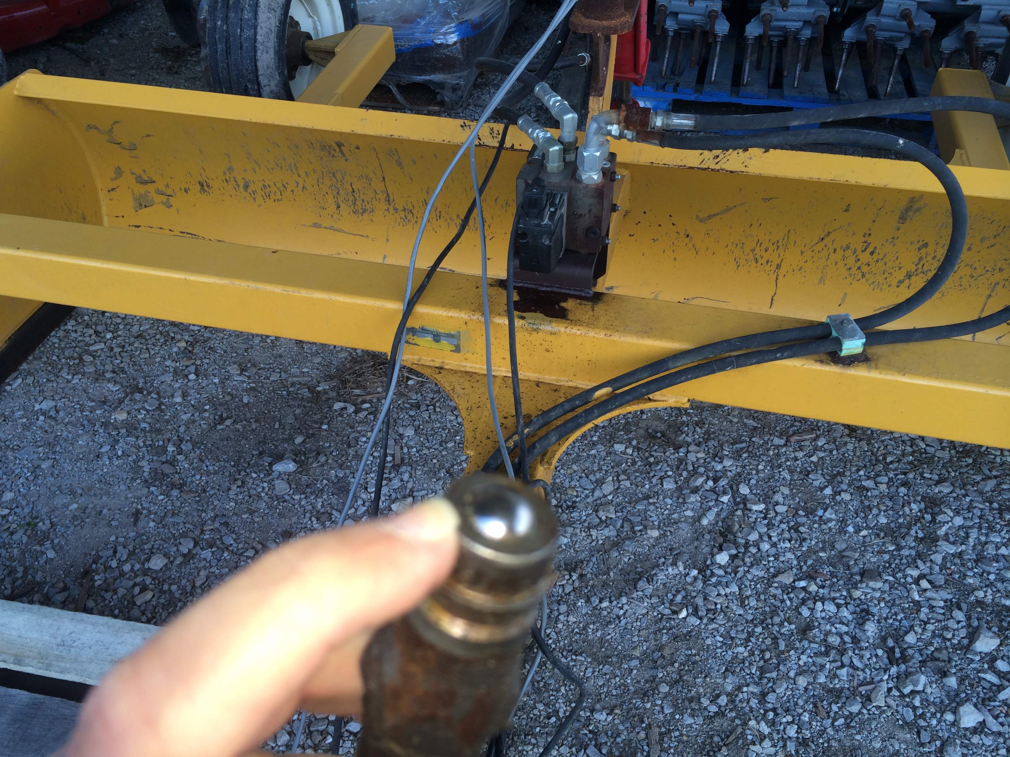

Here are pics of my male QD on the blade, and the female on the tractor. I'm going look at the valve to see if there is a place I could put a gauge.
   / Laser grading hydraulic valve issue. #28

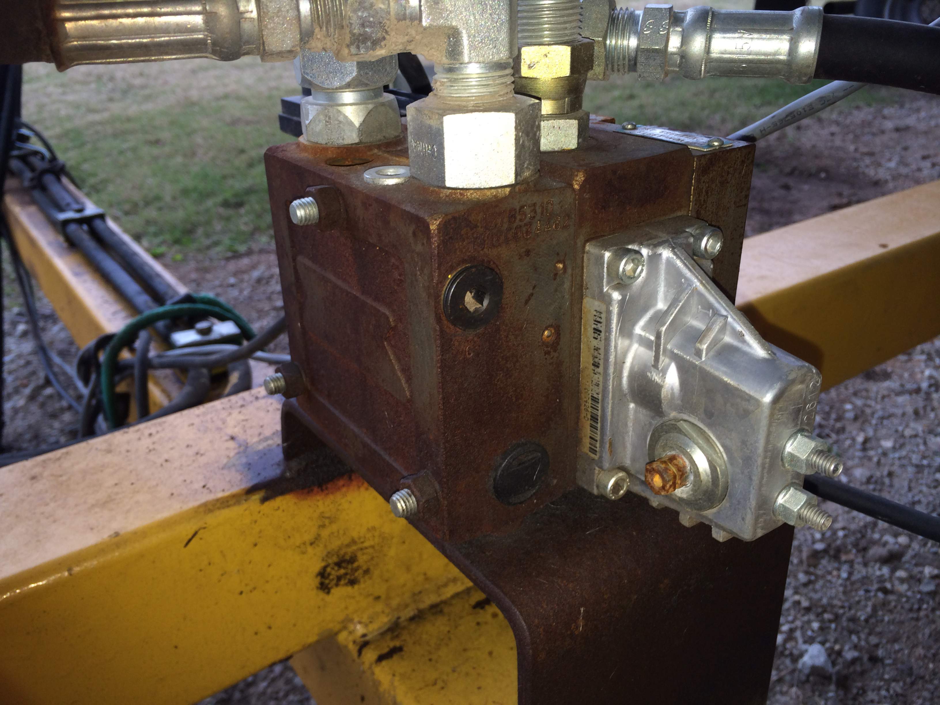

On the picture in post #7 there appears to be plugs labeled TG & GP. Not sure if that is for tank gauge & gauge pressure or some other function.
Is the QD on tractor a flat face or poppet style? Almost looks like poppet style where there would be a cone shaped pice in the middle of the QD. Occasionally these will interchange with ball style but I have had them fail and block the flow which would then create back pressure on the tank line.

On the tractor, the QD is a poppet style, and on the blade, they are ball style. I'm gonna change those before I use it again.

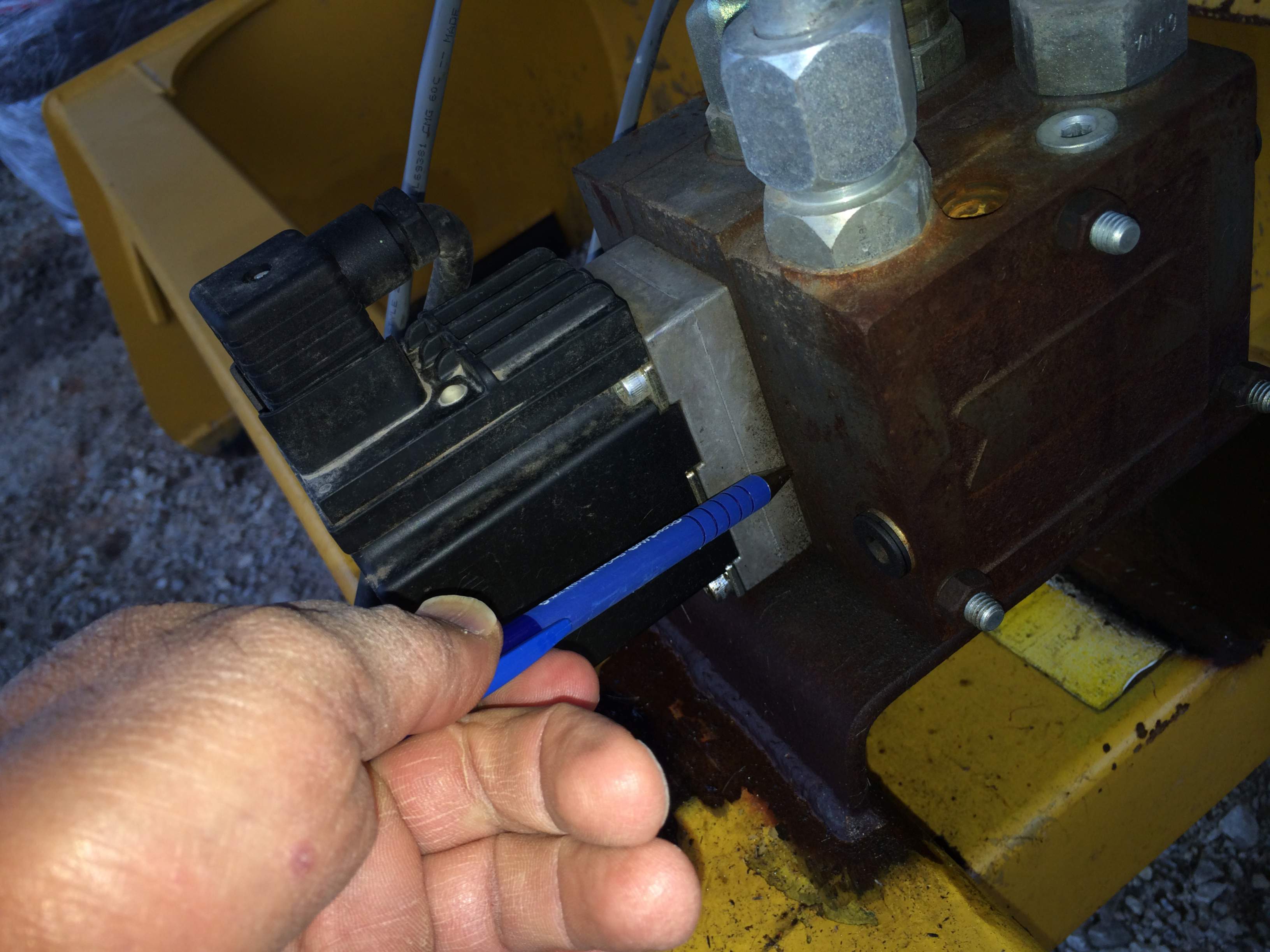

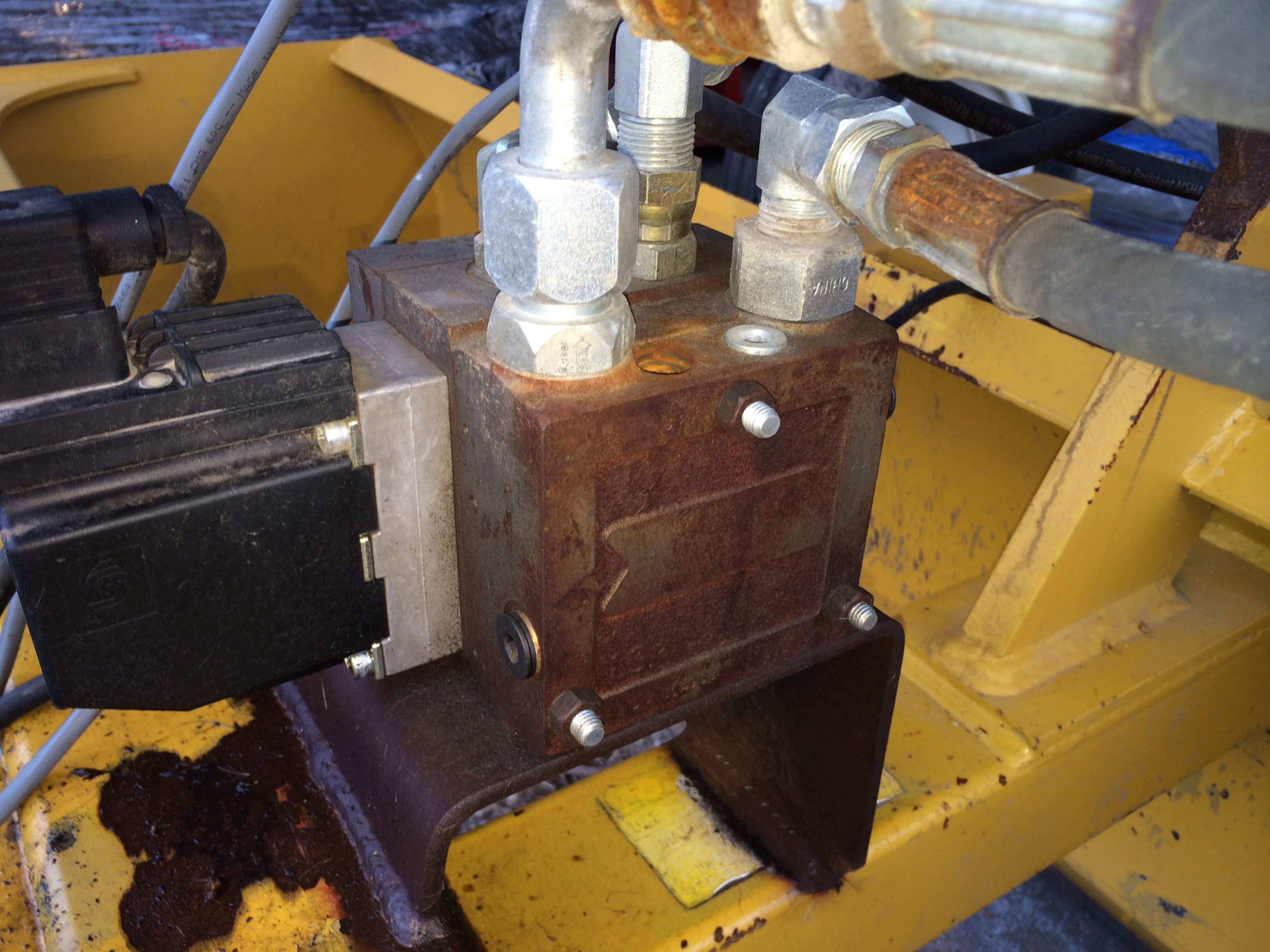

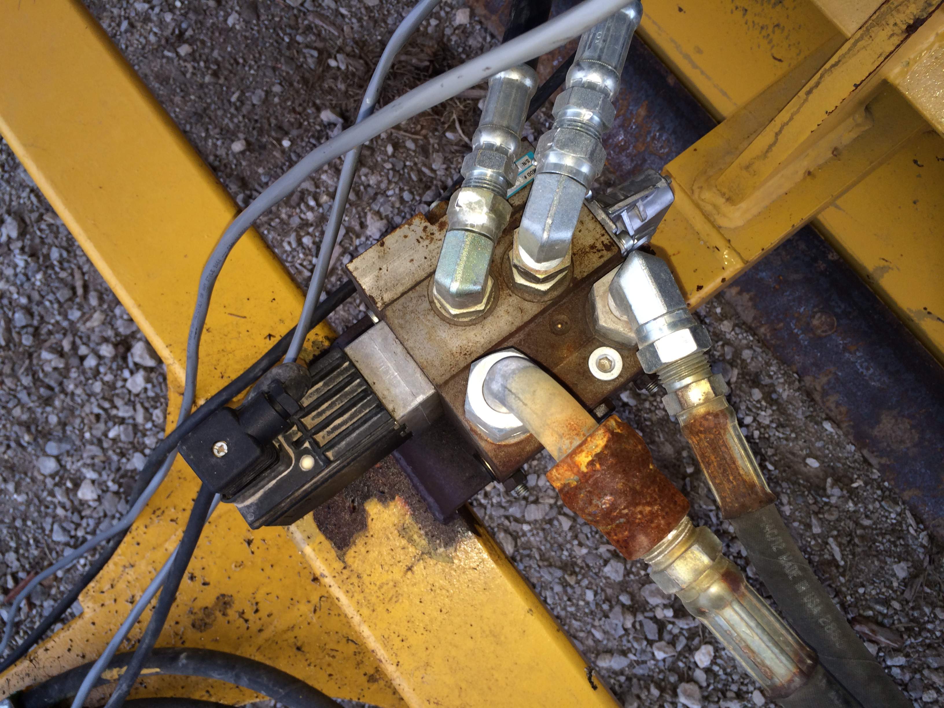

Here are some more pics of the valve. I don't know if any of these ports would be for a gauge. And at the tip of my ink pen is where the oil comes out when the 'coil' fails.
   / Laser grading hydraulic valve issue. #30

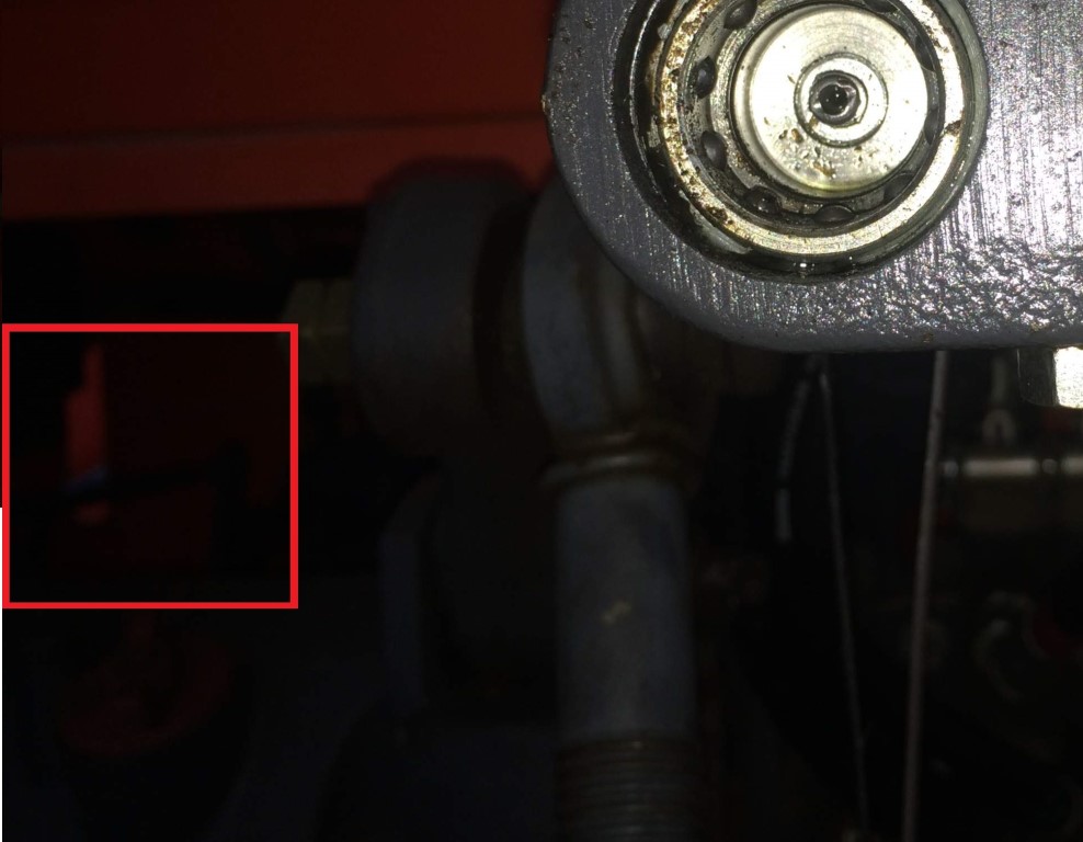

Look where the red box is in this picture. You will find an orangeish/yellowish cap that can be used as a pressure free tank return if you drill it out and tap it.
