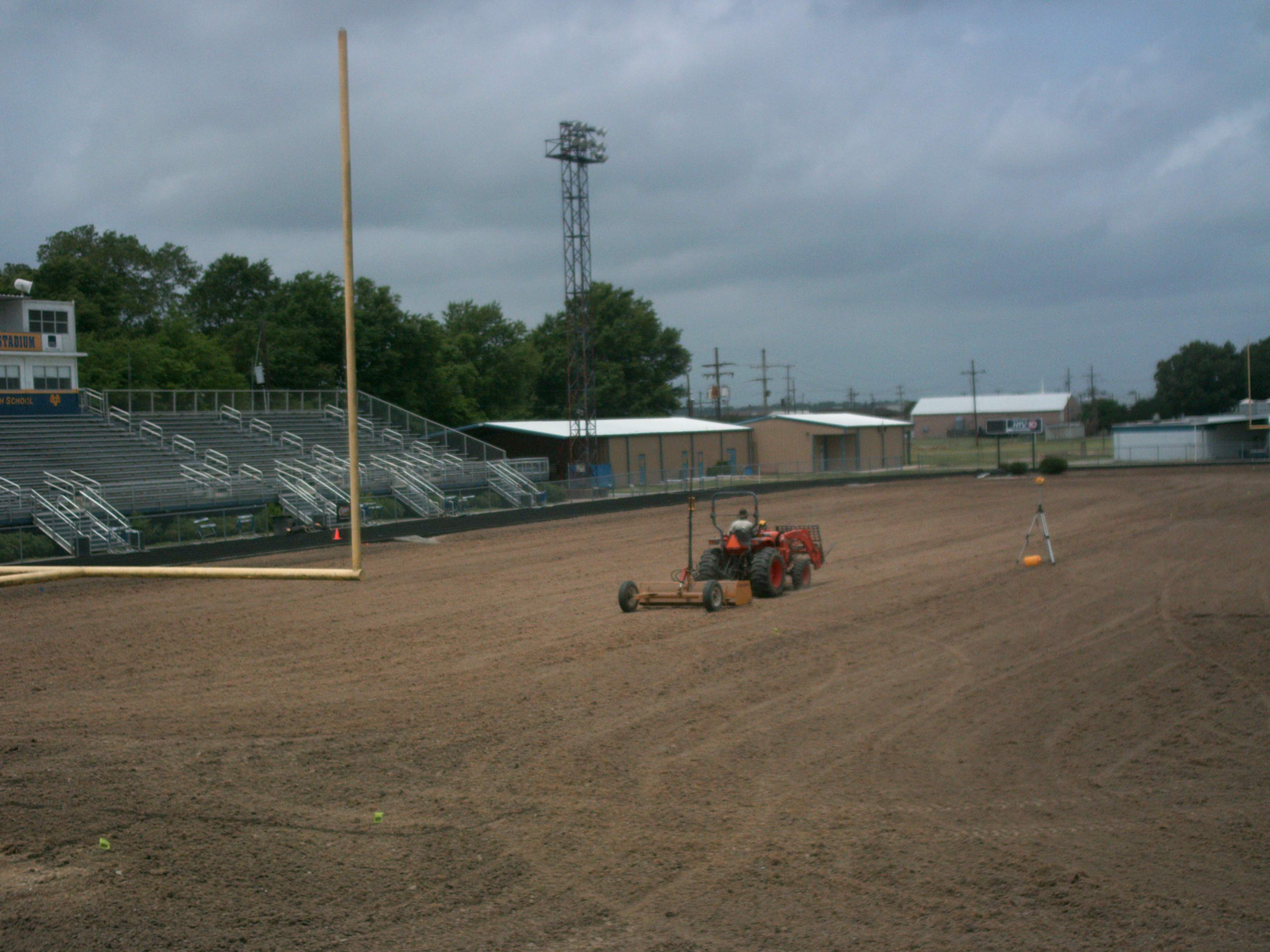

Thanks for the information. I didn't expect detailed information, but something a little better then what they had. But then I've seen that all these systems mostly talk about all the neat stuff you can do, but never speak of the hardware itself.
What makes these things so expensive? I have so many questions about these systems, I should start a thread rather then hijack this one. For one, I am curious is there is a position sensor on the cylinder? Most computer controlled systems like a CNC machine has a feedback loop indicating position or speed.
   / Laser grading hydraulic valve issue. #67
No feedback on the cylinder, it uses the laser detector on the "stick" to tell where the blade is in relation to the ground and to know how far up/down it needs to go.

Thanks again. Just two more questions and I won't have to start a thread.
How wide an area does the stick "see" and what happens if you loose the laser as in going too high or too low? Do you have to basicallly be within grade to a certain extent before you can employ the laser grading?
Q # 2 I see many systems with two receivers on each side of a blade. Is that just like having two seperate systems?
   / Laser grading hydraulic valve issue. #69
A1: It depends on the stick and how many receptors were put on it. Wider range = more expensive.
A2: That allows the system to grade a slope (ie: make the crown of a road while driving down it) and they will generally be hooked up to tilt the blade from side to side.
Aaron Z
