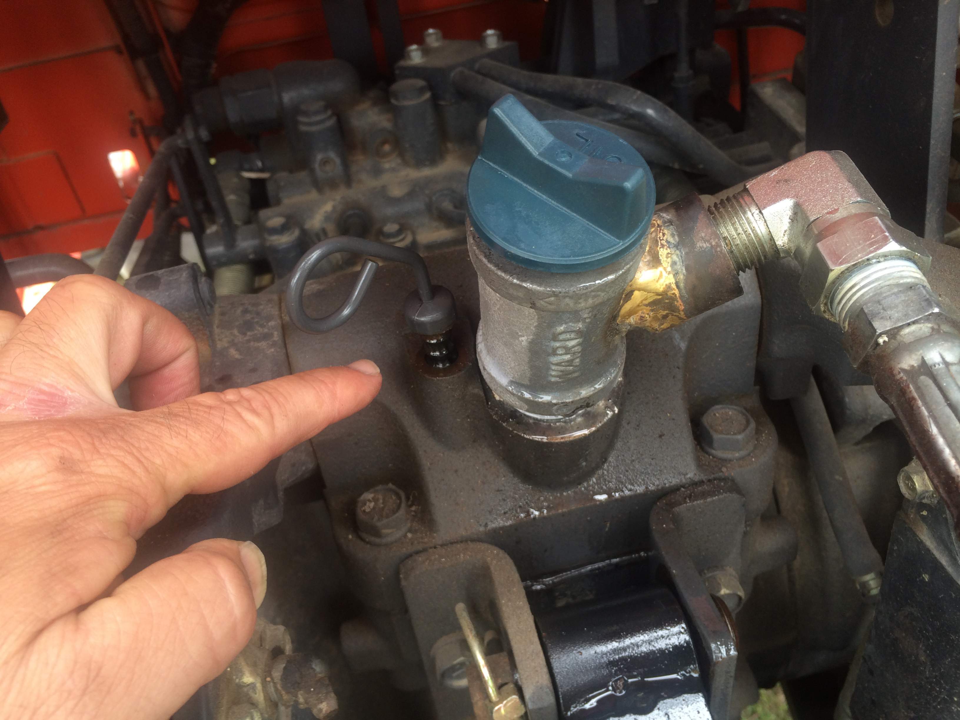

Got it hooked up today. I put the valve in the line just to verify that there is no more pressure.
Right away, it started spewing oil out of the vent hole in the fill cap. I called my guy at the machine shop, and he will try to fabricate another connection with a diverter welded inside to make sure the return oil goes down, and doesn't spew out of the vent hole.
I am curious if this matter was ever sucessfully resolved?
No, it has not. My guy at the machine shop is supposed to be fabricating a fitting similar to the one in my pic above, but with a 'baffle' welded in it to keep the oil from spewing out of the vent hole. He hasn't got that for me yet.

Is the return pipe below the fluid level.
Dumping into the air space in a reservoir is not recommend for any hyd system.
Is your reservoir at the correct level with all cyl filled?
   / Laser grading hydraulic valve issue.
#74
No it's not below the fluid level. It dumps into the fill cap. If what you are saying is true, then I'll have to start over. I don't want to start over.
   / Laser grading hydraulic valve issue. #75
Why start over, any return line should be returned below the fluid level, just extend the line going further down into the fluid.

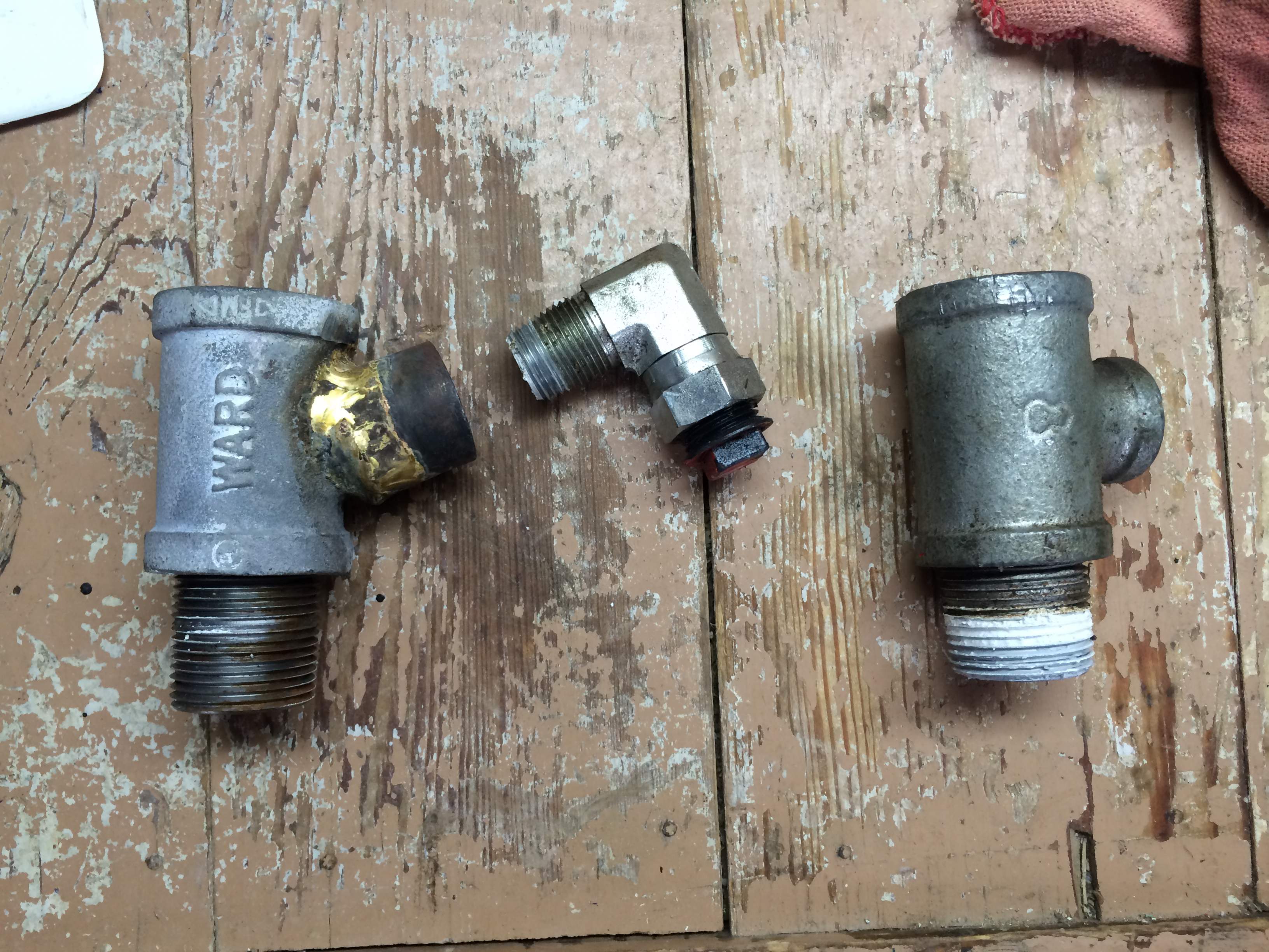

I had a new fitting made hoping to direct the oil flow downward so that it wouldn't spew out of the vent. You can see the new fitting on the left and the old one on the right.
It didn't work. As soon as I got the rpm's up on the tractor, oil began spewing from the vent.

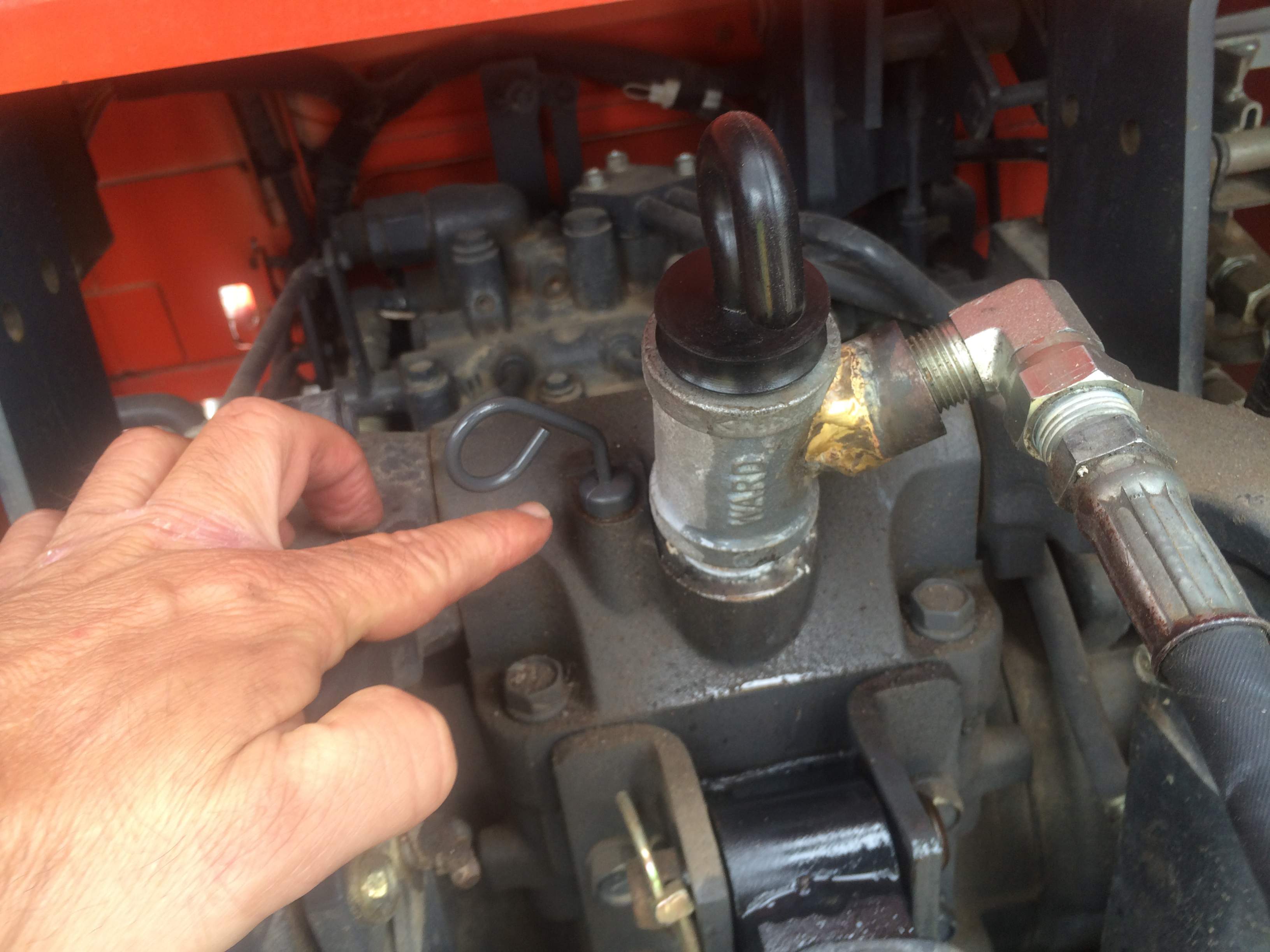

The picture below shows the vented cap in place with the dipstick where it should be.
I replaced the vented cap with a non-vented cap and pulled the dipstick out just a little hoping that this would be enough to 'vent' the system. I'm headed to work on a field early next week with it like this. Hope it works.
I also checked with my Kubota dealer to see if there is any kind of 'power beyond' kit available for this tractor, and they said there is not. I would have to go to an aftermarket system. I've gotten so many different stories about how I should handle this, that my head is spinning. I'm going to try it like this, and if this doesn't work, I'll hook it back to my New Holland tractor to finish this job.

I suspect that set up above will entrain so much air to cause system damage. Not familiar with Kubota plumbing but it would seem to be better to tee into the lower drain plug than to go thru the vent/fill.

What sort of damage to the system would it cause?
How would I know if there is too much air in the system?
   / Laser grading hydraulic valve issue. #80
I would be concerned with pump cavitation and heat. When you compress the hydraulic oil with air bubbles in it you can get a lot of heat generated, clear oil without the bubbles isn't going to compress/expand much.
I would watch carefully for the pump over heating, might wan't to buy an infrared thermometer. Does your tractor have a transmission temperature gauge? If so that should provide you with some indication of rising fluid temperatures.
