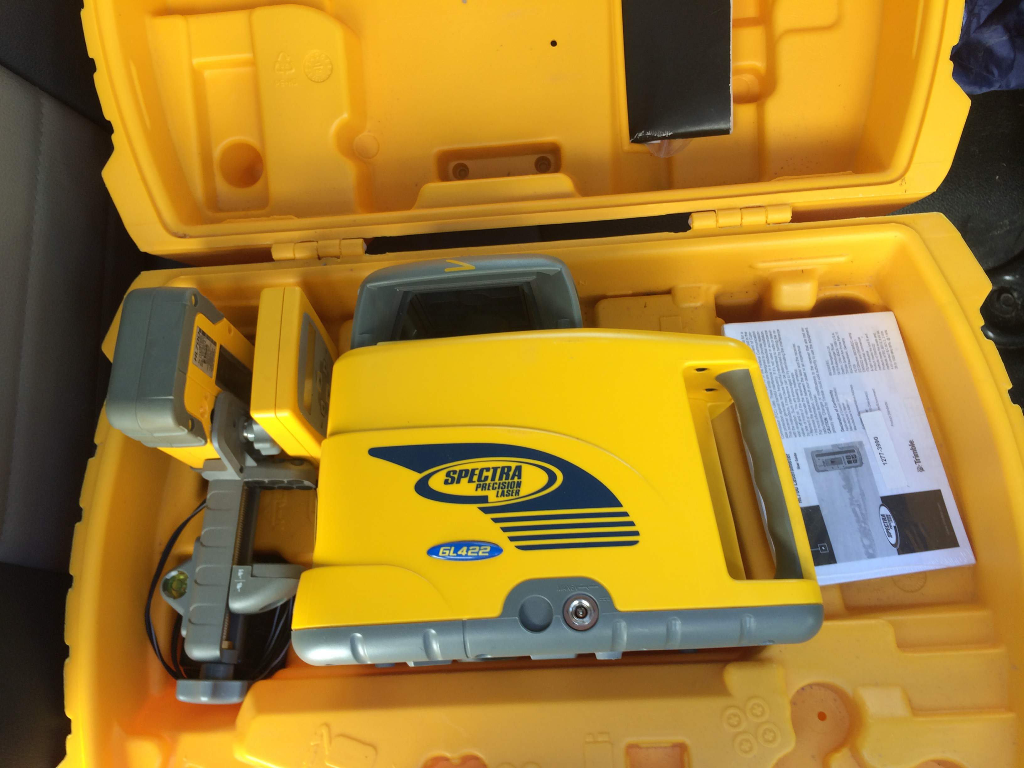

I have a Trimble GL422 Dual slope laser package.
The receiver is a Trimble LR50 and the control box is a Trimble CB25

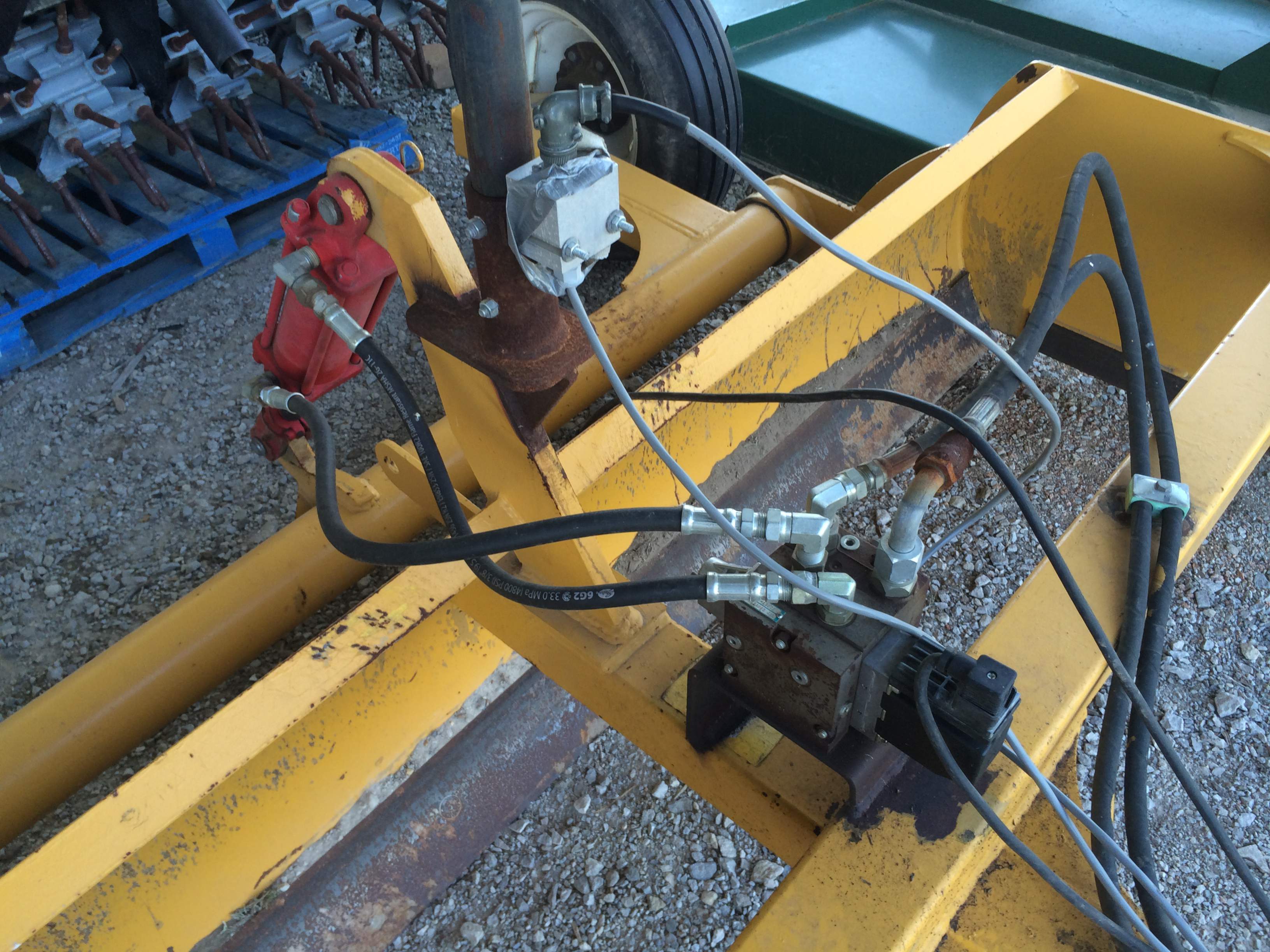

This picture is of the valve and solenoid mounted on my 8' Landscraper blade.

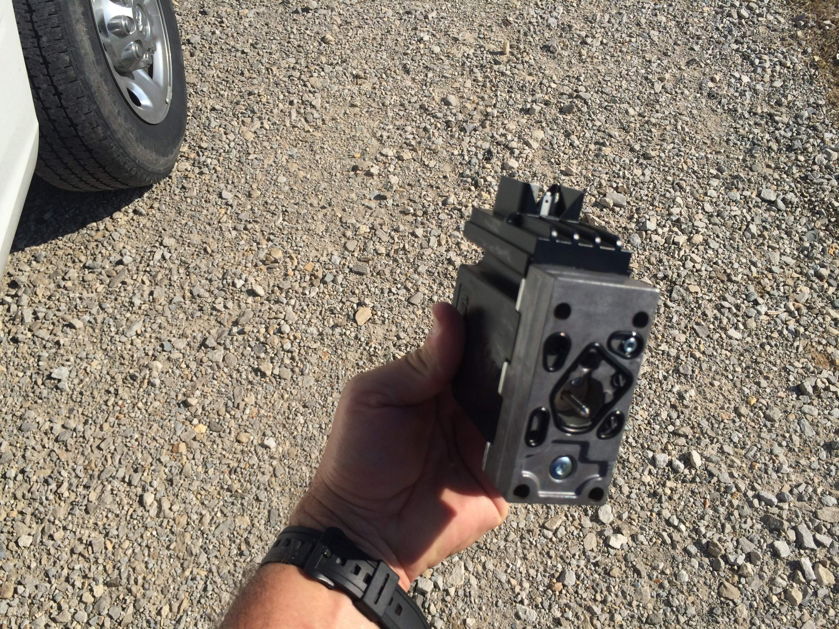

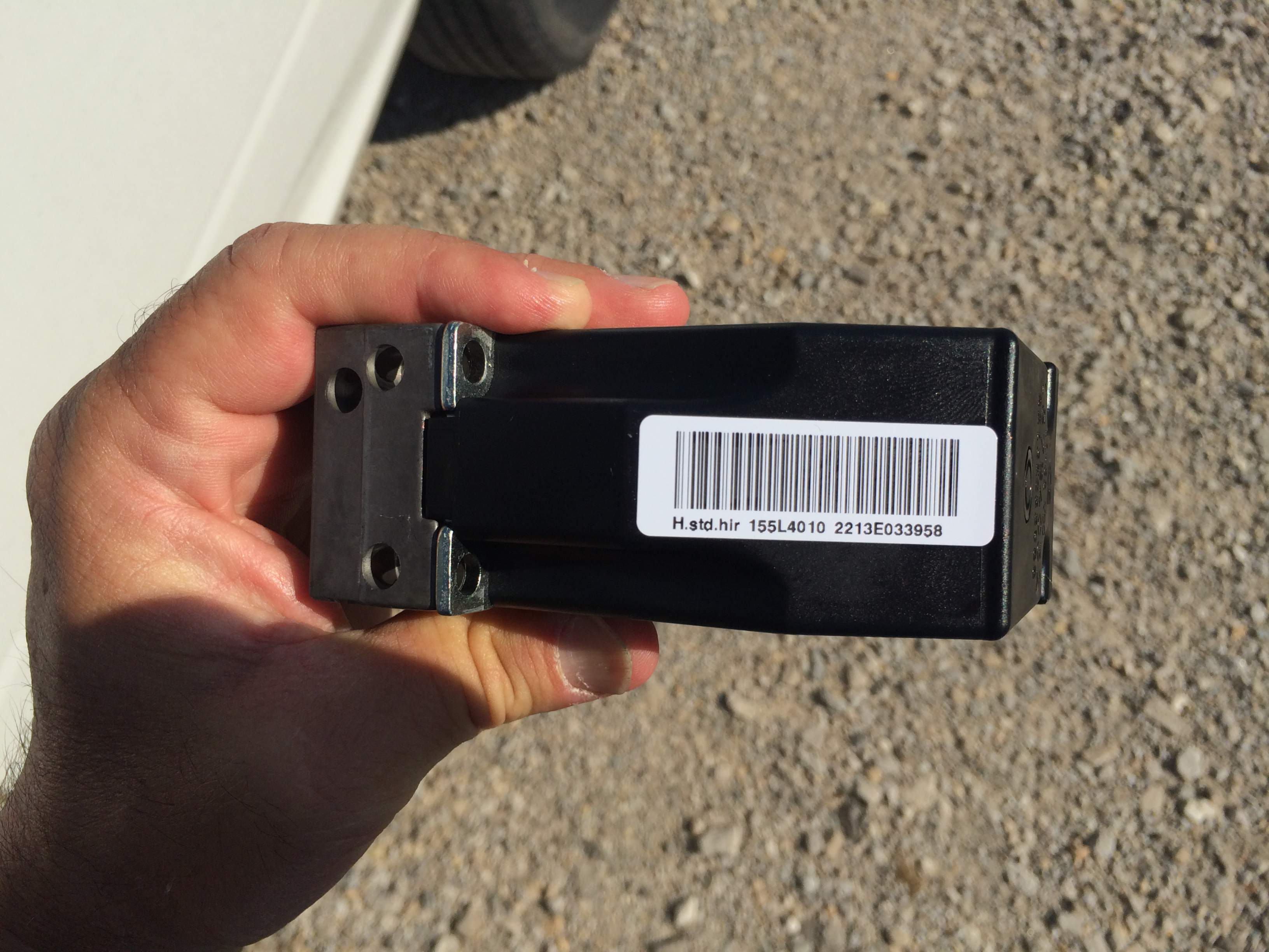

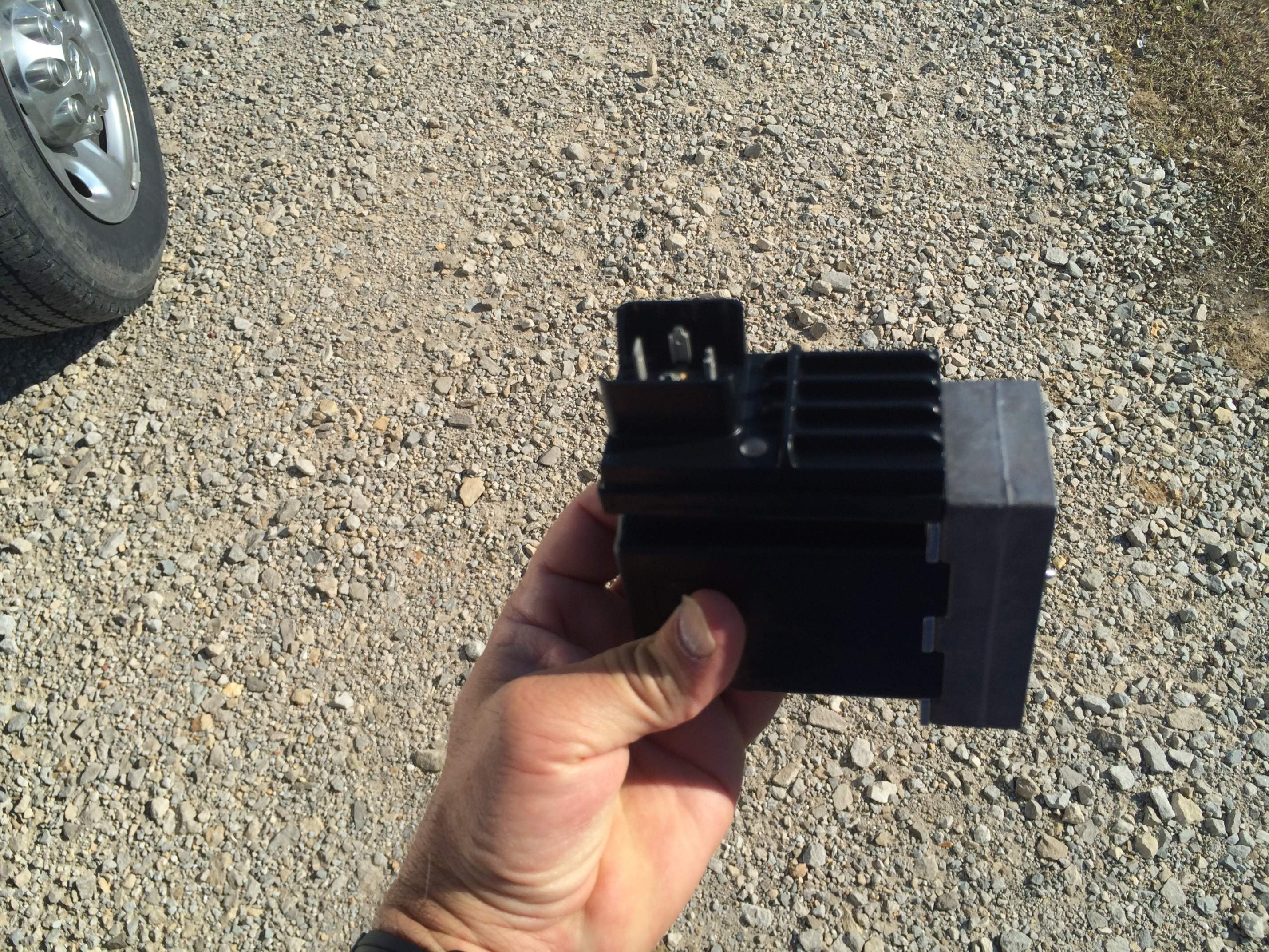

And, the pics below are of the new solenoid or coil that I have not mounted yet. I'm going to use the one already on the blade until it goes out completely before mounting this new one. I looked on the shipping invoice an the part number listed for this is MTA6157B4032.
