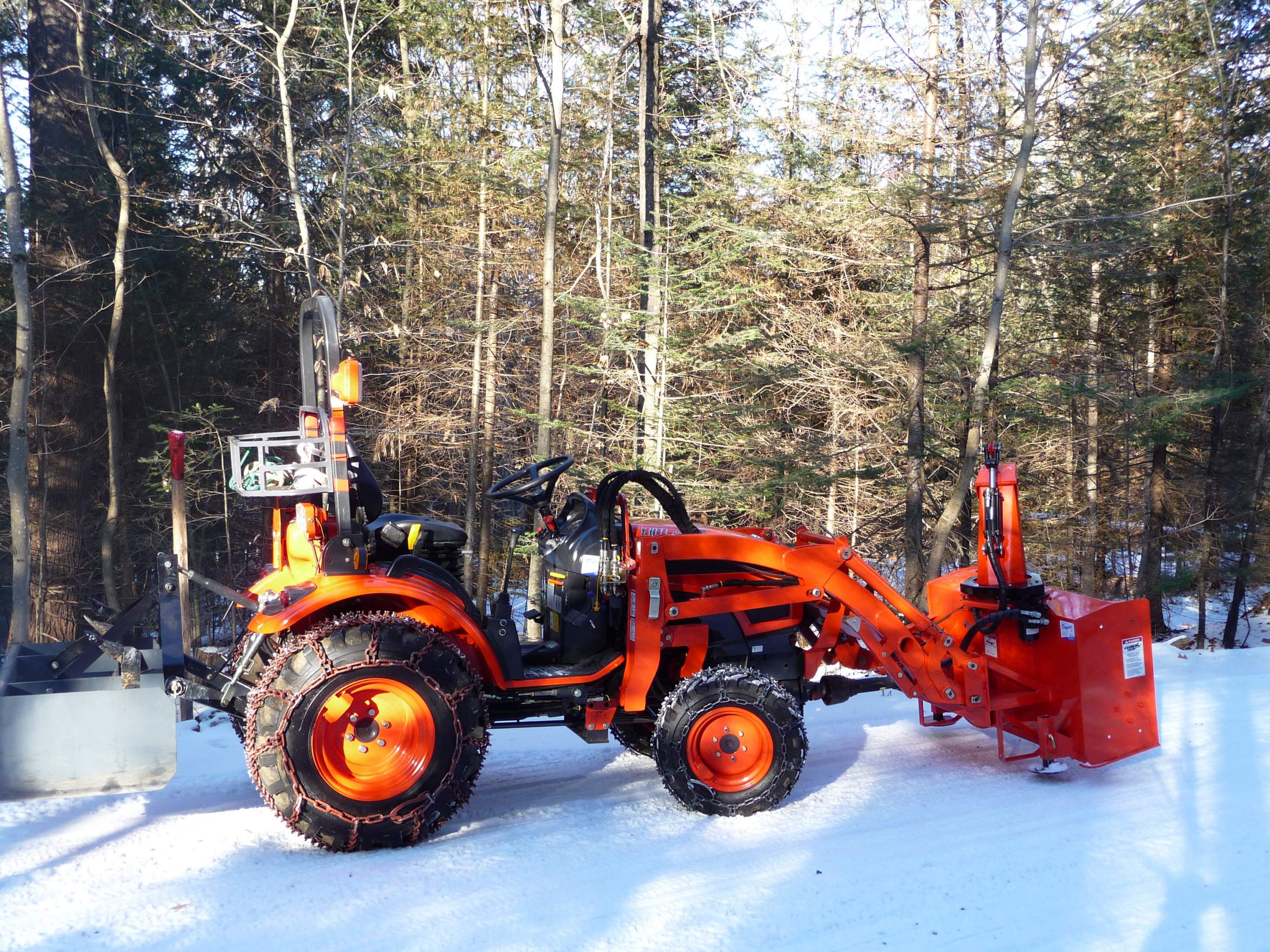

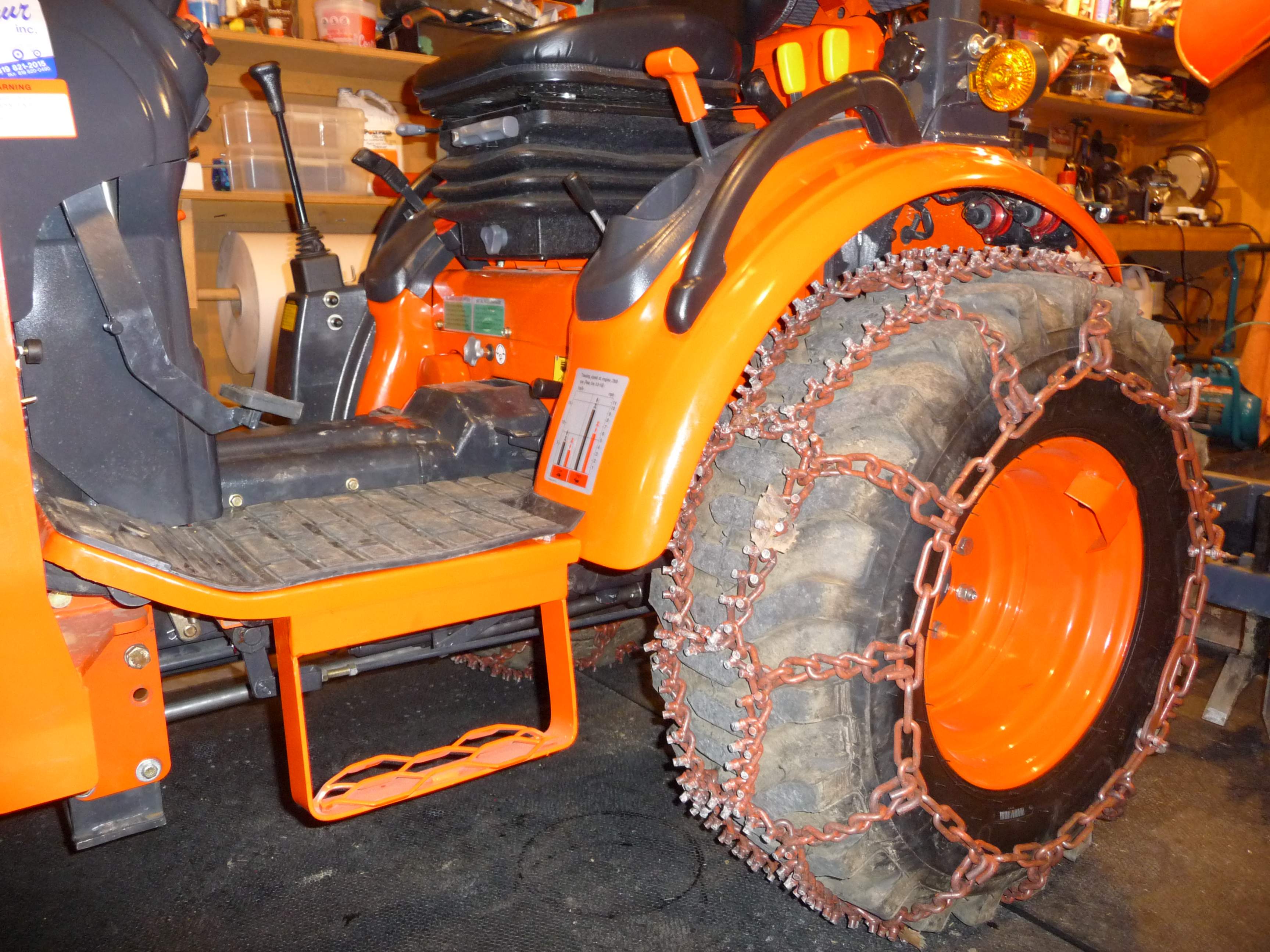

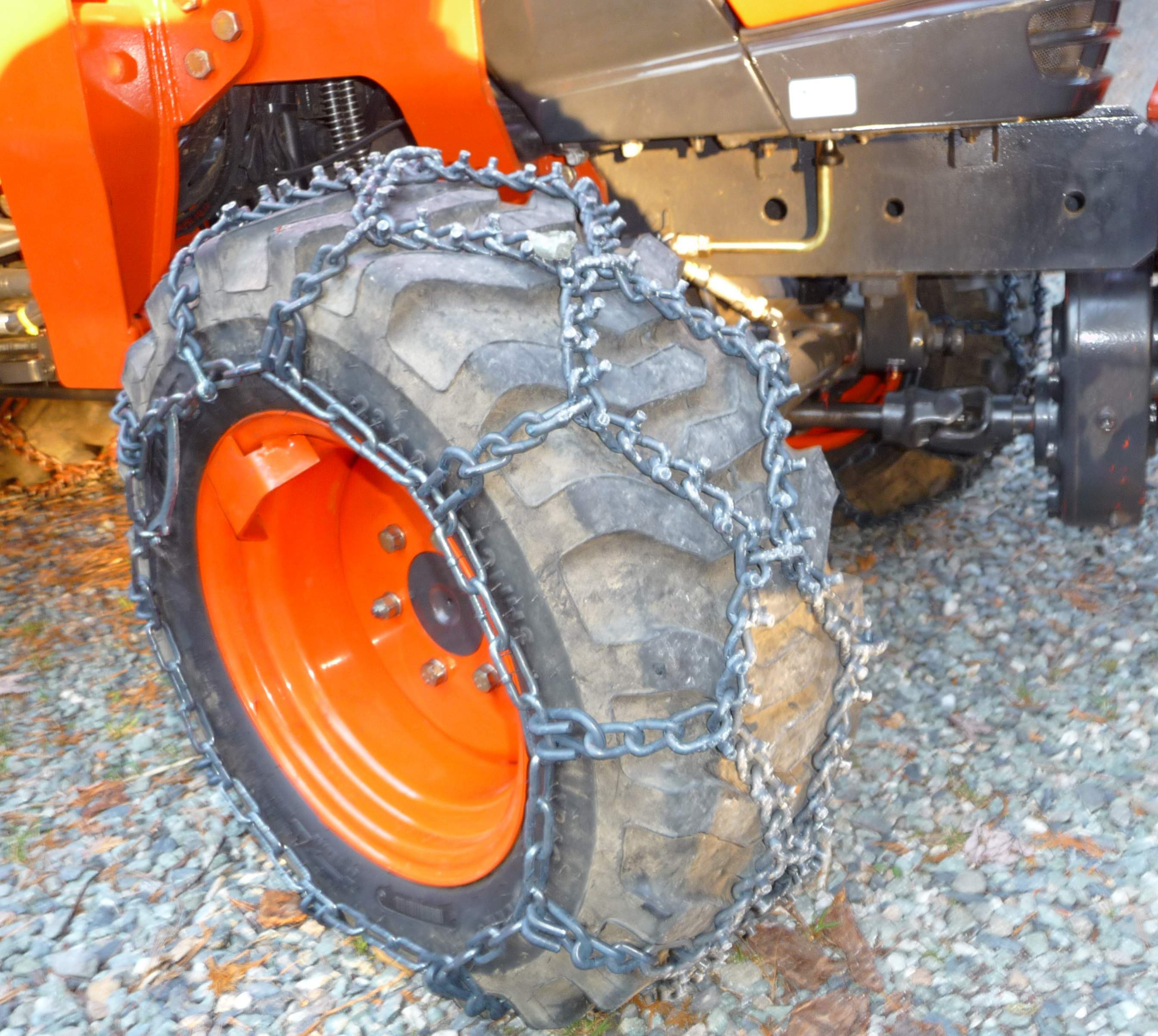

P1010826.jpgP1010841.jpgP1010899.jpgI have been stuck on icy road for over 40 years, where I lived they just paved one of the two main roads one year ago. When I bought my CK20, I was able to try a bear paw chain, really great for getting wood out of the forest, wet clay, but I found out with Trygg studded chain, almost as good with mud. Last winter diamond pattern gives you a really smooth surface. You always have contact with chain-stud, not bumpy ride (ladder chain desing). On ice, there are the best, on pavement if you don't "spin" they won't leave so many bad marking. And going downtown, nobody (except my favorite grumpy grandma') will criticism those chains.
Here's are pics., Not cheap, but they will last you a very long time.

OOhh!! Snagel toothed on the fronts too. Stopping power for sure! for sure!!
Have you had any problems with the fronts out pulling the rears and dragging the tractor on just the front wheels?

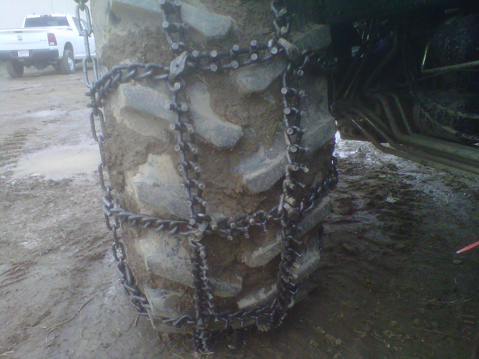

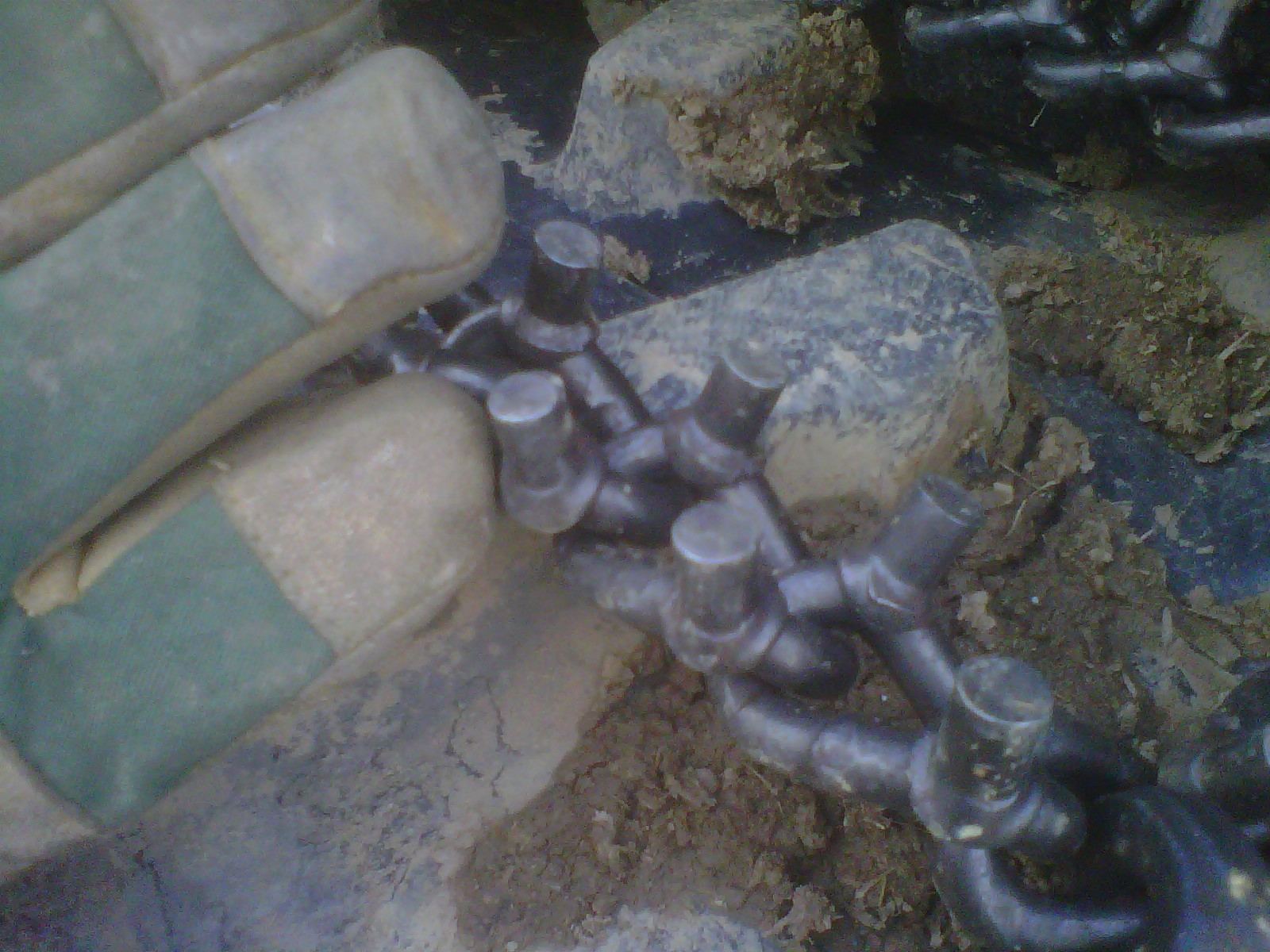

Backstory: So i think a little update is in order. I ended up buying a set of the aquiline talons from tcr.com . The sticker shock was the main reason in why I drug my feet for so long. tirechains.com is where i purchased my previous v-bar duo's and I was less than impressed with them. I ended up buying extra duo patterns and modified them to tighten up the patterns and I still was not happy. I took another members advice for this year and loosened them up and it made a pretty big improvement but I knew I still needed to get rear tire chains.
ok enough backstory, I received my talons from tcr.com and holy man are they heavy. I picked up the box and carried it across the parking lot to lay out the chains and I had wished I wouldn't have when i finally set it down. (248lbs plus the crate) I couldn't resist putting them on that day even though we didn't have any snow or ice at that time. I was a little bit confused about the extra fasteners but I quickly realized they were just spare parts. My chains just fit onto my tires with very little slack in the 4 chain loops. I took it for a little test drive while I was putting round bales out for the horses and it looked like I was driving a tracked machine around with the constant chain imprint in the mud. I kept it out of 4wd and never even noticed I was in 2wd on the steep muddy hills. I don't want to say it replaces 4wd, but it sure gets around much, much better!
If anyone is looking for a good set of chains for an R-1 tire, I would certainly recommend getting the talons. I think the duo's worked a lot better loose on the fronts, but there is no comparison between the two of them. (I can't say how much the tighter pattern helped either since I didn't have anything to compare it to.) WE are slated to get 5-9 inches of snow with some sleet mixed in over the next 36 hours so it should be a pretty good test of the talons. We also have a L3400 with r-4's and v-bar ladders work very well on that tire type since the treads aren't deep enough to hide the chain.
My only question is why tcr states that their tire chains are not for towing. Even the skidder chains IIRC say this. Who in the world buys chains and doesn't occasionally have to pull something with them on?

Pictures, because we all know it didn't happen without pictures.

The front never dragged the tractor, but when hitting a "good solid iced pack tough chunk" it will correct with ease the desired trajectory! I keep asking my dealer: "any danger for the front axel?" and he keeps on telling me: "no it is design to take it..." The real bonus you can go absolute anywhere on your land with those chained tires, getting stuck is for spring time only!
