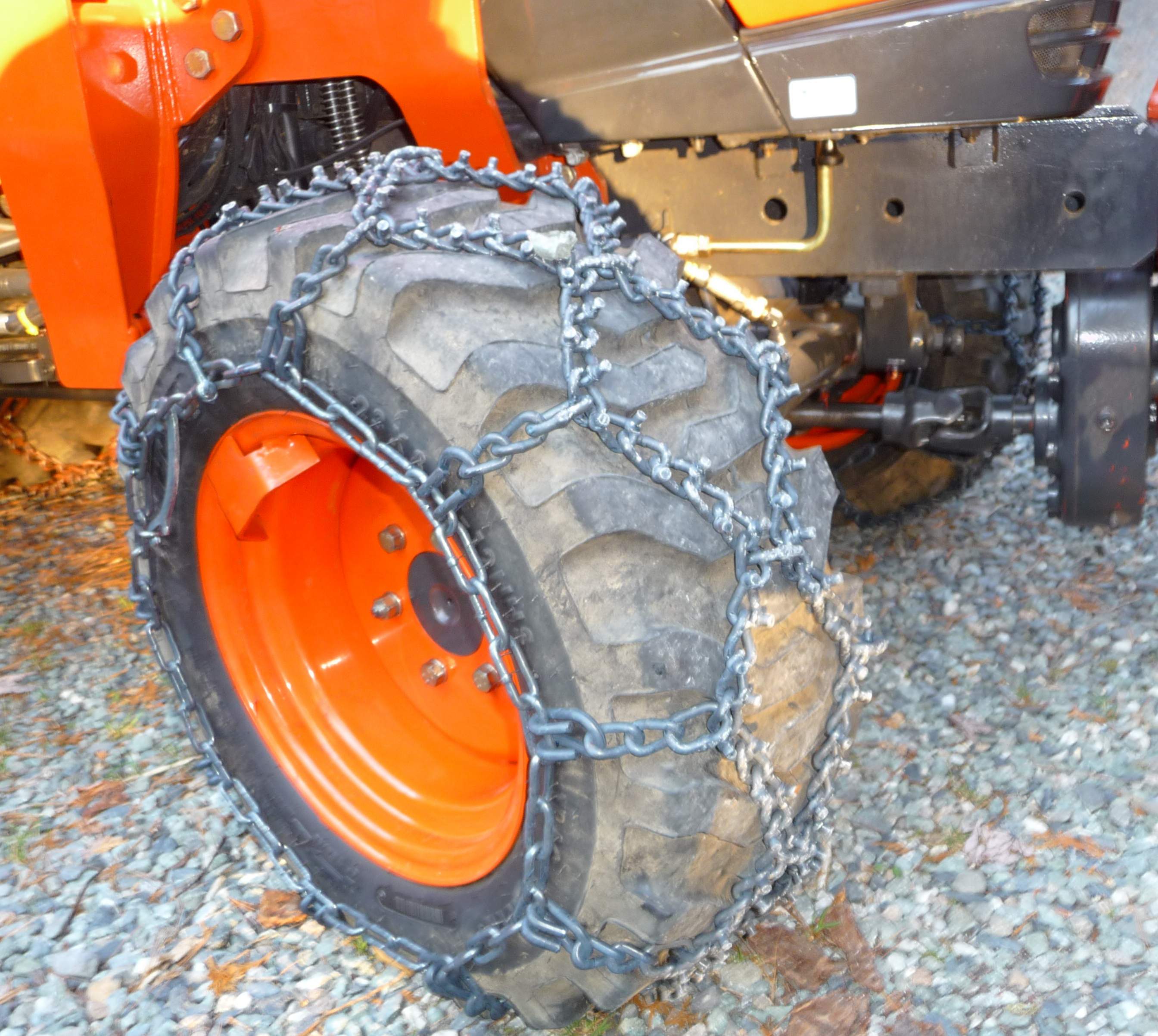

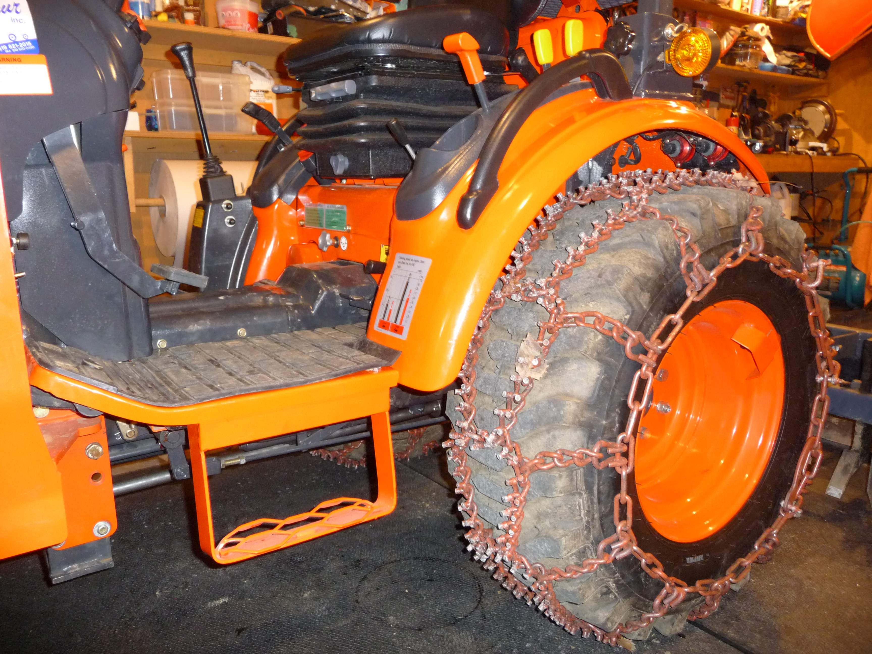

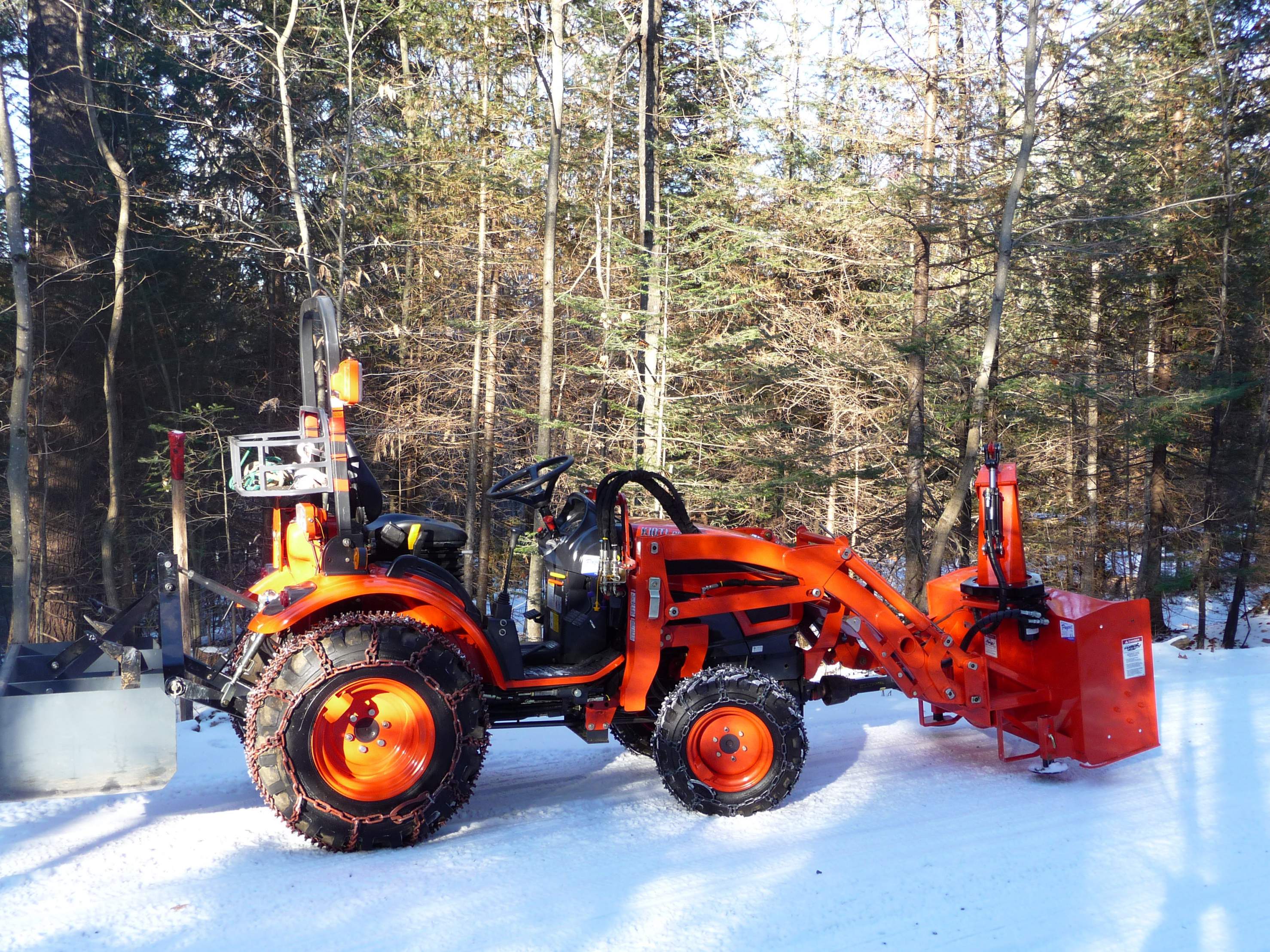

To me that would come down to the price and condition of each set. A like new of either type would be better then a worn out set of the other.
My personal preference is to have the most aggressive chains on the rear and something less or no chains at all on the front. That is to let the fronts have their ten percent rotation advantage without the chains binding things up and stressing the front axle parts when you get down to the hard going.
I don't have enough experience yet with a 4WD tractor in the snow to say that my current plan works the best but so far (one winter) it seems to be working for me.
