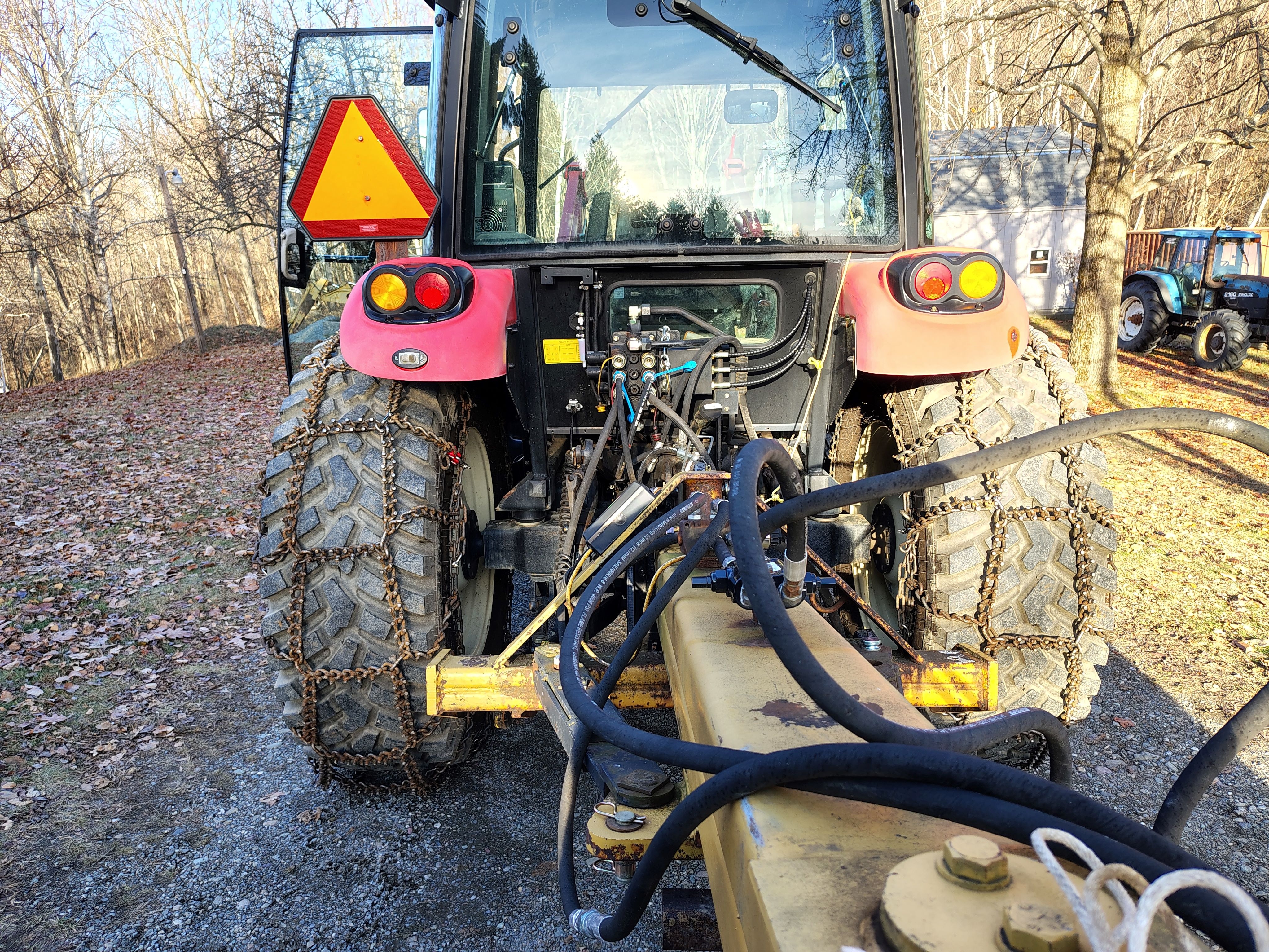

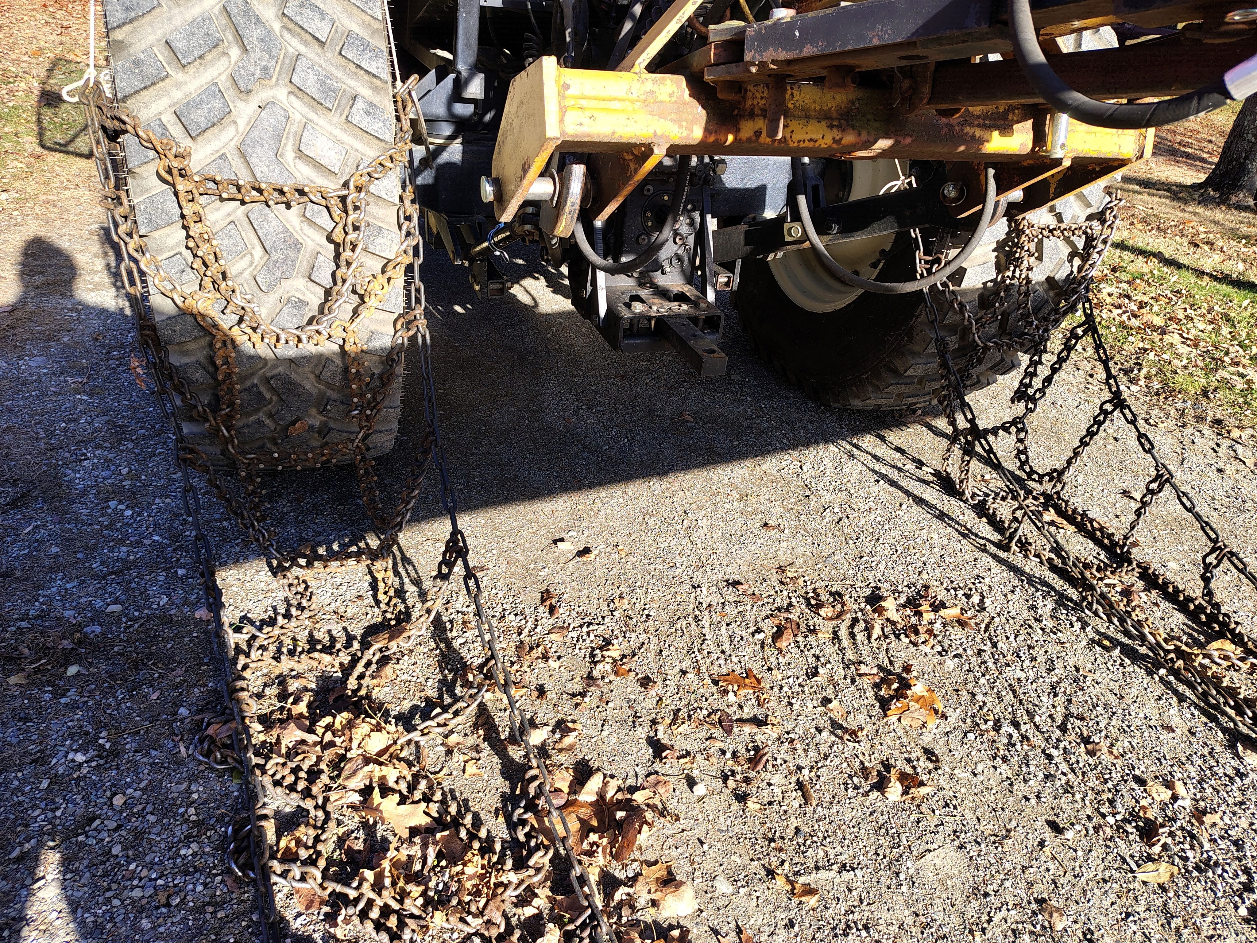

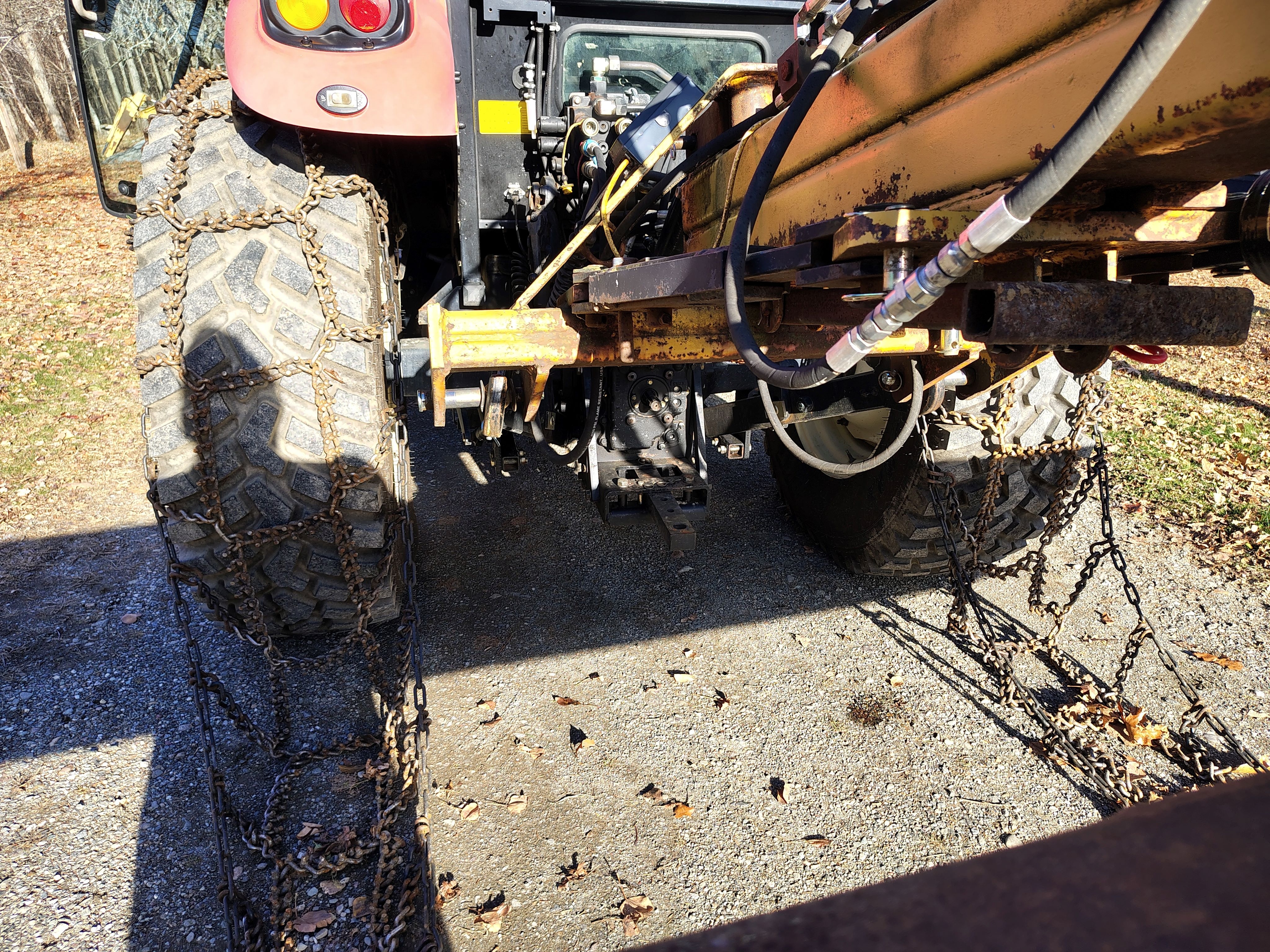

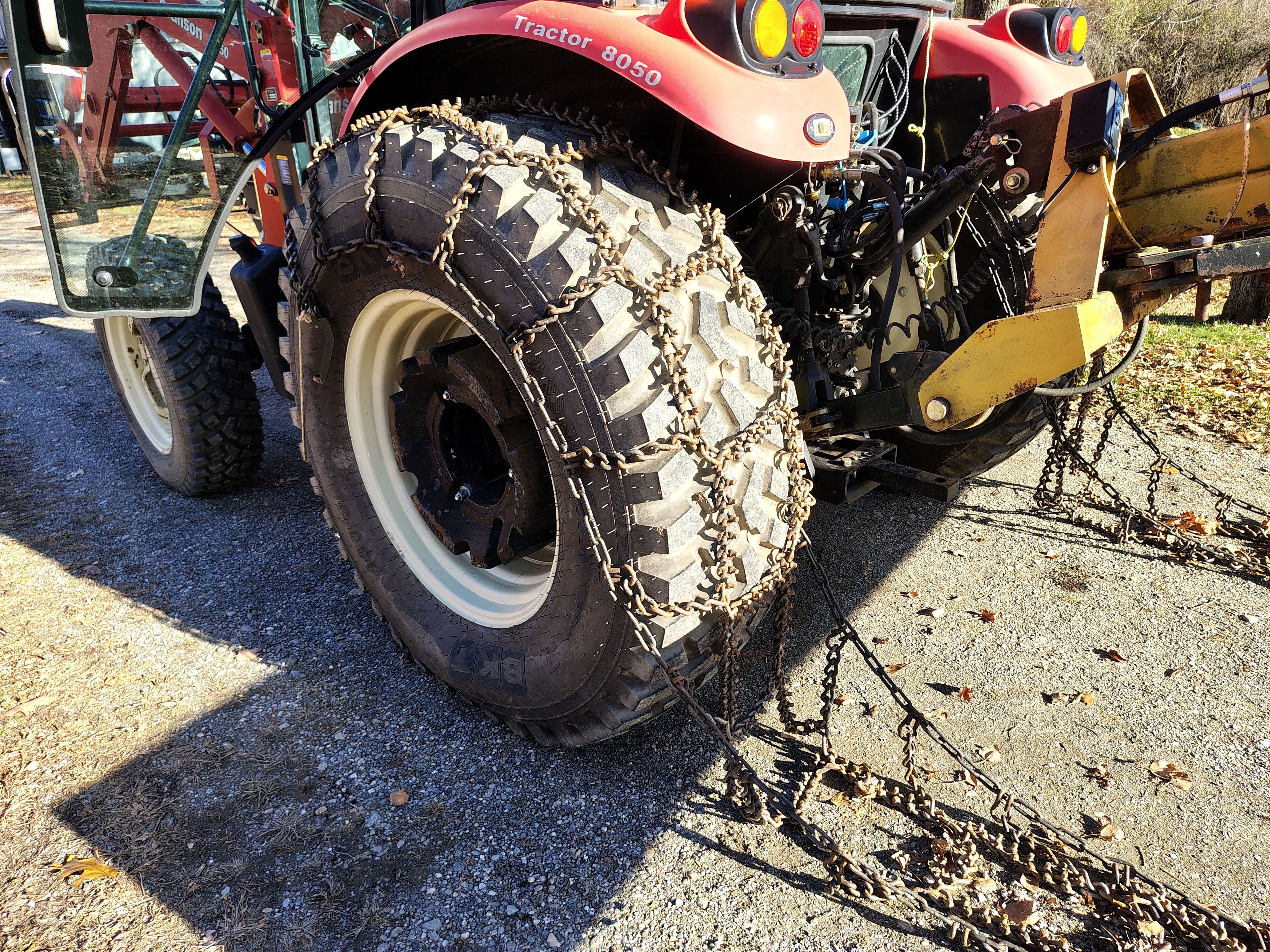

I jack up the rear end of my tractor and slide chains under. Then lift the top of the chain put it on tire and slowly rotate tire. For the front i use loader to lift tires of the ground and do as above
/ Put the Chains on Yesterday #28
That wont work on my rears…man, there heavy.i lift rear of tractor, leave unit in neutral. I lay chain on ground behind tire. I place end on tire and then spin tire . This pull chain up unto tire. Than place tractor in low which locks tire from moving. Next link back side of chain then fight to lock front side.
