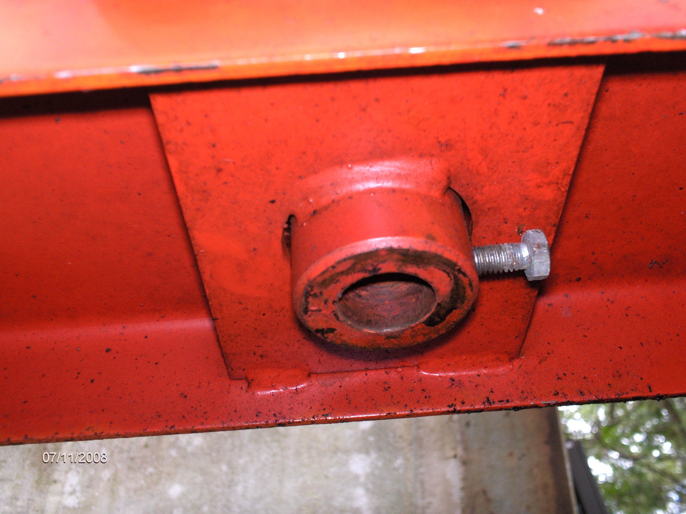

Larry, Looking good. On the seamless tubing, do you have a way to keep the tubing secured to the anvil? On my receiver, I have a bolt in the side to secure the top half .
Thanks J.J. -
Not to worry about the mounting stub, got that secured in place with lead free solder composed of SnSb5, (95% tin, 5% Antimony) melting point is 232-240*C (450 - 464* F). SnSb5, has good shear resistance so it will not come out under normal use. If for some reason you ever had to replace it, just heat it up and slide it out.
