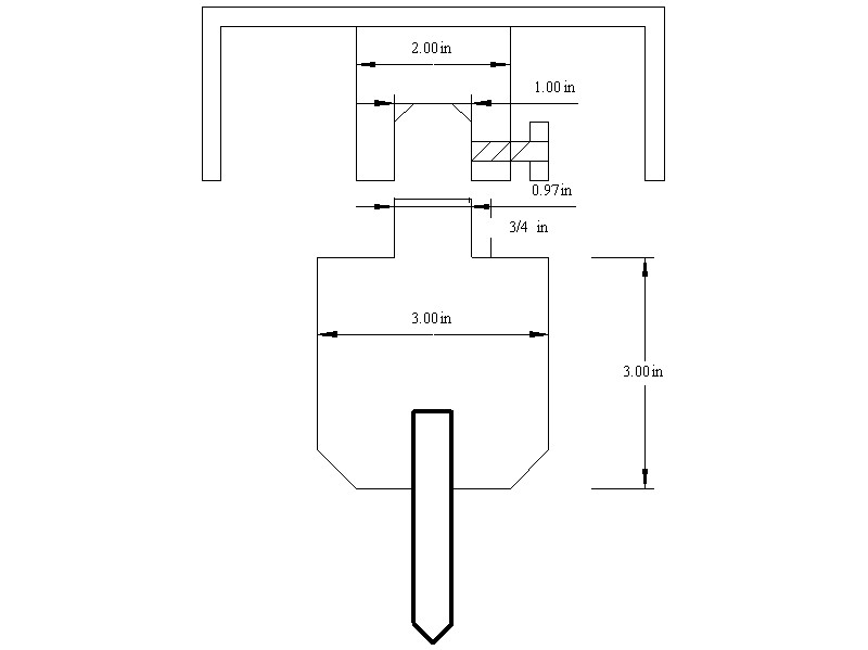

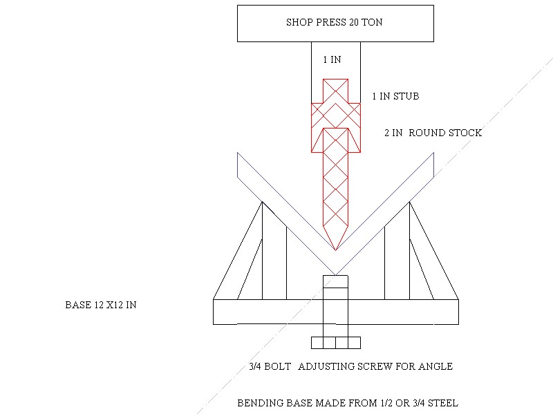

GuglioLS said:
J.J.,
The channel is 4" wide. The die I made is 4" X 4" square. Do I think it would bend 1/2" x 4"? On a 20 ton press it would be close, maybe right on the edge of it's limits. You are correct in that it did bend 1/2" x 3" hot rolled flat bar, the 20 ton air over hydraulic bottle jack was straining a bit. 1/2" x 4" would be a close call. If not, the width of the die could be increased to 5". I think for sure it would bend 1/2" x 4" that way, but of course the radius of the bend would increase a bit.
In the video you quoted me on, that was a test piece of 1/2 x 2.5" if you go back and listen to the sounds of the air motor on the test piece and compare it to the sound on the 1/2" x 3" wide bar (page 7 reply# 63) there is a noticeable difference in the load on the press motor. If I had a scrap piece of 1/2" x 4" I'd try it out for you to find out for sure. Did you still want me to make you an Anvil? if so I need a picture of your press and the O.D. of the stock anvil so as to machine one to fit.
Larry
LARRY, Can you do something like this?

J.J.
How about something like this?:
The base plate is 6" x 6" x 3/4" thick (1/4 the size and weight of your proposed 12" x 12" base plate). It would still do job, be less costly in material and shipping plus more manageable to machine. Gussets could be welded on the ends just like I did to make my el-cheap-o die out of 4" channel. Is the 1" ID counter-bore at the top of the anvil correct? or does your press have a 2" OD stock anvil? OH and your idea to use a 3/4" Bolt to set bend depth / angle is a really good one. This design will produce a 90* bend without the depth bolt screwed in. I think this anvil and die combination will work just fine on 1/2" x 4" flat bar stock and smaller. I would still back it up with press plates underneath it. Let me know what you think........
Larry

Most pre-CNC benders, used an adjustable pushrod.
Do you know these hydraulic bottle jack with a screw inside the plunger, to lengthen the jack ?
Well it was kinda that principle. When adjusting the screw, you could adjust the maximum stroke. The stroke results in the bending angle.
/ Landscape Rake Build #144
GuglioLS said:
J.J.
Larry
This is an update on the anvil after our talk this morning.
