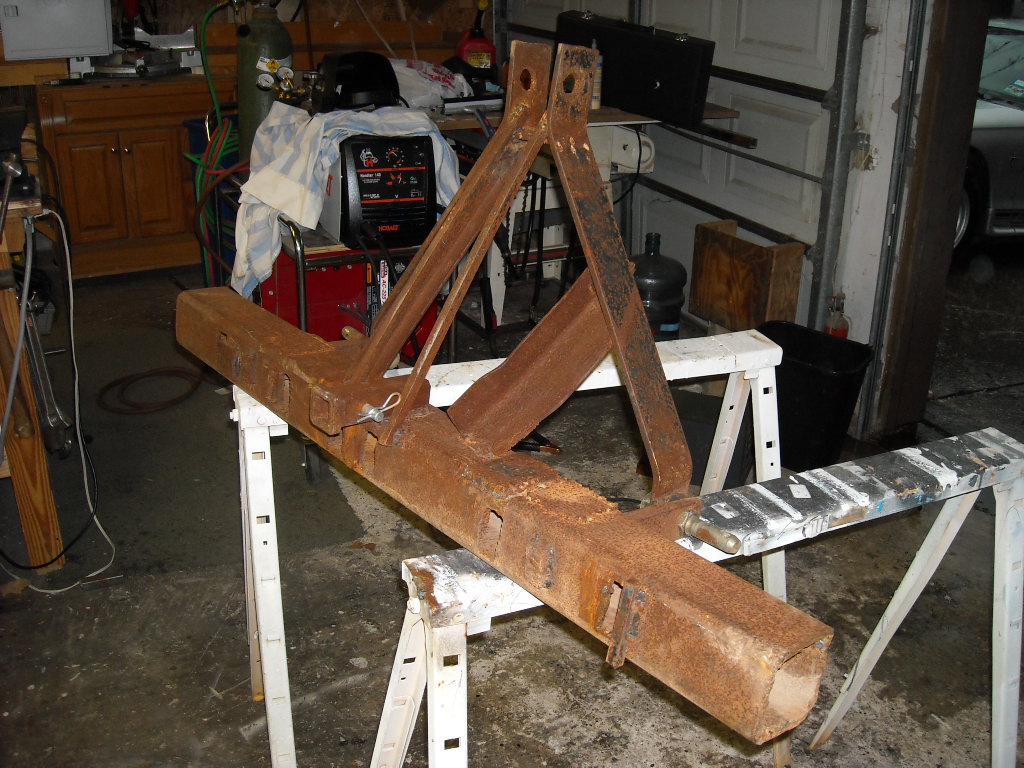

Here is the latest progress report for the perpetual rake build...
The Index plate needed some machining, two holes for cylinders needed drilled to 1.00" and the center hole bored out to 2.4375". The bar that holds the rake tines needed two 1.50" id holes to insert some 1.0" ID X 1.5" OD DOM (Drawn Over Mandrel) A.K.A. seamless tubing, this will be for cylinder pins. Unfortunately I failed to cut those holes BEFORE welding the darn thing up. So I had to carry it onto the basement and clamp the monstrosity to my machine. It really wasn't that hard to do that ;)
The DOM tubing will be welded in place at a later time.
Larry

Next it was back to the TPH saddle mount. I finally welded on the arms and test fit the 3/4" top link pin and the 1-3/8" hardened chromed pin used for the swivel offset feature.
Short video showing the fit I was able to achieve on those two pins.
I am so relieved those pins fit and slide in out as well as they do. Taking the time to make sure everything was accurate really paid off.
Larry

Next is to build a mount for the swivel / offset cylinder. That was an entire project unto it's own, 15 shots of that bad boy. First was to fit a 3/4" thick x 4" wide flat bar into position, transfer holes for the cylinder mount, drill and tap four 1/2-13 holes......
Then cut at a 43* angle to match the angle of the arms. The parts were small enough to into my blast cabinet filled with glass beads. A before and after shot of that......
Re clamp the finished parts into position and weld.....
Larry

Time to make a 1/2 thick washer 1.66" ID X 2.5" OD. That washer will slip over the top of a piece of pipe being used as a hinge for reenforcement.
See the washer I just made on top of the pipe? Hey, the boom is starting to look like some sort of monster with a dorsal fin. Oh and I put in a couple of grease fittings too.
After all that, I got to weld and test fit the boom into the TPH saddle and test mount the swivel offset cylinder......
Amazingly, everything seems to fit.
That's it for this update -
Larry
