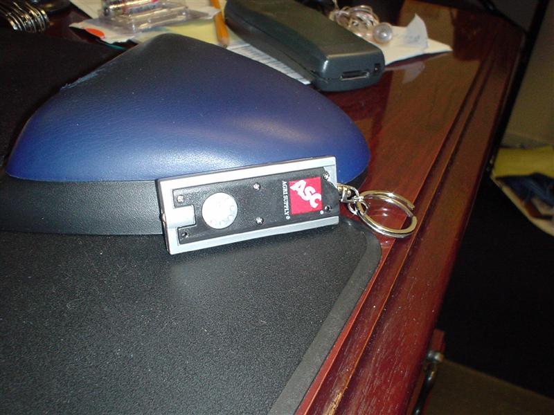

Ok Larry I guess it's still raining because we haven't seen that rake work yet. Tell me you are actually going to use it!!! :D
But on a serious note, did you get the secret decoder flashlight key ring with your tines from Agri Supply? I re-found mine and here it is. Ok note to ASC..do not put little LED light, in an envelope, in a box with 30 tines. You can see it took some damage. I ordered 5 extra tines recently and will see if I get another.
Rob

Rob your cracking me up. Well no, I did not find my little decoder flashlight in my two boxes of 42 tines that were torn and falling apart. Of course I didn't look, was I supposed to? Oh thanks, now I feel like I got jipped. I did just order some stuff from them, (replacement quills, jack shaft, bearings, mower blades, belts and the like) for my little Murry hydrostatic 42" riding mower which I use for the tight spots around the house. I'll be sure and look for my surprise.
