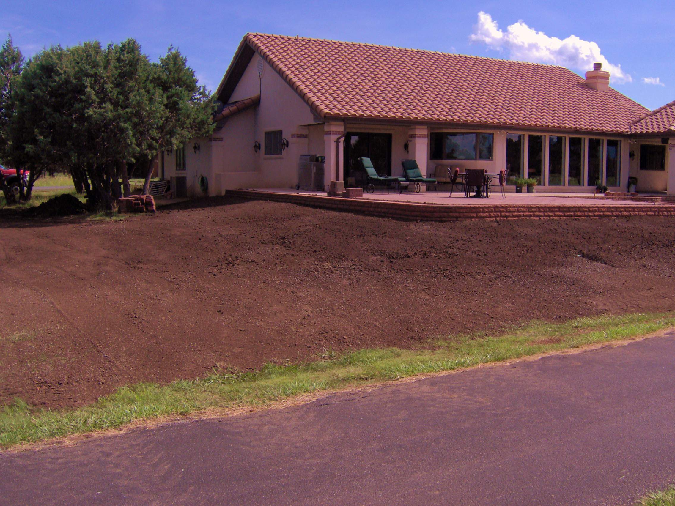

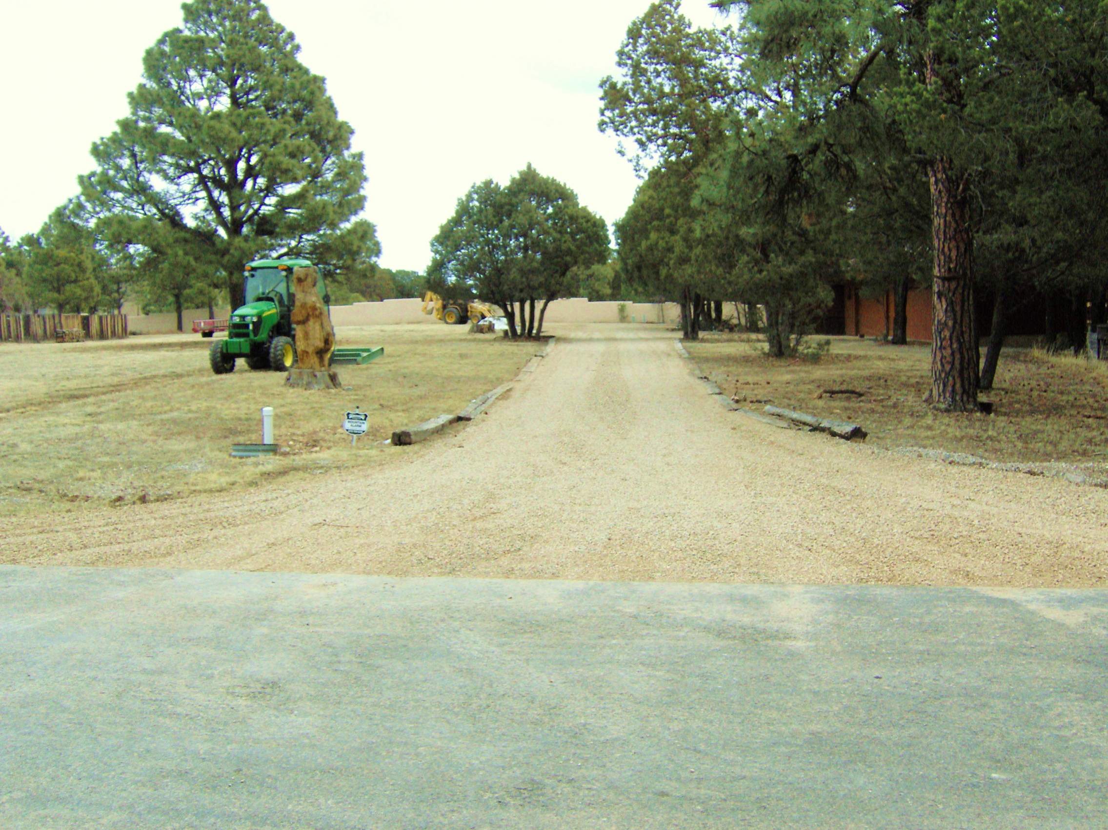

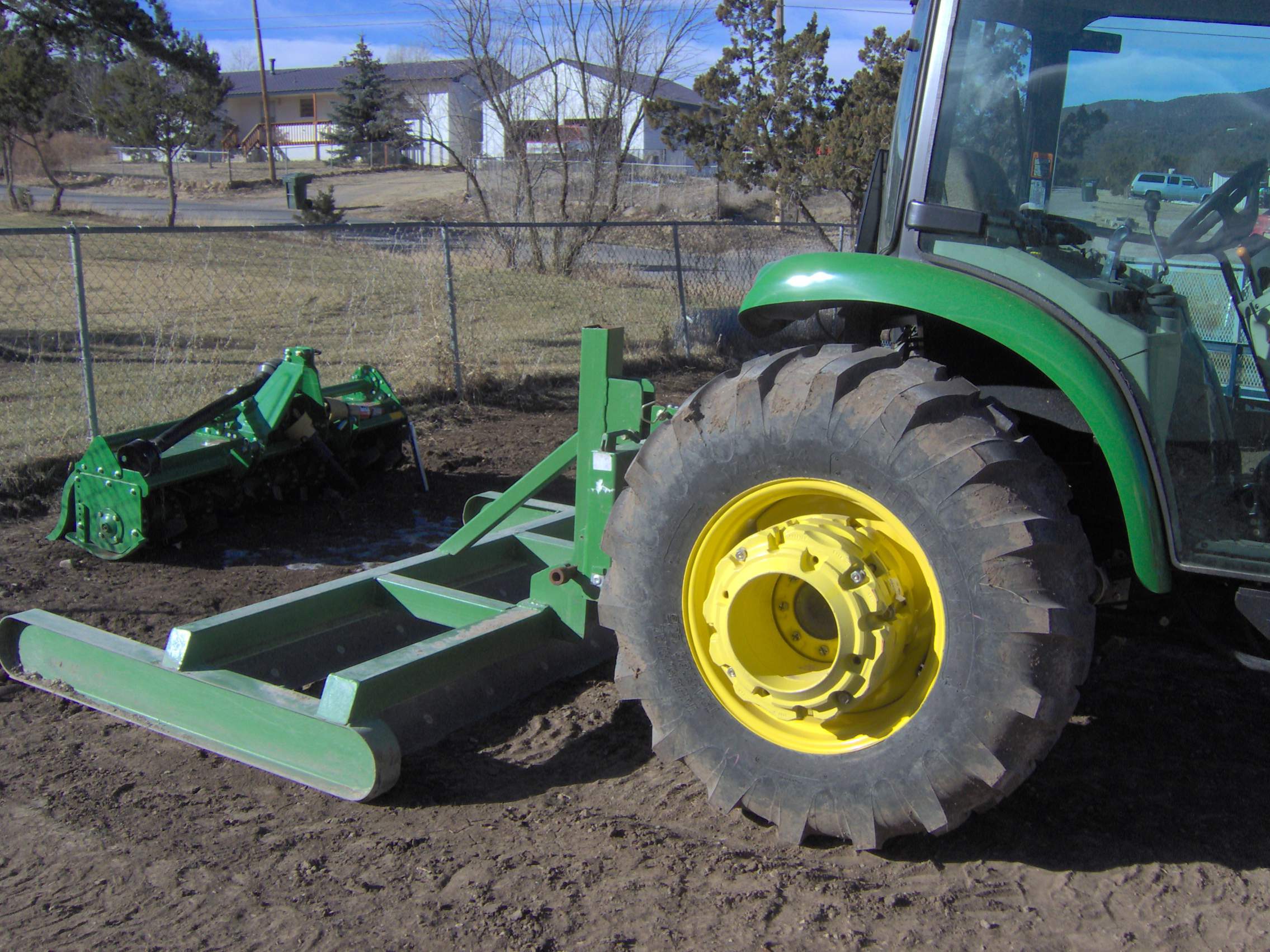

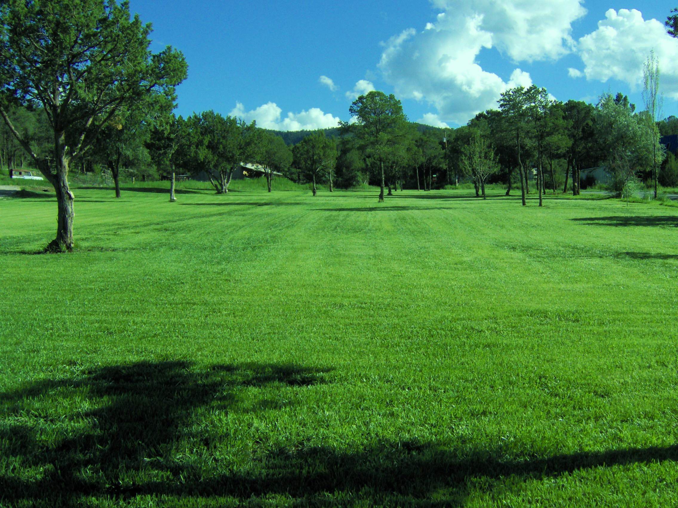

John,
I like the idea of having the water tank for reducing the dust and should add that there are times when adding a little mositure will be handy too. Nice build:thumbsup:
I use my land plane primarily for lawn and pasture smoothing and maybe 5% of my work is gravel driveway work. I find that setting the blades straight and even with the skids works the best. The sheer weight of the land plane will enable it to cut enough for smoothing out a field.
Here are pictures of my larger land plane I built in 2009 and a few pics of jobs I used it on including my rear lawn. Really helps smooth up the ground.

I was going to put both blades level with the skids at first but most advised that some cutting was required?? Any way drilling two more holes is all that is required to make the front blade level. I am just about to take it out and use it so we'll see. I have a driveway of 1 mile and lots of tracks that need work also. It will get lots of work as the kids cut up the tracks with the motorbikes and quads, little buggers, but gives me an excuse to need these toys:D

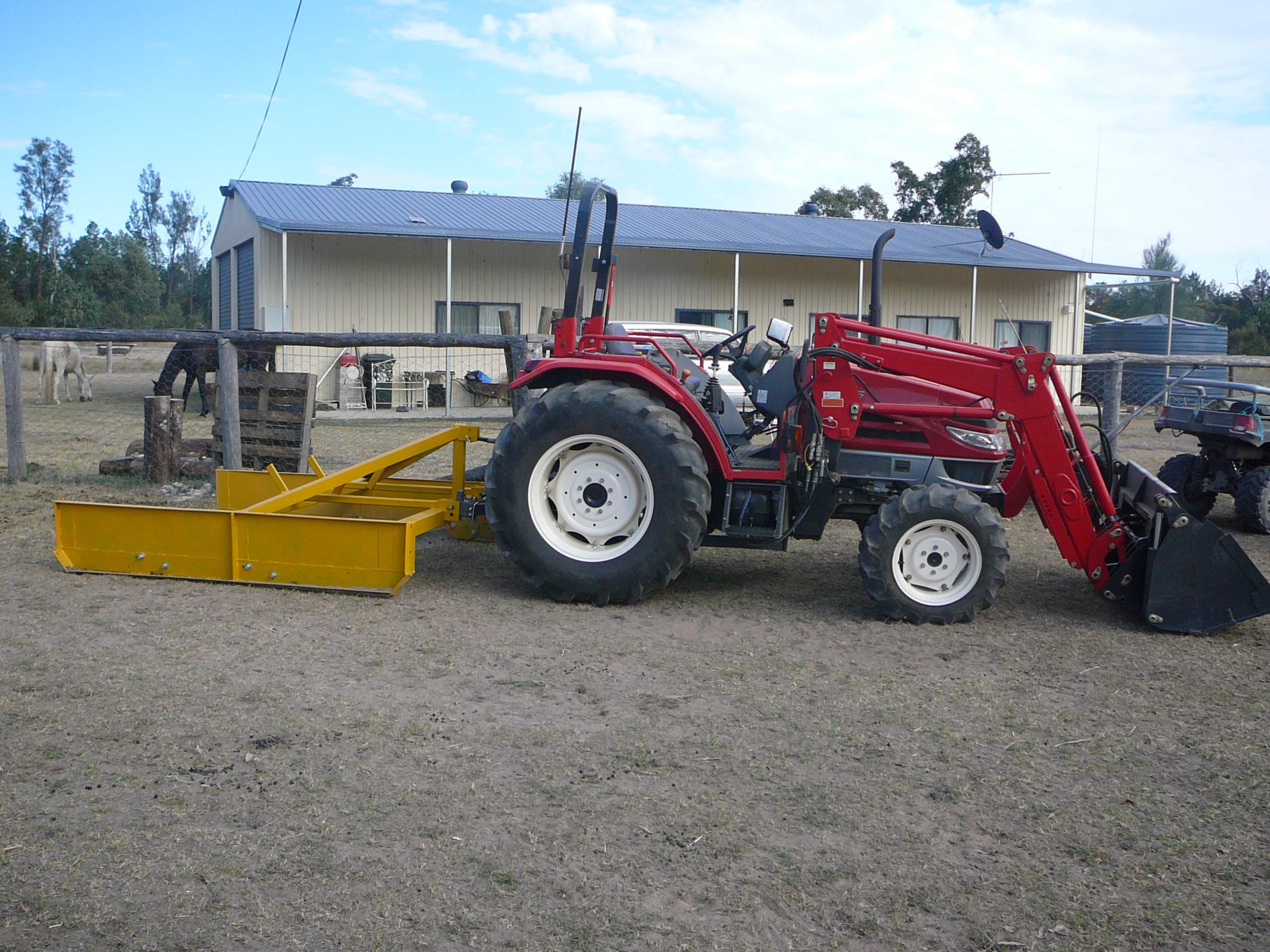

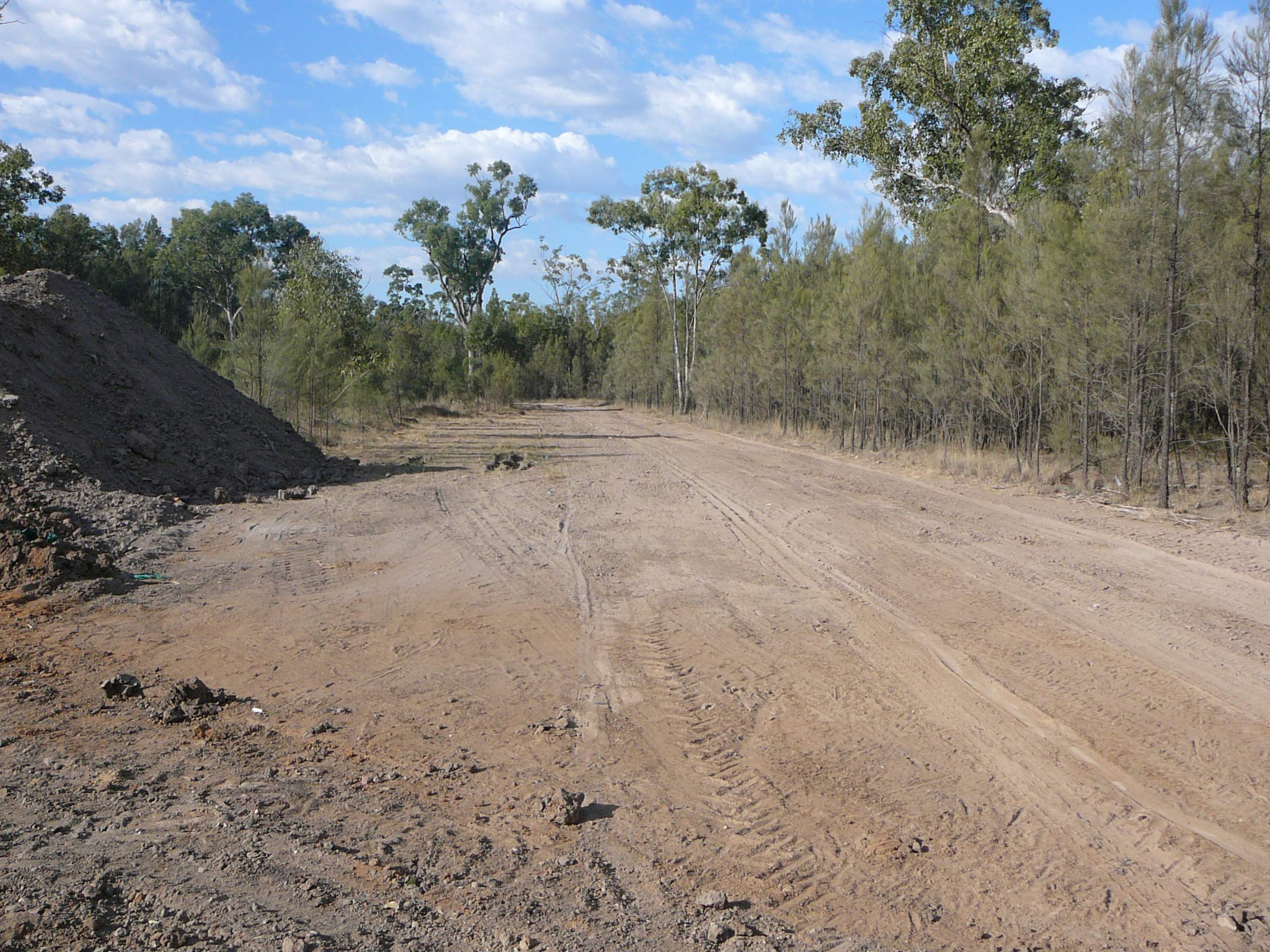

just finished about 4 hours on the tractor using the land plain. Works well, I thought at 8' long I would be able to use chain top link and just let it find it own level but not the case, as the front blade digs and cuts (at 10mm down) it has a tendency to lift the back so I had to use the solid top link to keep the back down. Didn't use the extra weight of the water drum, that may help with keeping the back down if I used a chair again but I didn't need to adjust the linkage much so I think I will just leave it this way.
Did a good job, this is a small section of one of the tracks
I found that after a couple of passes cutting then a pass in reverse smooths out the soil really well.
/ Land plain blade height help #45
A little seat time and you will get the hang of it.:thumbsup:
I use a hydraulic top link to adjust the running angle and suggest you try to put this on your list.
