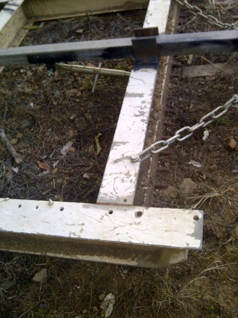

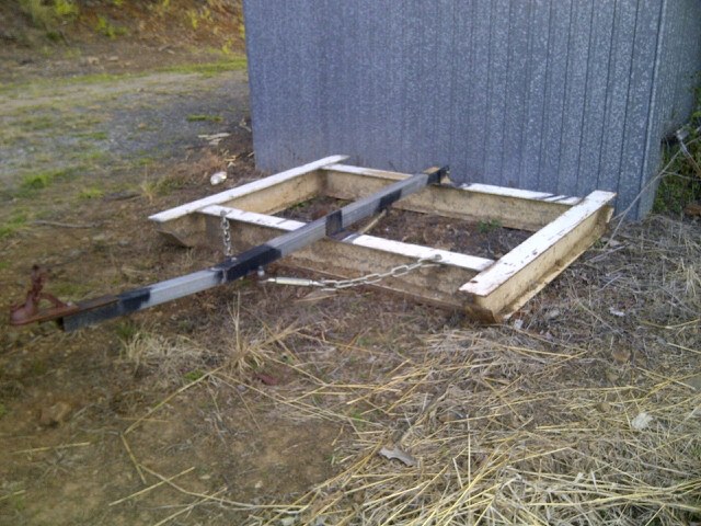

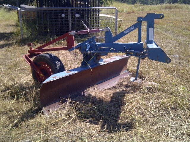

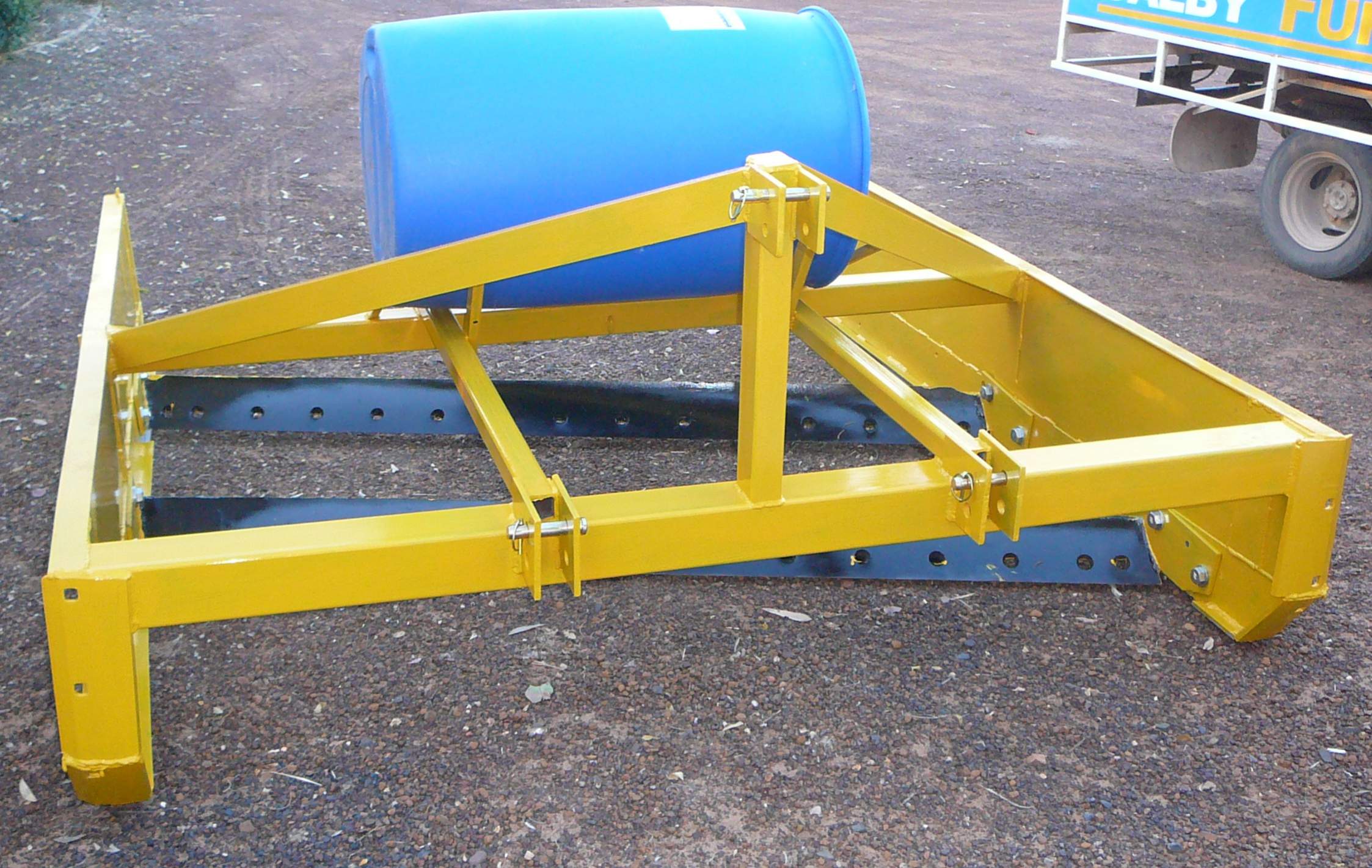

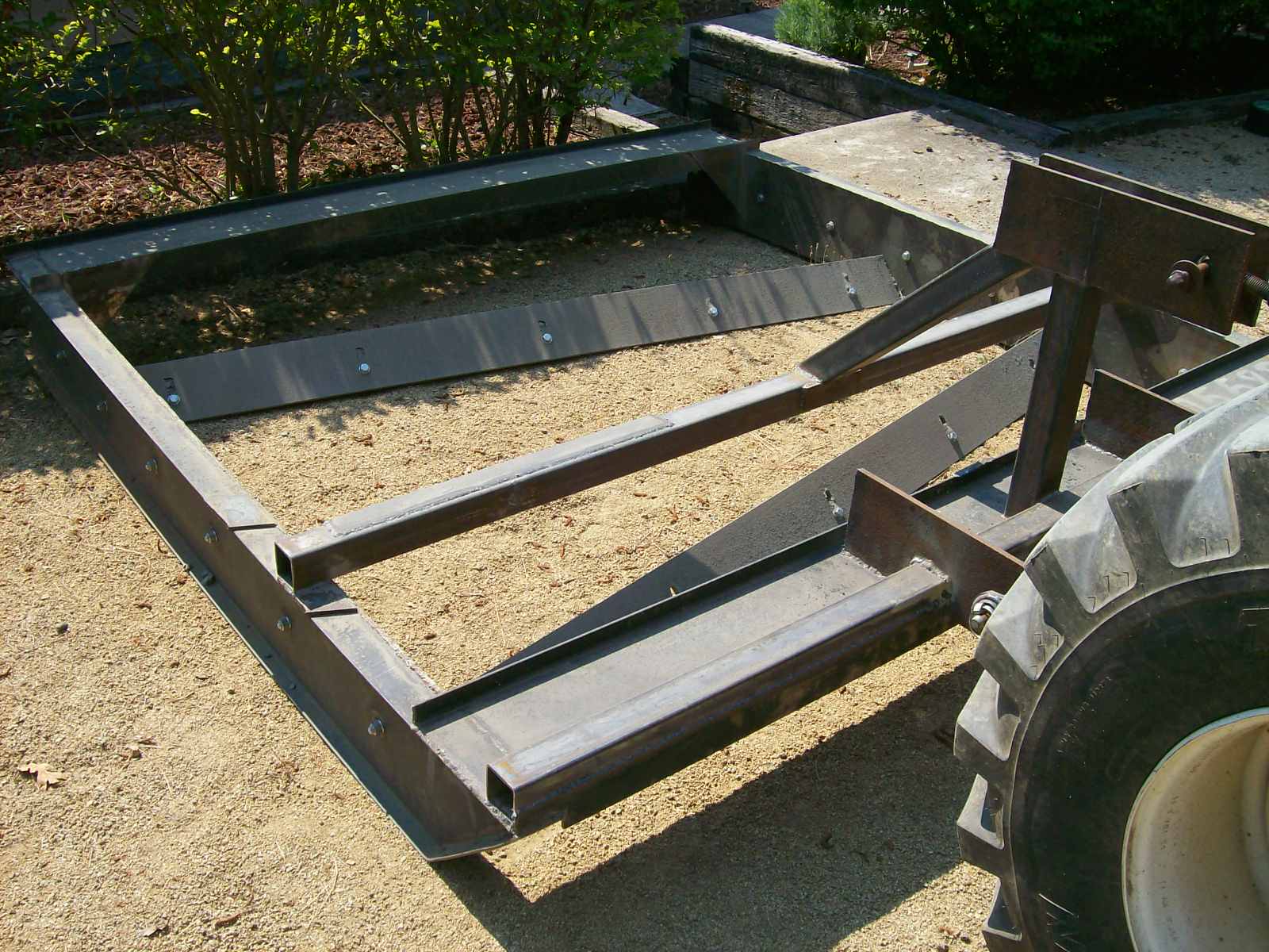

I do like your land leveller Fred - the one i bulit was a quick knockup out of stuff lying around and is still a work in progress. What i like about yours is the way you say it takes the material over to one side to create a crown, handy having the adjustable cutters for depth & angle. The only thing i don't like on most 3 pt hitch attached levellers is that (unless I'm missing something) they stay fairly rigidly set (even like the berends one below is fairly rigid, but maybe float mode & a deft hand on a hydraulic top link would cover it) so when you transition between grades (i.e. lumps & hollows) that you want smooth transitions for they either lift off the ground or dig in - I know you can try & feather the lift height etc but thats why I like the tow behind (set & go).
You don't really have that problem, it never digs in much because the runners stop it. If you have the weight and power, you can just put the 3pt lever down so that you get full travel up and down and if you have a hydraulic side link with float mode, then it will pivot side ways and you have your smooth finished surface. The land plane grading blades are nothing like a box blade or a rear blade where you can get wash boarding ^^^^^ or the whoop tee doos ^--^--^--^--^. :eek:

What a great looking build, very well done Rustyiron, and now given me new ideas.

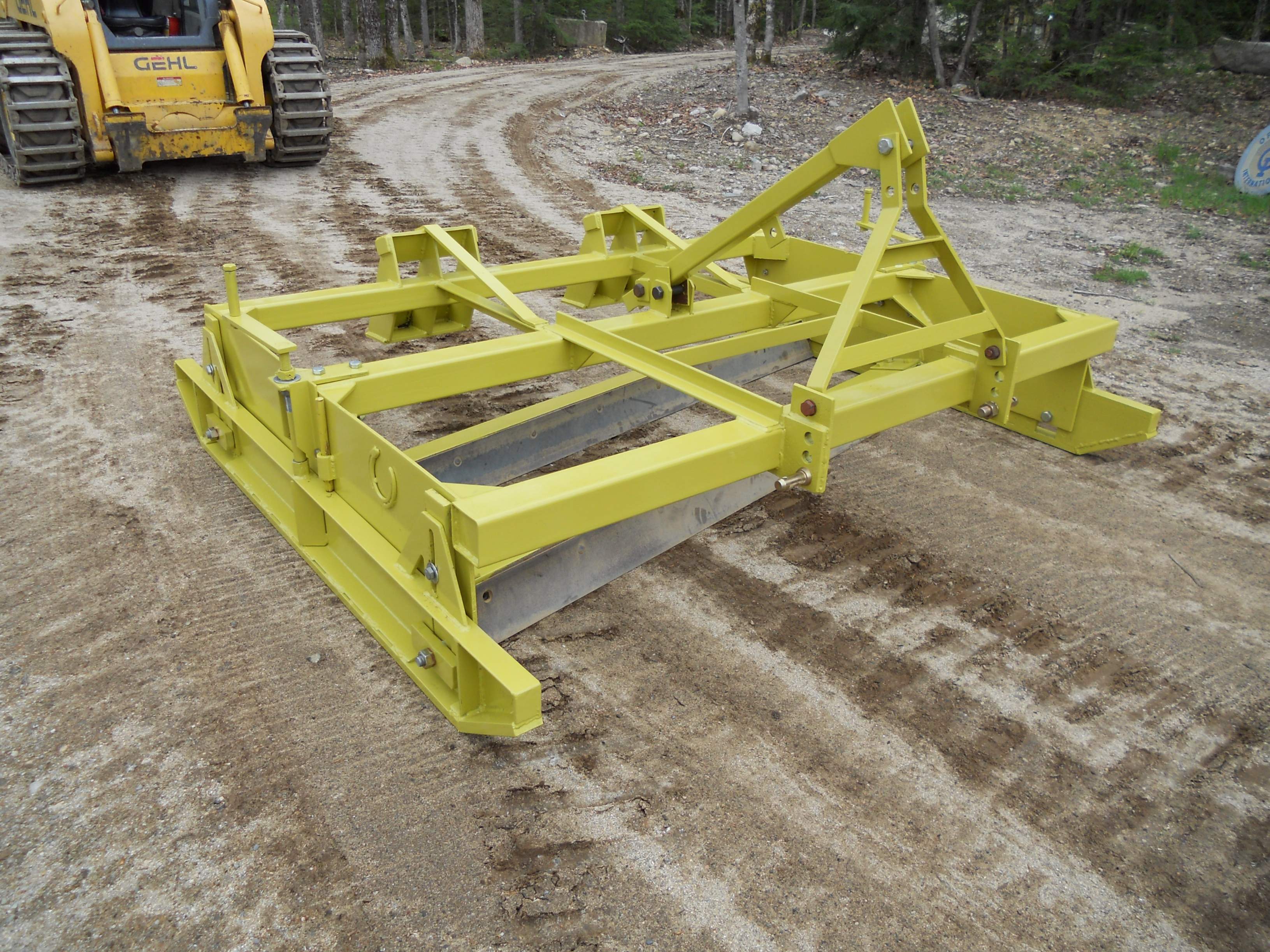

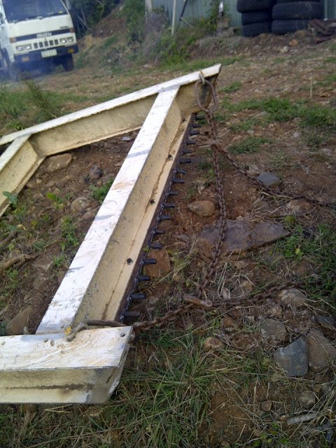

What is the extra parts braced up on the rear and do you have more photos?
I think bukitcase answered my question with his first link. Looks to be a skid steer attachment to be used as a pusher.
Yes, ss mount to push it. Bukit (thoughtfully) put in the links (post 19) of the build where there are more pics. The depth adj. is really nice to have but it does add a lot of work to your build. Even a simple skid shoe that you could adjust up or down in a series of bolt holes would be good, also handy as your cutting edge wears.

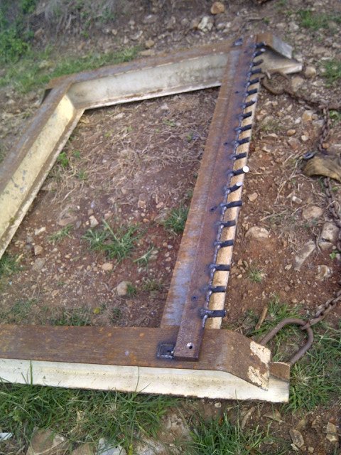

John, are you going to used curved cutting edges?
I really like your LP Rusty Iron.

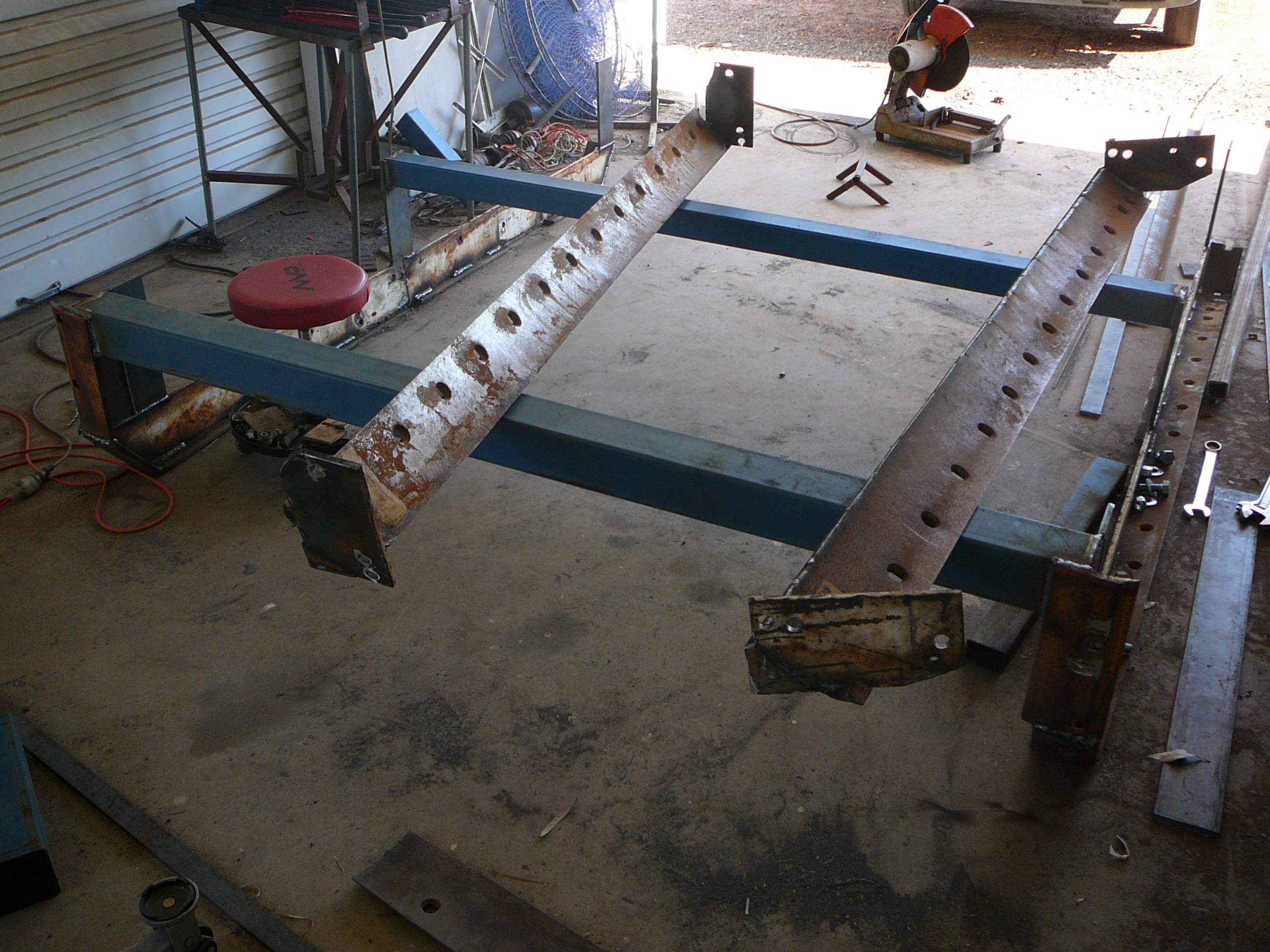

Hi Roger, I'm going to use curved cutting blades. Ex-council used grader blades, they only use one side because of the hole placement so if I reverse them they are brand new edges and better still they were free. I have 5 so I was going to use two turned flat to the ground as the wear side runners, 2 as the cutting blades and may be one as a tailgate that can be locked down to move material if needed.
I think I have a couple like you are talking about. The bolt holes are at the top instead of the middle of the cutting edge.
/ Land plain blade height help
#30
Yes, not sure why they make them like this, stops you being able to use both sides. They must be for different machines with different hole placements. Good for us though, gives an unused edge. :)
/ Land plain blade height help #31
I am not sure how I would reuse them unless I weld them on.
#33
I was going to weld them on to a 3" X 3" X 1/4" angle at the back then weld that to adjustable plates each end so height can be adjusted. I thought it would take a long time for me to wear out a blade so I didn't need to have the blade removeable by bolting on. If I did eventually need to replace a blade I thought I could just weld a new blade on top of the old blade.

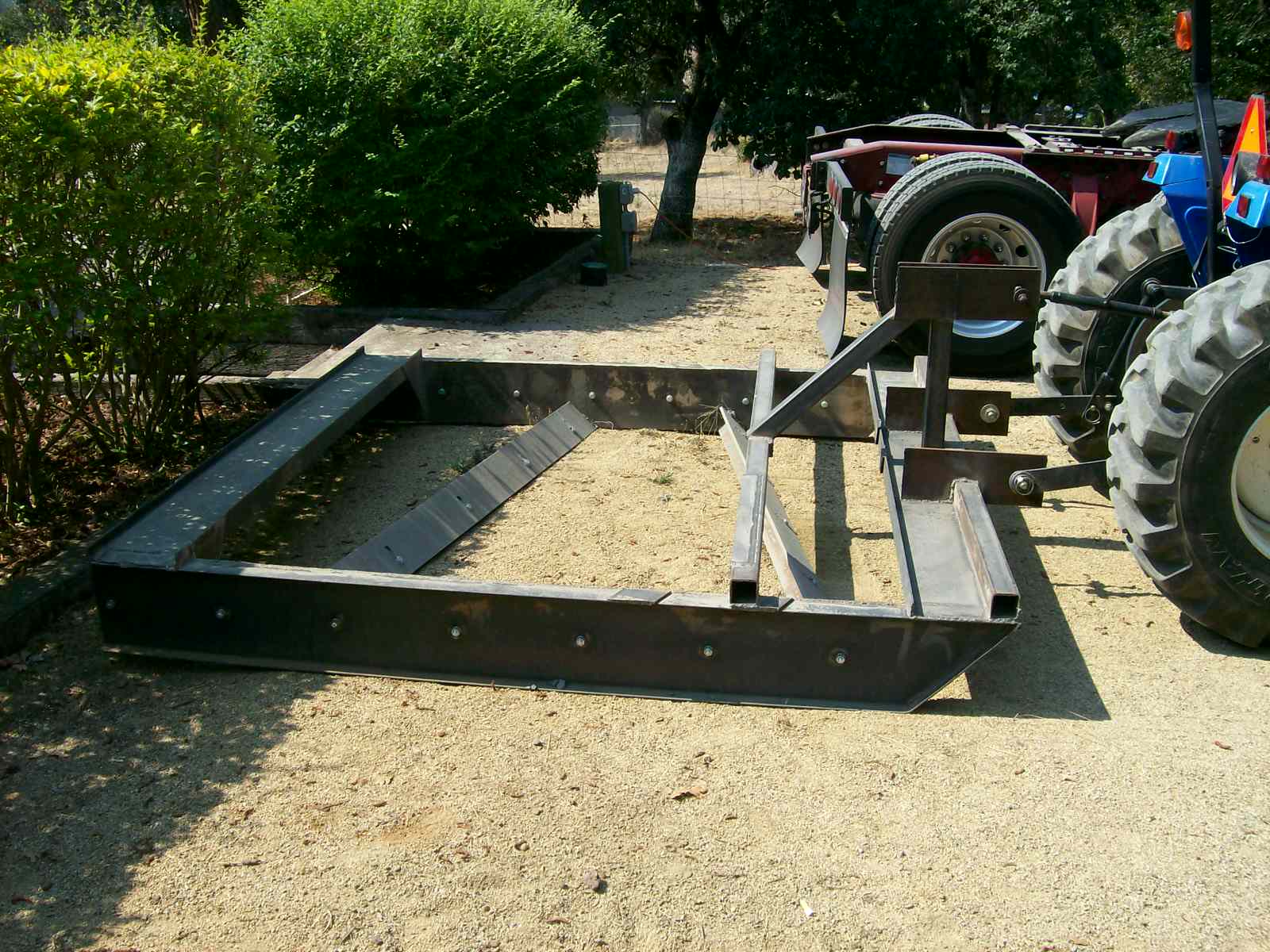

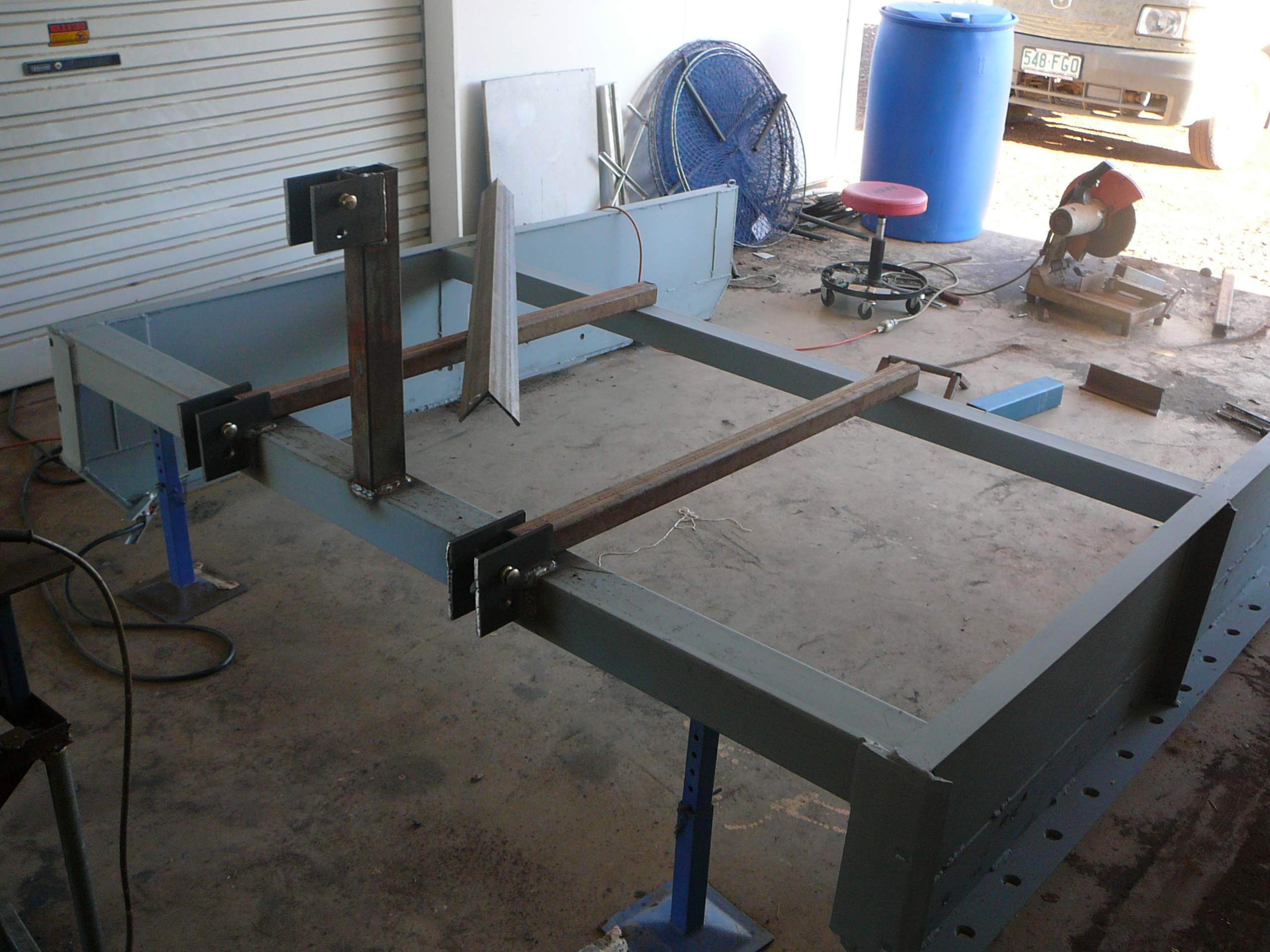

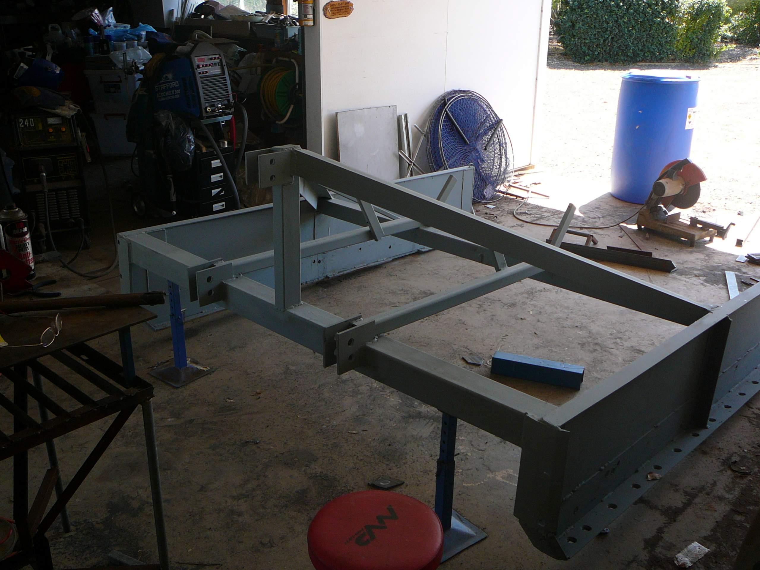

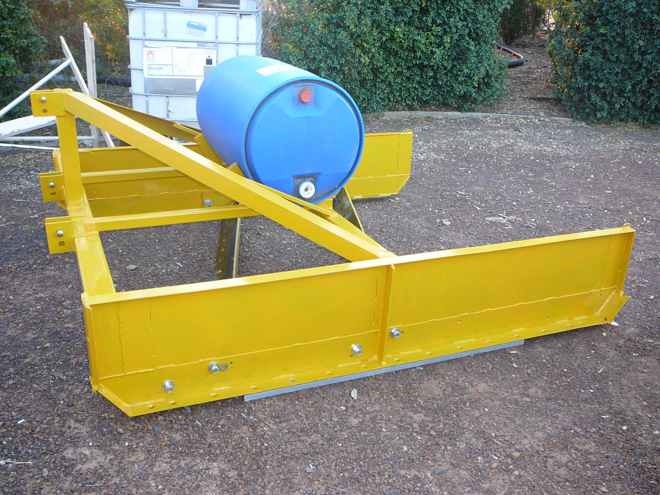

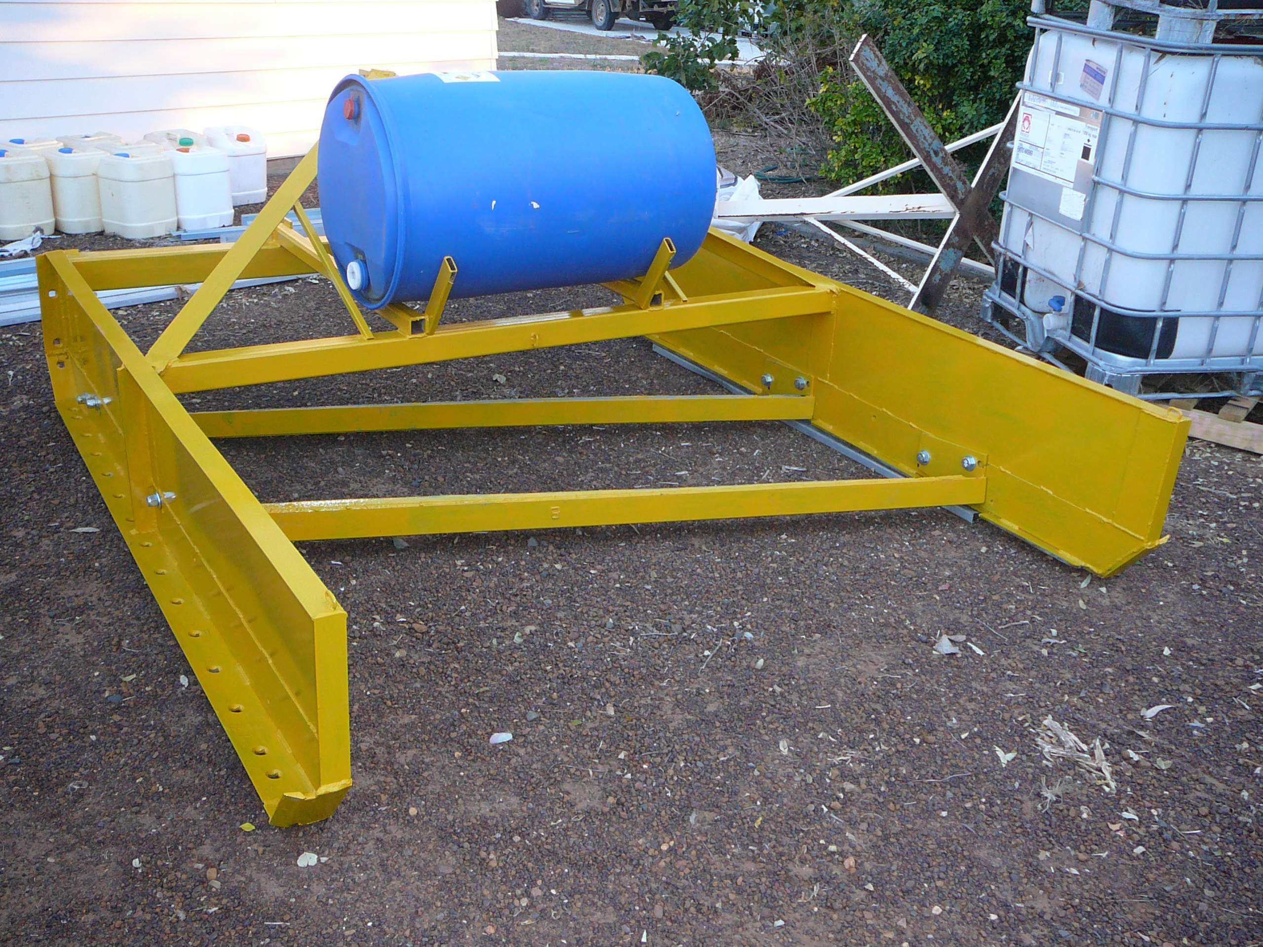

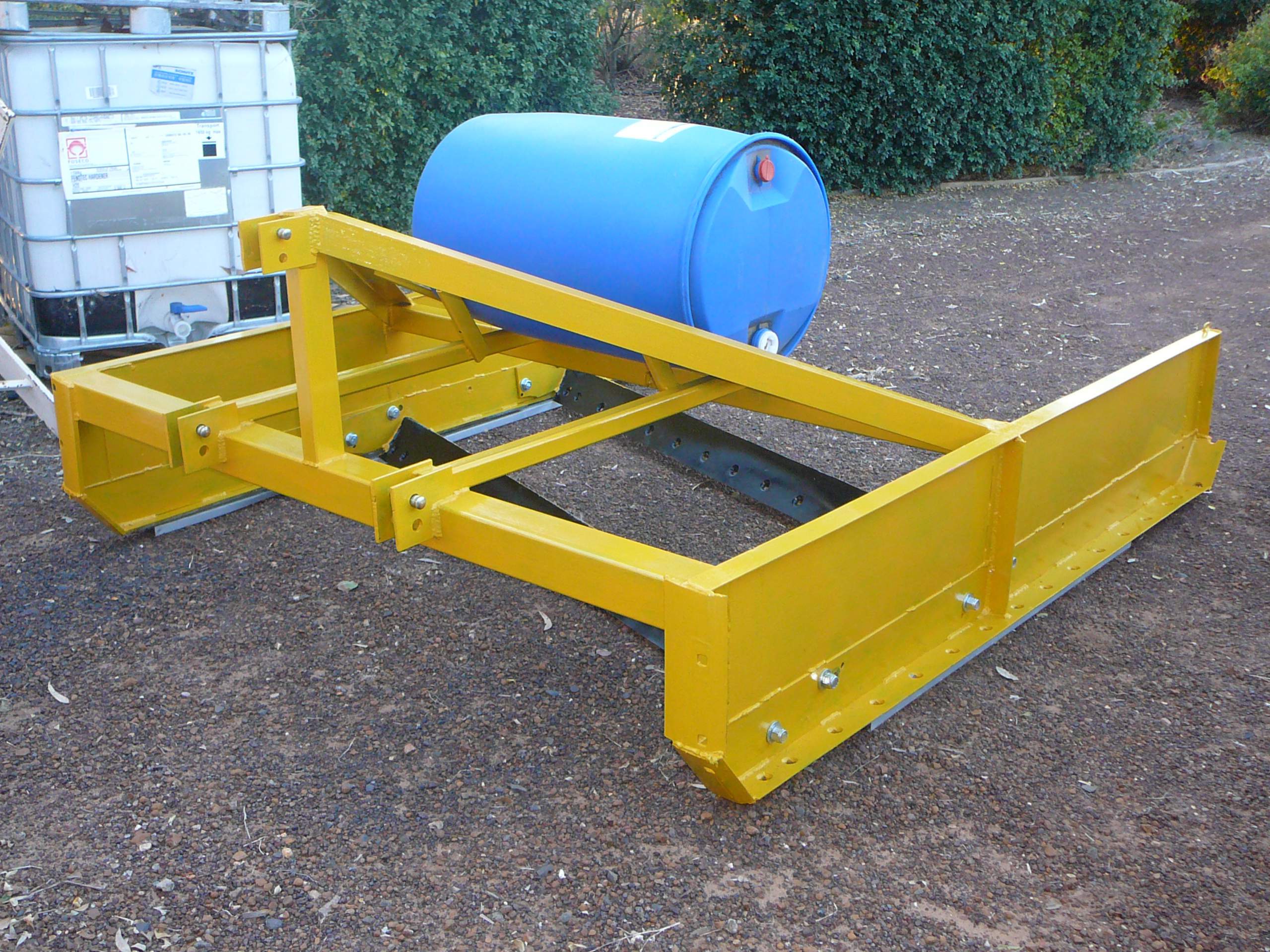

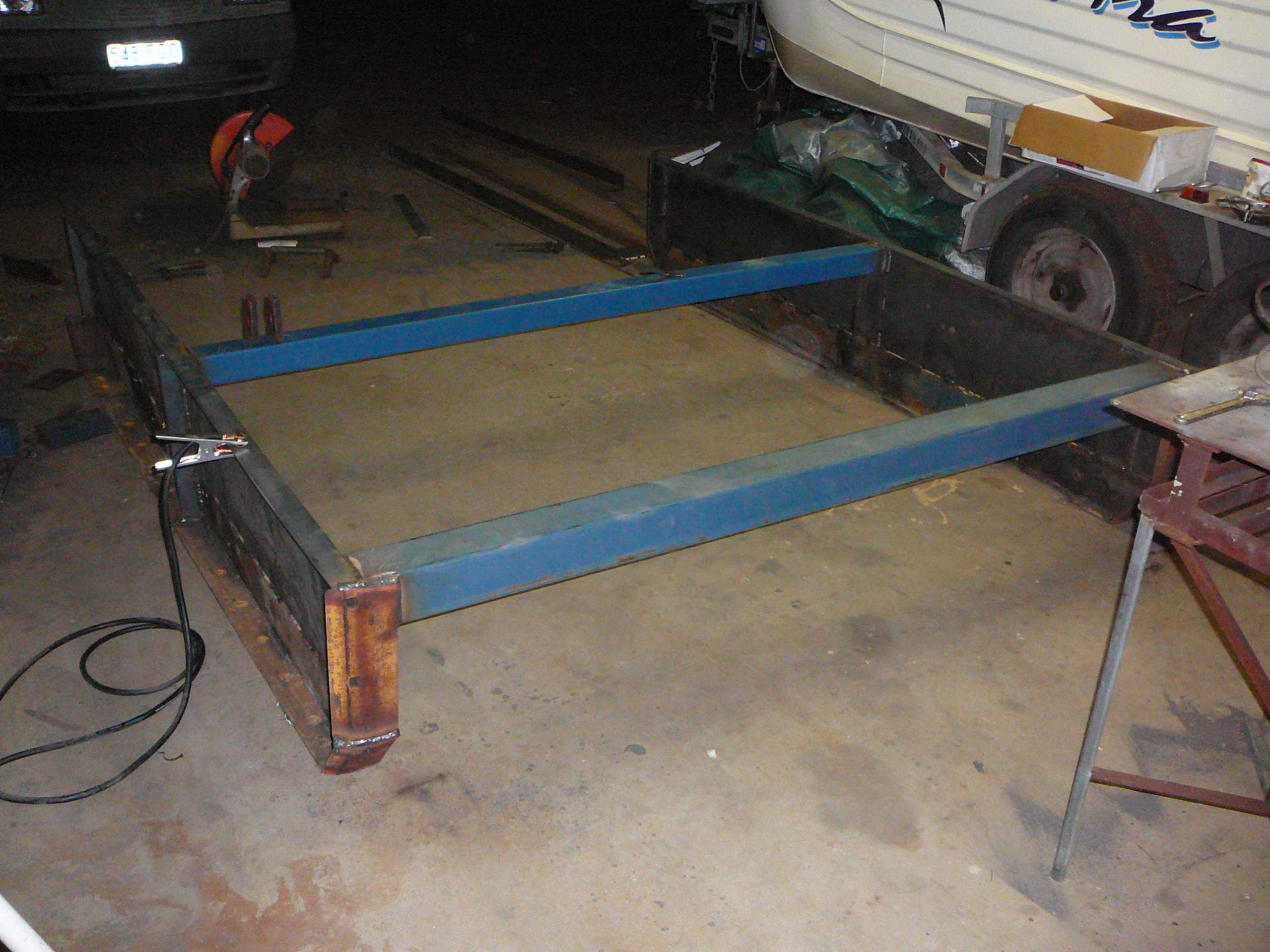

well after a few weeks of night and weekend work I have a finished land plain finally. Just finished the paint job today so I thought I would show some pic of the finished product with a bit of a time line of getting to the end. I used some steel I already had and had to buy some all up it cost about $600 to build. The 5 grader blades that I used were free :) It is 6'6" wide and 8' long estimated weight about 500lb plus the 44gal water drum adding another 400lb if needed. We are in sandy soil so not sure if I will need the extra weight by it's there if I do, just need to fill it.
P1090526.jpgP1090527.jpgP1090530.jpgP1090533.jpgP1090536.jpgP1090535.jpgP1090537.jpgP1090538.jpg
after all the hard work I hope it does the job

The nice thing about the blue barrel is you could add a sprayer to it and do a wet down. Nice job, I will be starting one soon.
#38
What a good idea, I hadn't though of that but would be an easy adaption and with our dusty sandy soil a good option. Thanks :thumbsup:

Good work - I like the storage in your welder trolley too.
Are the cutting edges fixed or adjustable John?
