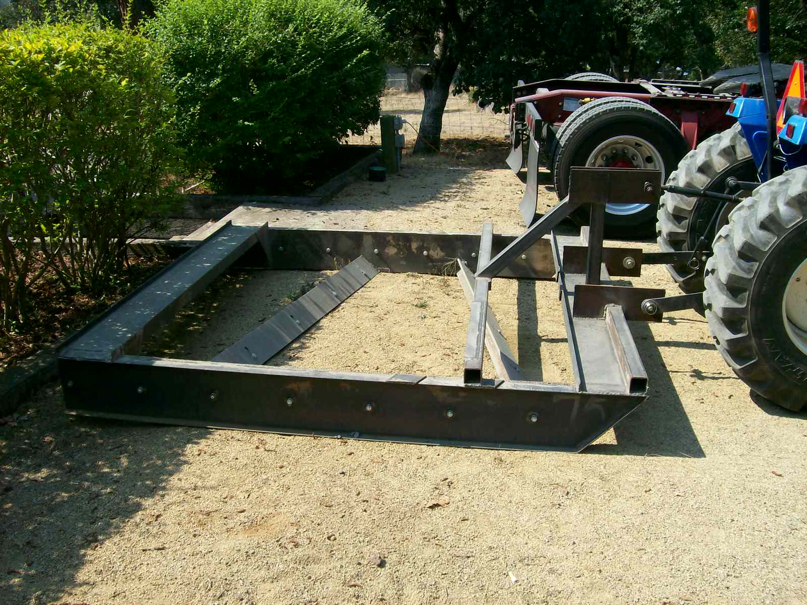

I'm starting to build a land plain to make road ways on our 1000acre property but don't know what height to set the blades at. I intend to make the thing 6' wide and 8' long with 2 blades angled about 20deg left to right and about 2' apart. I will post some pic's of it as I build it.
Some advise about the cut depth of both blades would be a great help. I am not cutting hard packed gravel, our land is quite sandy and this is to tidy up and level the tracks after I push through with the dozer. I am thinking about half inch below skids for front blade and level with skids for back blade. Am I on the money??

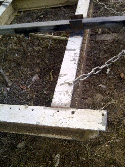

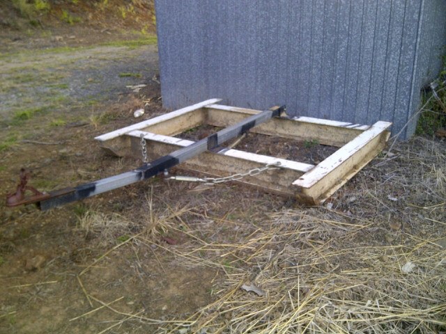

When I made mine I laid the sides on the floor and raised the front about 1". The 1st cross was back aways from the front and it put it down about 3/4". 2nd one I would guess maybe 1/4". Then I put one stright across and if I remember right I think I raised it up about 1/4"off of the floor. I use mine on a gravel road and most of the time I the have to rase the front just a little.
/ Land plain blade height help #6

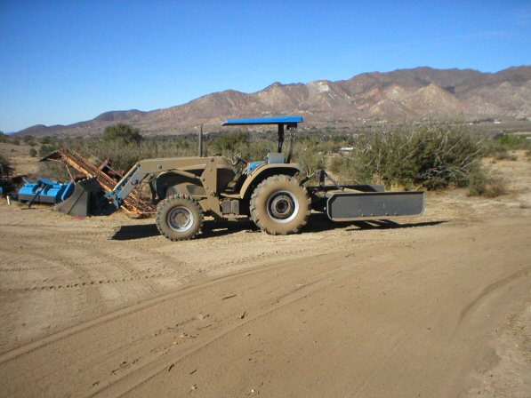

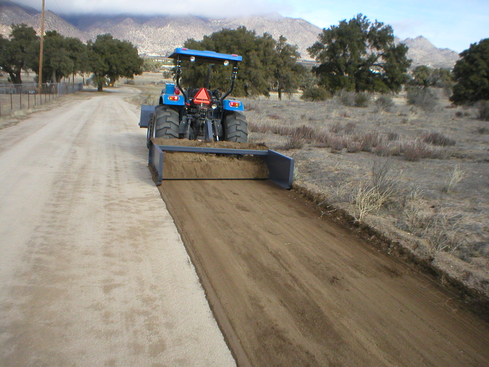

Both of my blades are down 1". I control the digging depth using a hydraulic top link. If you get into some hard ground, you will want both of those blades cutting. Can't do that very well if the back one is set flush. If I were you, I would set the blades at 30" apart. Mine are 24" and one of these days I intend to move the back one out so that they are 30' apart. Just seems like they might work better that way. don't know for sure though. :confused3:

Thanks for the super fast reply's. What's your thoughts on making the two blades angle different ways, one angled right one angled left to move the dirt one way then back again? I was thinking of doing it this way but it does require a lot of space. At 20 degree angle it will fit at 8' long but I have not seen any done like this, is that because it doesn't work?? or just because it require long sides to fit and most I have seen are not that long. I don't have any tight turns in any of the roads I intend to make so 8' length is OK. I was going to incorporate a 44gal drum on it's side on top of the frame over the blades to fill with water to give adjustable weight.

Brian mine is longer then yours and if our road was like yours I think I would want all the blades 1" down. Right now with mine only down real close 3/4" I start popping big old rocks up. My angles on the 1st 2 or more. As long as I'm not popping up the big rocks it looks someone raked the road. Now this road is river run rock and some of the old base rock is big as a soft ball.
You said you use your top link to make it dig in. I can see how that would work good. I just couldn't do that with what I'm using it for.

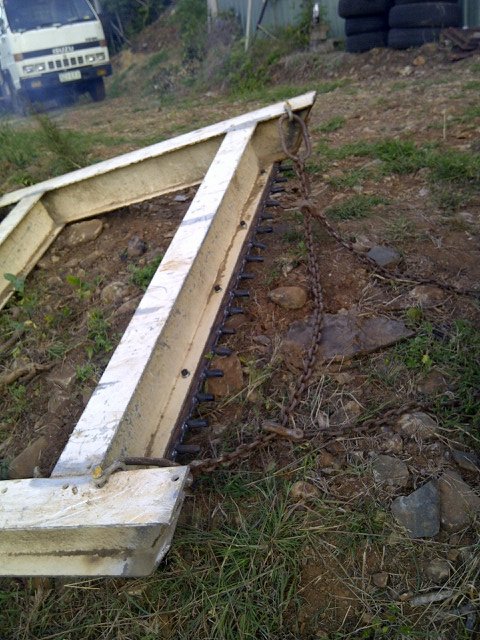

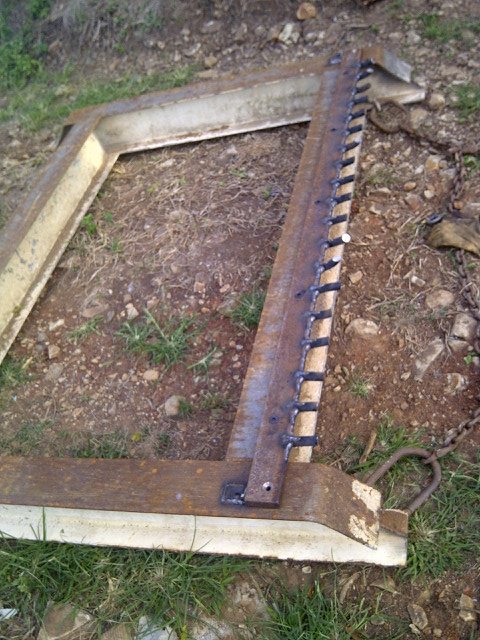

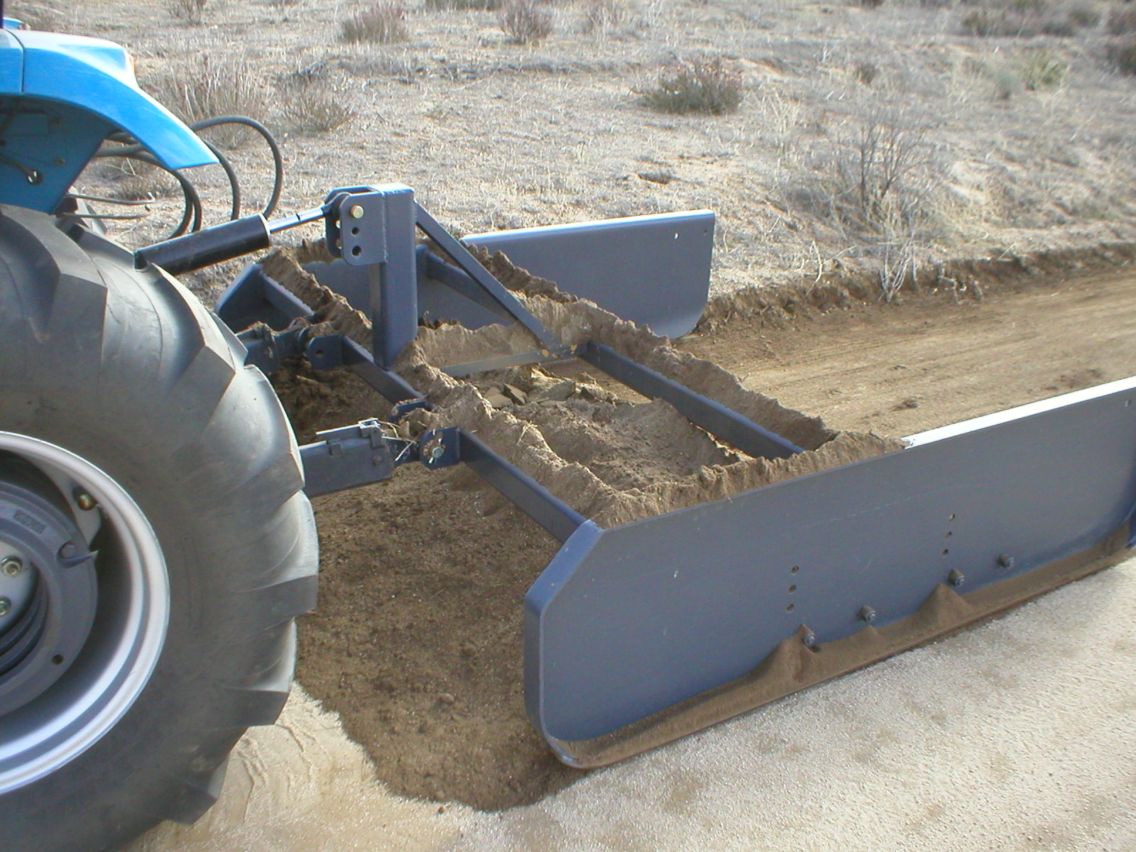

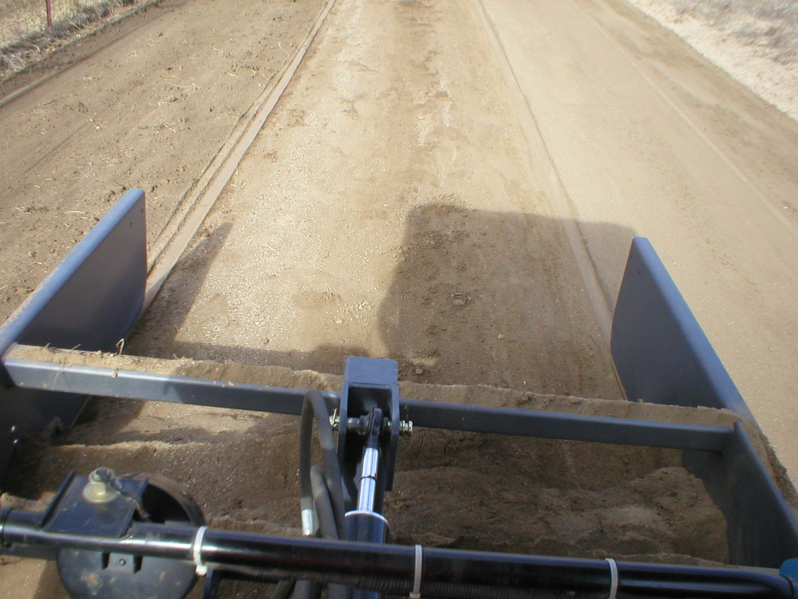

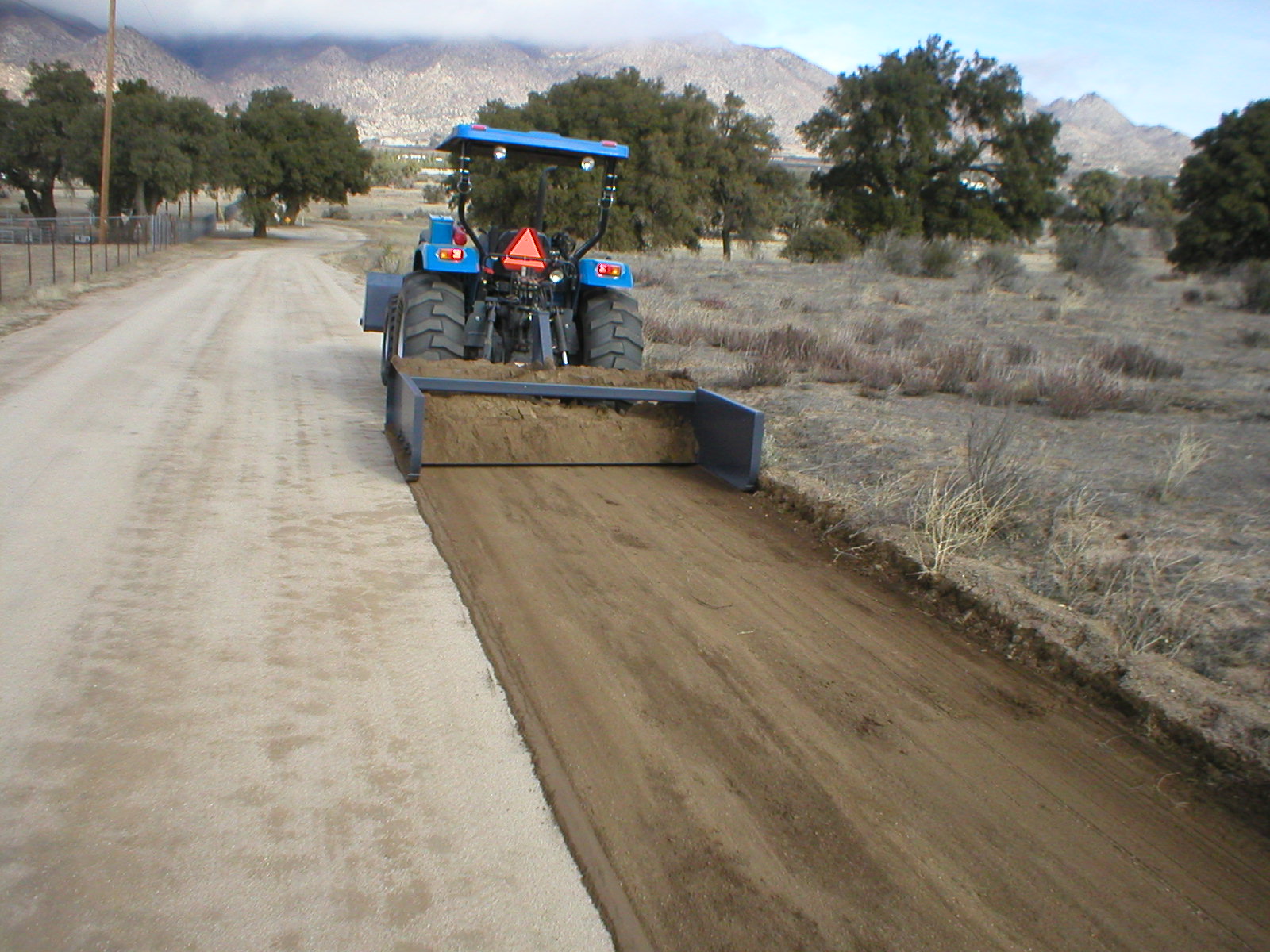

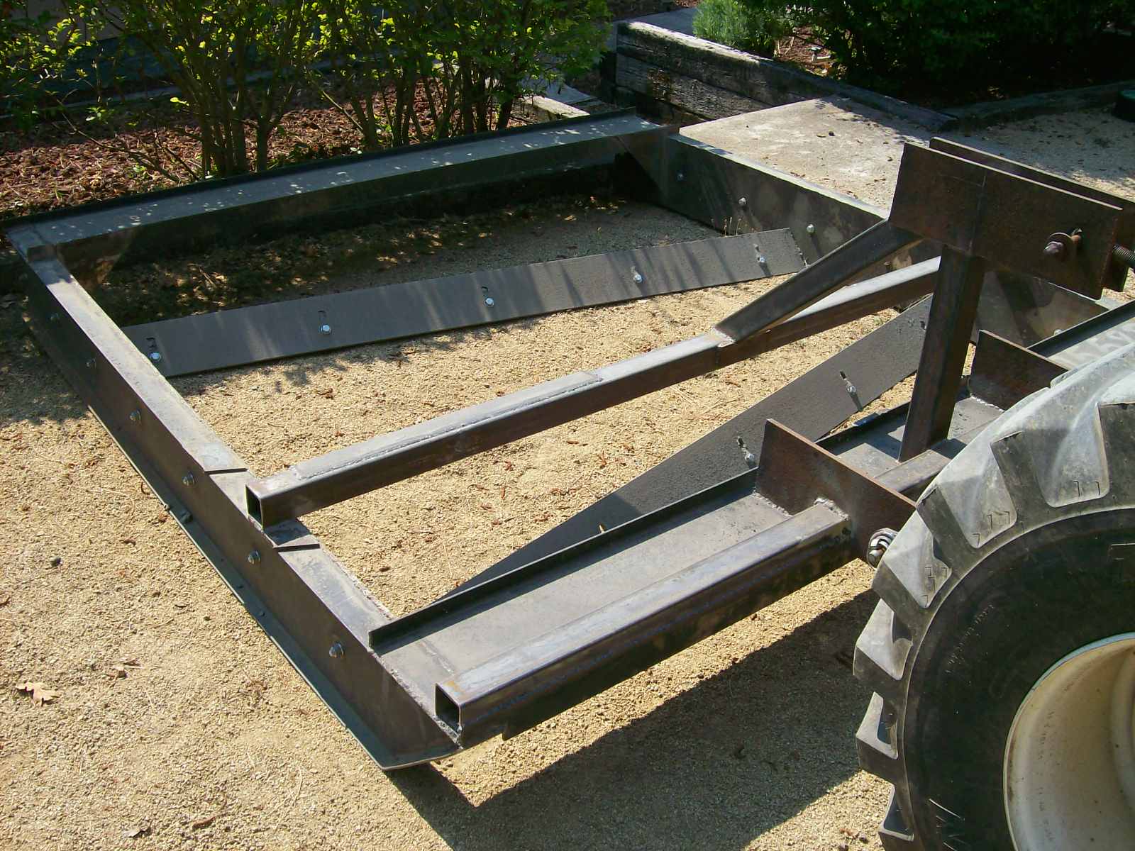

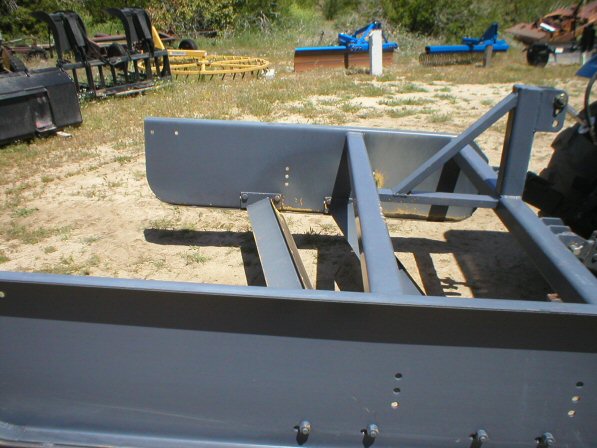

Is this the way you are talking about ??
Those pictures were taking before total completion . I welded 2 pieces of 3" x 3" x .25" angle stock some were around 15 to 20 degree angles about .75" above bottom of skids . Blades are then attached with 1/2" bolts , thus I can set blades from level with skids to a max cut of around 1.5" . Currently I have it set with front blade 3/4" down on that nearest side to camera while opposite side is maybe 1/4" down . Back blade is set 1/4" down on far side from camera while near side is actually above bottom of skid . I make one pass down driveway on 1 side , with side nearest camera against edge of driveway , then make pass back up on opposite side . I pull the shale from edge , bringing it back towards center then 2nd blade feathers it back towards edge of driveway without carrying it all the way back to edge .
I would say mine is 8' feet long without going out a measuring it , and it is around 7' wide , pulled behind a N.H. TC30 . Blades or just 6" x 1/2" flat stock .

Hi Fred,
Thanks for the reply, yes that's exactly what I am talking about. Are you happy with the way it moves dirt back and forth, would you change anything if you built it again. I was going to put a drum of water over the blades to give some more weight and a hinged Tail gate of sorts at the back that hangs straight against a stop to pull dirt with me if I needed or flap the gate over to hang back to drag across the dirt at the back to do a final flatten.
Yours looks great and looks like it would do a good job
Regards John
/ Land plain blade height help #13
For my needs , Yes I like the way the opposite angled blades work . As I described above , the crushed shale that we use on our driveway tends to migrate out to the edges , at least what is not packed down in the first month or two of grading . One thing that I would change , Which I am actually working on now , Is to put spacers or bushings on the bolts that hold the blades , Add vertical threaded rods to each side blade , which will be threaded through a fixed mount on top of each side rail , with a handle on top . Thus to change depth of blade on each side , it will be a simple situation of just turning the handle , moving that end of the blade to what ever depth I desire . In pictures above , I had to loosen all bolts , then slide blade to desired position and re-tighten bolts .I have seen graders / planes built with that type adjustment but some I seen had one handle which adjusted the entire blade were I want to adjust each end of blade differently . I have added more bracing from top of 3 point frame to back corners of side rails also , just have not taken any more pictures of grader since I first built it last summer .

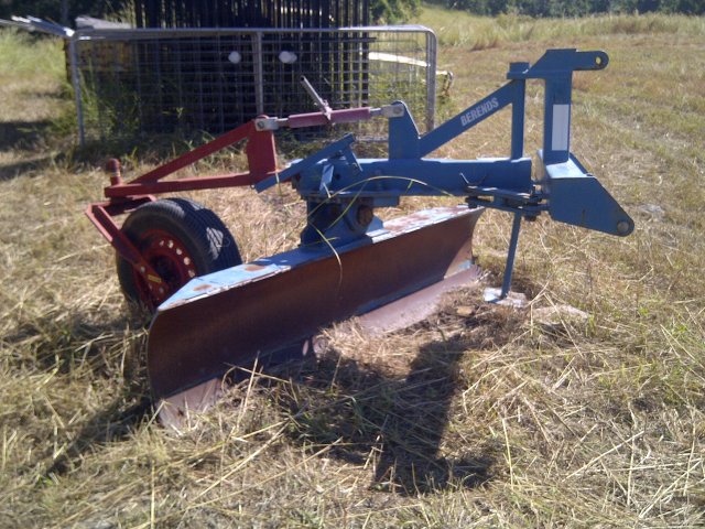

I have one of thesehttp://www.roadrunnerblade.com/index.html it works very well & the adjustable depth of cut is a must. I built one similar to the Roadrunner shown above but with the side plates & skid shoes moving rather than moving the blade assy. This will complicate a simple non adjustable build but it is worth it. My blade adjusts with a crank on each side from an 1" cut to about 4" above ground. This is for spreading piles of dumped material.

I do like your land leveller Fred - the one i bulit was a quick knockup out of stuff lying around and is still a work in progress. What i like about yours is the way you say it takes the material over to one side to create a crown, handy having the adjustable cutters for depth & angle. The only thing i don't like on most 3 pt hitch attached levellers is that (unless I'm missing something) they stay fairly rigidly set (even like the berends one below is fairly rigid, but maybe float mode & a deft hand on a hydraulic top link would cover it) so when you transition between grades (i.e. lumps & hollows) that you want smooth transitions for they either lift off the ground or dig in - I know you can try & feather the lift height etc but thats why I like the tow behind (set & go).
Here is a couple of pics of the work in progess Dragalong - some are while upside down when it was getting teeth & one is when it was using a bridle before it got the adjustable towbar (the front sleeve of it is a little bent after hitting a stump but I expected an issue with it because it was only thin wall stuff that was on hand at the time).
It is destined to get a set of wheels on the back mainly to lift to travel or reverse & maybe some slots in the front I beam to allow material thru & maybe some fingers that allow bigger rocks to go up over into the box to be able to deposit them somewhere else. As heavy as it is, more weight would be good (the wheels on back will help towards that) - one time when it had the bridle on, it hit a rock while going downhill and it flipped in the direction of travel - was like hitting a tree for a split second then seeing in the rear vision mirror this thing chasing me down the hill. The old patrol tows it ok but if its full of gravel going uphill when its slightly wet gets to be too much. When it gets extra weight with the wheels etc it might become a tractor or dozer job to tow it but at least with the hydraulic or electric actuated lift wheels i could release the load when it bites off too much.
