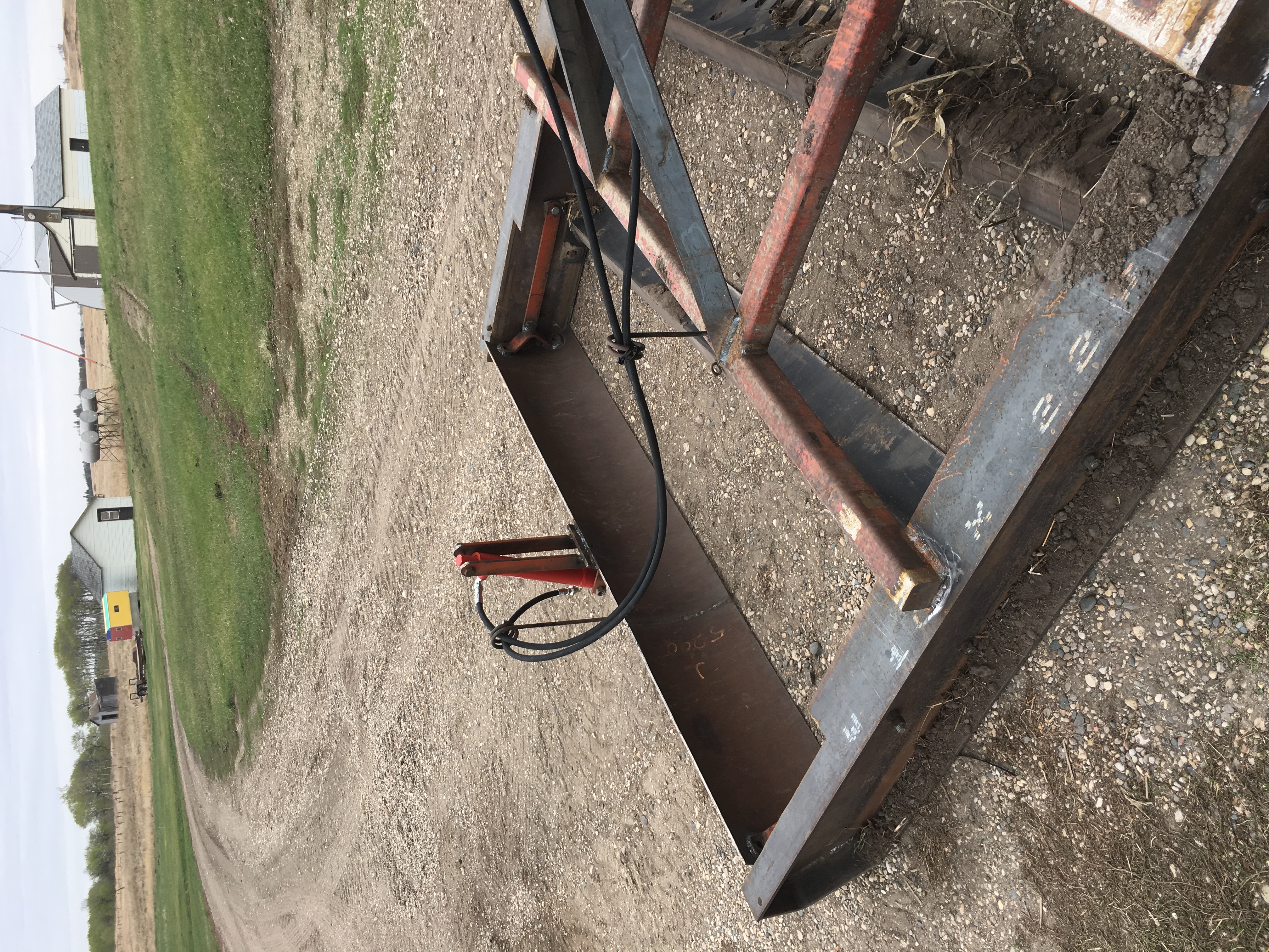

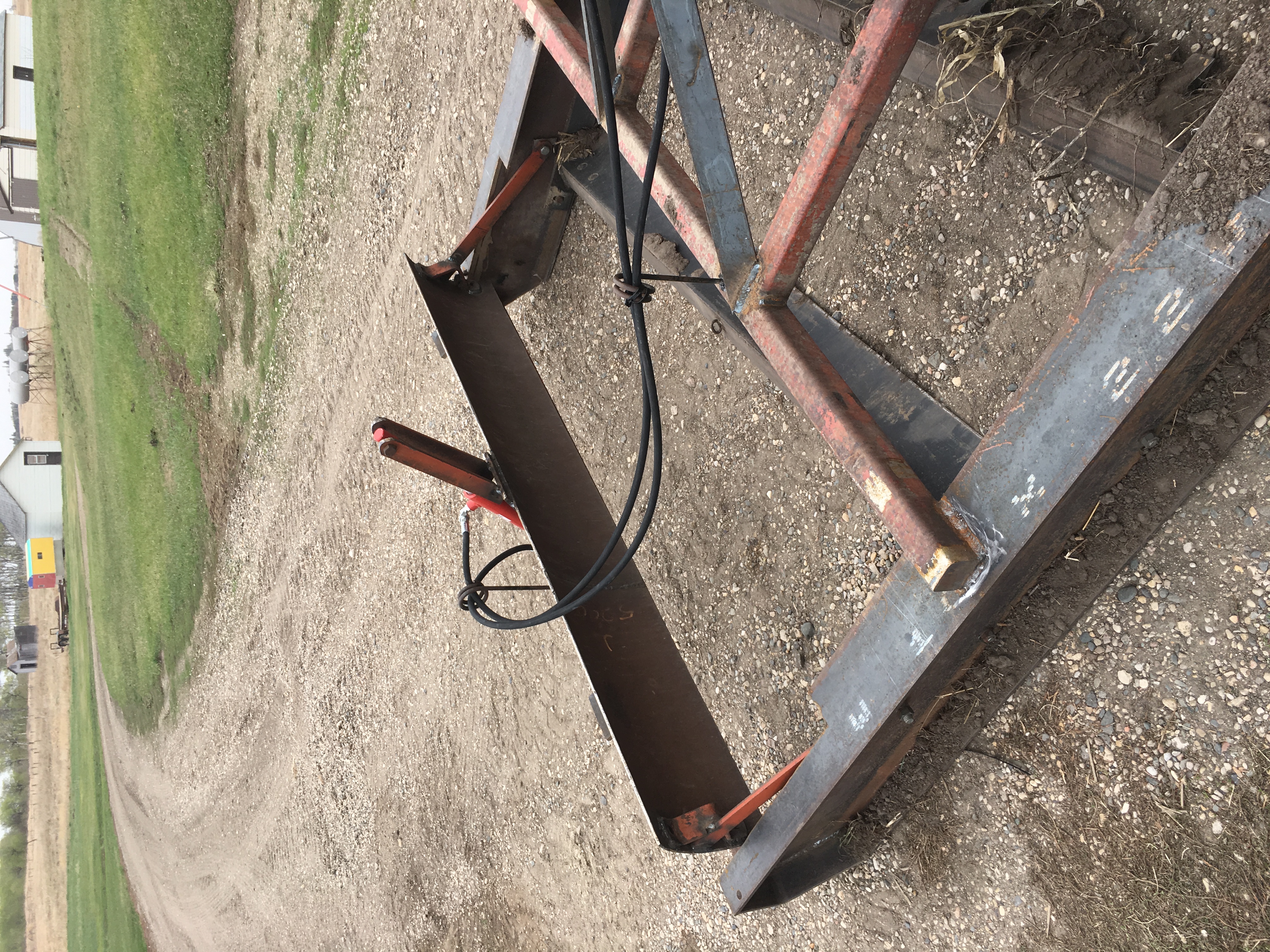

Nice build. The shop makes me feel at home. Wish I had the overhead beam for heavy stuff. Yes , I have a hydraulic rear gate on mine, I will find a couple of pics.
/ Land Leveler Build #12
Rear gate 4AB3B1C4-8098-4CFE-9B6A-FF8611BD3DD6.jpeg3597A9BA-E208-4E42-A03B-BB4E6028F090.jpeg6CEF7B30-141E-4AA9-AAEA-14DFBFFC6BF2.jpeg

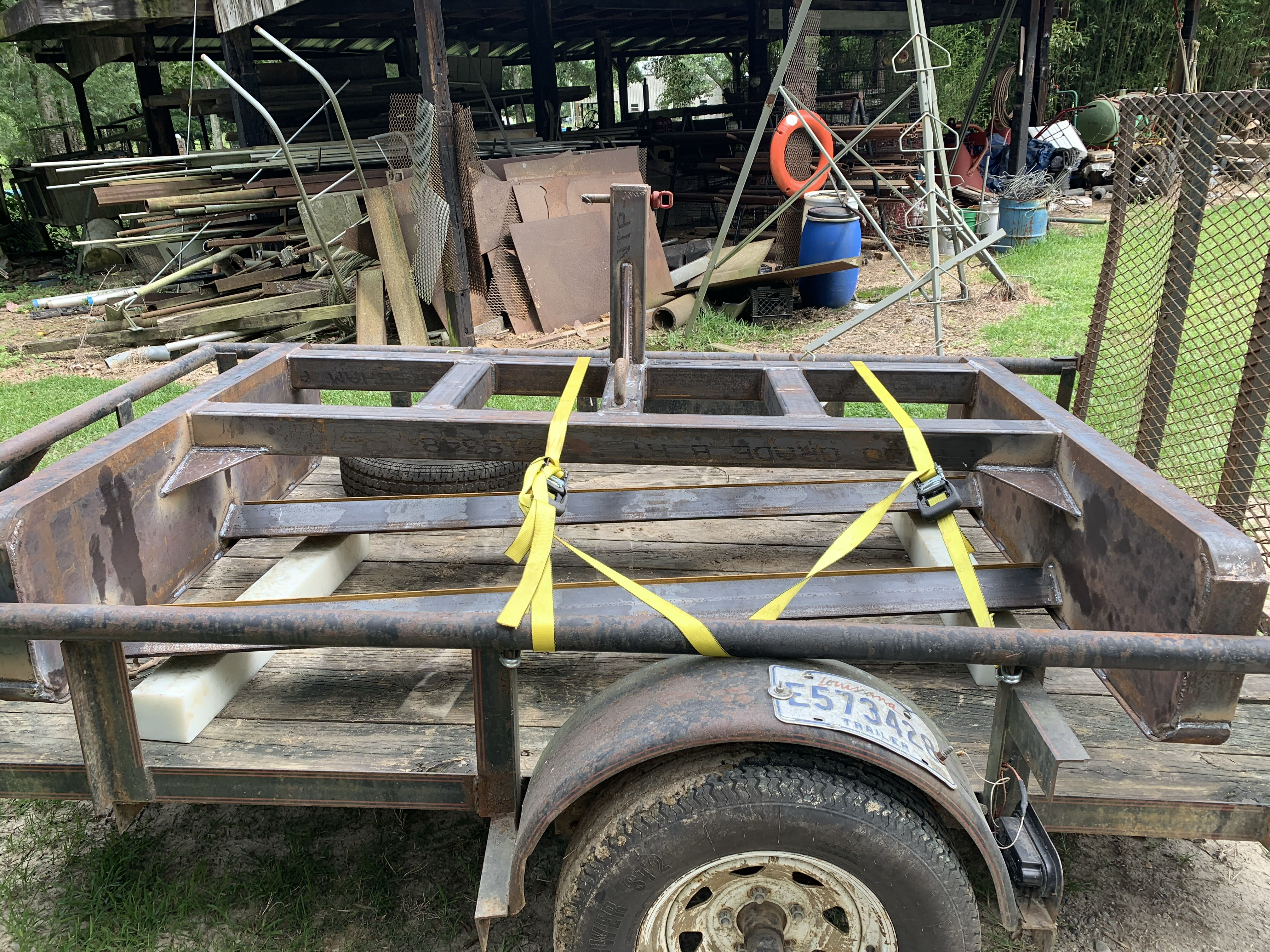

I understand what you are saying here, but the land leveler I am basing my design on, has the angle (4x6x1/2in) the blades bolt to at a 60degree angle off the “road” surface. But the curve of the blade puts the first inch of the blade much closer to parallel than 60degrees.
I have 7’ motor grader blades I purchased from a local dealer (I didn’t think $60 each new was too bad), and looks like the same angle should work well on my 4x4x1/2 angle to mount the blades. Just have to make to right miter cut to get my 10 or 15 degree angle to the runners. Trying to decide which would work best.

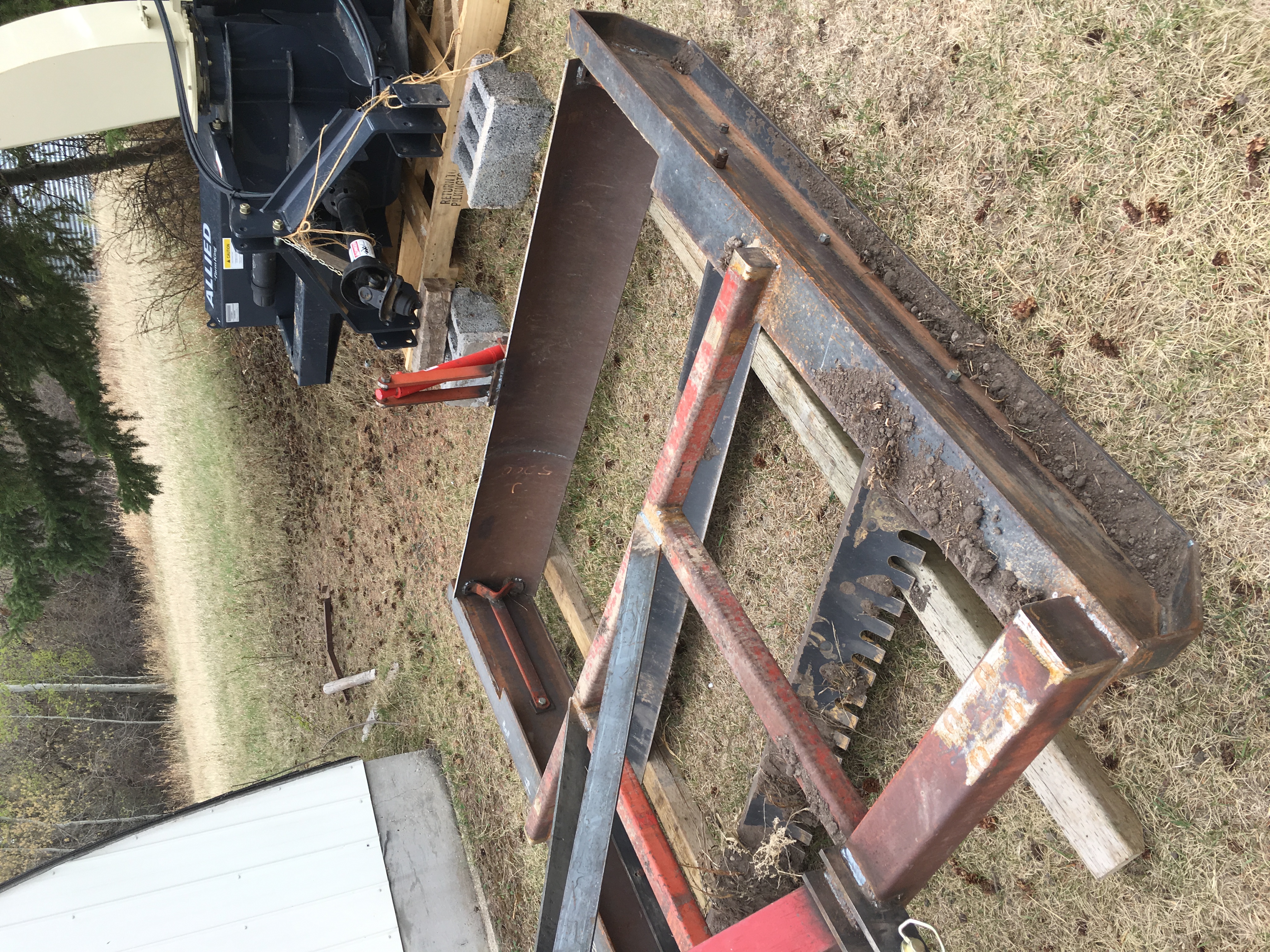

I’ll have to get more pictures once I add the gate and paint it. Figured I’d test it before trying to add a gate or teeth. Works really well but still considering both a gate and teeth

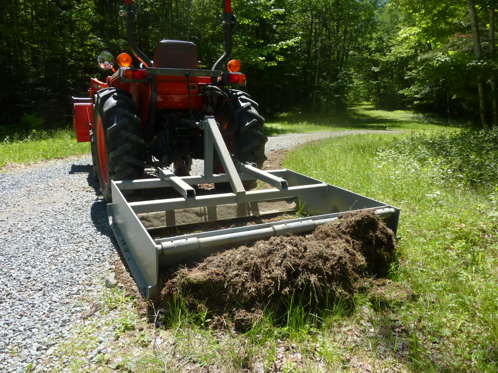

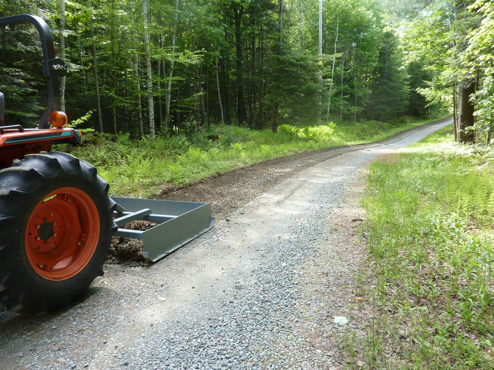

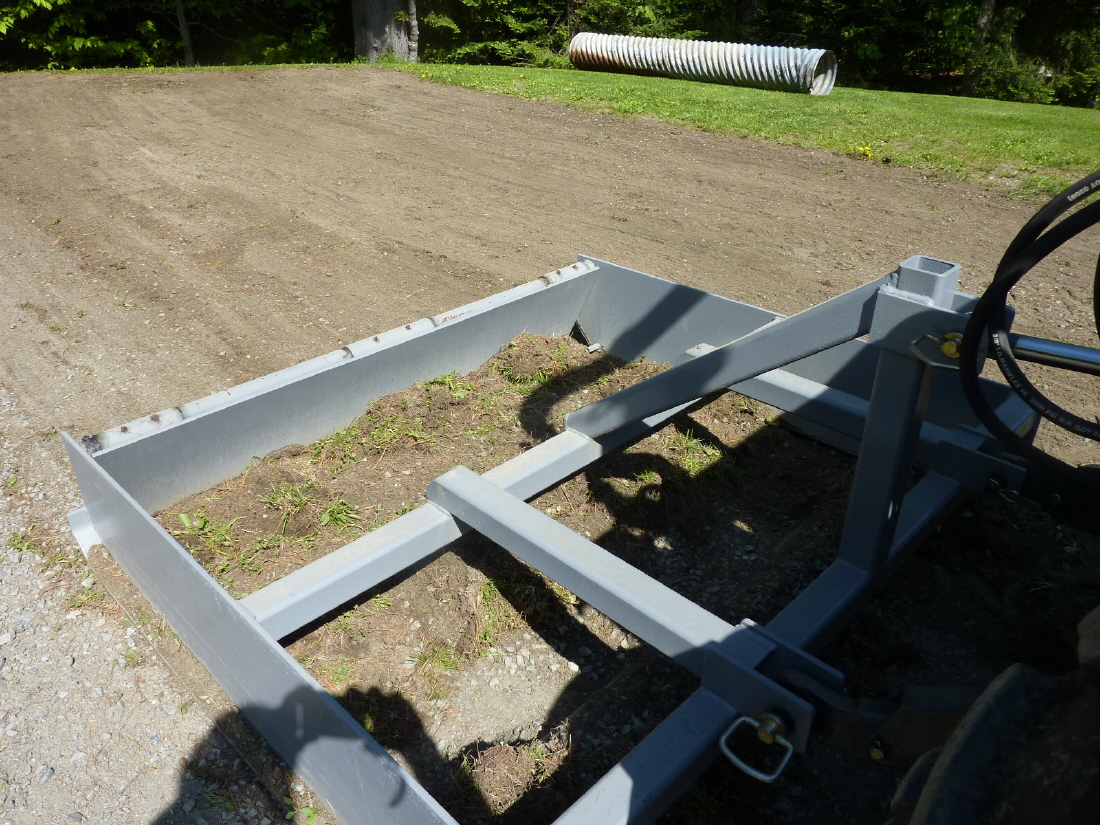

I have a simple rear gate on mine. It's not nearly as nice as MetalBenders. It's just a plate hanging on a hinge. There are two pins that act as gate stops. If I flip the gate so it hangs behind the pins it just acts as a rear drag but is heavy enough to collect sod, which floats to the top. The gravel passes thru under the sod. Then I can use the gate as a crude blade to push the sod off the road. A couple pics desodding a parking pad and pushing road edge sod off of the road. If I flip the gate to hang in side the pins it will collect material like a box blade. When I spread new gravel on a road this makes it easy to spread evenly.
