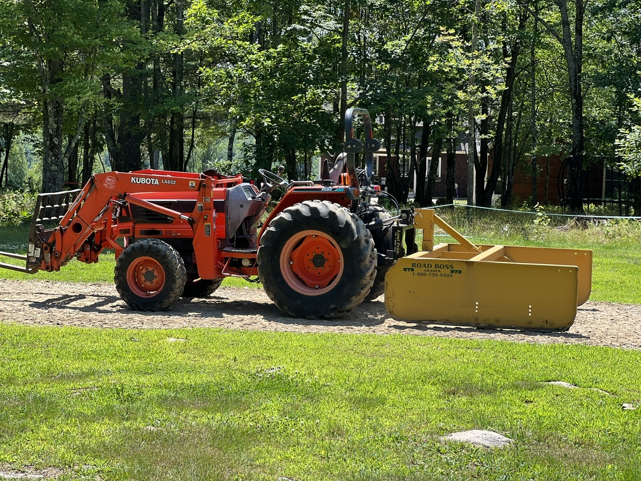

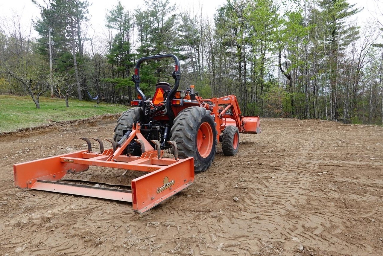

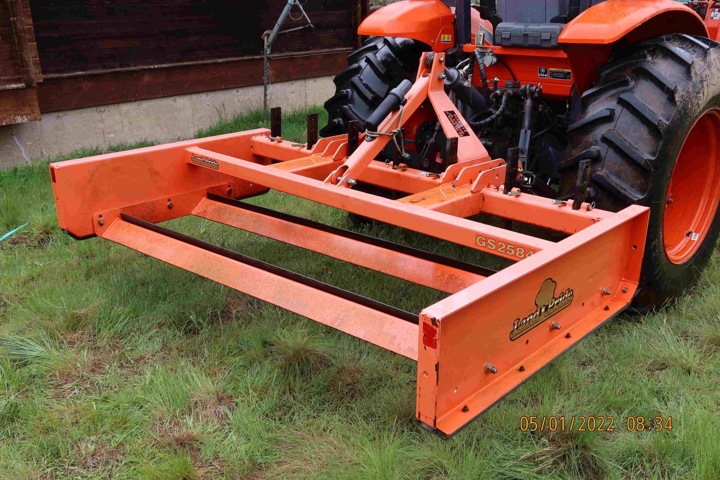

Unless you have an extreme situation (like Oosik with his rock hard driveway) then you will rarely need the scarifiers. If you have to scarify once in a blue moon, you have your box blade.
I had a Landpride 2584 with scarifiers, I never once needed to use them. I sold it because I bent the crossbar that holds the cutting edge and it was $1,700 for a replacement blade carrier at the time.
I replaced it with a Road Boss which doesn’t have scarifiers, but I knew I would not need them. Granted, it weighs 1,100lbs so weight certainly helps. You can always add weight but it’s more likely to bend your equipment if you hit an immovable rock.
The land plane is more of a finish implement, you would do the rough work with the box blade, and finishing touches and maintenance with the land plane.
I suggest spending more money to get a heavier land plane vs the scarifiers.
looking at the one the OP posted the cross bars not having any diagonal support to help spread the load was my first concern.
