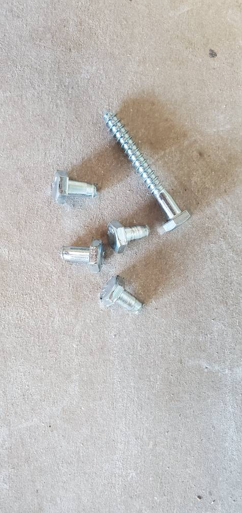

I've been renovating my new house for the past few months and I've noticed that all of the lag bolts I've been buying are snapping off at the neck of the bolt. Not all of them obviously but out of 40 bolts today, about 8 of them the snapped.
I also had this happen with different sets of bolts, including galvanized bolts from lowes, and now stainless bolts from home depot as well as galvanized bolts from home depot (maybe they're using the same supplier?).
Anybody have a good lag bolt I can try next time around? 20200919_172911.jpeg

It would be unusual for that many different varieties/suppliers to all have bad bolts. On the other hand, driving a lag into a tight hole creates an awful lot of friction and will surely increase the chances of failure. I am guessing that you're not drilling a large enough hole. I pick a bit that is the same diameter (err on the large side) as the inner diameter of the bolt.
Stainless will be a little weaker but I used a lot of stainless lag bolts on my pier and don't recall any failures.

I'm driving them into studs with an impact driver and I'm being fairly careful to not over-torque. I am pre-drilling but the holes are 1/8 and the bolts are 1/4 at the neck. Some broke off in the middle of driving them in. I guess I'm noticing this because I've done numerous projects before with lag bolts like this and even when I way over torqued them I never broke a bolt.

I would think 1/8" hole for a 1/4" lag is the problem. You can get away with that in some soft wood (if it doesn't split) but not all. I have actually driven lags into soft white pine with no pre-drill at all, but the same technique is hopeless on yellow pine or any harder wood. If it's old wood, hard wood, or aged wood, you really need a large clearance hole. Let the threads bite and don't worry about the wedge effect (it's not a nail after all).
