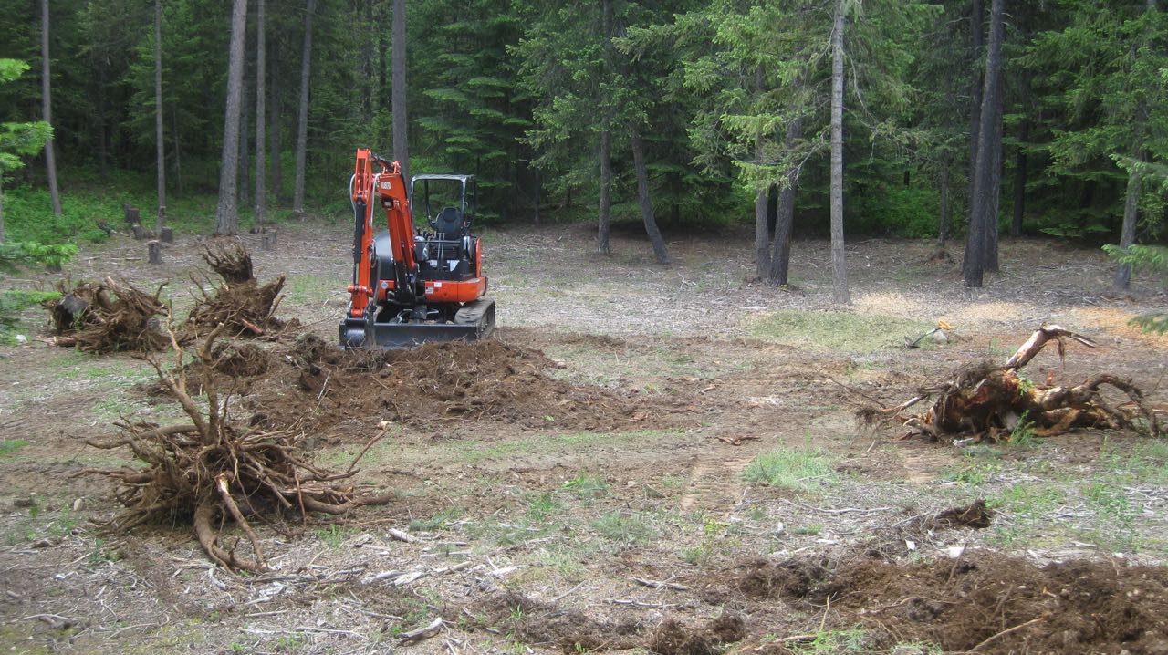

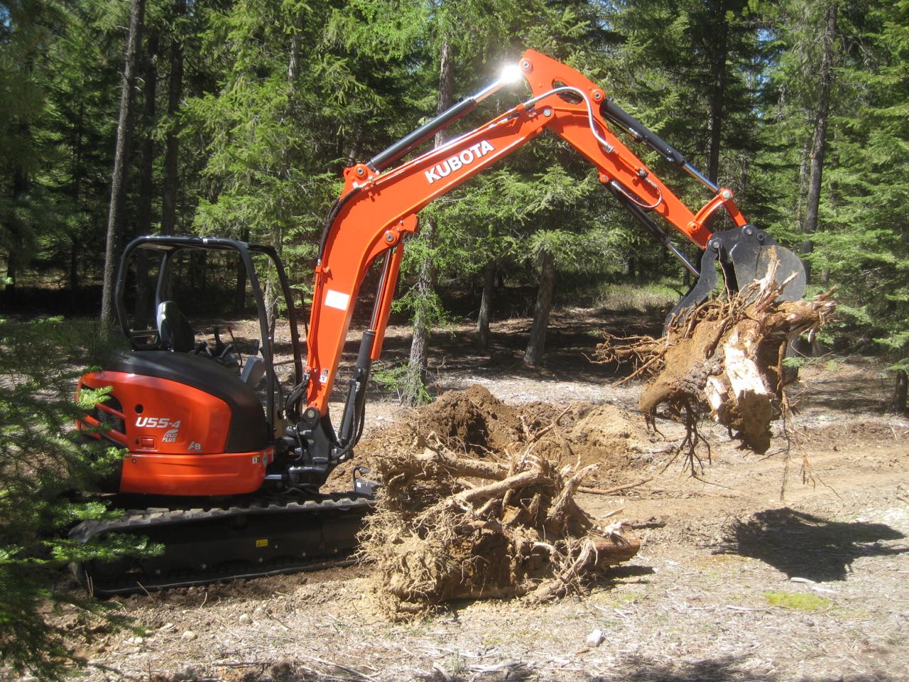

If you want to pull a bunch of stumps get a mini ex. Good to have a separate tractor and mini ex.
Question for you... What makes a mini ex better for stump removal versus a backhoe on a tractor? Is it the motion of the machine itself whereas a tractor doesn’t move around as easily?
Weight and digging force. And the ex has the blade that you drop that acts like a brake against the digging arm.
/ L6060 or L47 #15
Ah good to know, thanks! I wouldn’t have thought about the blade helping with it.

There are tradeoffs with anything, even a mini-ex. One of its strengths is easy maneuvering around the jobsite - very handy for grubbing stumps. But one of its weaknesses is getting to and from the jobsite. You either go slowly on its tracks or have to trailer it, and a mini-ex that outdigs an L47 will weigh 10,000 lbs. And the mini-ex won't bush hog your place when you're done digging. If you've got the resources and the space for multiple machines, by all means go for it. But lots of us - me included - cleared a lot of stumps with our CUT backhoe attachments over the years.
