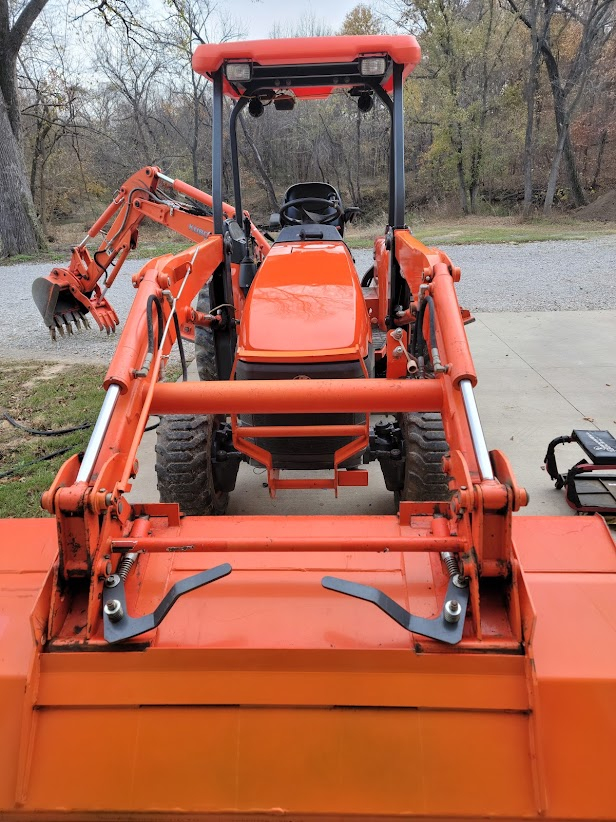

Interesting. I have the quick coupler BH bucket but I believe it is different than the Kubota excavator buckets. Love the air ride seat idea, never understood why they put such a cheesy seat on something someone spends hours on. My ZD326 mower has a lazy boy feeling seat compared to the folding chair feel of the L45.
Workallthetime,
My M59, bought used, arrived with 24" pin on bucket and after searching around for alternate width buckets and researching the M59 TLB quick coupler, I decided to go aftermarket and have custom coupler created to provide access to the Kubota mini excavator quick attach buckets ( KX121 KX040 KX71 KX91 U35 KX033, U17, KX018, U35, U55, KX080 ) and other tools hung off the Kubota excavators. The above mini x's use the K7870 quick coupler which is not compatible with Kubota TLB's ( L45, M59 etc ) pin spacing so USA Attachments made a quick coupler with M59 pin spacing and couples to the mini x buckets. easy peasy.
Finding used Kubota QA hoe buckets is like finding hens teeth whereas the used market for mini x buckets is huge and much less expensive.
Here are some pics

I'm agreeing with rScotty, You have a low hours, very versatile L45. The larger TLB's are extremely good for homeowner/ small contractors since they can use so many attachments. About the only thing they lack is ability to run 15 gpm hydraulic attachments off the FEL. I'm currently working a solution to that so I can run a SSQA trencher and various other higher flow hydraulic tools off the FEL.
The TLB is a great all -around tool that does many tasks well but it is not a bulldozer, or an excavator, or a telehandler.
Have fun adding implements to the L45 to make it more capable.

Workallthetime,
Here are some pics
Who made your M59 quick coupler? Cost?
Your right about the M59 buckets are hard to find, especially pin on.
Messicks told me the Kubota excavator QA was not compatible with my thumb. New thumb too expensive $3K in addition to new coupler. There was only one thumb option for the M59. M62 has two thumb options depending on what QA coupler.
Hopefully you found a good solution.

rScotty,
USA Attachments is the company that makes a quick coupler that pins onto a M59 and couples to the KX/ U series Kubota mini excavator bucket line and any Kubota or aftermarket attachment fitting the KX/U quick coupler. See post 22 for the installation of the USA Attachments quick coupler. This coupler is compatible with the M59 thumb with a few very very minor alterations of the thumb, the quick coupler, and each KX bucket. SmokeyDog and I have discussed the alterations and he indicated he has moved forward with a coupler and buckets purchase.
I have been using the M59/KX quick coupler for a number of projects and am very pleased with the ease of bucket changes which take under one minute. Most of the time is spent walking from backhoe operator station to the bucket to remove the locking pin and then again to replace pin when new bucket in place.
I will post the purchase details related to purchasing the PGC100 quick coupler, that USA Attachments requires to build it compatible with M59, and needed alterations and appropriate spacer/ shaft collar details if there is interest.
