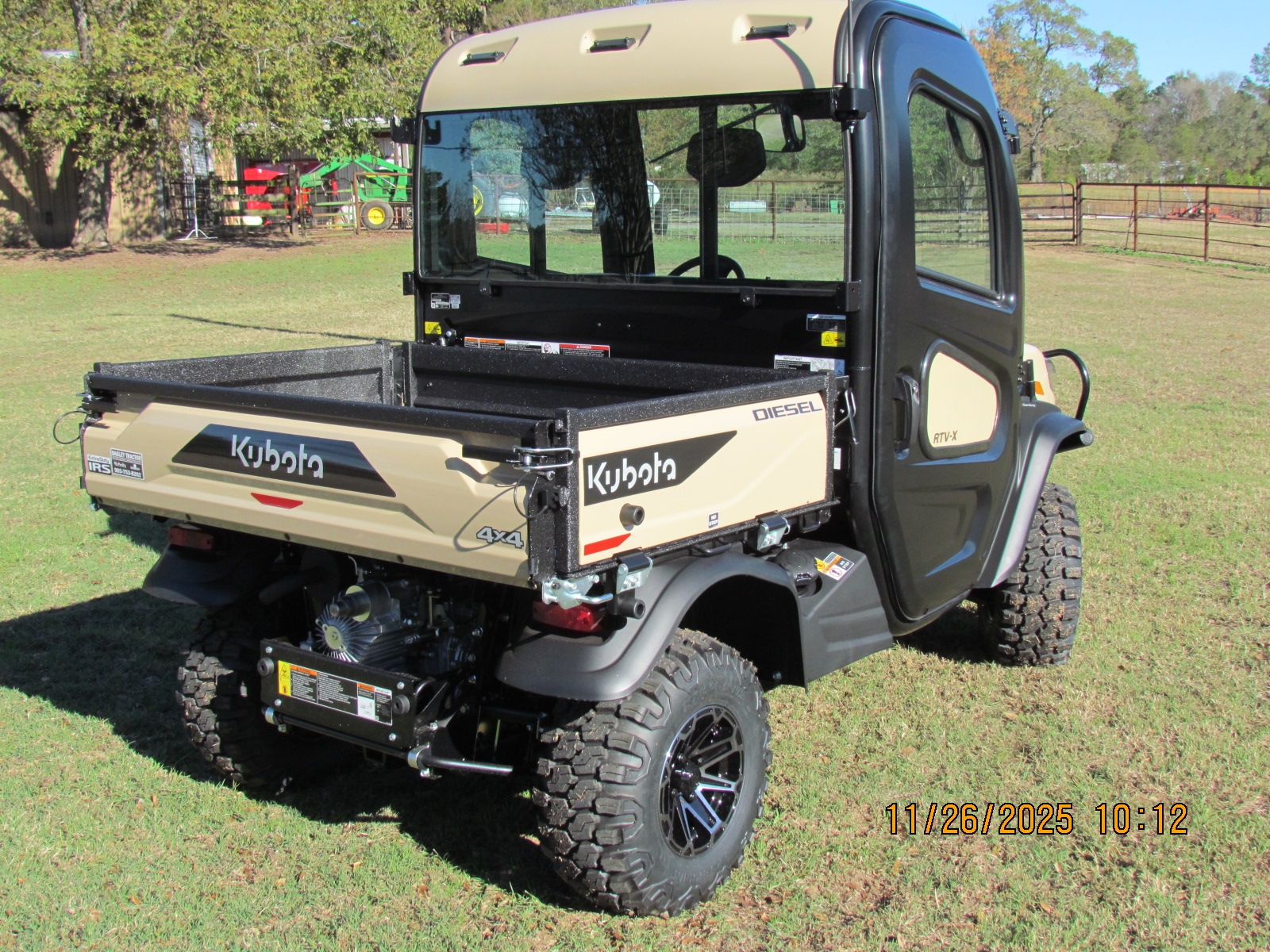

Warn VRX 45-S winch with synthetic line, front and rear work lights, windshield, canopy, bluetooth speakers, and mirrors ( dealer threw them in with purchase). I added receiver ball mounts to each end for attaching a clevis for trailer tiedown as well as pulling my drag harrow. I also added an extension to the rear hitch so as to not hit the RTV-X with the manure spreader or pasture vacuum. All of the accessories were installed by my dealer, hence the clean dash switches and remote connection.

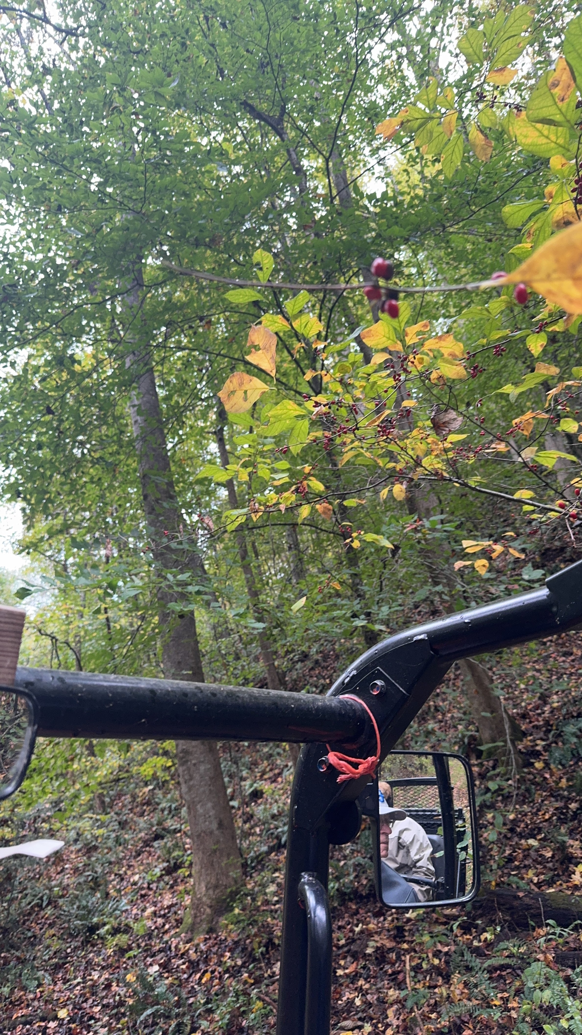

I have my second 1100 and I've added these magnetic mirrors, but always attach such with bale string or the like. I have no cab or windshield as my rough terrain and forever changing forests would tear them apart. Sure I have to reset them, but that is far better than having to repair or replace!
I could probably get on board with the magnetic lights. I'm in the woods with my RTV and the branches would beat up the mirrors. My luck even though I'd add string to prevent a total fly off, the mirror glass would smack the roll bar and break, who knows

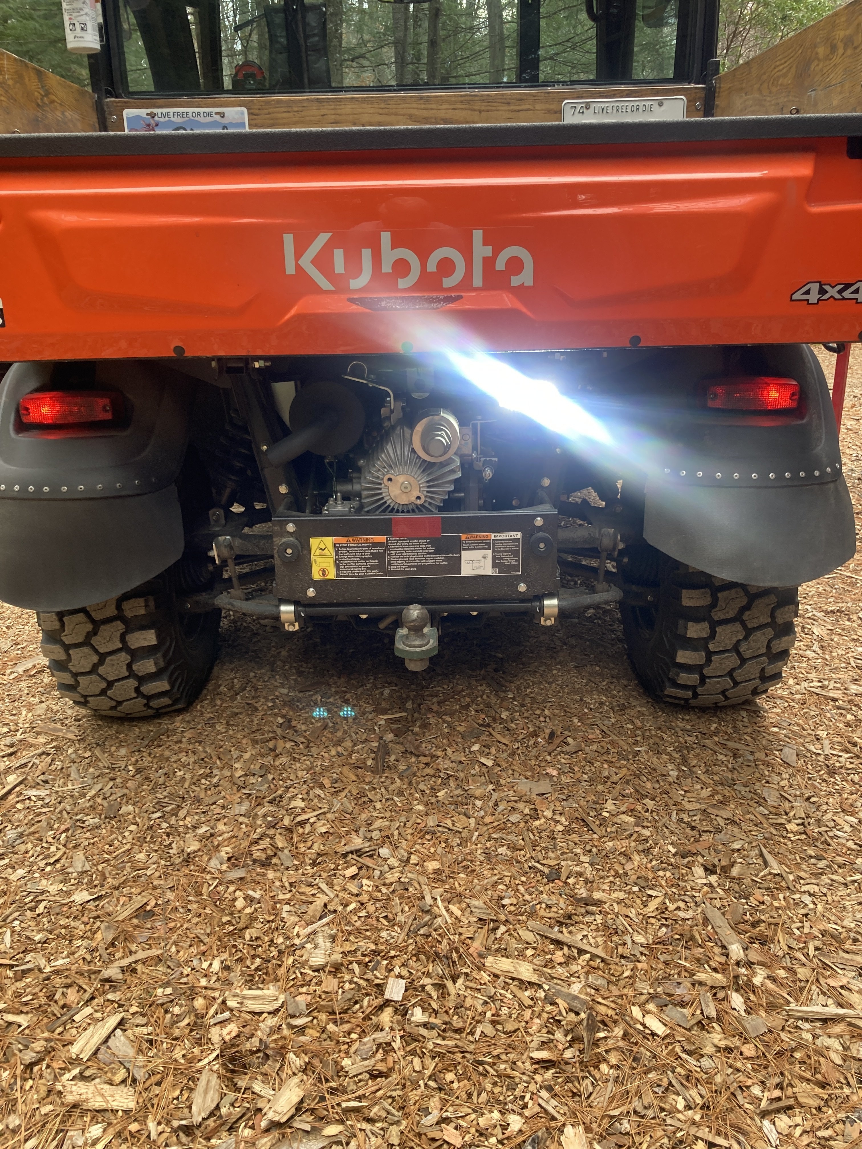

The 1100C comes wired ready for the backup beeper - if you did not order the beeper the connector will be hidden under electrical tape (probably blue) just above the bracket on which the beeper would be installed. I used this bracket to mount the lamp. This is a bit difficult to photograph, but the attached may help. The bracket for my lamp is one I made and it is bolted to the factory beeper bracket which is part of the frame. Hope this helps.
Here's what I have on the tail end.
