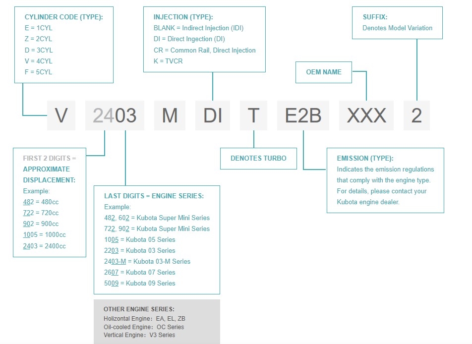

One of the good changes to the gear drive was adding syncro's to the shuttle shift, the one I drove shifted great, It looks like they are trying to use as many common parts between the l3302, the l2501 used many of the parts from the l3200 and l3400, but the engine is a mystery as I see very few parts cross over to anything else
