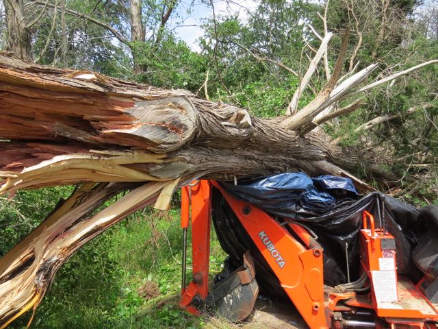

Another word of caution: do not leave you BH under a tree. (Ask me how I know)
