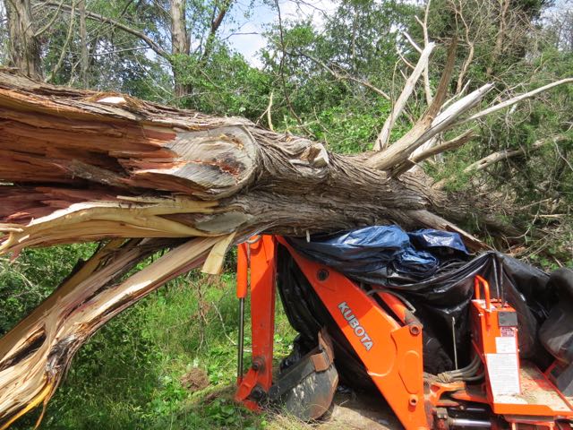

Another word of caution: do not leave you BH under a tree. (Ask me how I know)

As for the tree - ouch, thats never good!
