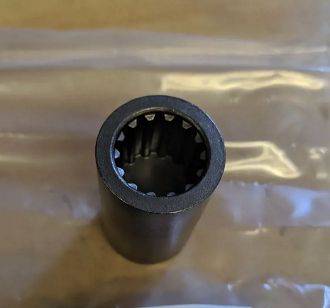

Plowing snow today noticed a clunking noise. forward or reverse. 4 wheel drive only. all three transmission ranges. sounds like a cog missing off a large gear. 10 years old, 500 hours. light use. proper maintenance. no incidents that would have caused damage to drive line.

Sounds like it stripped one of the splined couplers between the transmission and the front axle. Are you on 4WD a lot? Specially on hard surfaces?
Had that happening to me on a B7000. That one used u-joints instead of a straight coupler but it's the same principle.

Several here on TPN refer to Kubota's splined FWD coupler as being a part that is designed to wear out so that it protects the rest of the front drive components.... I've no idea if it was designed for that, but apparently that is what it does.
The symptoms match, easy & inexpensive to replace. Look there first. You will have to undo the drive shaft cover. Most of the covers telescope.

I don't know if they are "designed" to wear out, but I had an old Case backhoe that used one of those to drive the hydraulic pump off the front of the engine and I remember changing them every couple years.
Or maybe you mean they are designed to wear before the splines on the shafts do.
/ Kubota B3030 HSTC #7
I was thinking the same thing. A part like that coupling is going to move and wear, so it would make sense to make it of a material that would wear faster than the splines on the shafts.
So it makes sense that anyone who designed that type of coupling would tend to specify materials to make the coupling wear faster. Maybe not as a truly sacrificial part, but as a side benefit.
Another thought was that if the splines and coupling were intended to wear at the same rate, there would be some way to lube it and keep it lubed.

I guess I misread the model number, I thought this was the later B series design with splined couplers.
There is a splined coupler on the B2910 - it’s further forward on the front drive shaft which has no u-joints IIRC.
Might be it on the end of the front shaft sticking out of the axle in the 2nd pic above.
