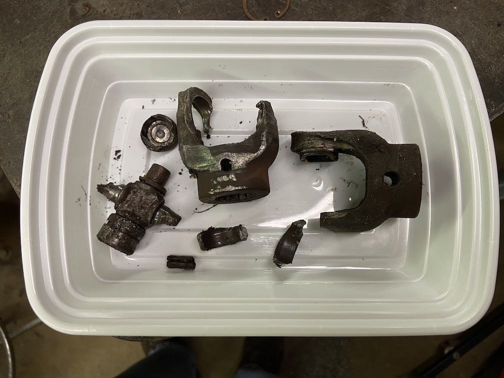

Blew the rearmost u-joint on the drive line going to the front axle @ around 2400 -2500 hours while dropping it into 4WD pushing the loader into a manure pile.
Managed to destroy the yoke halves as well.

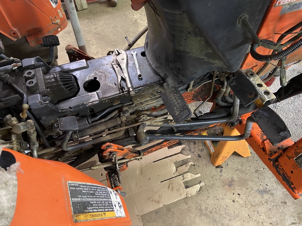

Front axle has to be dropped to remove the driveline and a hole (2” ?) has to be punched in that tunnel that connects the front of the tractor to the rear - so the yoke can be (roll) unpinned from and then pinned to the output shaft on the transmission. Can’t get to it otherwise.

Most critical thing to know is where to punch the hole in the tunnel with the hole saw - so you don’t end up cutting the hydraulic hard lines that run through the tunnel.

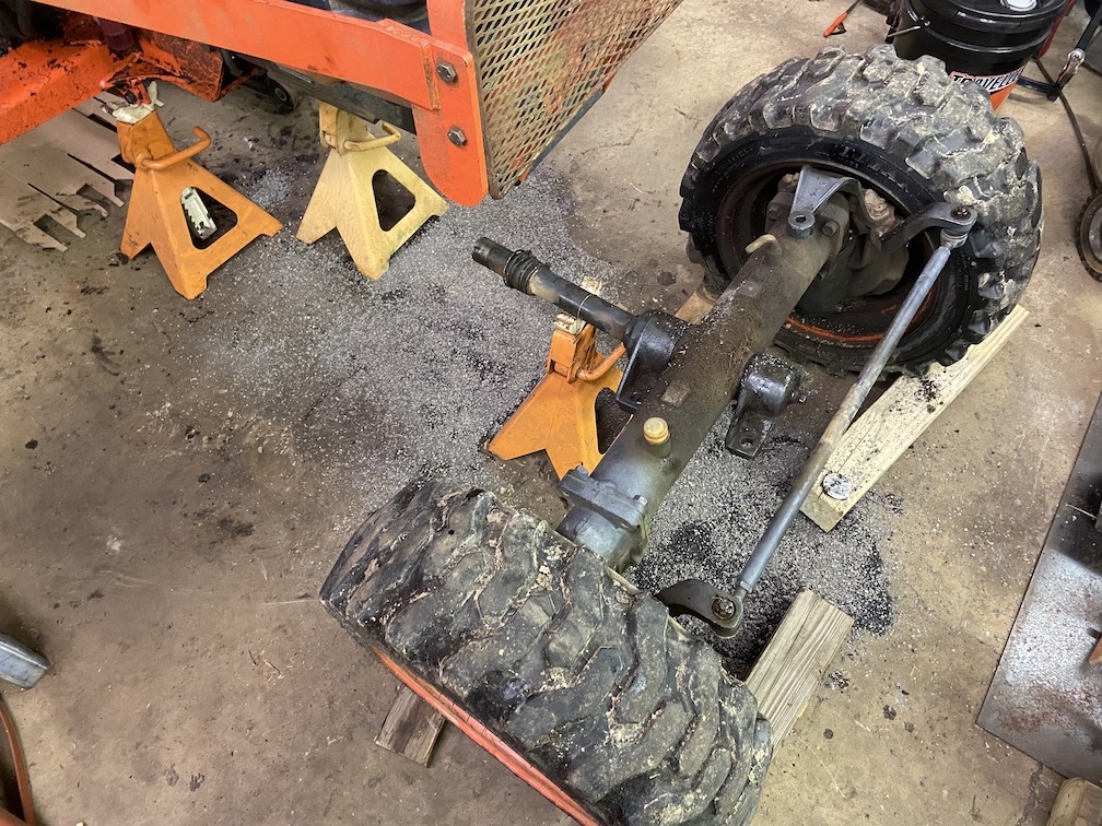

Here's some pics:
Last pic shows the location of the hole that has be drilled in the "tunnel" to access the roll pin holding the old yoke on so that it can be removed and replaced.
No guarantees that the locations of the hydraulic hard lines are the same on a B3030 though.
Maybe compare B2910 ---> B3030 exploded parts diagrams up on Kubota's website ? Might give a good idea.
IIRC, the u-joint/yokes are a single assembly: rear yoke/u-joint/front yoke.

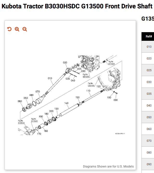

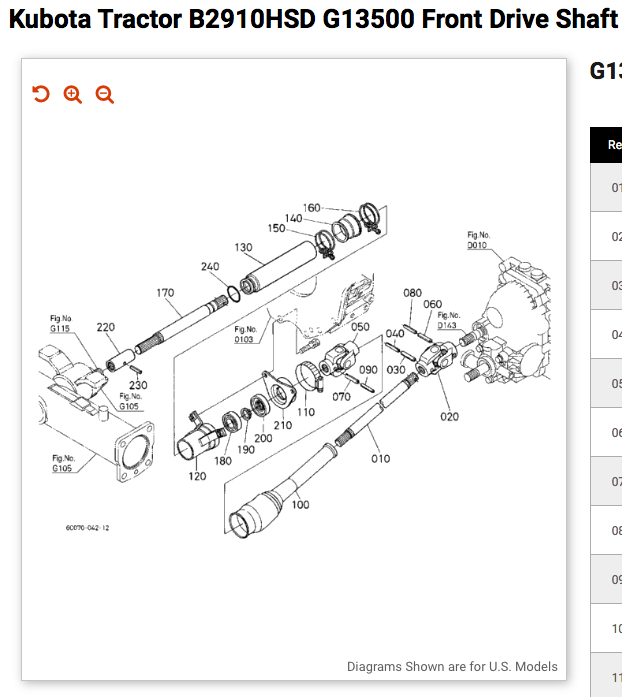

   / Kubota B3030 HSTC #20
Drivetrain on the B2910 and B3030 are very similar (despite the difference of the layout of the exploded parts diagram) - with the exception that the carrier bearing appears to be integrated into the bell housing on B3030:
Versus the B2910 which utilizes a separate external carrier bearing mounting (Items #120 and #210):
Didn't check, but I'd bet that they share a lot of parts in common.
If the picture is accurate, the fact that the carrier bearing is in the bell housing may be an obstacle to removing the rear driveshaft without splitting the tractor.
Would need to get down there and have a look to really tell how it's put together.
First thing to do would be to see if you can pin down where the noise seems to be coming from.
If you can't tell when with the engine running and it moving, then maybe jack/block it up with all the wheels off the ground (with the engine off) and put it in neutral and give the wheels a spin.
