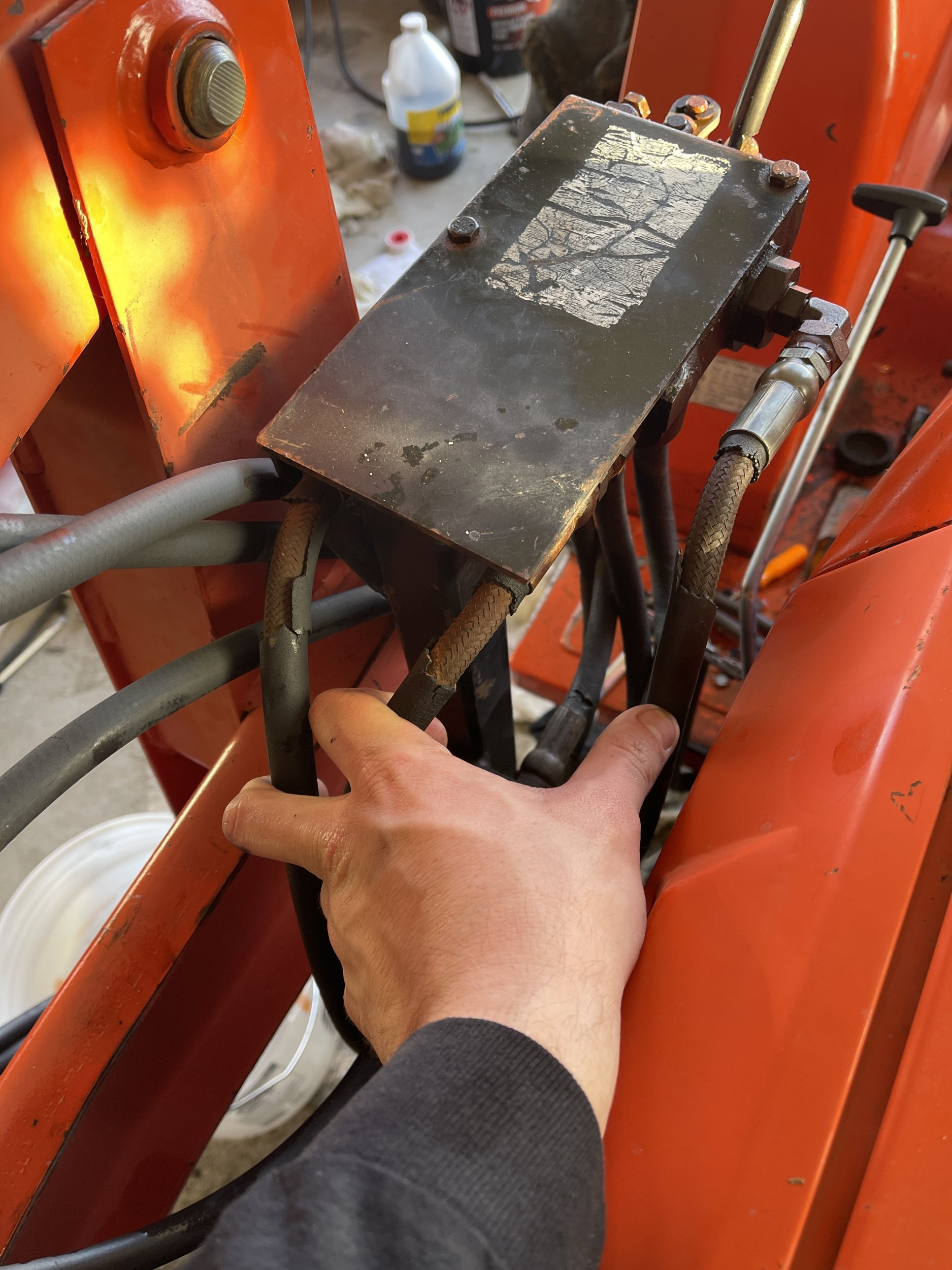

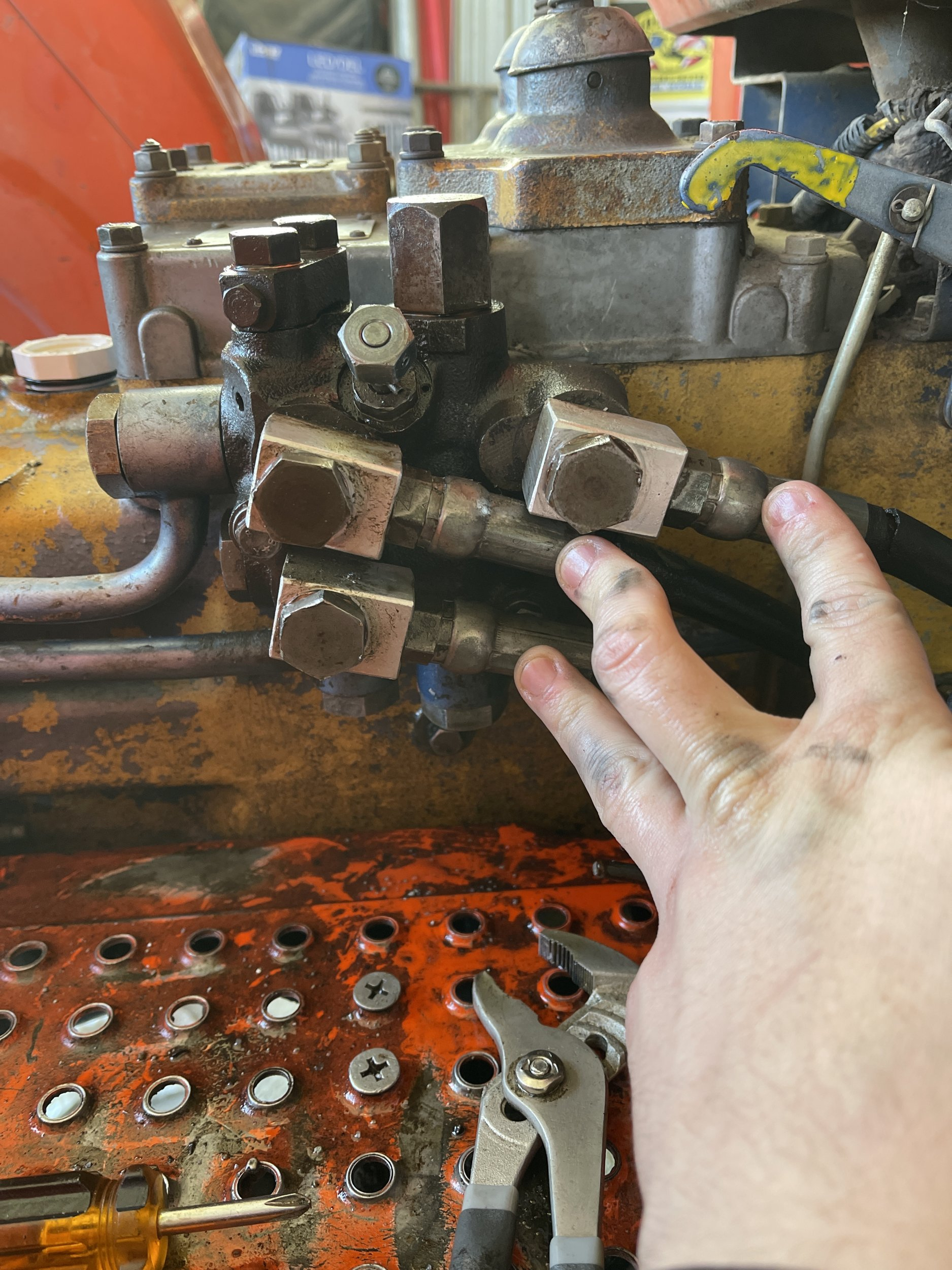

Those three going to the loader valve are these three on the manifold. Bottom left goes to middle on loader valve pic. Top left going to far right on valve pic. Right on manifold goes to far left on valve.

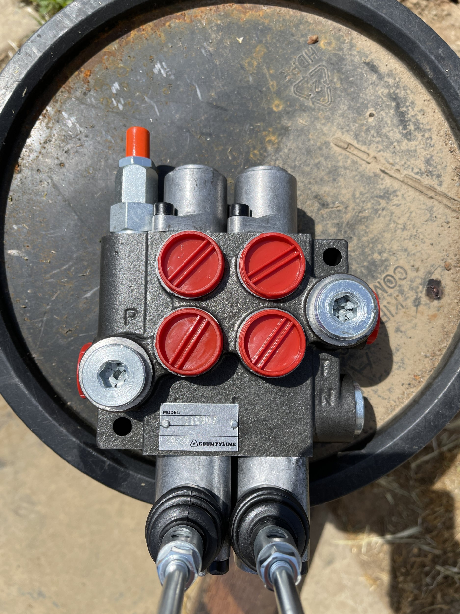

Thank you, I got this valve to replace my existing loader valve, could you just help me understand what P T N stand for? My old valve says in out P. Just need to know on this one which is in and out.
/ Kioti LB2204 hydraulic issues
#37
If I had to guess P is power aka in and t is tank aka out and n that’s plugged would be for the power beyond?
/ Kioti LB2204 hydraulic issues #38
P is Pressure in
T is Tank port
N is Power Beyond. You do need the PB sleeve for this valve in order to use the power beyond.

What is a PB sleeve?
/ Kioti LB2204 hydraulic issues #40
Power beyond sleeve is a fitting that's needed to provide flow to any valves after that one.
It's also valve specific, so you need to get one for your valve, unless you're not feeding any valves after that one. (I haven't read the entire thread though).
