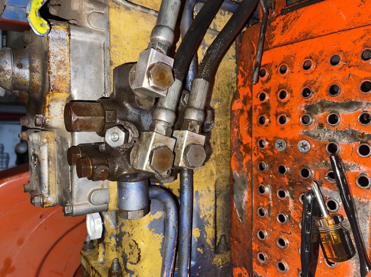

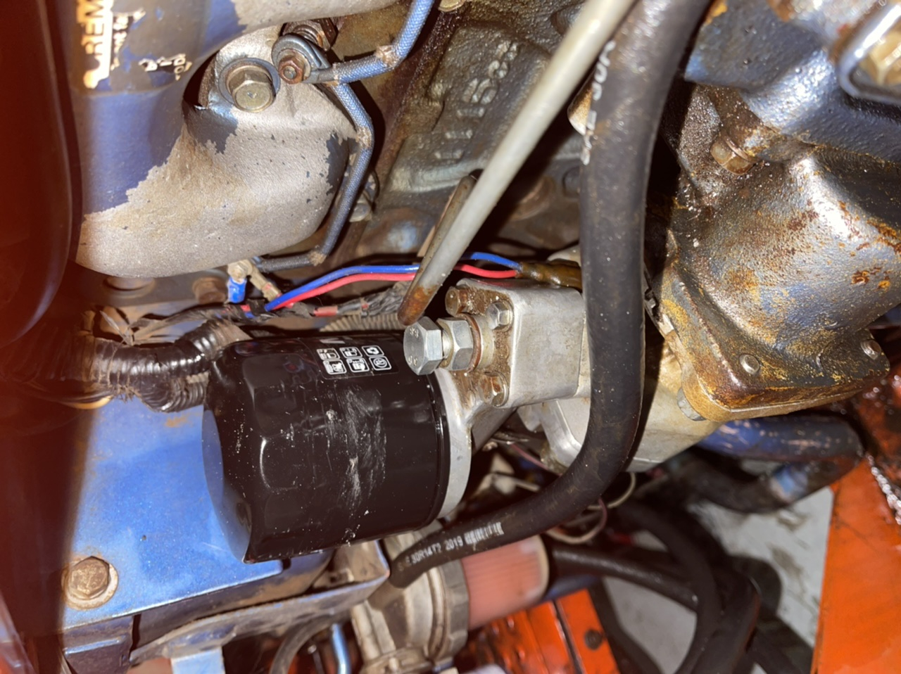

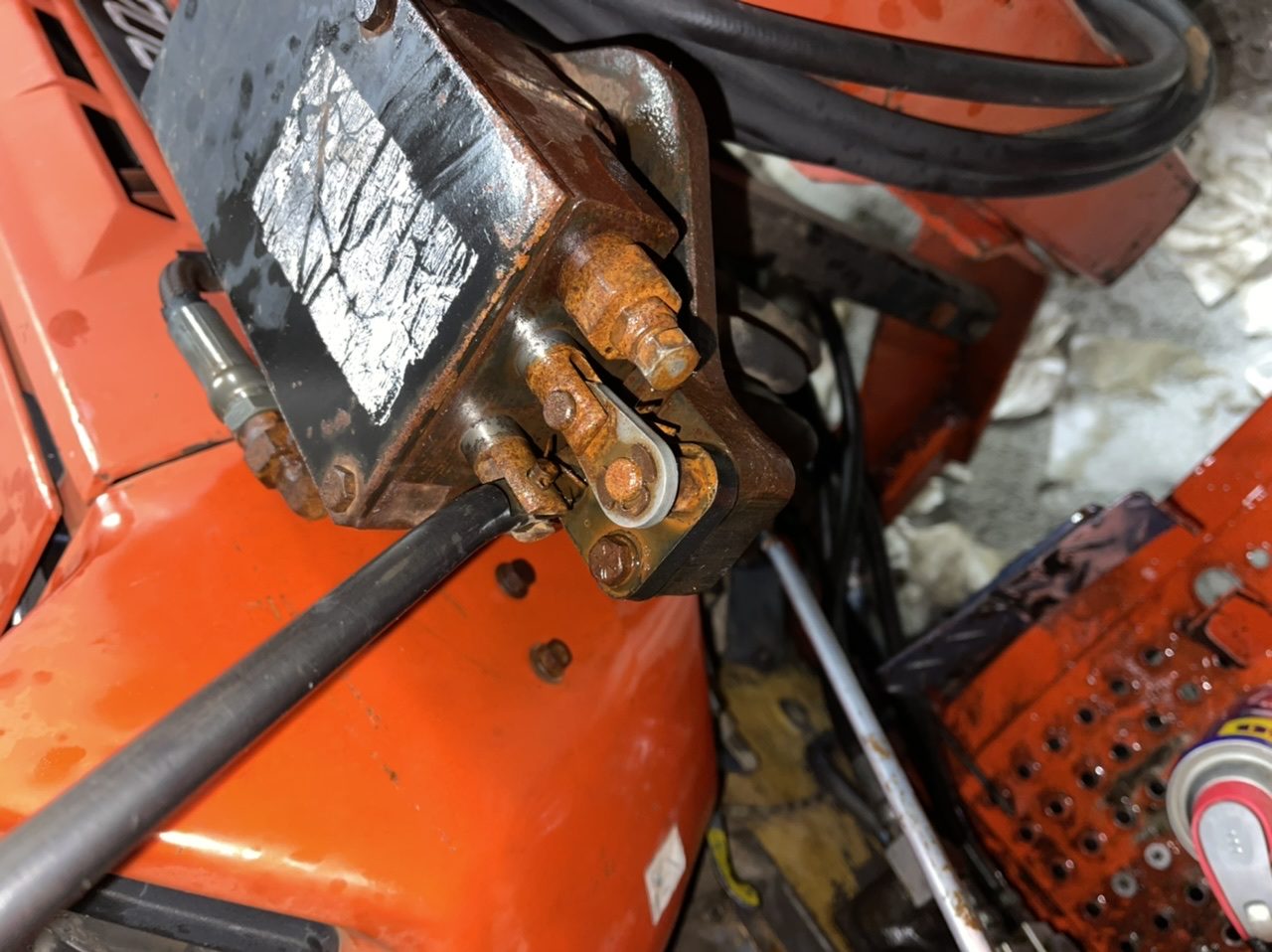

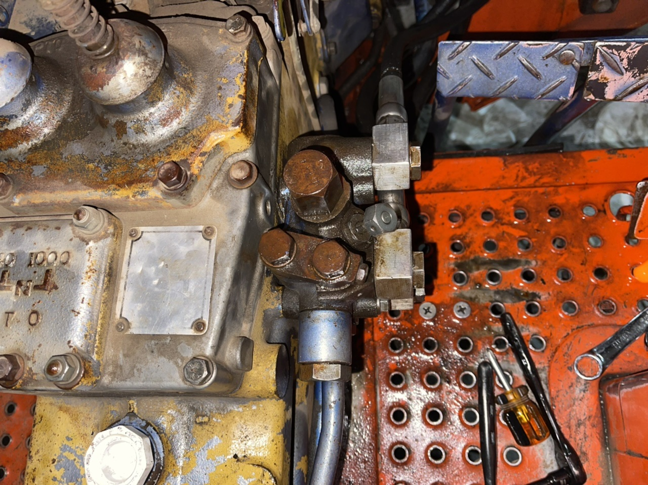

Hello, I recently purchased a Kioti LB2204 and the hydraulics didn’t work at all. After replacing filter and fluids I can get the rear to go up slowly at higher rpm and it will fall once it’s back to idle speed. I’ve taken apart most everything on the hydraulic system of the tractor and I’m still not anywhere closer to fixing it. I would very much appreciate any help I can get with this problem. I’ve included photos of some of the hydraulic components on the tractor.
Thank you in advance

The nut I circled is the diverter for when you have a loader installed. Looks like the pin is cut off or missing but it originally would only turn so far and the pin would keep it from going 360 degrees. All the way clockwise was for a loader and counterclockwise for no loader. Does this have a stop or will it just keep turning?
/ Kioti LB2204 hydraulic issues
It will keep turning freely
/ Kioti LB2204 hydraulic issues #4
That is a problem. That diverts flow to the power beyond that feeds the loader. Then power beyond goes from the loader to 3pt hitch.
In one position, it would bypass the loader and just feed 3pt. In the other position it would feed the loader. Anything in between would create a split flow that would create a shortage of fluid to both. Here is a picture of mine.
That said, the symptoms sound like a weak pump or stuck relief valve. I believe that model had a 7GPM pump so maybe doing a flow test would tell you something.
To do that you can discount the hose feeding the loader and pump it into a 5 gal bucket with a mark for 1 gal. Then time how long it takes to fill to that line. Set RPM somewhere between 1500 and 2000 for the test.
I hope that helps!

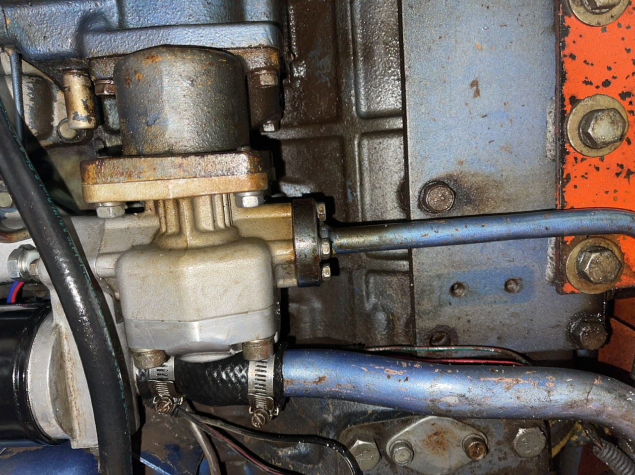

If there was a screen on the suction side of things would I have to take off the top of the transmission under the seat area to get to it?
/ Kioti LB2204 hydraulic issues #13
No it should be on the side of Transmision or behind the fitting that feeds the pump. Just unscrew the fitting from the transmission and the screen may be attached.
#14
That’s the pipe that’s feeding the pump, I’ve taken it apart before to see what’s on the other side and I put it back together after seeing it’s only a small hole not any obvious mesh anywhere. I will give it another look this weekend when I’m able to work on the machine again. Thank you

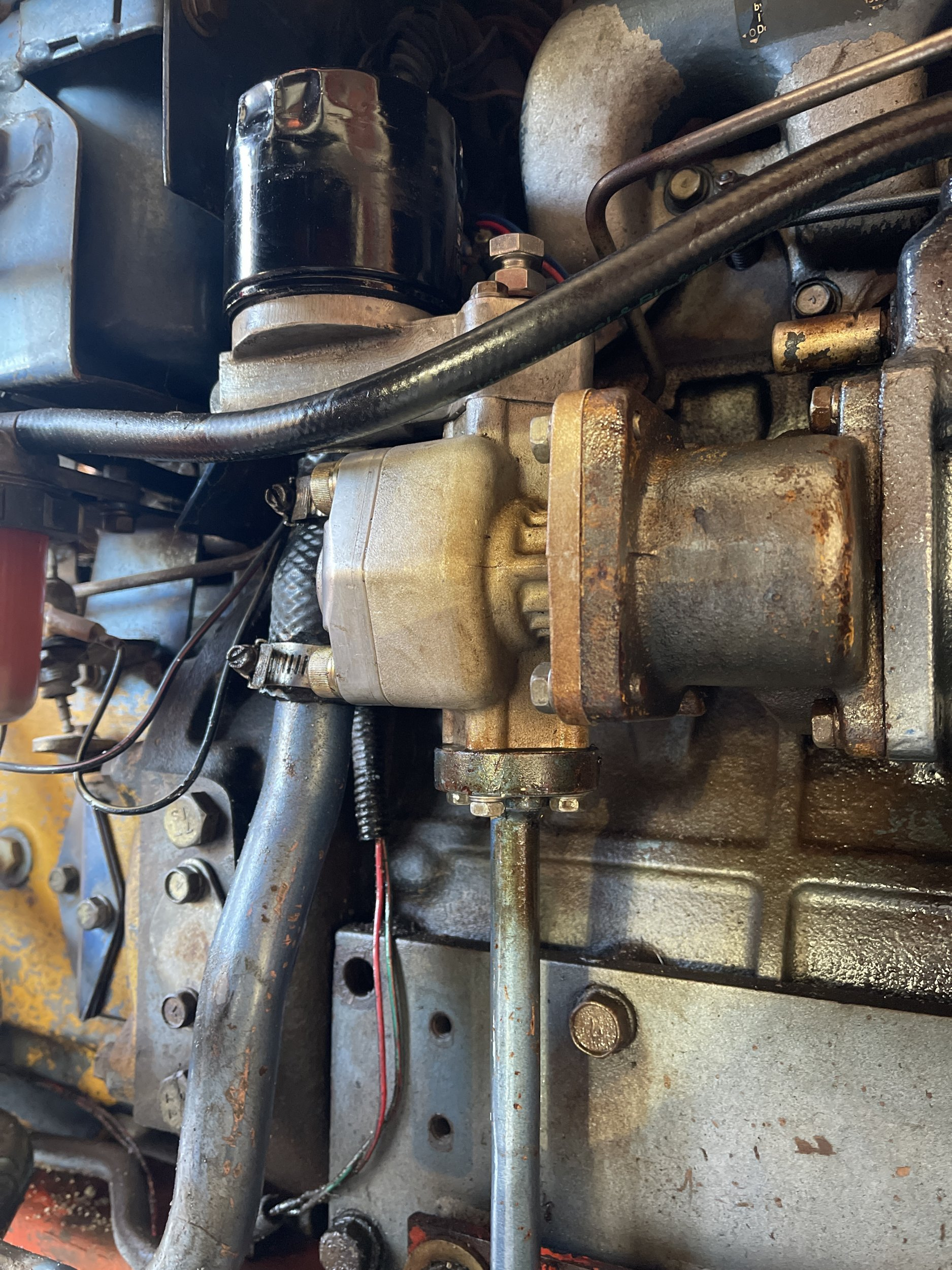

So the specs are 6.67gpm and at a higher rpm I was able to get 3.75gpm and at idle 2.5gpm straight off the pump
/ Kioti LB2204 hydraulic issues #18
So the pump is weak. I would imagine under pressure it would be worse. Can you post a picture of your pump?

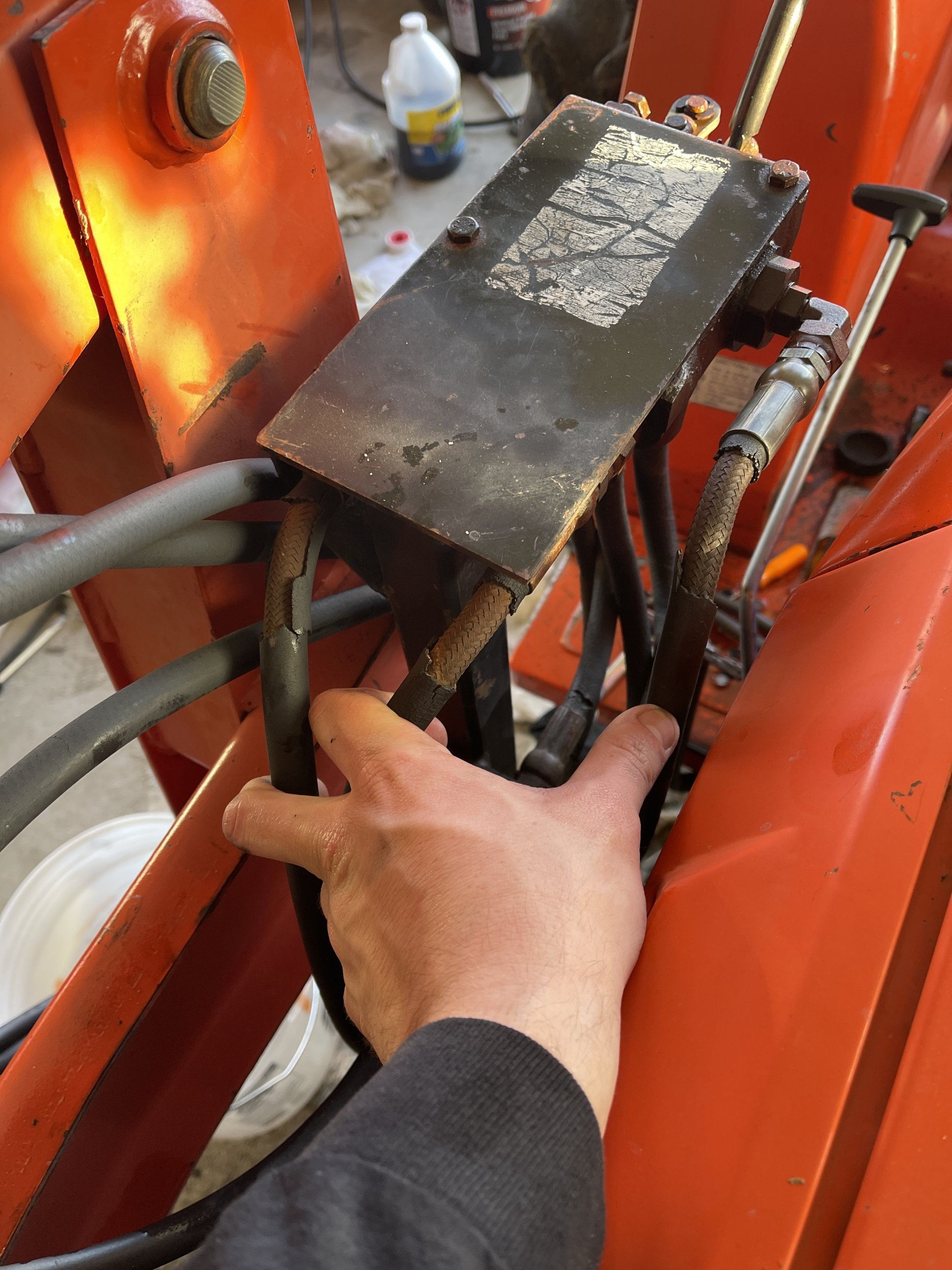

#20
I’m guessing that these three hoses going into the loader valve is inlet, outlet and power beyond. Any chance you can tell me which is which?
