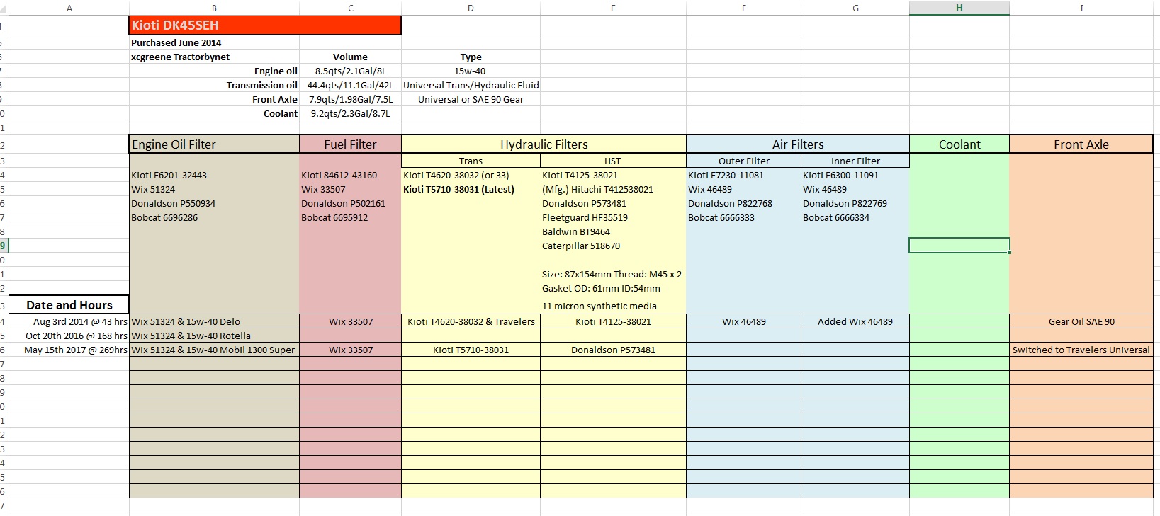

Also, Here is a Spreadsheet I have made of all my cross-referenced filters for my 2014 DK45SEH. I also have volumes, Types, and my own change history on there. Maybe others could find the format useful. I'm not sure if I can put the excel document on here, but this is a screenshot.

Thanks for the spreadsheet, I did copy and paste it.

My tractor history is telling of my decisions. Note that my engine oil choices were based off sales at wallyworld or napa at the time, I pledge allegiance to no one, so long as the standards are met and oil changed reasonably on time. I will say, though, that I prefer Wix filters if purchasing many at a time from Fleetfilter.com. I have 15 different engines around the house, I'll by 3 filters for each engine at a time and the price is WAY under what you'd find buying a wix by itself from amazon, Napa, or what have you. If not buying in bulk from fleetfilter, its not worth it. I've cut open many filters to see the quality, and wix is at the top with a number of others. I recall the original filters that came off my Kioti were top notch as well, having cut them in half. Metal caps, antidrainback valves, good looking media. I think this is very telling of Kioti.
Why are the wix air filters for inner and outer use the same #s?
Oops :ashamed: the inner air filter is supposed to be Wix 46490 (as a note, this inner filter did not come with either of my 2 DK45SEH's)
Updated
