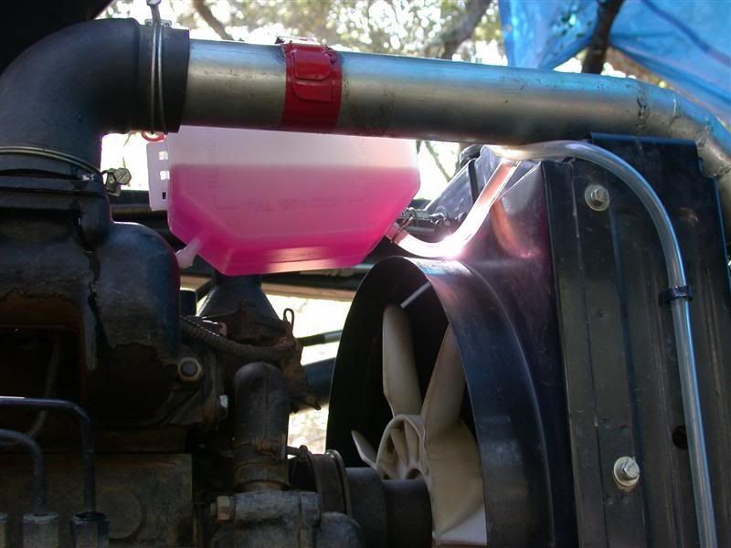

Although I didn't get around to adding the screen in front of the radiator, I finally completed my radiator and coolant change and added the overflow reservoir. Besides being time after nearly 400 hours, there was this lower radiator hose that started showing cracks in it. that also prompted to do something about it.
I started by draining the system of the old anti-freeze. You can see here by the color that the dealer put regular anti-freeze in it and not the specific wet sleeve type, which is either red or orange colored.
Nevertheless, it looked surprisingly super clean! I was starting to wonder why I was doing this?

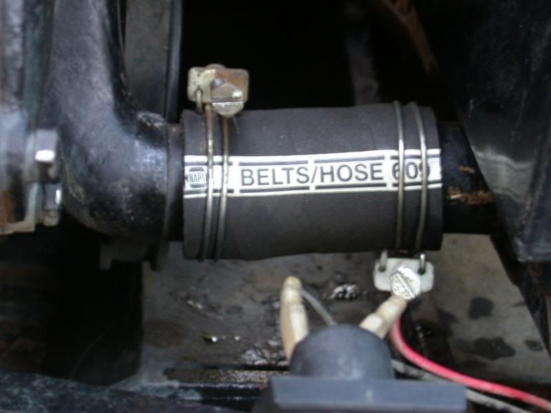

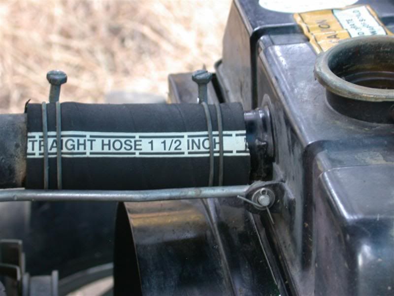

Then it was time to take off the old lower radiator hose and replace with a new one. I bought Ø1-1/2 hose at Napa. The old hose was extremely hard to get off because there was very little room between the radiator and the engine return. The new hose was even harder to get back on! I had to fold it in half to get it in there.
I guess the best way to do it is to remove the radiator completely and put the hoses on the engine ports, then put the radiator back on and connect the hoses to it. but that seemed like too mush work so I managed to sqeeze them in there. I changed to top hose also, while I was at it. I reused the old clamps since I forgot to buy new ones, but they were fine.

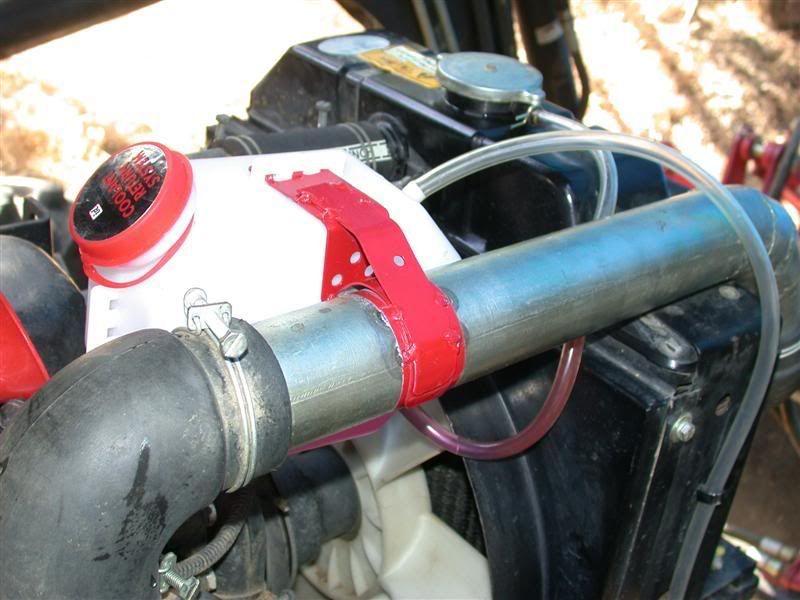

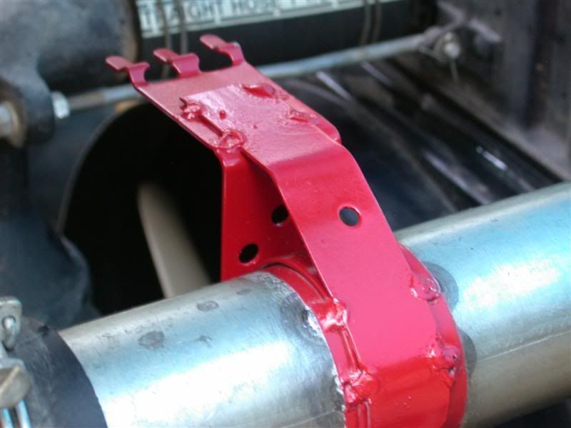

Then I filled the radiator with a 50/50 mixture of the wet sleeve type anti-freeze and distilled water. After that, I used the little flimsy bracket that came with the overflow kit and added some of my own. Then tack welded the bracket to the air intake tube so the overflow could sit as high as possible under the hood.

Here is the overflow kit mounted inside the engine compartment. You can see how high I was able to mount it and without interfering with anything else.
I was able to use my old radiator cap since I've never had an overheating problem with it. Nor did I move the giant air filter which is mounted in front of the radiator for the same reason. I might move it in the future only for the sake of easier cleaning of the radiator. But as far as blocking the air flow and causing overheating, it is no problem. The 554 runs constantly at 80°C as it is.
Here is a shot of the overflow from the bottom. I thought it turned out pretty good with the modified bracket and all.
Thanks for looking.

If you change the hose from the water pump to thermostat housing.......Let us know the NAPA part number as the diameter of the hose ends are different and the hose also has a 90 degree bend. I believe the bottom connection is 1" and the top is 1 1/2".
All my Chinese hoses are cracking and I'm going to do exactly what you are doing hopefully next week if I have time. If I beat you to it replacing this hose I'll post what hose sizes I used and the NAPA part numbers.
You said that the lower hose between the radiator is 1 1/2"? I must have measured wrong as I've recorded that it should be a 2" hose. The top radiator hose is 1 1/2" though.

When you change the elbow hose, let me know what that is.
I used the same hose for both top and bottom connection...both are 1-1/2". If you look closely at the bottom hose photo you can see after the "609" there appears the start of an "S". Then look at the top hose photo and the "S" of Straight hose is cut in half.
Get some hose clamps too.
