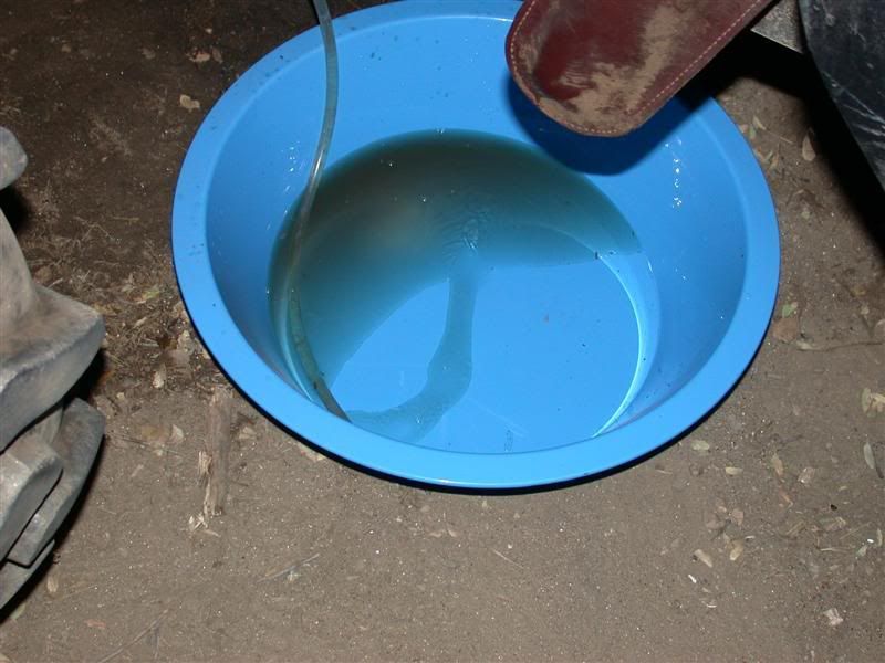

I started by draining the system of the old anti-freeze. You can see here by the color that the dealer put regular anti-freeze in it and not the specific wet sleeve type, which is either red or orange colored.
Nevertheless, it looked surprisingly super clean! I was starting to wonder why I was doing this?

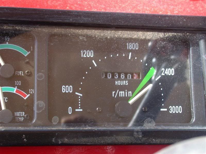

That is until I ran the flushing solution though. Then it all started to make more sense. Don't forget to drain the petcock on the right side of the engine block either.
I ran the engine for about 10 minutes after reaching operating temperature as suggested on the instructions. Even in need of an oil change and a valve lash adjustment, the 554 Kama ran smoothly at 2400rpm.
The more I drained out into the big container, the more I could see how much crud and rust had built up on the inside of the engine block and radiator. This had to affect the cooling ability of the system a little, I would presume.
After the first flushing, I re-filled the radiator and ran it for another 5 minutes or so before draining it again. This time most of the crud had been flushed out.
I did that one more time until the water coming out of the radiator and engine block petcock was very clear.

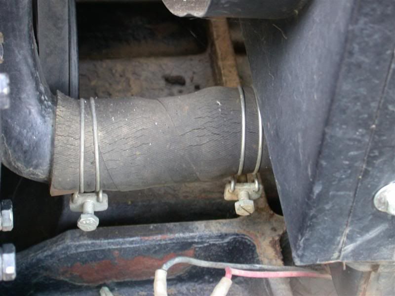

Then it was time to take off the old lower radiator hose and replace with a new one. I bought Ø1-1/2 hose at Napa. The old hose was extremely hard to get off because there was very little room between the radiator and the engine return. The new hose was even harder to get back on! I had to fold it in half to get it in there.
I guess the best way to do it is to remove the radiator completely and put the hoses on the engine ports, then put the radiator back on and connect the hoses to it. but that seemed like too mush work so I managed to sqeeze them in there. I changed to top hose also, while I was at it. I reused the old clamps since I forgot to buy new ones, but they were fine.
Then I filled the radiator with a 50/50 mixture of the wet sleeve type anti-freeze and distilled water. After that, I used the little flimsy bracket that came with the overflow kit and added some of my own. Then tack welded the bracket to the air intake tube so the overflow could sit as high as possible under the hood.

If you change the hose from the water pump to thermostat housing.......Let us know the NAPA part number as the diameter of the hose ends are different and the hose also has a 90 degree bend. I believe the bottom connection is 1" and the top is 1 1/2".
All my Chinese hoses are cracking and I'm going to do exactly what you are doing hopefully next week if I have time. If I beat you to it replacing this hose I'll post what hose sizes I used and the NAPA part numbers.
You said that the lower hose between the radiator is 1 1/2"? I must have measured wrong as I've recorded that it should be a 2" hose. The top radiator hose is 1 1/2" though.

I used the same hose for both top and bottom connection...both are 1-1/2". If you look closely at the bottom hose photo you can see after the "609" there appears the start of an "S". Then look at the top hose photo and the "S" of Straight hose is cut in half.
Get some hose clamps too.
Don't know if this will help anyone http://www.napaonline.com/MasterPag...at=Heater+Hose+-+90+Degree+Molded&VehCode=N.. NAPA has pictures and hose sizes posted on their web site..Also has adapters available for "limited" hose size changes, ie: (3/8" to 1/2") etc.
